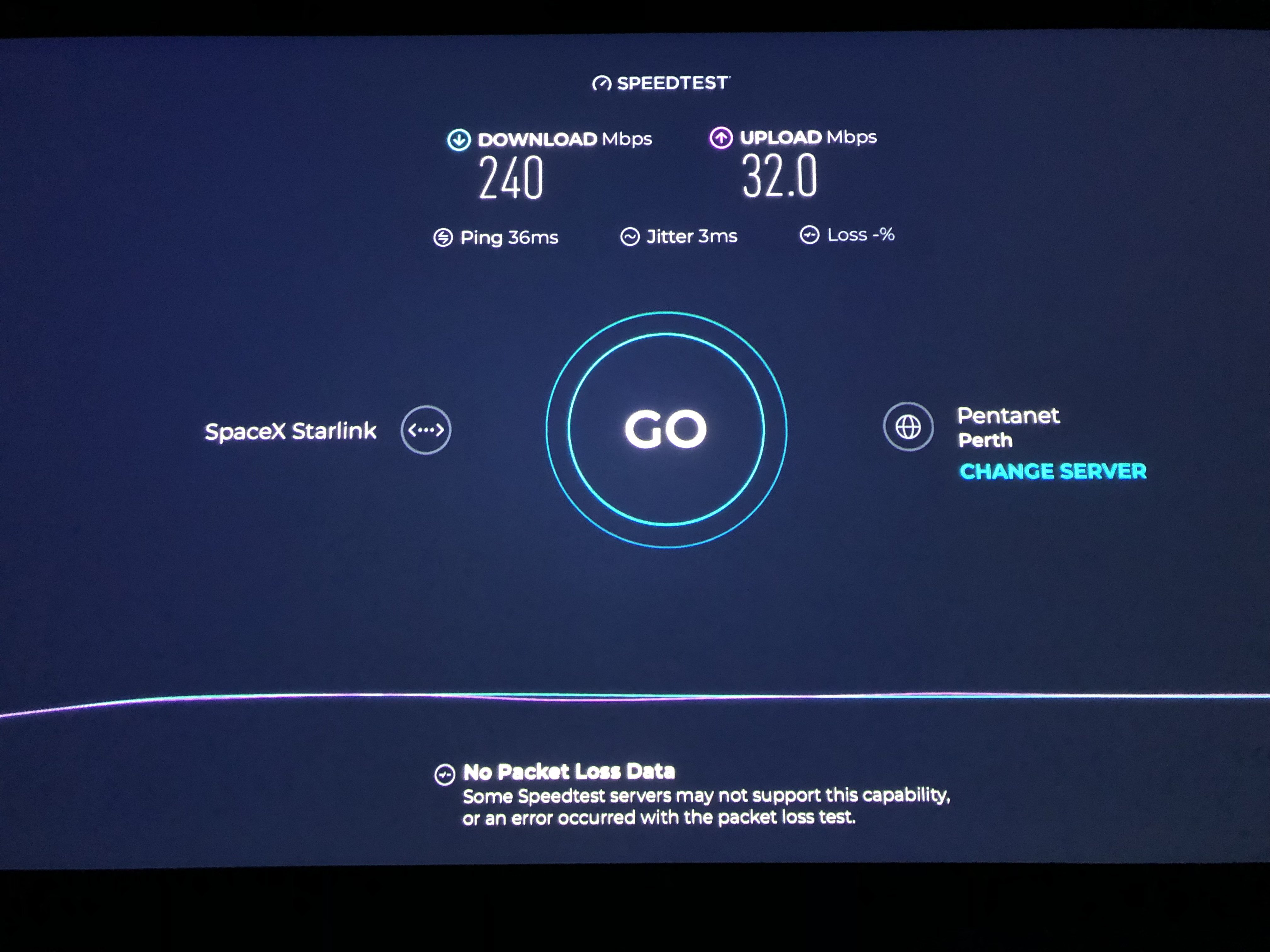

I've never noticed Starlink throttling down speed at any time previously and I probably run a Speedtest once a week. I did what you suggested and ran speed tests on my MacBook and then the ATV.
Top is Speedtest on ATV4K app.
This is the Speedtest from my MacBook via WiFi immediately before. So the ATV4k is getting slightly better speed which is understandable as it is connected via ethernet.

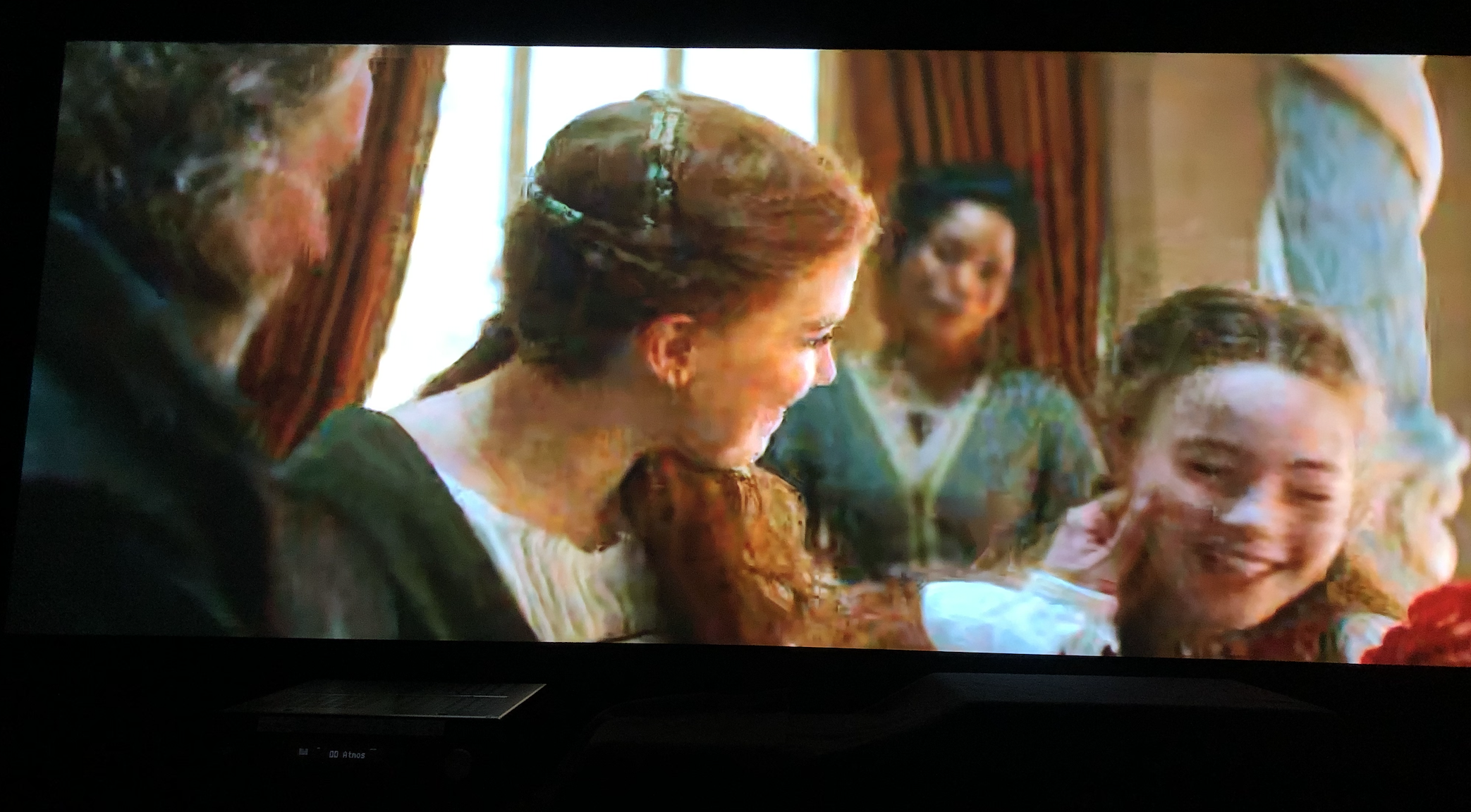

This is an iPhone photo just now from Damsel, Millie Bobby Brown's worst movie ever. The picture is terribly compressed.

3 minutes ago, Quark said:
I'm jealous of your download speeds!
Agree, that sample image you posted is appalling.
