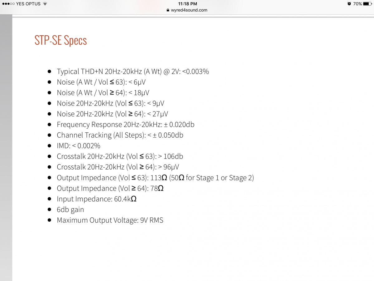

Addicted to music Posted July 28, 2016 Share Posted July 28, 2016 I'd seriously consider this. http://www.stereo.net.au/forums/index.php/topic/108000-wyred-4-sound-stp-se/ Uses some very high quality components, a stepped resistor ladder switched by sealed integrated relays if I'm not mistaken and supports Balance. 1 Link to comment Share on other sites More sharing options...
greigw Posted July 28, 2016 Author Share Posted July 28, 2016 I'd seriously consider this. http://www.stereo.net.au/forums/index.php/topic/108000-wyred-4-sound-stp-se/ Yes been reading about that one. But not sure about passive with the relatively low input impedance of my power amp. I wonder how the W4S would this compare to the MF a5cr? And does the wee Klein pre play in the same league as the amps mentioned? Link to comment Share on other sites More sharing options...
Addicted to music Posted July 28, 2016 Share Posted July 28, 2016 (edited) Yes been reading about that one. But not sure about passive with the relatively low input impedance of my power amp. I wonder how the W4S would this compare to the MF a5cr? And does the wee Klein pre play in the same league as the amps mentioned? The WFS has an output impedance of 113 ohms max. That's an easy drive for 33k ohms. Also looking at the gain and Max voltage output suggest it's an easy drive for the Holton's. Edited July 28, 2016 by Addicted to music Link to comment Share on other sites More sharing options...
Addicted to music Posted July 28, 2016 Share Posted July 28, 2016 (edited) Here's a review, http://www.6moons.com/audioreviews/wyred2/preamp.html Ignore the BS literature, just look at the photos, it tells me high quality componentry and very well laid out. A must for what's asked in the classified here, Edited July 28, 2016 by Addicted to music Link to comment Share on other sites More sharing options...
betty boop Posted July 28, 2016 Share Posted July 28, 2016 Yes been reading about that one. But not sure about passive with the relatively low input impedance of my power amp. I wonder how the W4S would this compare to the MF a5cr? And does the wee Klein pre play in the same league as the amps mentioned? personal experience wiht it myself to comment .ran the mf a5cr myself some ten years gorgeous pre amp, with its matching a5cr power were not shamed feeding some 20k speakers. theyre the super bargain to grab buying yourself some $4k in pre amp. actually the m6 that followed and is still current is pretty much the same at some $6k in rrp. gives some idea the kind of pre amp getting for your money. pure analog and fully featured to the hilt Link to comment Share on other sites More sharing options...
greigw Posted July 28, 2016 Author Share Posted July 28, 2016 Or 113ohm at vol <63. I notice a high turn over of these W4S amps. Anybody know how the amps mentioned compare to a lightspeed attenuator? 1 Link to comment Share on other sites More sharing options...
