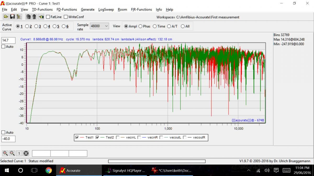

Anyway, I fired up Acourate. This is the result of my very first measurement sweep:

You can see that the high frequencies are -10dB down compared to the midrange. Also a downward curve in the upper bass, above 100Hz.

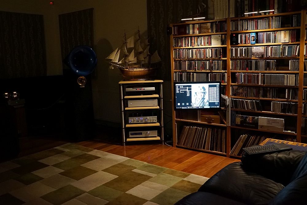

Here are a few updated system pics.
post-104440-0-48698500-1467210716_thumb.

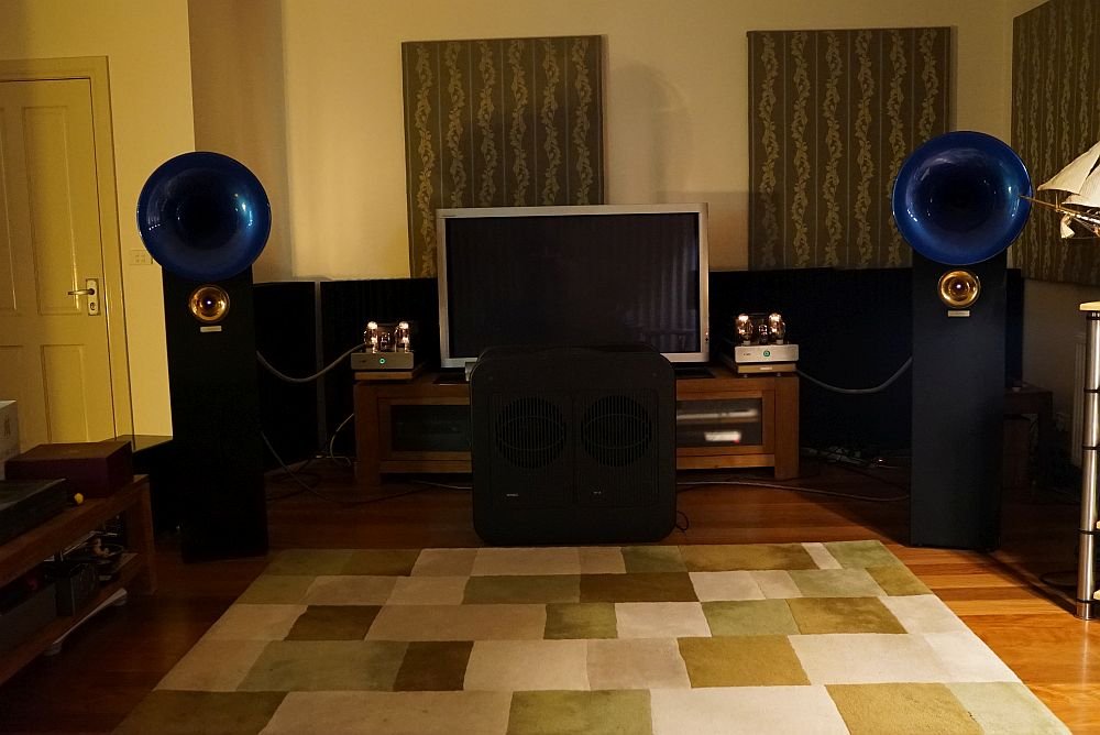

Overview of the system.
post-104440-0-16069600-1467210723_thumb.
View from the listening chair.

The whole system with a borrowed subwoofer - a Genelec monster pro sub. This thing is so powerful it makes the house vibrate.

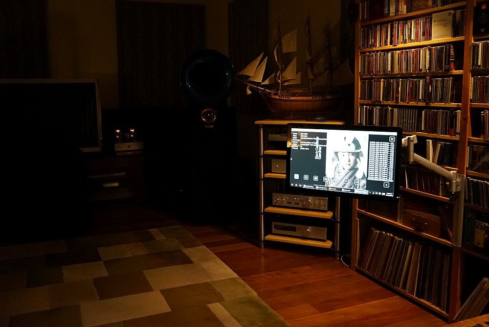

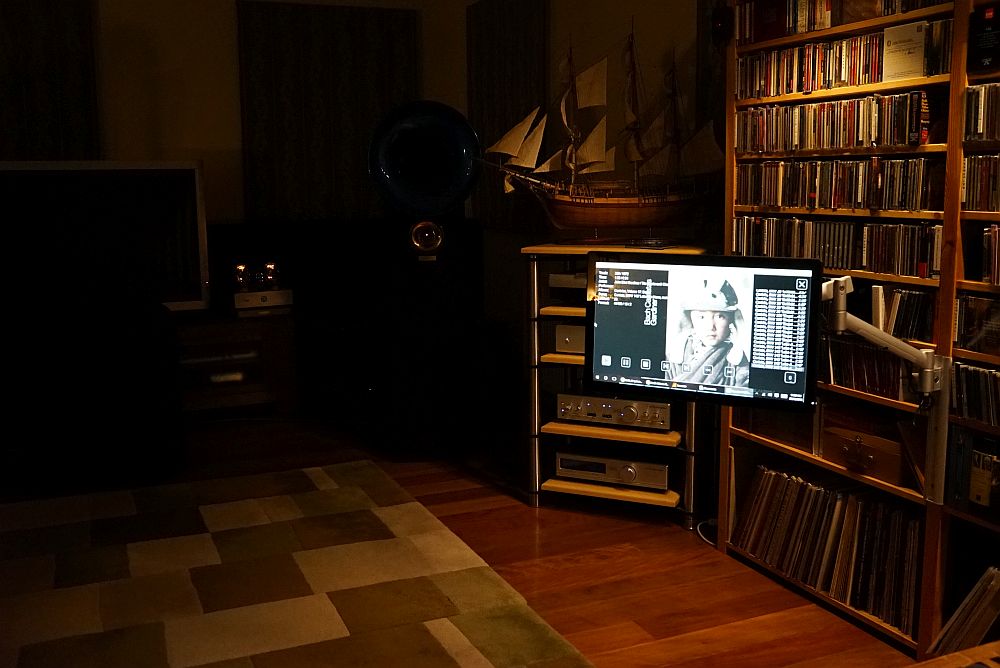

Dell S2240T touch screen monitor mounted on an Atdec Systema arm: http://www.atdec.com.au/tv-monitor-mounts/desk-mounts

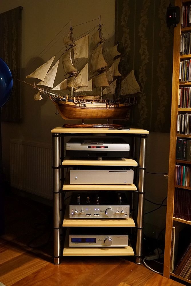

Equipment stack. From top to bottom: Playback Designs MPS-5, Audio PC, Cary SLP-05 preamp, Cary SLP-05 power supply
