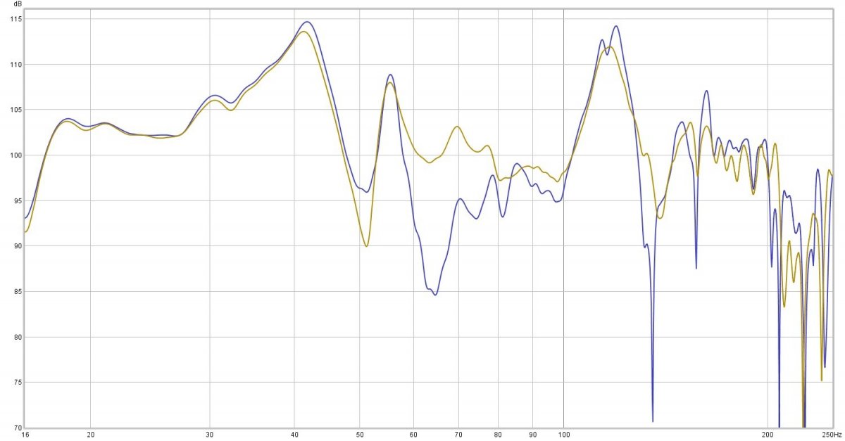

12 hours ago, almikel said:
that's why absorption gets too big to work effectively below 125-150Hz. They're big at 150Hz and truly massive at 100Hz.
Sorta Mike, at least in theory.  In practice things are sometimes different.  Recently playing with two (2) unopened bags of Greenstuf R2.5 in my room I had good impact sub 100Hz, especially with cancellations rather than reinforcements.  Enough of an impact for me to consider building proper Superchunk traps to see how they do.
Blue = zero room treatment
Gold = 2 unopened bags of Greenstuf R2.5 in one front corner floor to ceiling
15dB improvement @ 64Hz which makes the whole 60Hz-100Hz  fit within +/-2.5db of the first order low pass set at 60Hz.  Some effects as low as 40Hz, and some hope of taming the room modes circa 42Hz, 55Hz, 117Hz with more stuff in the right places.
Cheers,
Anthony
ya gotta consider the theory, but I just cant help loving the practice a whole lot more :). Thanks Anthony for your observations noted here
Just as an aside.....  Remember that the frequency resolution of this data is quite limited.
What you are actually looking at, rather than "15db improvement".....  is really turning a total cancellation (actually a combination of multiple total cancellations), into "not-cancelled".     You just can't see these "total cancellations" very clearly as there aren't enough data points on the X axis.    The fact that REW has drawn a continuous line through the data points - hides the reality.
It might seem like semantics, but it can be important for understanding.

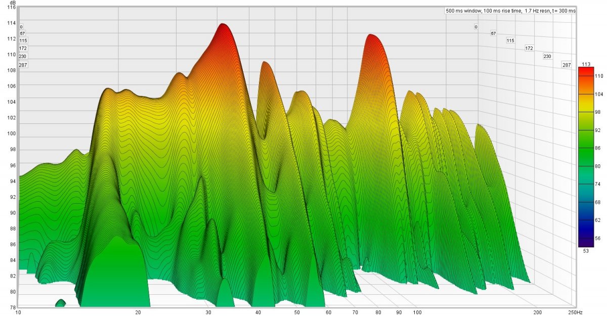

Be good to see a waterfall
Before (zero treatment):
2 unopened bags Greenstuf R2.5 stacked floor to ceiling in corner behind speaker:
381778442_Waterfall2bagsGreenstufbehindactiveCannon.thumb.jpg.b22c30b18b6b7f6e42cbe984648886fe.jpg
7 hours ago, Peter the Greek said:
Its still a pretty darn good outcome isn't it? considering the simplicity of what was done.
Agreed - and it's reduced the nulls above 100Hz also...as expected.

It's a bit easier to see with a gif. Anthony's waterfalls:
Thanks for sharing the waterfalls. What kind of subjective difference did you notice?
When using lower density bass traps with a low GFR, you can improve results by making them thicker. However, when you are using products like Polymax, greater thickness is not always more beneficial. There are trade offs involved between bass and low midrange absorption.
The theory doesn't contradict practice. The theory is built into the models which predict that practical resistive bass traps can be made, using dimensions that are much smaller than ideal, with measurable and audible improvements below 100 Hz.
@Red Spade AudioPaul, thanks for the gif...what a great idea!  Please share how you did that although I could probably google it.
Subjectively, I did not listen to anything but sweeps and I shifted the Greenstuff out of the room immediately because it is for something else.  Because Autex have shut up shop here and gone back to NZ I have since purchased some Higgins R2.5 poly insulation to roughly make a corner trap or two for more formal testing.  Just gotta find some free time to cut it up and stack it in place.
One thing that I have wondered since taking these measurements is whether the  physical shape of my sub has something to do with the success of the trap.  It's not a normal sub...see below...
Not as much as you might think.... we discussed this a lot earlier in the thread, where I was repeating that your sub is "not a line source" ... and that the "shape" of your subwoofer wasn't a concern for LF.
50Hz is a ~7m wave , and 25Hz is ~14m ...  So, your subwoofer is 1/7th of a wavelength long.   It's still a "point source"   (ie. it's too small to constrain the dispersion of soundwave) .... in fact it's much more like a point source, than mids and tweeters in a typical box speaker.
Cannons  :D :D
3 hours ago, Peter the Greek said:
Sorry I didn't mean it like that, more a question as opposed to a statement.
Yeah, I got it.... answer the the question is yes (sure!) still a good result.... which is not unexpected, as like Paul said, simple models of the bass traps, and of a purely pressure/velocity action ..... might say "they won't work" ... the reality is more complex than the model.
Cannons  :D :D
Nothing to do with line source behaviour Dave...I was referring to more to physical reflections due to the size and heftiness of the subs...2.4m tall x 1m deep and 400 kg...a wall of sorts...perhaps with a behaviour of reflecting more of the low frequency energy back into the wall or corner rather than letting it bounce around other parts of the room.  Sound wraps around the speaker, bounces off the side wall (bricks) then the Cannons, then the side wall, Cannon et cetera, getting a little less each time as the wall and the Cannon lets a bit through, but ultimately more energy stays in the corner to be absorbed by the Greenstuf.  It may only be a few or maybe 10% more energy reflected back into the trap by the mass of the Cannons.
One thing that I can say is that the bass in the room improved a little just by building the Cannons in situ even without turning them on and still using the ML1's...I reckon there is something in my theory....somewhere...perhaps.
Ahhh, I see.
The object will be beginning to reflect the sound once it's bigger than 1/4 WL .... so not really.    It could explain some of the small effects you see here and there in the results (which aren't covered by some other theory)
