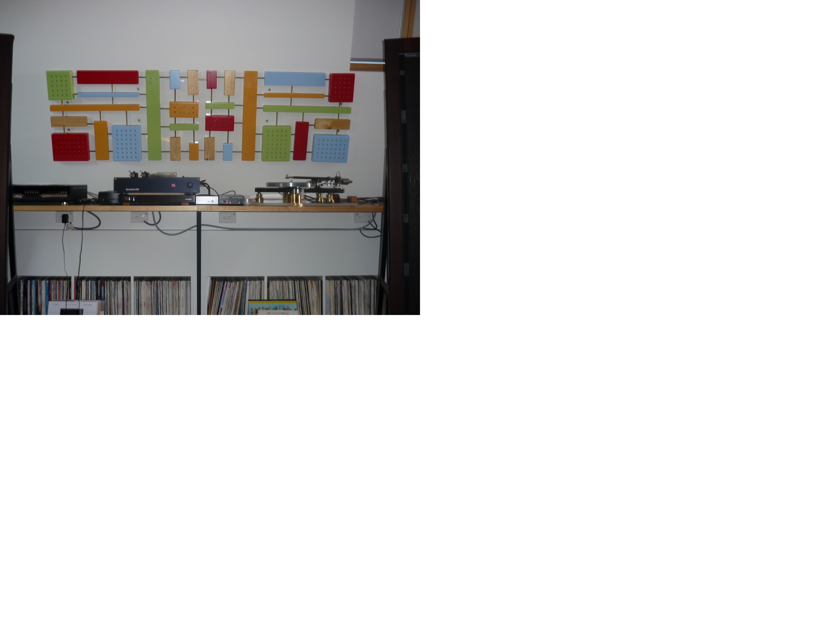

Well, finally the art work is fixed to the wall.  :)  (A very delicate operation as the studs were difficult to locate accurately, through double sheets of Soundcheck plasterboard! :( )
Now for the listening test!  :lol:  (To see whether it actually does do any diffusion and so delivers extra soundstage depth.)  @guru, are you still planning on coming down with your 'shoebox'?  :)

So Andy.   Looks good.
Does it do anything to the sound?
Btw, don't let the grand children into the room.  They will be climbing on top of the turntable to pull some of those nice colours off the wall :)
Andy
Thank you Shane.  :thumb:  Yes, visually it is good (wifey is very happy! :winky: ) ... I just hope that it also improves soundstage depth ... by delivering some diffusion.
Quote
Have not yet been able to sit down and listen seriously.  :(  First impressions are - yes (but only a little bit - which is certainly good!).  I need to have a consensus from my "golden-eared panel" before I can accept that, though!  :lol:
Quote
Good point - I will remember this when grand kids come along.
