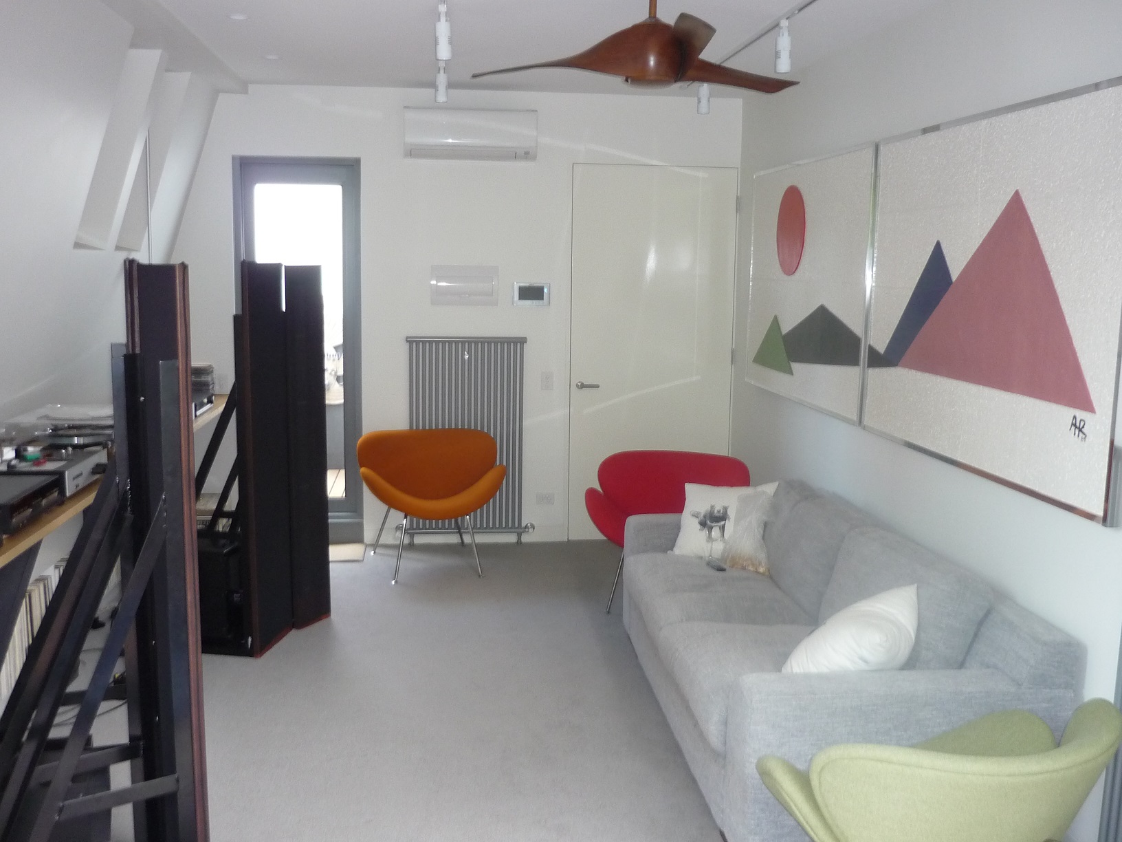

I have now got to work on my 'lack of soundstage depth' problem.
In my last house, I had my Maggies in a nice big room - 8m x 5.1m ... with a cathedral ceiling that was 2.7m at the side (long) walls and ~5.5m in the centre.  (I forget the exact height - I specified the rake angle between the 2 ceiling panels to be 100 deg ... so that I wouldn't get the infinitely repeating reflection from floor up to one ceiling panel, horizontally across to the other – then down to the floor ... and then up to the ceiling panel to repeat the reflection, which a 90 deg rake would've delivered.)
The room worked very well and, because of the length, I was able to have my Maggies 1.6m (1/5th room length) off the front wall - which gave me a great soundstage.  I then added a pair of DIY 'Room Tunes' – and got more soundstage depth!  ?  (Room Tunes were a commercial product from the mid 80s (I think) which didn't last long.  What they did - for Maggies, anyway - was diffuse the reflections from the ribbons off the front wall to the listener.)
Anyway, a guy named Jon Risch published a DIY design for Room Tunes, on Audio Asylum - basically, each Room Tune consists of 3 lengths of 50mm plastic pipe fixed to a base so they stood about 18mm apart but not quite parallel.  I made up a pair of these and found that, when I placed them about 100mm off the front wall, in line with the reflection off the front wall from the ribbons to my ears ... they greatly increased the depth of field I could hear.  Amazing!  With the Room Tunes in place, you could hear the sound stage extending a long way back ... laying them down on the floor reduced the depth to no more than where the front wall was!
Because of this experience, it seemed to me that - for dipoles, anyway - soundstage depth can be increased by diffusing the higher frequency reflections only ... you don't need to have a thick diffusor which diffusing LFs requires?  And a subsequent discussion on an SNA thread about diffusors under “Room Acoustics, Construction and Design” suggested that I was on the right track.  :)
Why this is important to me is that my current listening room is much smaller than what I used to have.  :(  I can only have my panels 900mm off the front wall and as a result, I don't experience much in the way of soundstage depth.  So I was hoping that putting some kind of diffusor on the front wall - which is designed to work with HFs only - would deliver the increase in soundstage depth that I am craving.
Due to my previous good experience with plastic piping, I had been thinking of a vertical & horizontal lattice of 25mm OD pipes, say 50mm apart - and painted the same colour as the wall.  But the good wife wasn’t having a bar of plastic pipes on the wall!  :(  (And it is a room that she uses, from time to time!)
Anyway, after some research on the net, she pointed me to a guy in the US who makes “wall sculptures” out of wood blocks, joined together with steel rod – which she would countenance having on the wall.  As he doesn’t ship outside the US, I decided I would make something better (bigger!) than what he does, myself!  :)
I started off by researching what widths and thicknesses of wood I could buy in Bunnings (this was important because Bunnings offers a cutting service – I don’t have a drop saw!).  Then I used Visio to draw up the design – which (inspired by the Melbourne Recital Centre Salon) ended up as 30 pieces of wood, of various types, widths, lengths and thicknesses, taking up a space which is 600mm high x just over 2m wide.  With a requirement from my wife that the pieces of wood had to be painted in colours that match the 4 chairs we have in the room.
This peculiar size is due to the wall behind my Maggies being:
  1. sloping (due to Building Regs), with a pair of thin dormer windows, and
  2. bisected by the bench which my gear rests on.  Below the bench is storage for LPs – which provides a diffusing surface – but there is also a 300mm high vertical panel above the LPs, which may also have to be treated with a diffusion layer, at some future stage.  (Depending on the success of the wall piece!)

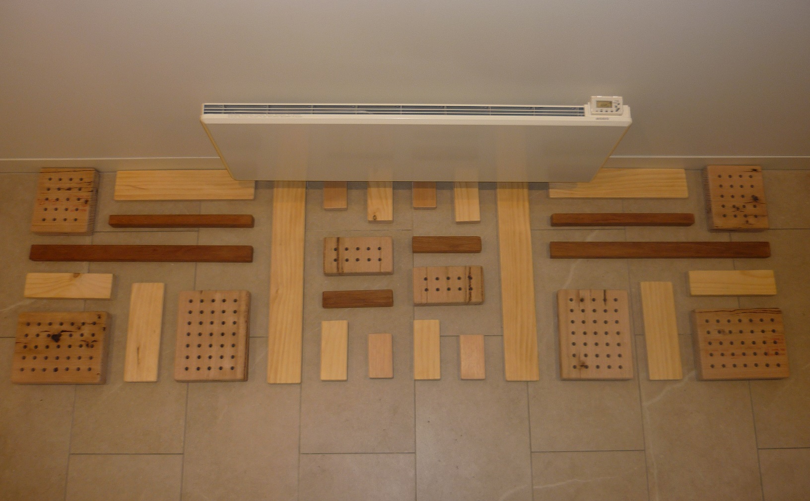

Then I went and bought the pieces of wood from Bunnings (who cut them to length) – plus 2x 5m lengths of 5/16” diameter, thick-walled brass tube, to be used to join the pieces of wood together – and got to work!  Lots of sanding & drilling later, here is a pic of the pieces all laid out on the floor:
And after lots more drilling and tube-cutting, here is a pic of the structure all connected up with lengths of brass tubing.

1st attached jpg

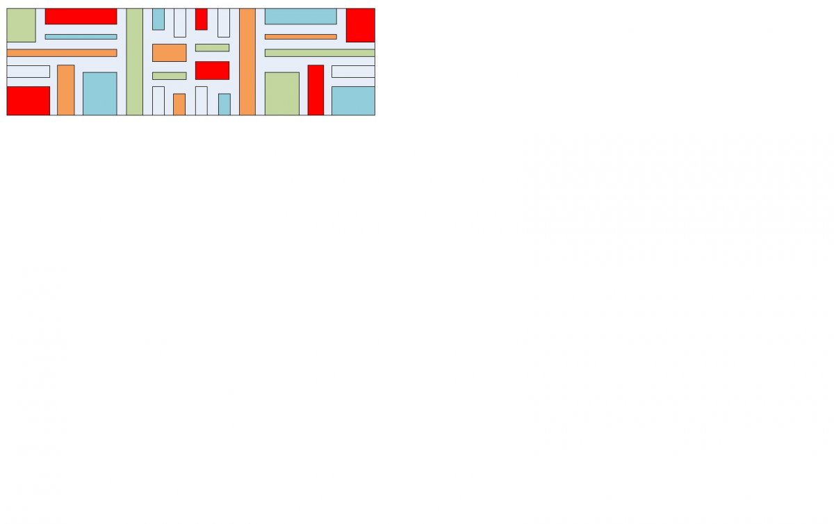

Visio pdf

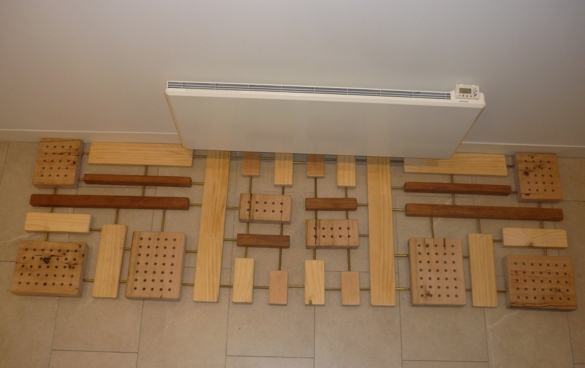

3rd attached jpg

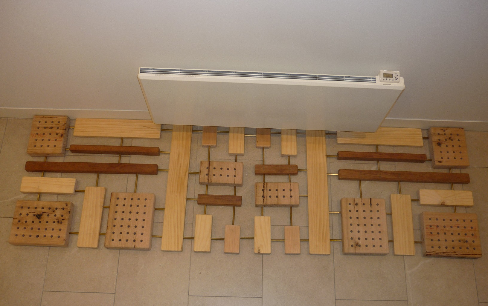

4th attached jpg
