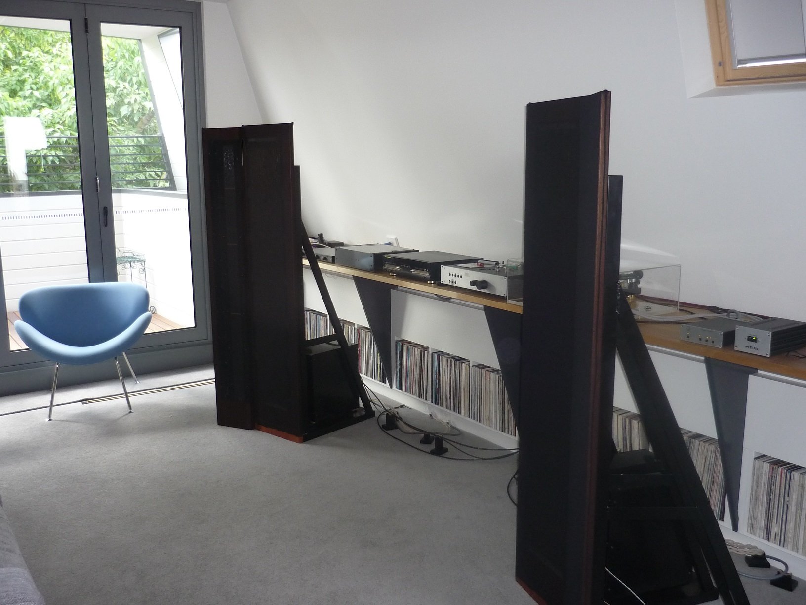

Is there a current photo of your room and system to get an appreciation of what your doing?
  • Author
On 30/08/2019 at 2:56 PM, Nada said:
Would it be worthwhile trying higher crossover points with gentle slopes too? It looks like an easy free experiment which might give interesting results with mid-bass rich music,  like acoustic bass in jazz.
Yes, it's a simple thing to do, N ... but I can't see any logic for lowering the XO slopes/raising the XO point?
As always - the change is quick ... but then you need to spend tome testing whether the new setup actually does sound better.  :)
Does this help?
The edge of the listening couch is shown in the bottom left corner of the pic.
The L sub is in the front corner, hidden by the L Maggie (under that laminated benchtop).
Andy
