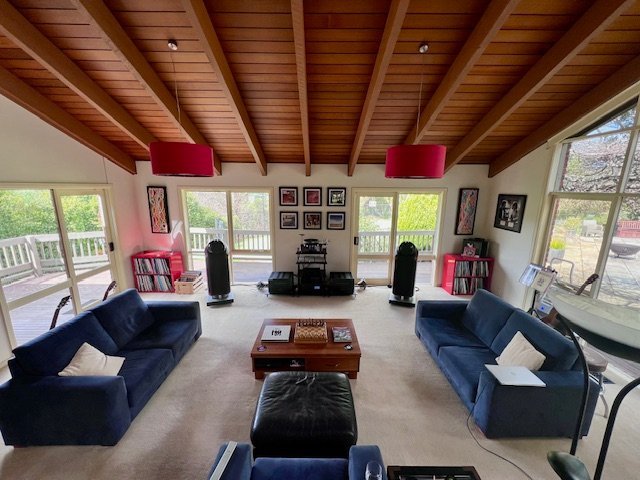

Looking for suggestions on whether to put curtains behind speakers or not. I am happy with my set up but always wonder how it might sound (?better) with curtains behind the speakers. I have a large room with lots of windows. The windows behind speakers do shudder a bit with louder volumes/base but don't usually listen at such levels. The soundstage I get is great but the sound is somewhat bright compared to a friends similar set up in a smaller room with no windows and I always envy his sound even though he has the 802s instead of the 801s - it is a richer sound with great depth.
Would curtains improve things or deaden the sound?
Any particular type of curtains? Blinds or thick curtains?
Any other suggestions for room treatment that might help - been wondering about acoustic reflection panels instead of those red lights hanging from ceiling.
Any suggestions how I can try things out before committing to curtains?
Always had great help from these forums so thanks in advance.

  • Hi and thanks for tagging me @Steff.    Lots of glass makes the room sound bright. The reason is because they are membrane absorbers - they absorb certain wavelengths depending on the resona
  • Thank you Mike.    All great tips. Behind me (as I listen to my system now) are stairs to downstairs cinema and a bar. So curtains behind me not an option.   I think I will go with so

Getting bass effects from the rear windows—are the 801s rear ported? Something to eliminate those out-of-time window reflections will help with the overall sound image, if not with perceived brightness.
Lots of glass makes the room sound bright. The reason is because they are membrane absorbers - they absorb certain wavelengths depending on the resonant frequency. Some of the energy is converted to heat, but the rest is re-radiated into the room at the resonant frequency. At the same time, high frequencies are reflected back into the room with no absorption at all. The nett effect is to reduce bass in the room (good), maybe creating some resonant bass frequencies (bad) and leaving the higher frequencies untouched (also bad).
As @Satanica mentioned, this brand of speaker is also known for a bright top end which would compound the problem. His advice to toe them out might work depending on your listening triangle.
Curtains are a very good idea. Some acoustic curtains are rated according to the NRC (Noise Reduction Coefficient). The best way to choose your curtains is to take some acoustic measurements so that you have some idea what frequencies need to be absorbed and what needs to be left alone. Of course you could wing it and guess, but results are rarely as accurate. I am more than happy to visit you and take those measurements and discuss what they mean. Or you could pay a professional acoustician (someone like Corsini) who would do a much better job than me, since he does it for a living and I do it as a hobby and for fun!

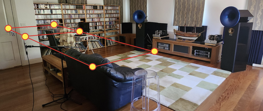

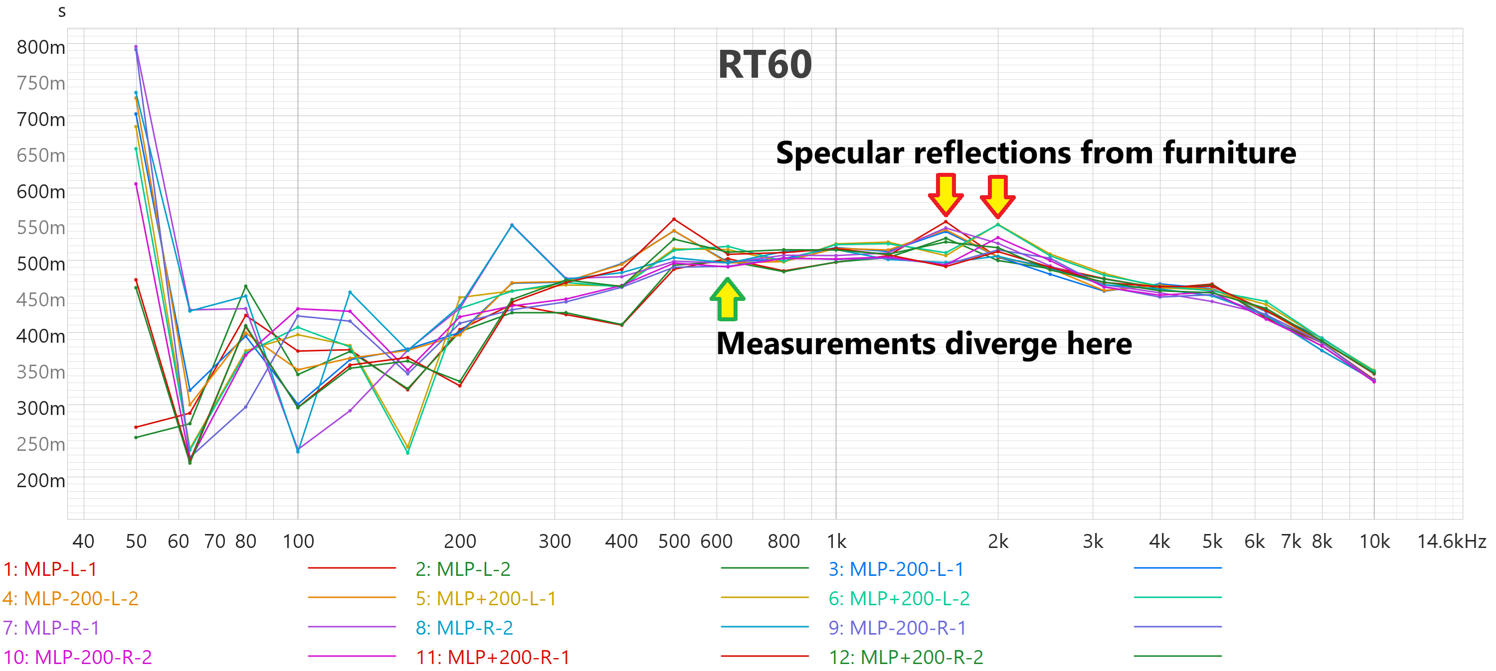

As it turns out, I just made this post on another forum. So i've cut and pasted it for your benefit.
I have wondered for some time whether reverberant fields actually exist in listening rooms. Dr. Toole says that the RT60 should be renamed "early reflection decay", because small rooms have specular reflections and not reverberant fields. But ... a 20kHz wavelength is 17.2mm, surely that is short enough to form a reverberant field, as well as specular reflections? And given that specular reflections become more diffuse as you get further from the wall, at what distance do they become "not specular"?
A reverberant field is supposed to measure the same no matter where in the room it is measured. I have made this theoretical point to others. And given that I am writing a REW guide, I decided to test this theory.
So I got the microphone out and took measurements from 6 positions. At MLP, 1m behind MLP, and 2m to the left and right ... as shown in the photo.
I then overlaid all the measurements and selected Topt. Now we look to see where the measurements diverge. As you can see, they are all fairly tightly bunched down to 600Hz, which is where they start to diverge. In my room, the Schroder frequency is 133Hz, which means the transition zone ends at about 532Hz. Nice to see the measurement following theory!
As you can see from my photo, I did not bother moving furniture out of the way when taking these measurements. This is why we have some specular reflections at 1.6khz and 2kHz.
What is surprising is how "dry" the bass is. The room has five smaller windows, one almost full-height picture window, and large openings to an adjoining staircase and the dining room. Plenty of opportunity for bass to escape. I guess this is why the bass is so "dry". As for that huge spike at 50Hz, that's the noise floor. I thought I could avoid it by measuring loud and long, but it looks like I didn't.
So there you go ... "proof" that reverberant fields exist in small rooms. At least down to 600Hz in my room.
Of course "reverberant fields" exist in small rooms - we have room modes in our small rooms, as science predicts.
What we don't have in our small rooms is a "diffuse" acoustic response - the pioneering work done by Wallace Sabine (the father of acoustic engineering), who invented the RT60 metric in 1895, based his maths on a diffuse sound field in large auditoriums (using a stop watch and bringing students in with seat cushions).
In our small rooms we have room modes and specular reflections to manage.
RT60 is not a particularly useful measurement in a small room - because a diffuse sound field doesn't exist.
