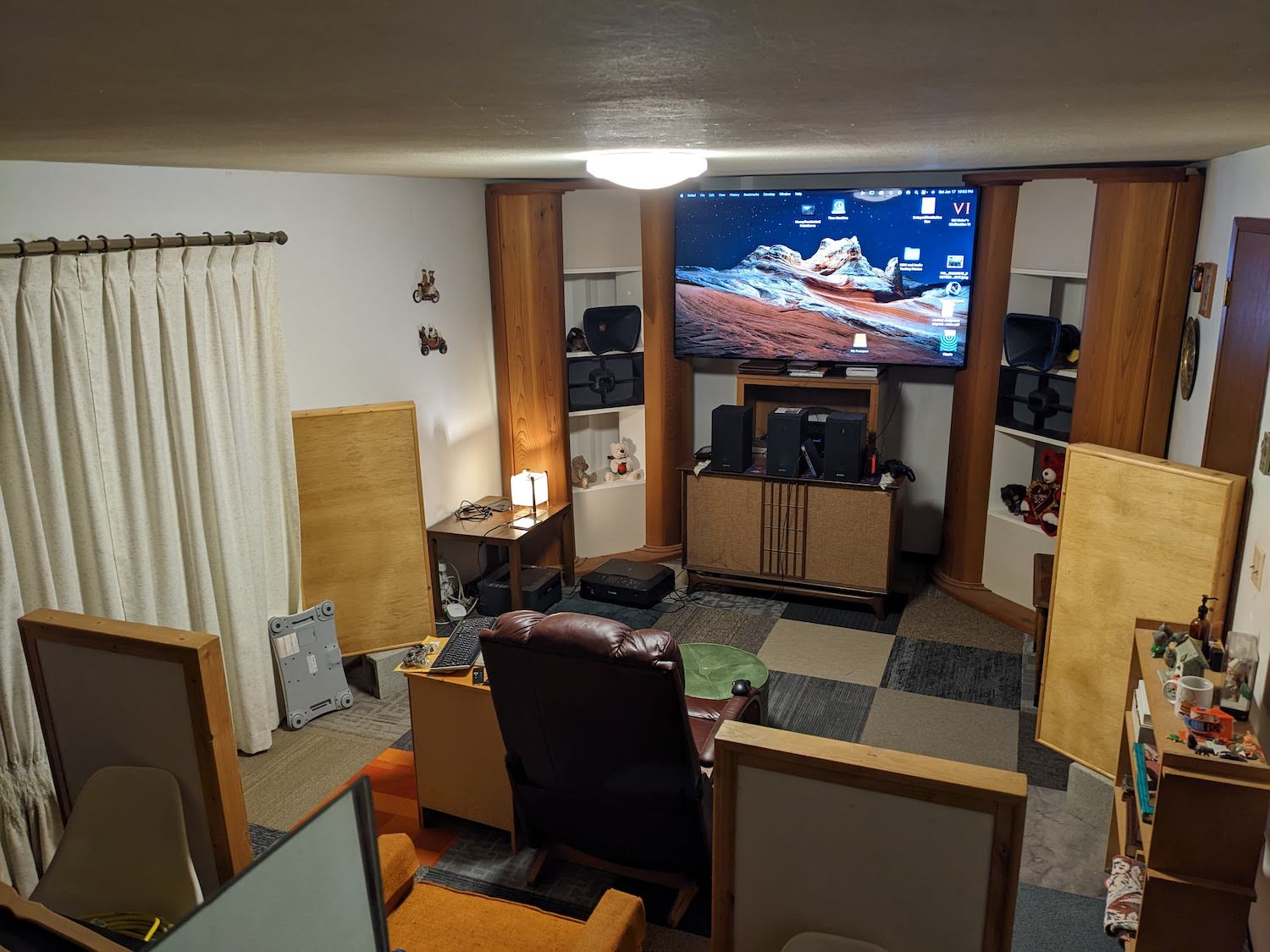

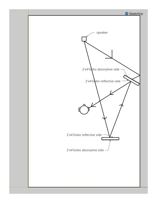

  • Author
12 hours ago, Keith_W said:
You could consider a solution like this
Hi Keith
Funny You suggest that.  I have considered building something like this, not dual layer, but creating small walls to make my room more normal, like a shoe box with four walls, I thought about timber frame with Gyprock, or office divide with Perspex, but timber, not you have me thinking.  Thanks.  Could always build a couple of these, stack them when not in use, and if needed, apply absorption or diffusion where needed.
A leaky room can be a good thing, as I do not have many of the issues a shoe box room has, but creating typical issues that you can hopefully fix is a different way of addressing the problem.  Thanks
i have bought some absorption panels to start with, and moved my speakers back closer to the wall, I will see how I go from there.
FWIW I am in contact with the guy who installed those gobos in his room. He designs acoustic treatment so he's pretty smart ;) If you are interested I could ask him for more details.

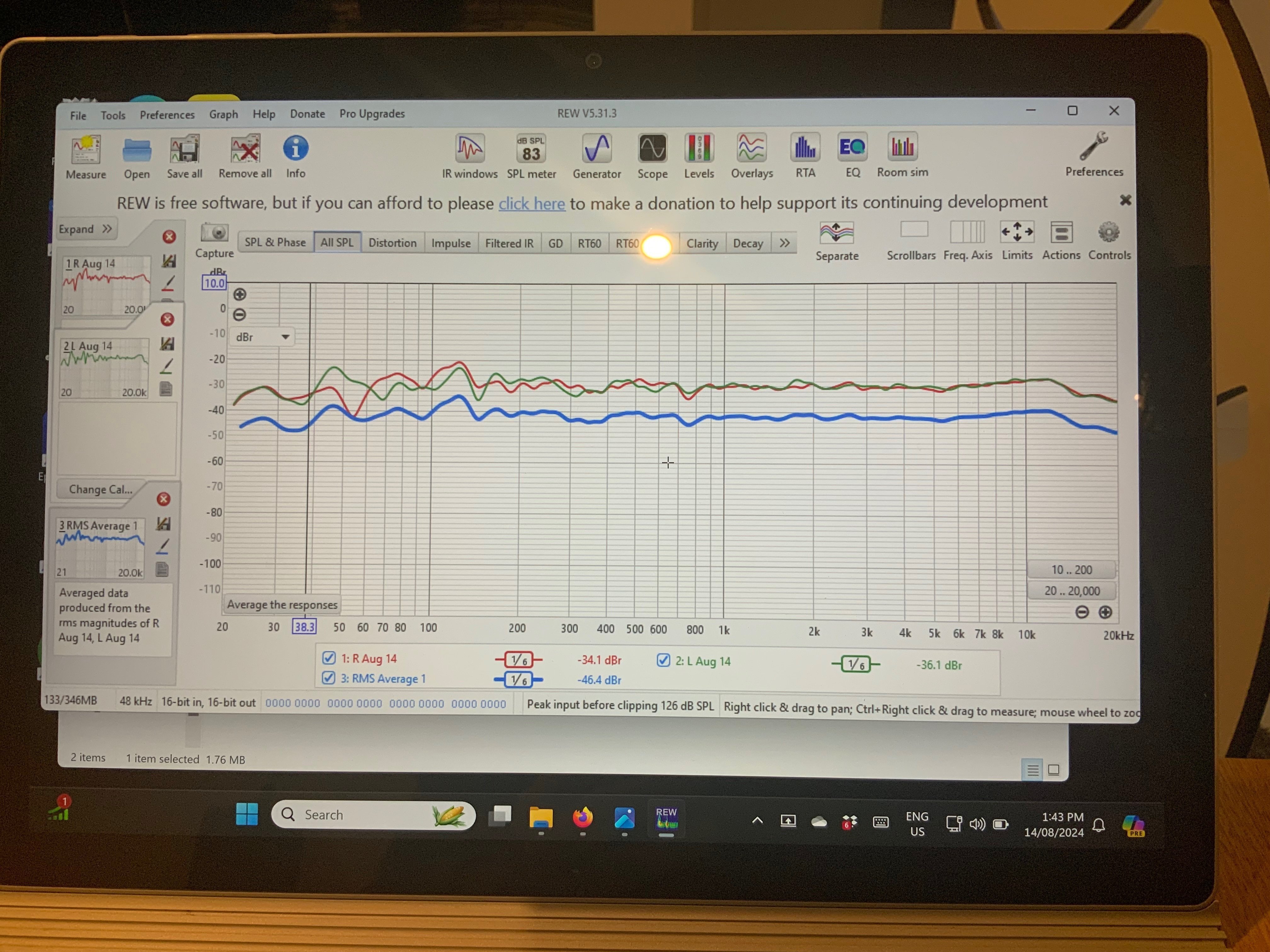

  • Author
Progress report
i have installed six Primacoustic Broadband absorbers (1200x600x50), 4 across the rear wall, and one either side of the listening position.  These panels dropped the midrange and high end 1k to 10k down to about the suggested line in the FR graph @Keith_W shared.  Did I notice any difference in the SQ, not really, maybe everything sounded a little tighter.  I am still very ineffective at interpreting these graphs, but I am pretty sure the decay times reduced as well.
I then installed 2 x Hybrid Panels acting as Diffusers at the first reflection point.  Here there was a noticeable improvement in the SQ = I liked.  However, upon measuring the FR, the midrange and high end basically went back to where it was before, but I really liked the SQ.  So in summary, 6 x absorption panels at the rear and sides reduced the mids and highs, then 2 x Diffusers at the first reflection point placed the mids and highs back to where it was.  Now I am only looking at one or two of the results, but I am a simple man.
what it tells me though is that there could be better places to place the absorbtion panels .  So I am going to play around a bit and Trial placement, see what my ears tell me and compare to the measurements, so some fun to be had.
today, I will move the Diffusers to behind the speakers, and try the absorbers beside the speakers, and then at the 1st reflection point.  I also want to trial absorbtion in the entrance and hallway, I reckon I get more reflection from the entrance then the rear wall.  And then there is the “off limits ceiling”, need I say more.  My walls only cover about 50% or less of my room, so I reckon that most reflections are coming from the ceiling, and or the entrance.
Either way, my SQ in my opinion is pretty bloody good, I just think it can be just a bit better with some minor peaks.

  • Author
14 hours ago, almikel said:
do you have DSP EQ capability
Hi Mike, no room correction for two channel, only HT.  As with subwoofers, it doesn’t mean it is not on the list, just not now.
I am using Keith’s graph as my bass line,  the four panels along the rear wall brought down the response over 1kz, but it remained flat.  And brought the RT60 numbers down as well.  I then installed two diffusion panels at the first reflection point, and it kind of took it back to where it was, but the diffusion panels created a sq that I enjoyed.   Hence why I am playing around.
My gut feeling tells me I might need to look at the ceiling, and or the adjoining tiled echoey entrance and hall way. When I apply a high test tone, the high pitch noice and echoe in the entrance is unbearable, so it has to have some effect n SQ in the listening room.   I will probably try placing a few panels n the reflection points in the entrance and hall way, and see what effects that has.
i am going to move the absorption panels to the first reflection point, and compare to the panels on the back wall.  I have the diffusion panels behind the speakers for now.
my gut feeling tells me I will add some addition diffusion panels to the front wall, and maybe the 1st reflection point, and strategically place absorption panels beside the speakers, on the brick wall and the rear wall, and maybe the entrance
