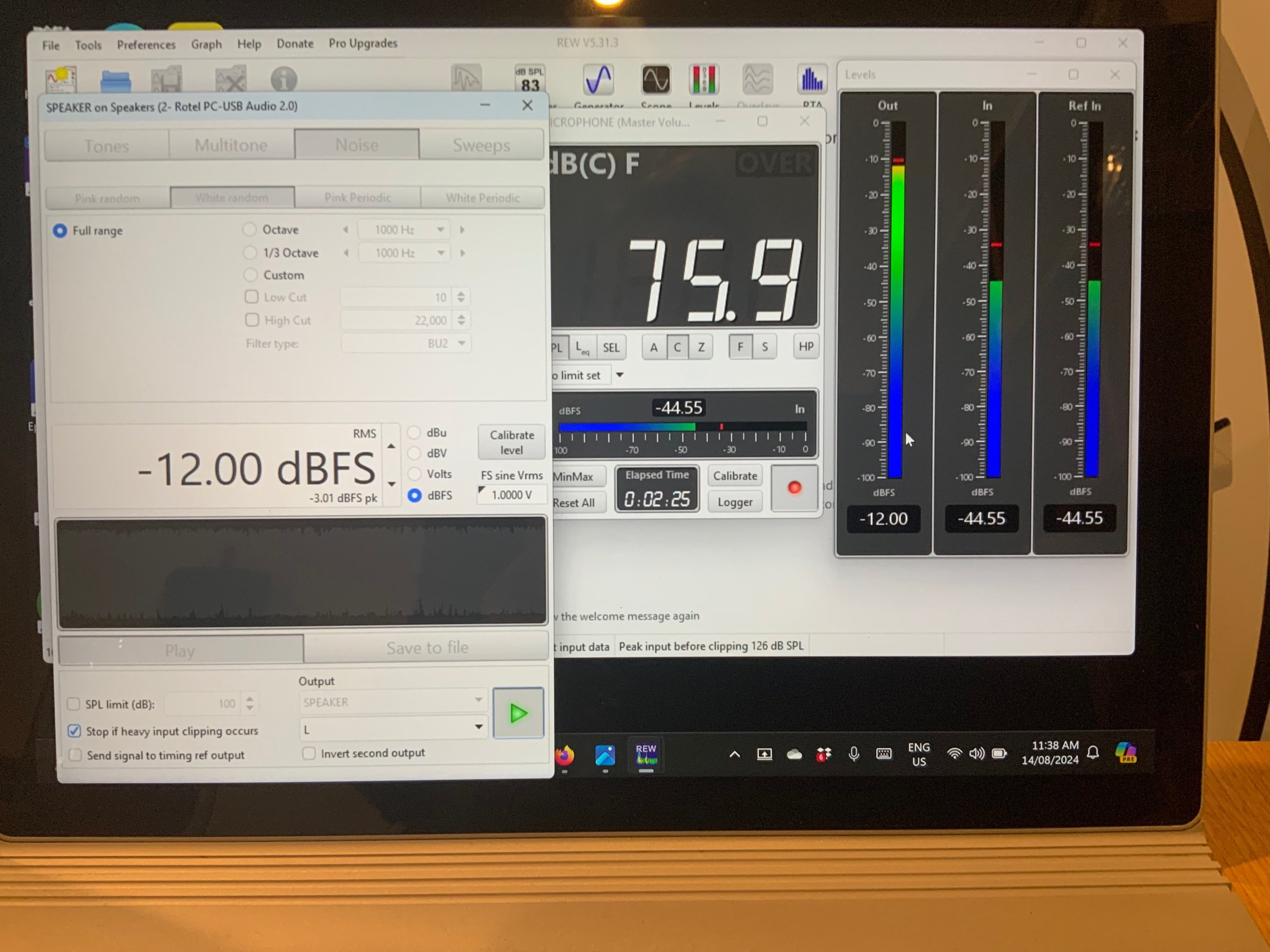

What microphone, are you measuring with?
UMIK-1, UMIK-2 or something else?
Are you using a calibration file?
Are you pointing the microphone at the speakers or up in the air?
What holds the microphone in place?
Just my opinion, but I think for the time being you should ignore the graphs above about 300Hz.
As it has been mentioned, you need to interpret the measurements of different frequencies differently.
Below about 200Hz, there is good correlation between what is measured and what is heard and this is one of the reasons that equalisation is so effective in this region.
But, as we move up in frequency, the correlation is not anywhere as close, so it gets harder and harder to correlate the measurements to what is actually perceived by our brain.
Remembering this, what is measured by the microphone and what is perceived are not the same thing, especially above about 200Hz.
The microphone captures everything, and then everything is stored on the computer.
Ours ears capture everything (well sort of), but our brain doesn't perceive all of it and/or does so differently (psychoacoustics).
Really high frequencies (above about 10kHz) where a speaker typically beams the sound rather than spread it out evenly and where reflections are not as strong, the correlation between measurement and perception is going to be stronger (I think).
This leads me to another question, what are your speakers?
The reason I ask, is if one knows the dispersion characteristics of a speaker, this information should influence positioning in a particular room, somewhat.
Anyway, I think you should concentrate on bass first and if you do change your bass, your perception of mids and highs is going to change (psychoacoustics).
For example, if your bass becomes louder, then you are likely to not turn the volume up as much to get "that" bass and so now without directly changing them, you have actually changed the mids and highs because now there will be less of them.
So, from this new bassline you can then listen again and again taking note.
Just a reminder, when it comes to speaker position, be weary about sacrificing the quality of mids and highs for better bass.
Better bass can be achieved with equalisation.
Edited by Satanica
  • Author
UMIK-1,
yes
up in the air
Small tripod which sits on top of lounge, right about ear height.

Were the measurements performed without subwoofer(s) and without any EQ/Room Correction enganged? Do you currently have a device (AVR, Processor, miniDSP etc.) with EQ/Room Correction (Audyssey, Dirac Live etc) ?
  • Author
Test performed on 2 channel amp.
no sub, no EQ or room correction.
i also have a Denom AVR with Audyssey only used for HT duties, along with the sub.

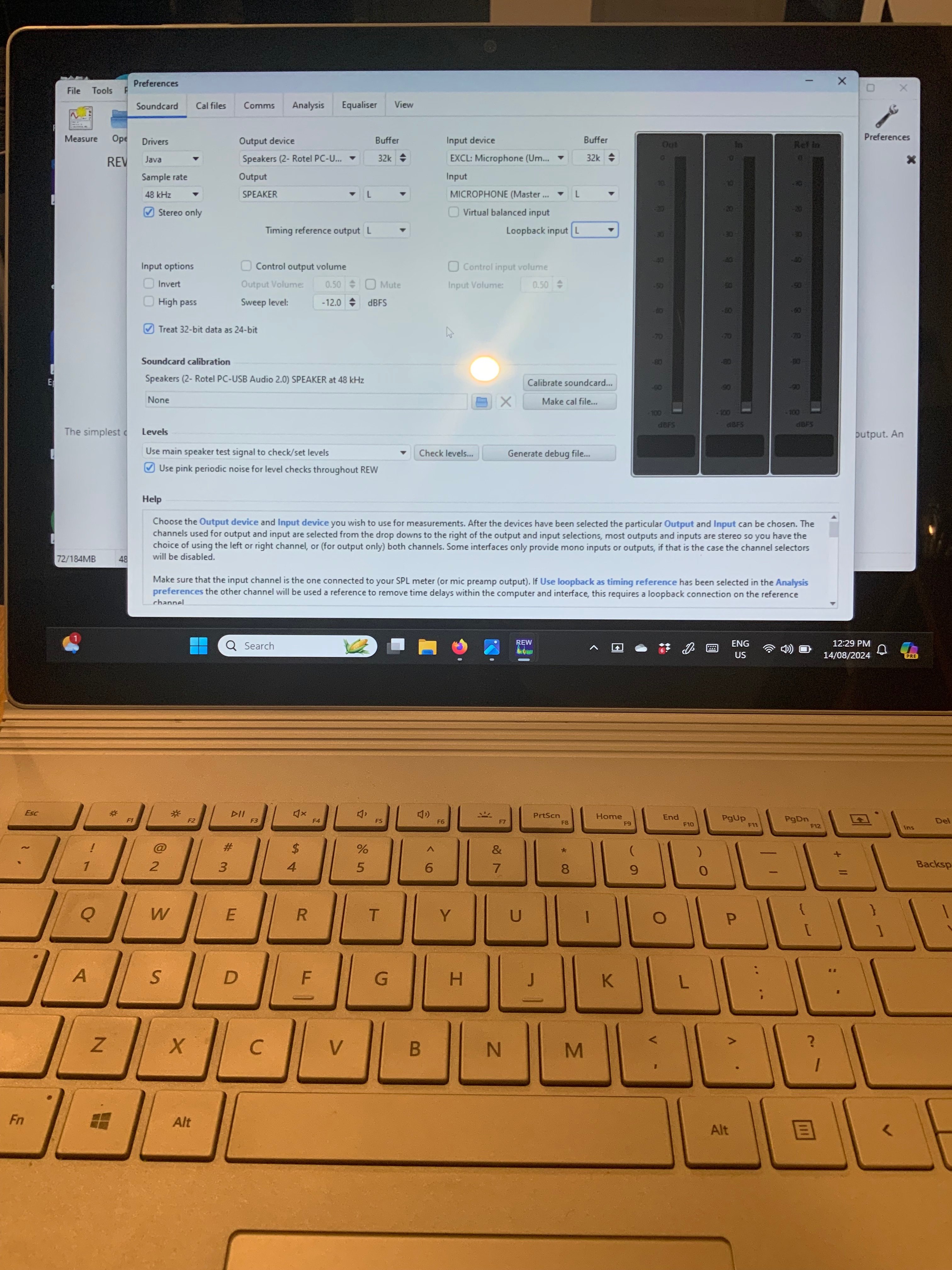

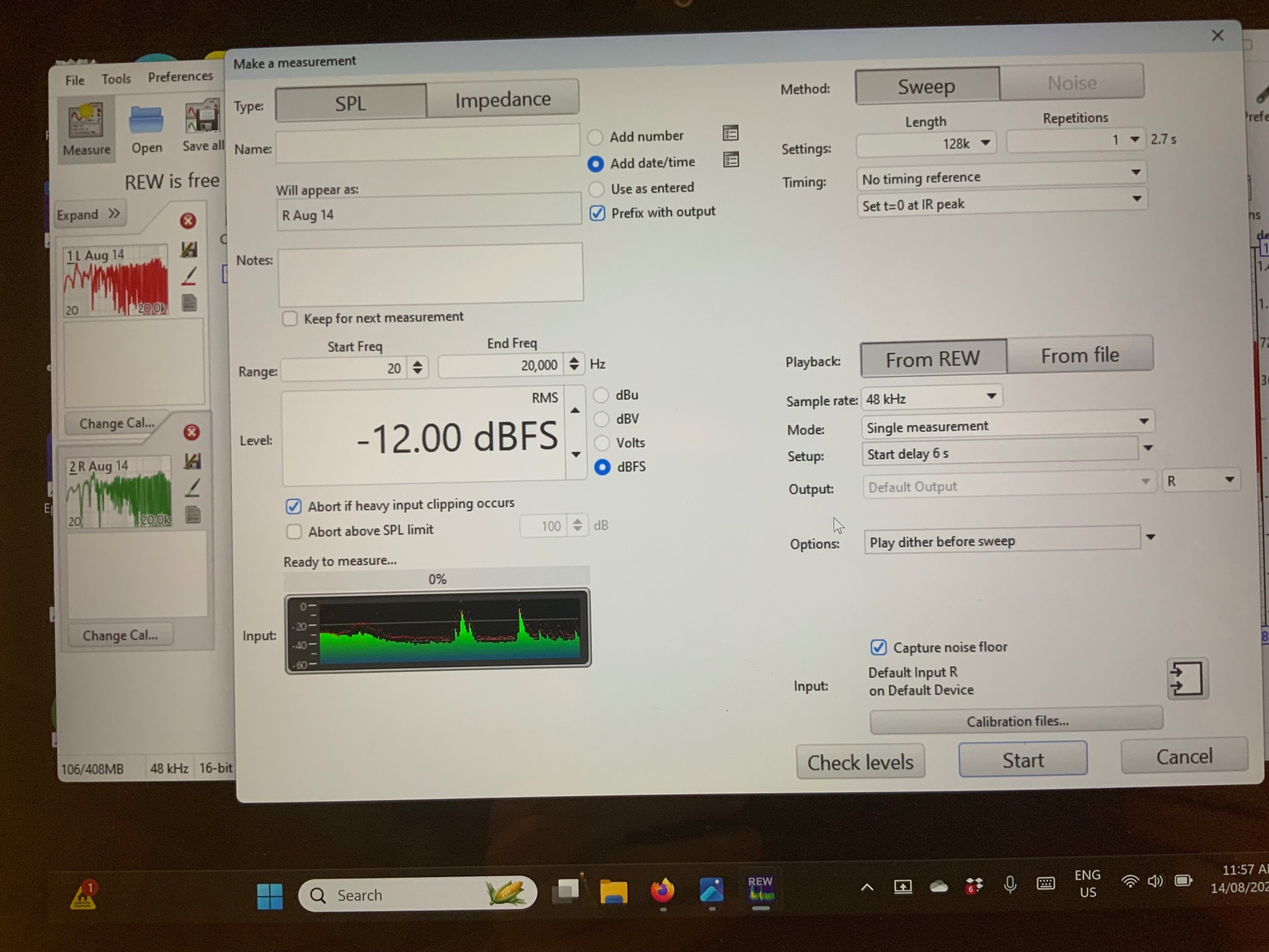

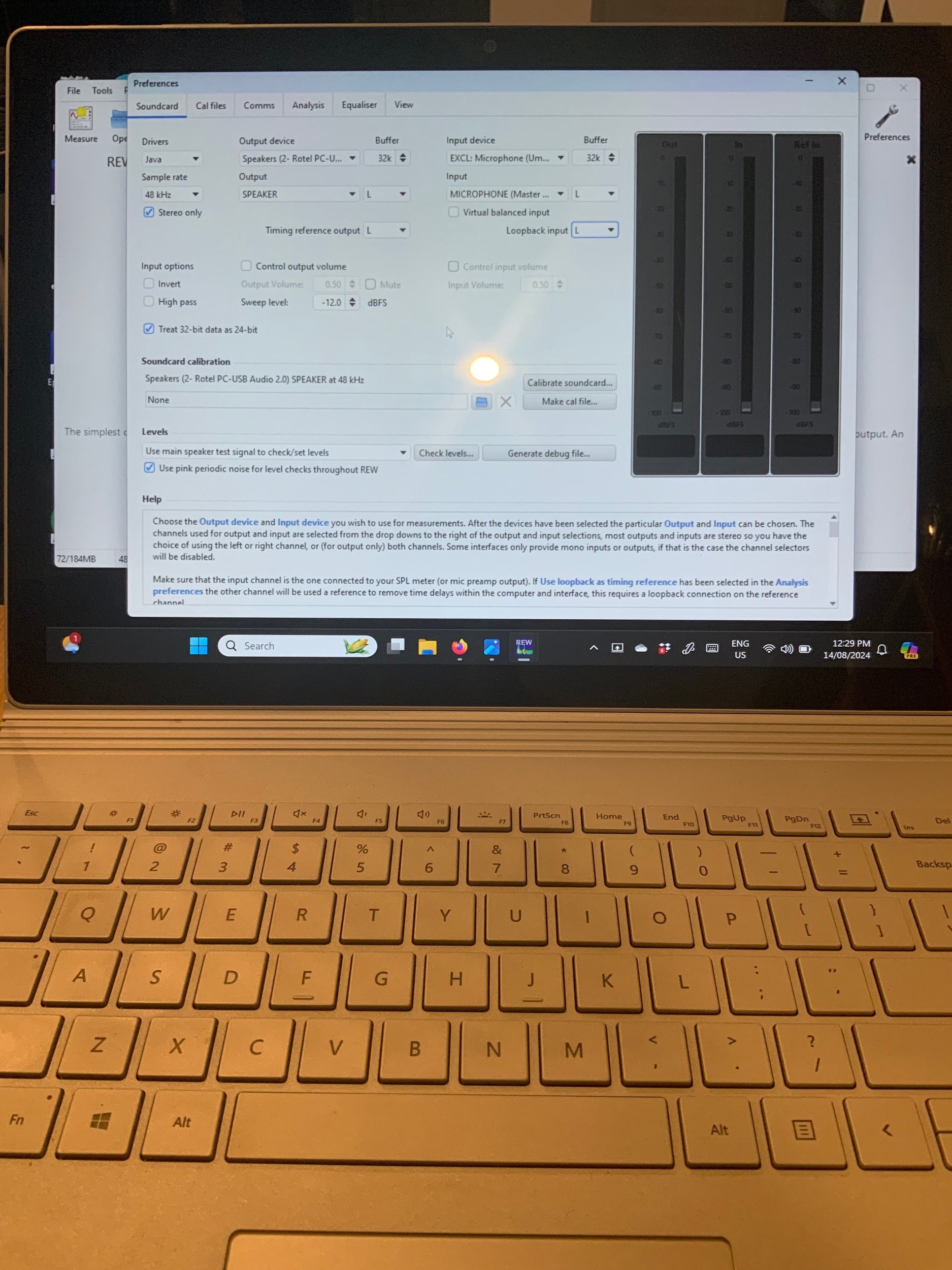

Hi gents
before I take a second measurement, thought I would make sure my settings are correct, can someone guide me through this, or advice if any changes need to be made.  I am assuming that I do not need to calibrate the microphone as I have the calibration file.  I then set up volume etc as per GIK, increase the volume until the meter reads 76DB.
On the preference tab, I am guessing I set everything to either R or L.
is there anything else I need to be aware of or change
It looks OK to me.

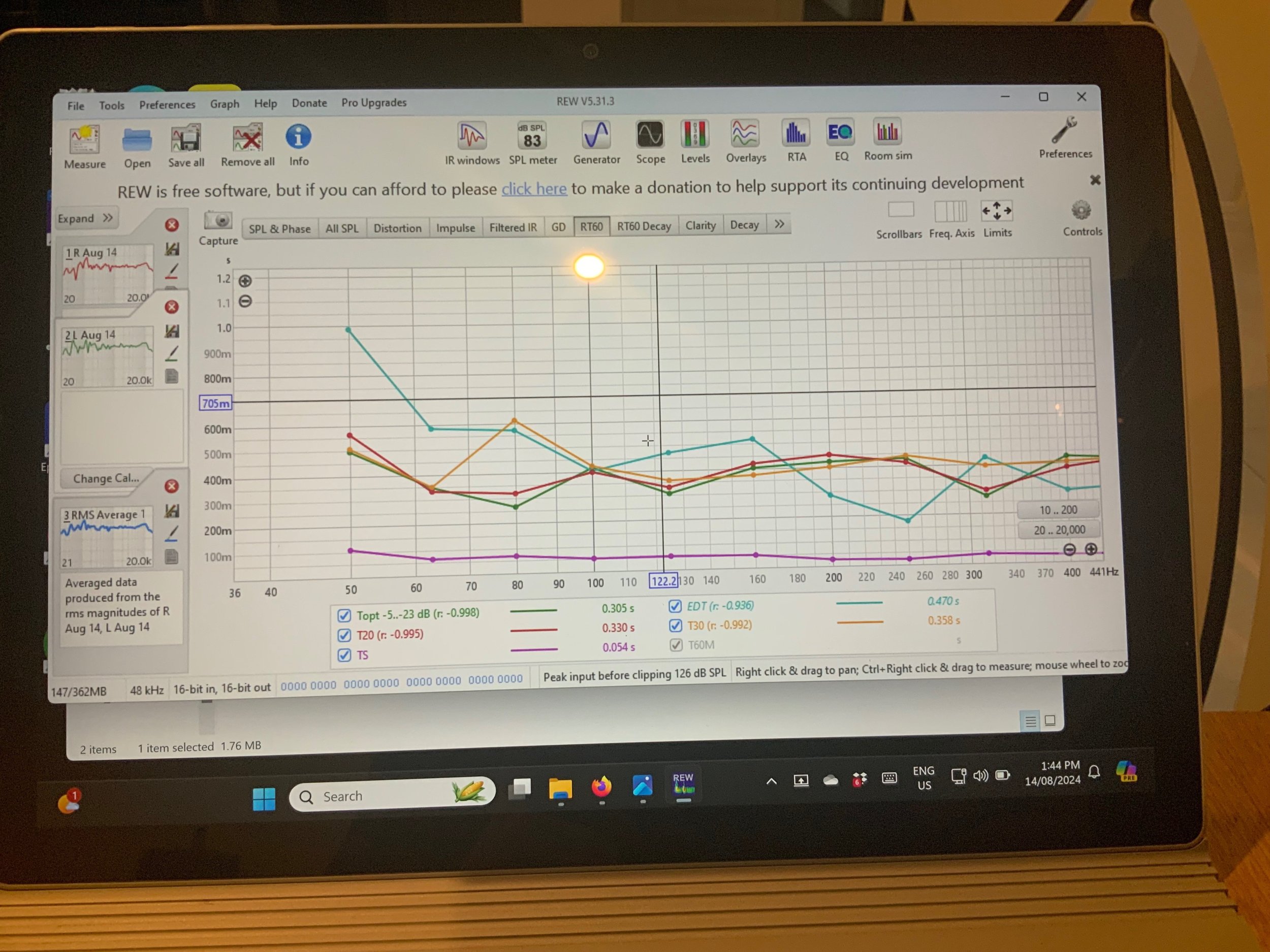

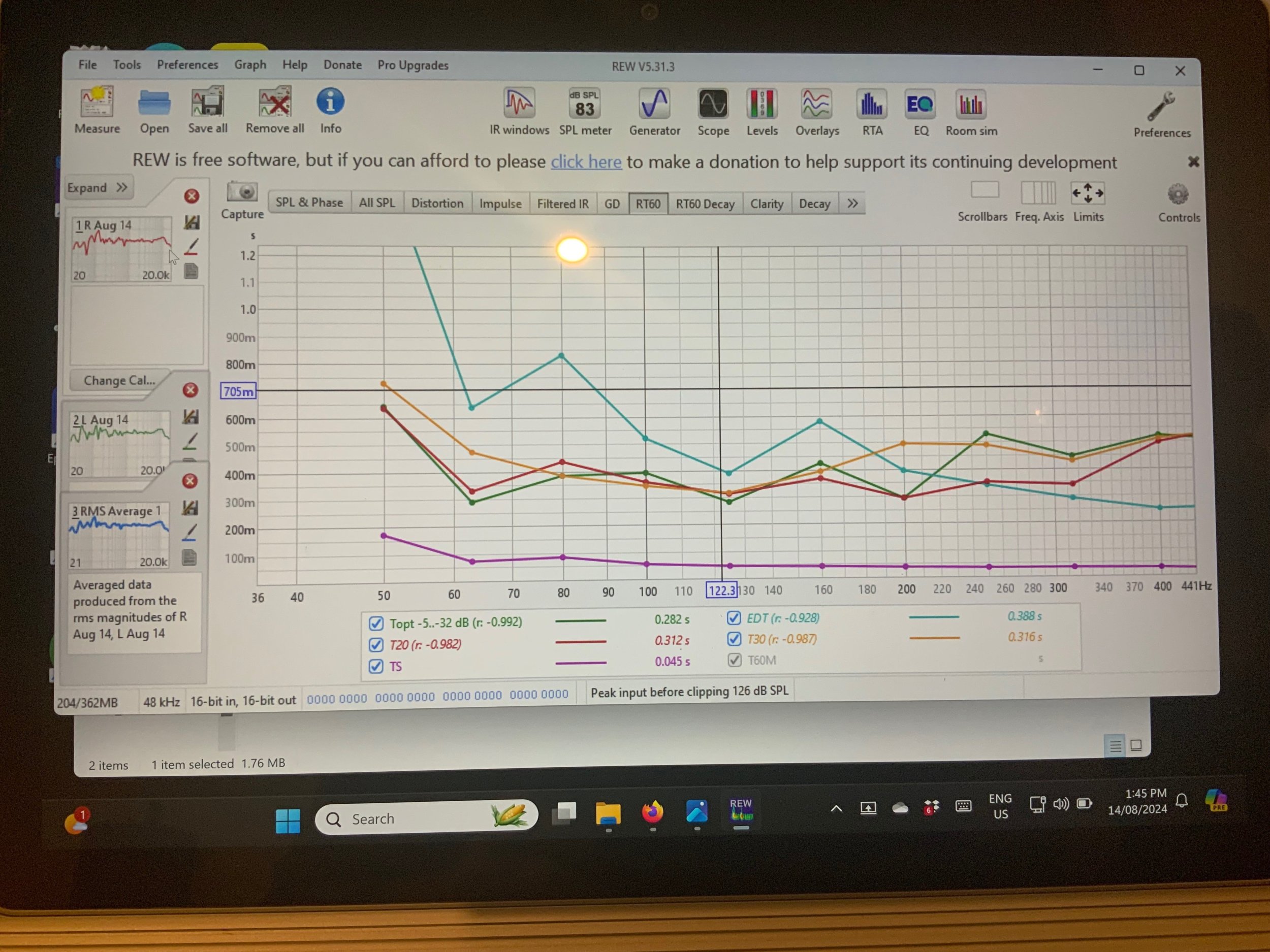

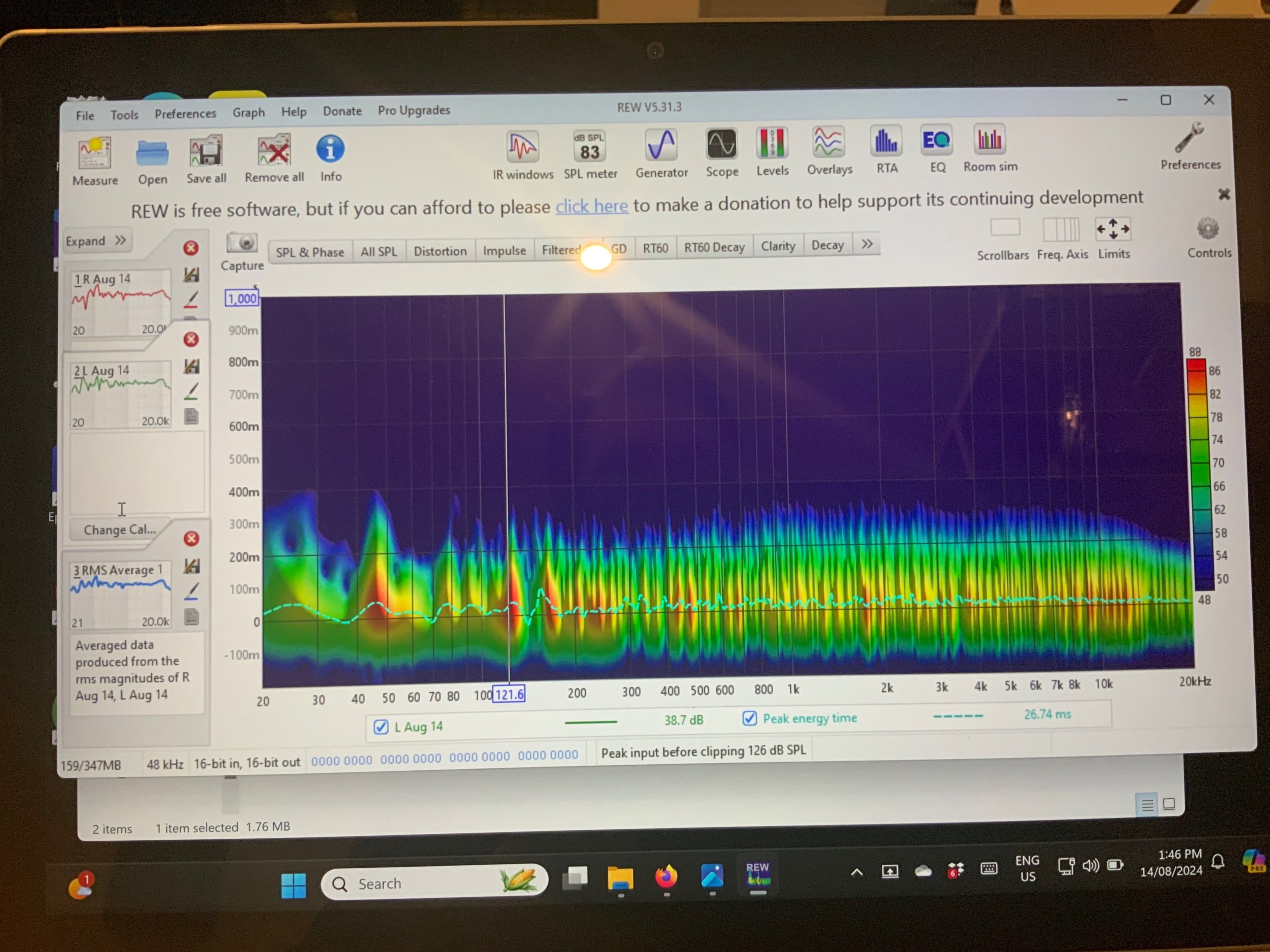

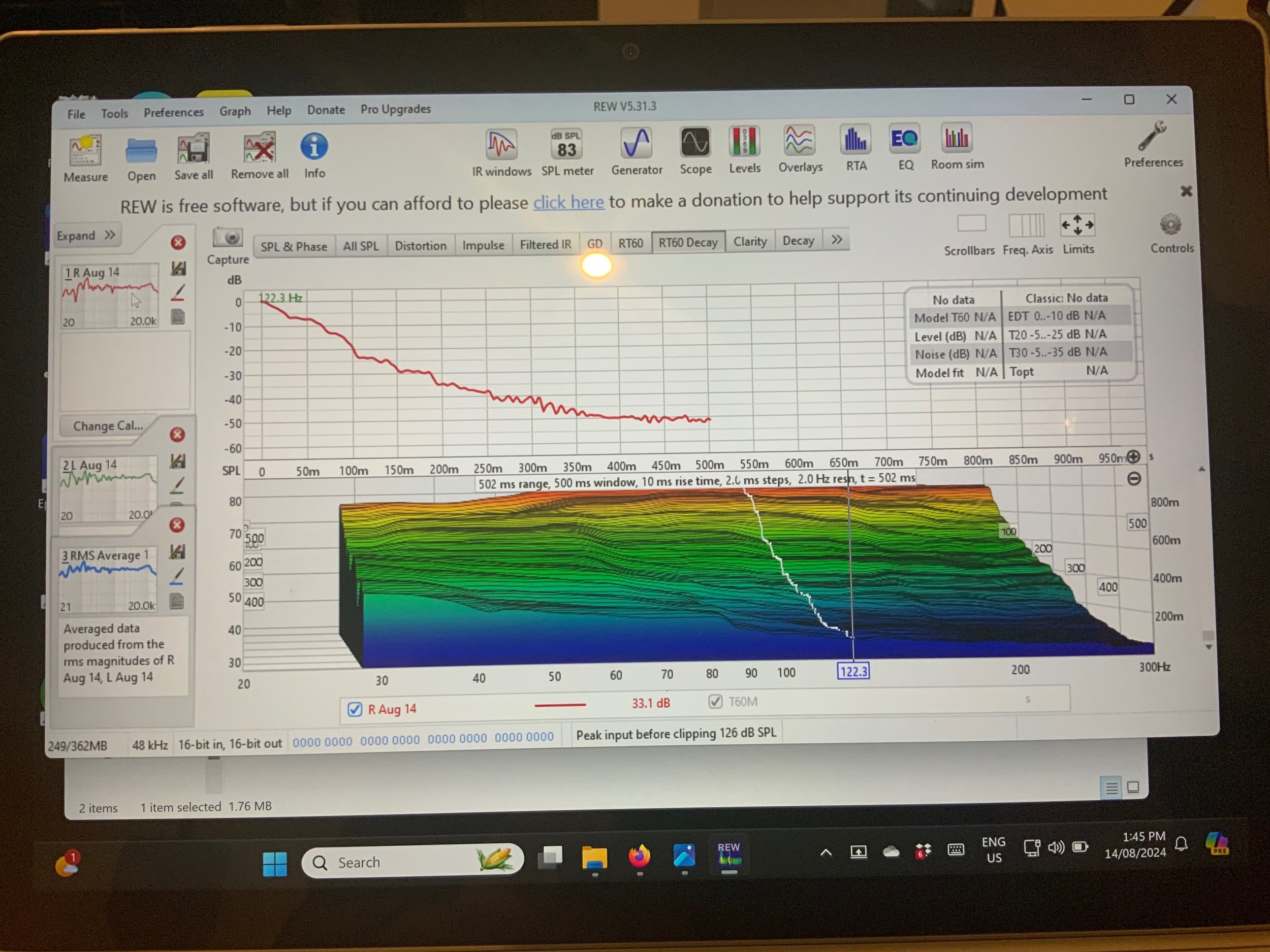

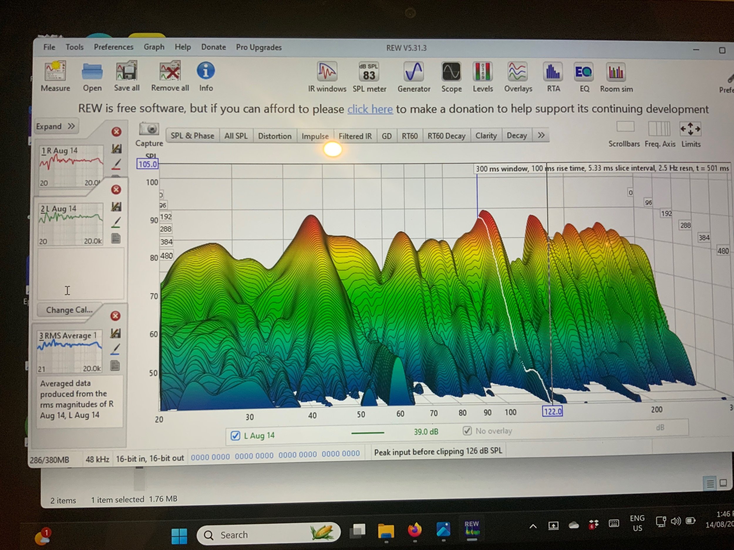

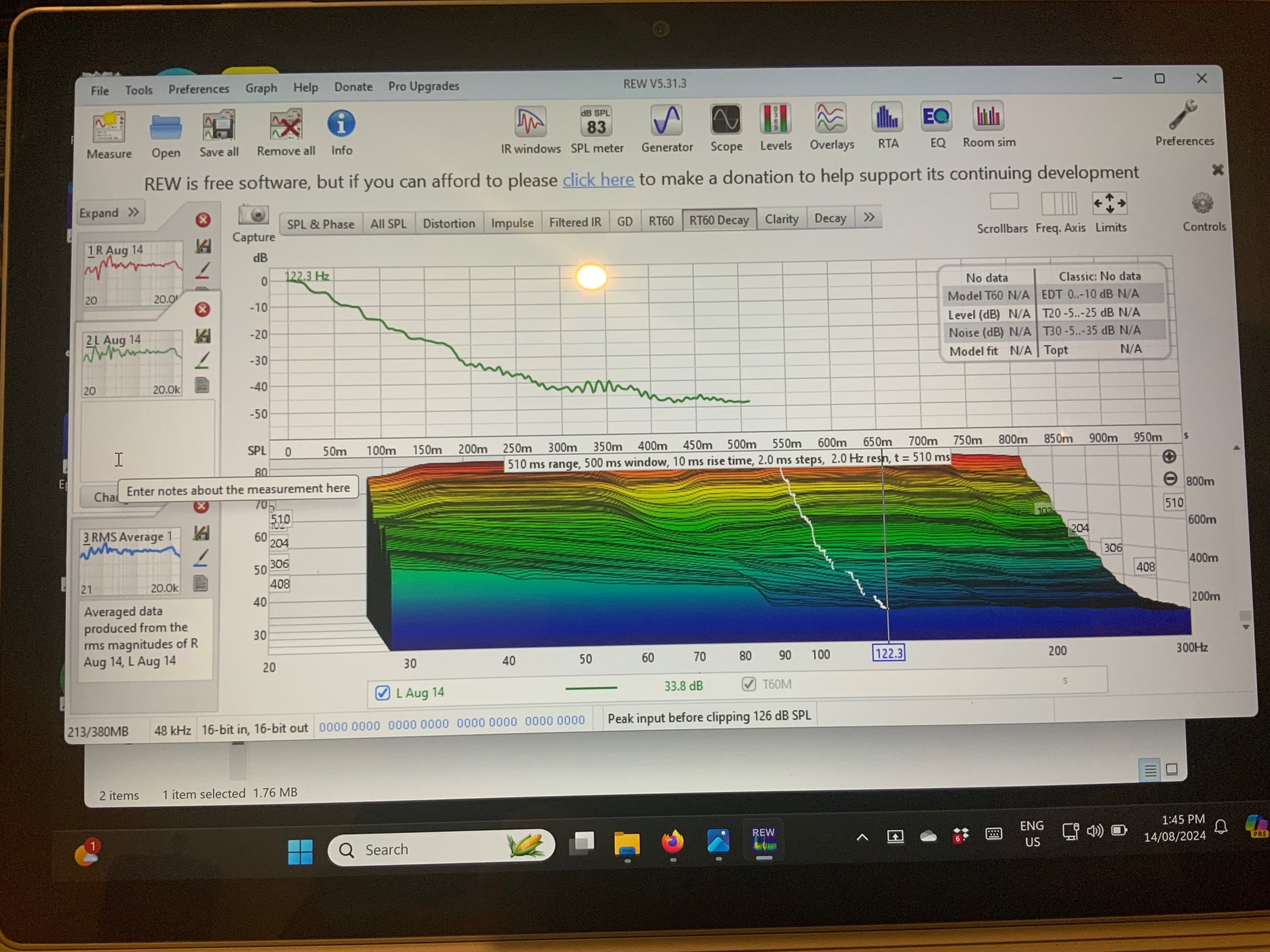

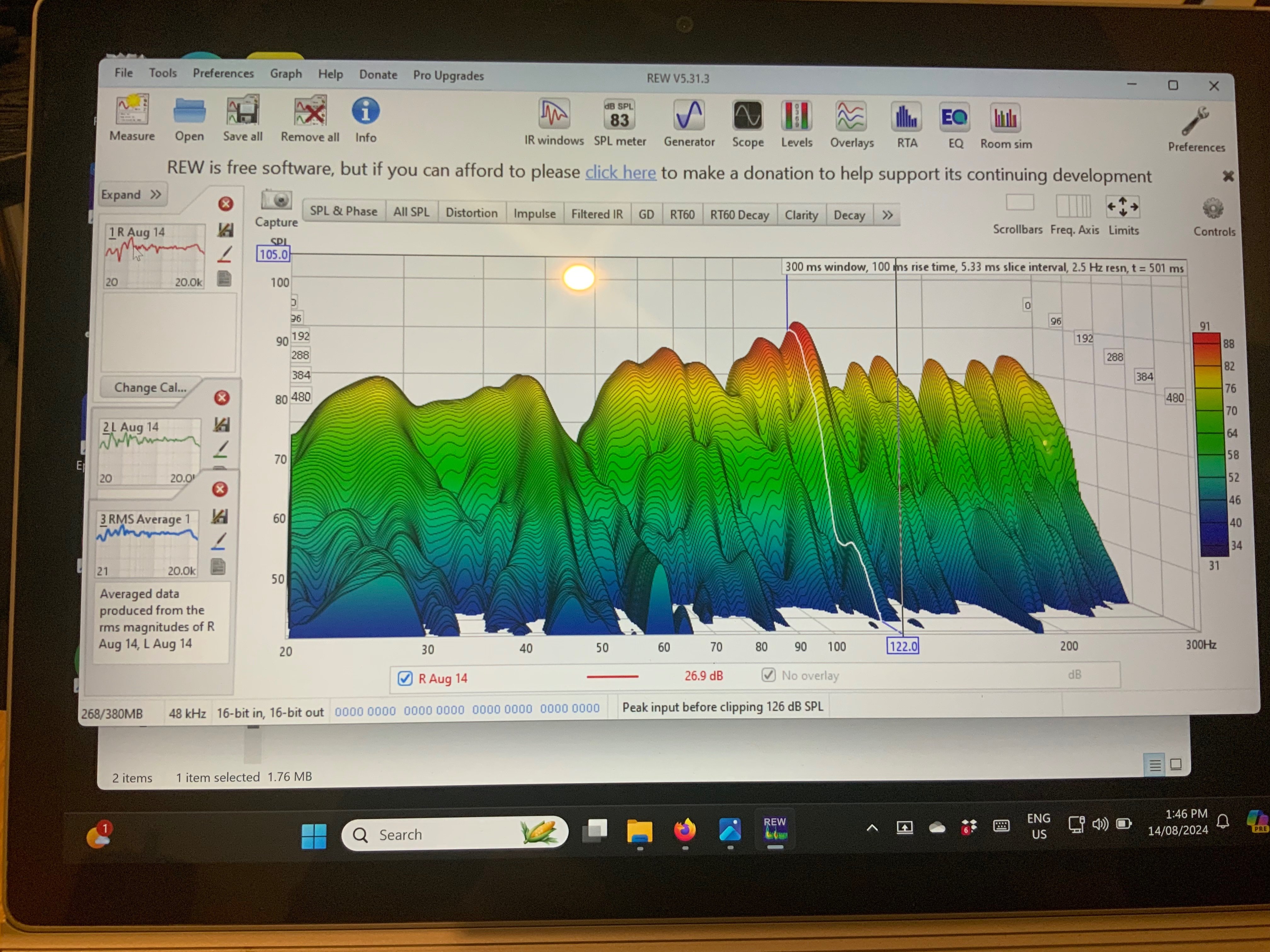

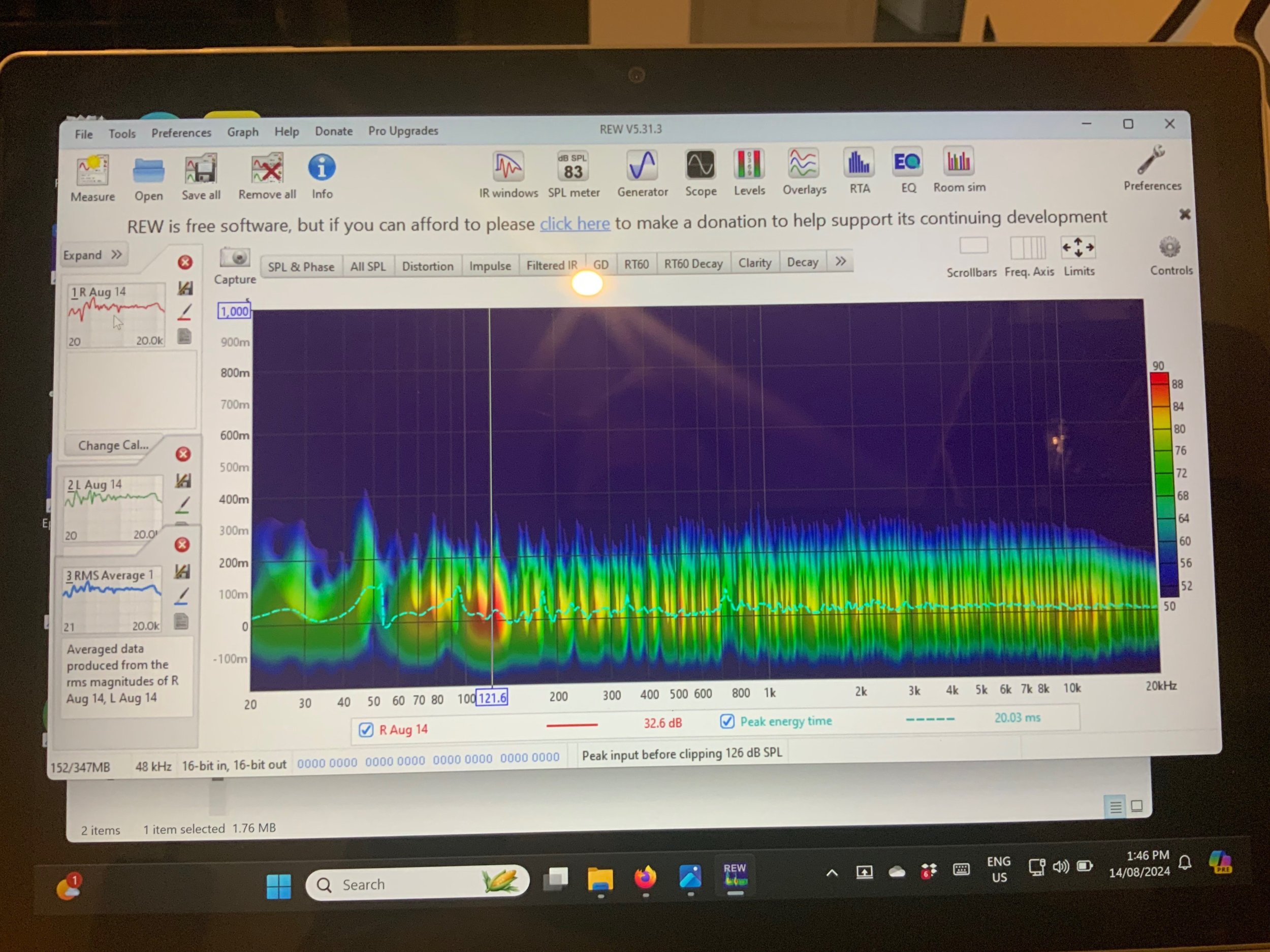

A second set of measurements.
speakers moved back about 35cm, now about 1m off the front wall (front of speaker back to wall) moved the speakers out slightly, as I thought a wider soundstage was possible,  right speaker now 650mm from the short side wall.
speakers are 2.7m apart, 3.1m to the Listening position.
curtains are closed on the left side
bifolds are closed on the rear left side
Edited by JkSpinner
1 hour ago, JkSpinner said:
OK before we begin, here are some pointers.
1. You are on a Windows 11 laptop. Are you aware you can hit the "PrtSc" button to copy what is on your screen to the clipboard? You can click and drag to copy part of a window, or the whole window.
2. Choose sensible zoom levels. By default REW zooms out too much and the graphs become hard to read. It's like taking a photo of your wife when she is standing 100m away. For e.g. this graph is far too zoomed out, so it looks flat. Press the "limits" button, and you can either choose "Fit to data" or manually choose your own limits - in this case I would choose -10dB for the upper limit, and -60dB for the lower limit. Another way to zoom is to Ctrl-right click and drag to draw a box. Click inside the box and it will zoom.
3. What question are you asking? If you are comparing your left vs. right speaker, then show a graph with your left/right speaker on "All SPL" as you have done. But if you are asking what is the difference between "before" and "after", load the curve with "before", and load the graph with "after". Adjust the two curves so that they overlap, and then post that. Clearly label which is before and which is after.
It would be better to post the REW .MDAT file. SNA won't let you do that, so I suggest you upload it to a Google drive or Dropbox account and post the link to the .MDAT.
If you want, you can PM me and we can have a chat on WhatsApp and I can guide you through the settings.
Edited by Keith_W

what am I asking - Good question.  I posted my initial results several days ago, and several responded that I am lacking bass.  I had recently moved my speakers closer to the listening position, and did notice the reduction in base, so after the initial test results and comments, I moved the speakers back closer to the front wall, and out a little closer to the side wall.  @Satanica suggested some would like to see these results, so I posted the results.  So not really comparing right to left, although the results for right to left differ, more comparing the results comparing this test to the initial measure at the start of this post, seeing if moving the speakers back towards the front wall made a measurable difference.
The left and right comparison, that is another question, and I think I need to create some sort of symmetry (such as creating first reflection points) before comparing this.
