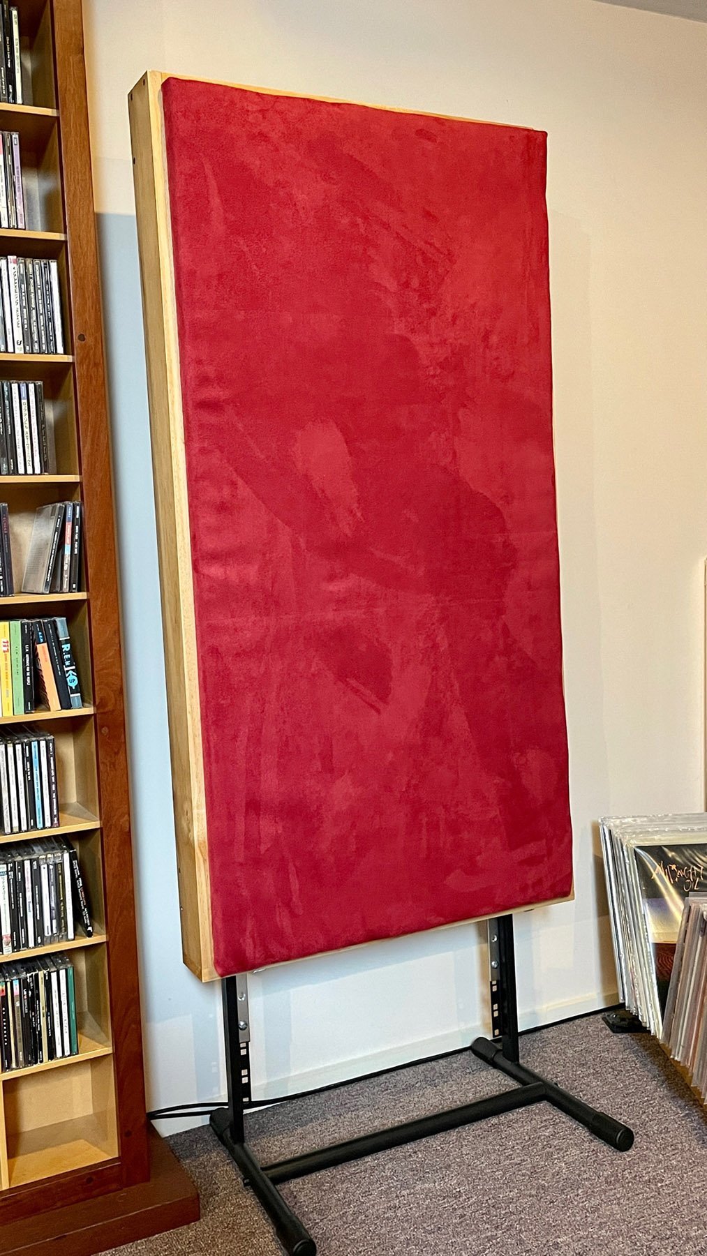

Don't need to hang on the wall - make some free standing movable panels.
This allows variable gap from wall to increase frequency absorption coeffients, as well as not marking the wall along with benefit of being movable should you need to reposition speakers.
These are made with same Martini Absorb HD 100

On 29/11/2024 at 8:26 PM, basscleaner said:
I didn't find any info about absorption coefficients depends from frequency.
Not too hard to find - http://www.csrmartini.com.au/wp-content/uploads/2024/08/Martini-DataSheet-Absorb_0824.pdf
Moreover, very doubtful, that it may work as bass trap.
OP is not using panel as a bass trap - using as a 1st reflection panel
