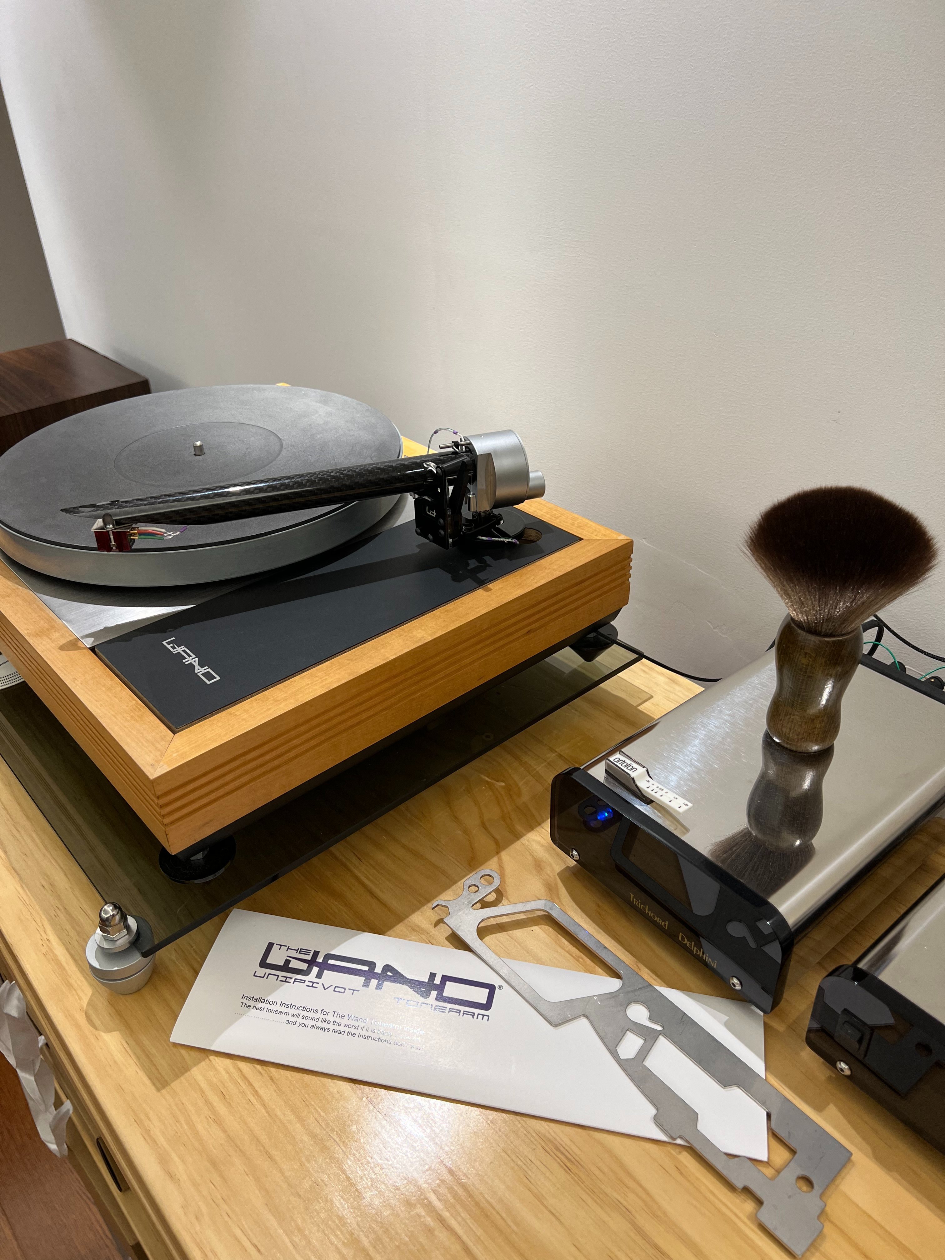

SONDEKNZ Posted May 12, 2024 Posted May 12, 2024 (edited) On 01/04/2024 at 11:50 PM, mattd2308 said: Hi all, am requesting what are best Tonearms up to $2.5k. Looking at purchasing my final TT up to $7-8K (one day at least!!) I notice most TT's around this price range don't have tonearms. Have venerable RB330 on my RP3. Views on brands, such as Origin Live, Sorane, Pro-ject (have new range) in 9". Still a novice in this field. Kuzma, SME etc would be lovely, however, well over budget. Thanks Expand You will - no doubt - already know that money invested in a better turntable will return bigger sonic gains, than money invested in a better tonearm or cartridge. With that in mind, if you are still keen to try a new tonearm - fair enough! I recommend you find your way to DESIGN BUILD LISTEN and take a look at the WAND PLUS 9.5". DESIGN BUILD LISTEN - Home of the WAND tonearms and turntables The WAND has won numerous design awards and accolades; and is priced very competitively... Even the late lamented ART DUDLEY loved the sound of the WAND he tested! There is a WAND OWNERS thread here on SN, full of good info too. STEREONET WAND OWNERS THREAD The WAND sounds incredible - and best of all, can travel with you when you eventually buy a better turntable. It will fit almost any table including REGAs, LINNs, THORENS, TECHNICS, etc. We replaced a perfectly good LINN Ittok on our hot-rodded LP12 and were simply stunned at the sound quality improvement. At the first needle-drop, my wife and I had a weird "snap" moment - and murmured exactly the same word at the same time... "Effortless!" Don't settle for less! Edited May 12, 2024 by SONDEKNZ
