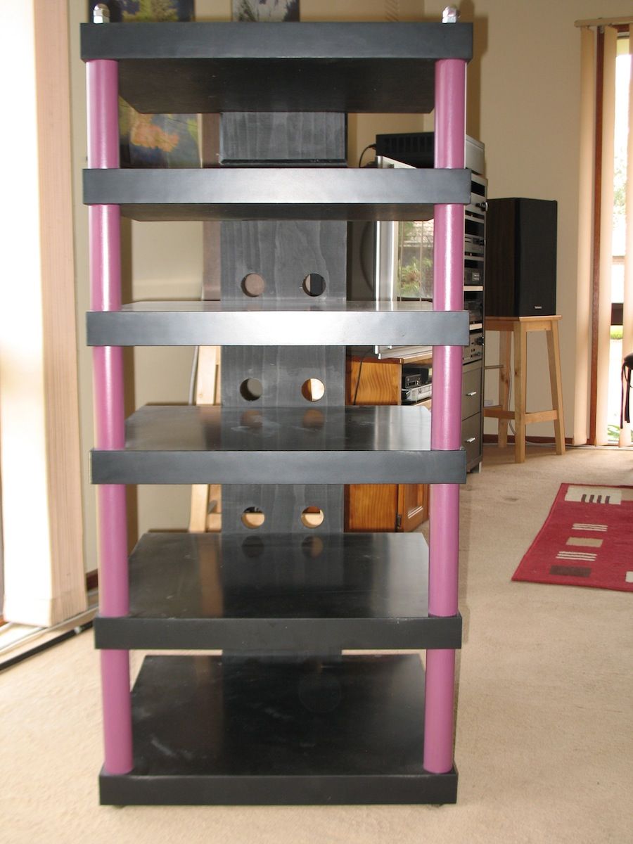

kczar01 Posted November 20, 2013 Posted November 20, 2013 So it has come time that I would like to build a rack and I have been granted permission to not buy a Quadraspire rack and to build one instead. The ikea cube will stay and move to the back of the room with an add on for more record storage. I quite like the look of the rack, and have a couple of ideas to do it. Any recommendations on on the shelf sizes between the tables? It will go onto floor boards not sure how to ground the bottom level Was wondering if anybody had done one?? Would like it to turn out similar below. this is the size i will use. http://www.ikea.com/au/en/catalog/products/50161665/
henry218 Posted November 20, 2013 Posted November 20, 2013 are they really good for hifi rack? its very light, i have few for the side tables.
harry_mr Posted November 20, 2013 Posted November 20, 2013 I think they are about half the standard leg size, these legs are hollow inside so just remember this when you cut them down. I nearly went down the lack track but ended up buying a secondand rack on here, althought I still might do it in another room. There is the smaller lack side table too, plenty of pictures of racks made from these cheap alternatives. Good luck.
ThirdDrawerDown Posted November 20, 2013 Posted November 20, 2013 A friend did this build recently (photos below) The hollow core of the Lack legs he handled by replacing them - buying thick dowel, drilling one hole through everything and binding the lot with steel rod. The square Lack is an almost ideal construction - materials, design, dimensions - for a vibration-free turntable stand. I think the hollow legs are part of the value, so it might be worth researching ways that Ikea hackers have shortened the Lack legs. When modding hollow-cored doors I've simply cut blocks of wood to suit and glued them into the modded door. If doing the same to Lack legs I'd hunt down some Titebond glue (from Masters, specialty shops). My friend has since moved on to something similar to your design. And we've been discussing a design equivalent to your design for me, the discussion cut short when I sourced some 2" thick pine. I'm looking at something similar to Thomo's design here, but with spikes on the feet of every leg. Links to inexpensive spikes are found in the recent spikes threads. As for height, your stereo gear is quite possibly in multiples of 1.75 inches high, and this might guide the purist in designing a rack: Quote Understanding the “U†in Portable RacksThe width and height of rackmountable equipment is standardized in the audio industry. At the core of this standard is the rack space, or unit. One rack space is defined as 1.75″ from top to bottom and 19″ in width. Rack Space — Top to BottomRack equipment that is 1.75″ high or some multiple of that conforms to the standard. Equipment height is often measured in rack units, where one unit (1U) is 1.75″, 2U is 3.5″, and so on. Racks are built with holes in their rack rails which correspond to this spacing, allowing for equipment of any unit height to be mounted. If you’re building your own rack, you can purchase rack rails of almost any height. If you’re not sure how many rack spaces your gear will need, you can use a rack ruler, which is a measuring tape that features rack unit intervals as well as inches. Rack Space — Left to RightFrom left to right, rack spaces are 19″ wide. Some gear is described as half-rack or third-rack. These sizes allow for multiple pieces of gear to fit in a single rack space (two half-rack units or three third-rack units fit left to right into a rack respectively). Quote Audio Rack HeightAudio rack height is measured in "rack space units", designated as "U" for unit, or "RU" for "rack unit. A single rack space is the equivalent of 1.75-inches (1U), with larger units conforming to the height standard with higher numerical "U" designations in multiples of 1.75-inches. Industry veterans often refer to the height of rack gear simply by the number of rack spaces rather than the "U" abbreviation -- "three rack spaces" for example, for the equivalent of "3U" or 5.25-inches. 2

ArthurDent Posted November 20, 2013 Posted November 20, 2013 (edited) On 20/11/2013 at 1:51 PM, ThirdDrawerDown said: The square Lack is an almost ideal construction - materials, design, dimensions - for a vibration-free turntable stand. I think the hollow legs are part of the value, so it might be worth researching ways that Ikea hackers have shortened the Lack legs. When modding hollow-cored doors I've simply cut blocks of wood to suit and glued them into the modded door. If doing the same to Lack legs I'd hunt down some Titebond glue (from Masters, specialty shops). It's an ideal size with 455mm between the legs fitting most gear. And yes, keeping the legs and filling just the bottoms with glued in wooden blocks seems to be the preferred method. Good price too at $10-$20 and an amazing range of colours at the moment. Using a nice red one under my turntable with the phono pre tucked in underneath. Edited November 20, 2013 by KenTripp
