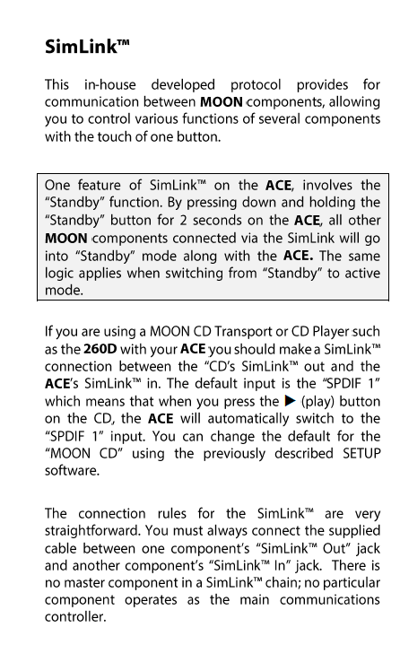

Worked as expected for the Elektra, not the Moon. I'll take a deep dive into the Moon manual and see if there is something to programme... there doesn't appear to be anything in the setup menu.
My Elektra has a reasonably loud pop on start up and switch off of 1 channel only, and a faint hum through the speaker audible up close when nothing is playing. I've tried a different RCA lead liberally coated in de-oxit, but no joy. The previous owner had no issues but had always used XLR connections whereas I'm restricted to RCA.  I hate to say it, but it's off to Arthur to have a look under the bonnet once the initial honeymoon of having a functioning system wears off. I hope he will work on it in a timely fashion
Hmmm. Nothing of any use in the manual and yeah doesn't sound like there's anything in the menu system either.
This reads word for word the same as my Mark Levinson stuff (which I think they call ML Link). But those jacks definitely work from an external trigger too on mine.  Stating the obvious surely, but you definitely plugged into your SimLink In port yeah?

@Marc no luck but there is a silver lining. I've discovered that the Moon has a faulty IR receiver, it won't accept any presses of the remote at all now, but the remote is working. Luckily Moon have a 10 Year warranty. I'm going on a bit of a road trip soon so it will be the perfect opportunity to get the Moon and Elektra sorted without being frustrated by a non functioning room.
Another long shot, but was the IR only not working while you had a trigger wire connected?
Try disconnecting it and see if the remote works again. A long shot, as I said, but I'd be fascinated if that's the case.
If it's not just a straightforward trigger, then it is possible that the "MoonLink" does disable the IR receiver as part of a "control" system.

I know this is an old topic, but the problem still hasn’t been solved up to this point. If someone owns a Moon device with only a Simlink input and would like to use their own trigger (12V or even from 3.3 to 12V), a fully isolated adapter has been created that enables communication from a regular trigger to Simlink. Here you can check details -> https://matway-electronics.pl/pl/p/Trigger-adapter/219
