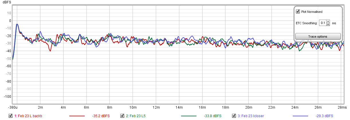

On 16/02/2023 at 1:56 PM, davewantsmoore said:
Can the LP be out from the wall?
Can you do a specrtrogram with the mic out another 1.5m vs where it is now?
didnt do 1.5 m out from current as that would be 2m from wall behind speakers and they are 3.2m apart but did do forward a bit and behind a bit. Which do you like the best?

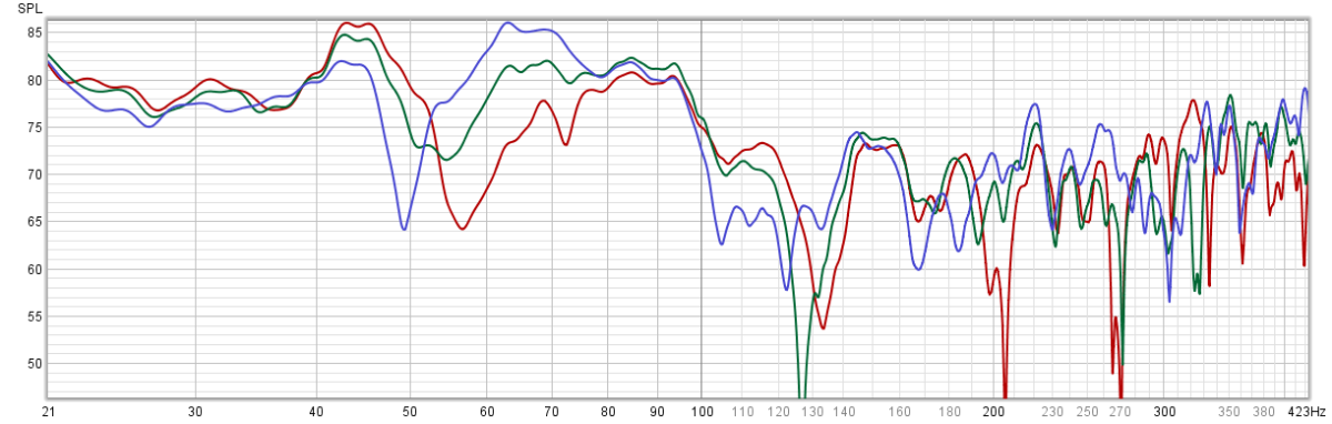

Frequency responses don't show you useful information.
ETC, decay, specrogram.    Ideally with corrected ("nomrmalised") frequency response.... so then you can really see the difference between "treatment A" and "treatment B" when a similar SPL is delivered.

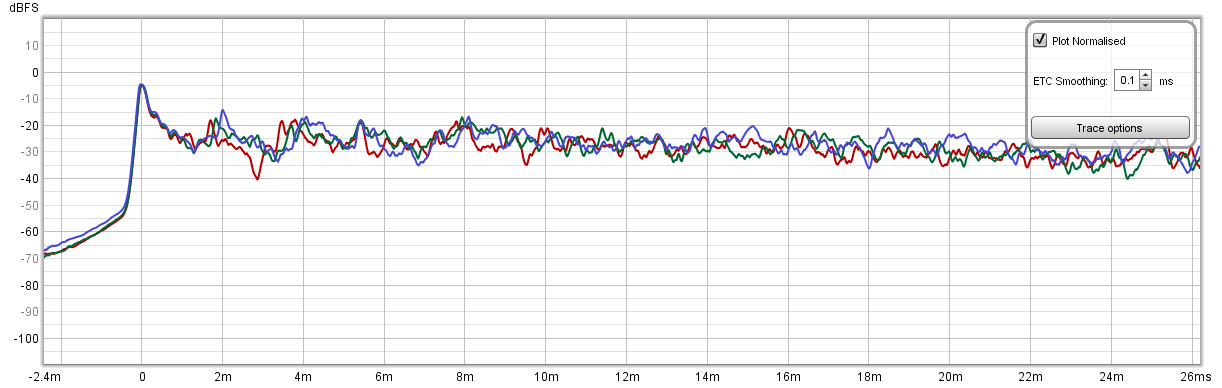

Err, sorry, didnt pay enough attention

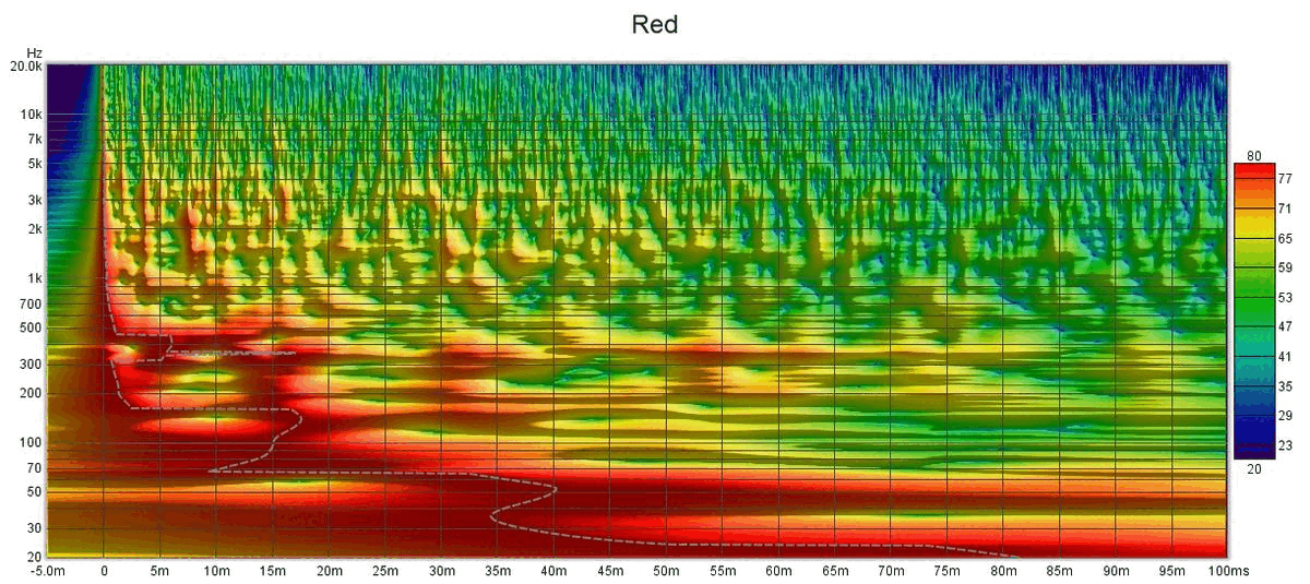

how about these
ETC
spectrogram
hard to say.

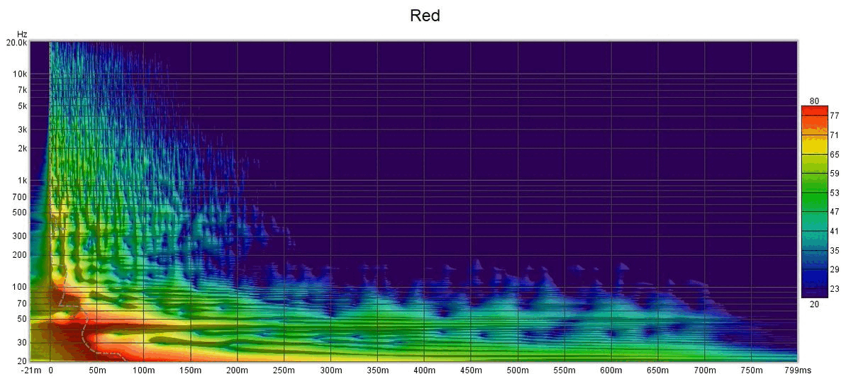

13 hours ago, frednork said:
spectrogram
Tick normalise to peak at each frequency (?)
Show 100ms.
  • Author
12 hours ago, davewantsmoore said:
hard to say.
Show 100ms.
Sure!
I think use a 100ms window @frednorkand a longer time axis to suit.
It's out of blue and green for me... but I'd really want to be looking at this measurement with an actually corrected (as opposed to normalised) SPL.
Which is which?  😁
  • Author
Before I reveal would you mind explaining why the red is least preferred?
I’ll take Red please.
the high spl in the other two is smeared over greater time delay (reverb) for both low and mid frequencies.
With the Red spectrogram setup you could further target narrower frequency bands with additional room treatment for mid-frequencies and possibly additional subs to even-out low frequencies. Then, depending on results,  DSP can be used to fine-tune the remaining peaks if required.
I'm only looking in the 200 to 600 ish Hz range.... and seeing more energy fall inside what a "dirac" specragram envelope looks like .... and more engery after 25ms ..... ie. there is less energy between the edge of the dirac envelope and ~25ms.    Because we want the direct sound, then a ~25ms gap, then the reflected sound.

I have been looking at that spectrogram for the last 10 minutes and going to myself I have no idea what he is looking at but then suddenly I saw it. Eureka! So indeed the red one follows that dirac shape less so than the other 2. Would love to see a real life  version of this , ie how good can it get IRL?
So the big reveal, Red was behind the current LP by about 50 cm, The Green was the current LP and the Blue was about 50cm forward of it.
