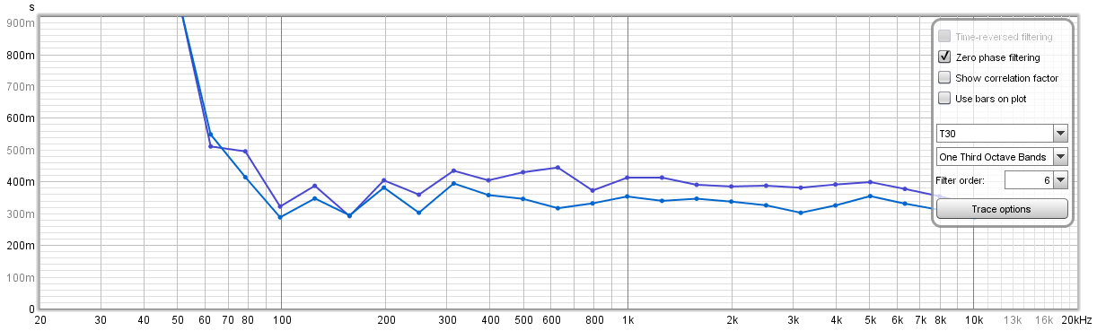

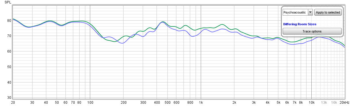

ok lets have a look at impact on amplitude response
Ok this is making a difference.
what about RT60
significant impact above 100Hz

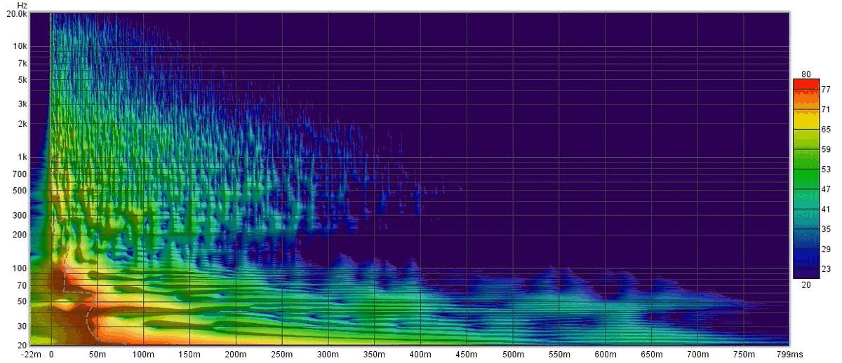

Spectrogram
So a nice reduction in RT60 and spectrally an evenish reduction across the board above 100Hz
400ms is still higher than I like so there will be more.

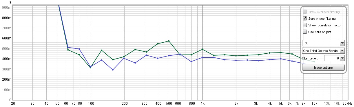

L3  treatment vs L4 2 x RPG BAD panels at first reflection
This will be interesting for a few reasons. Its only 2 panels so good luck to me picking which is which in the abx!! Also the LX521's being dipoles have much lower output at first reflection and infact that is how they are recommended to be setup so the effect of 1st reflection is less anyway..
Oh well not every change can be massive!!

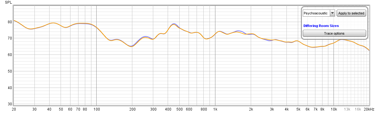

Here is the amplitude plot
Its definitely not massive

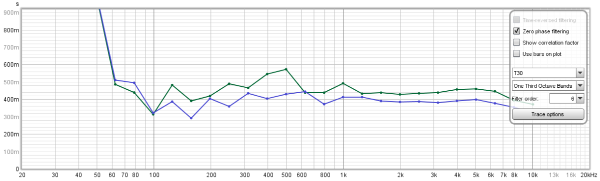

Heres the RT60
A small benefit - its only 2 panels after all
And spectrogram
At least you can see it!!

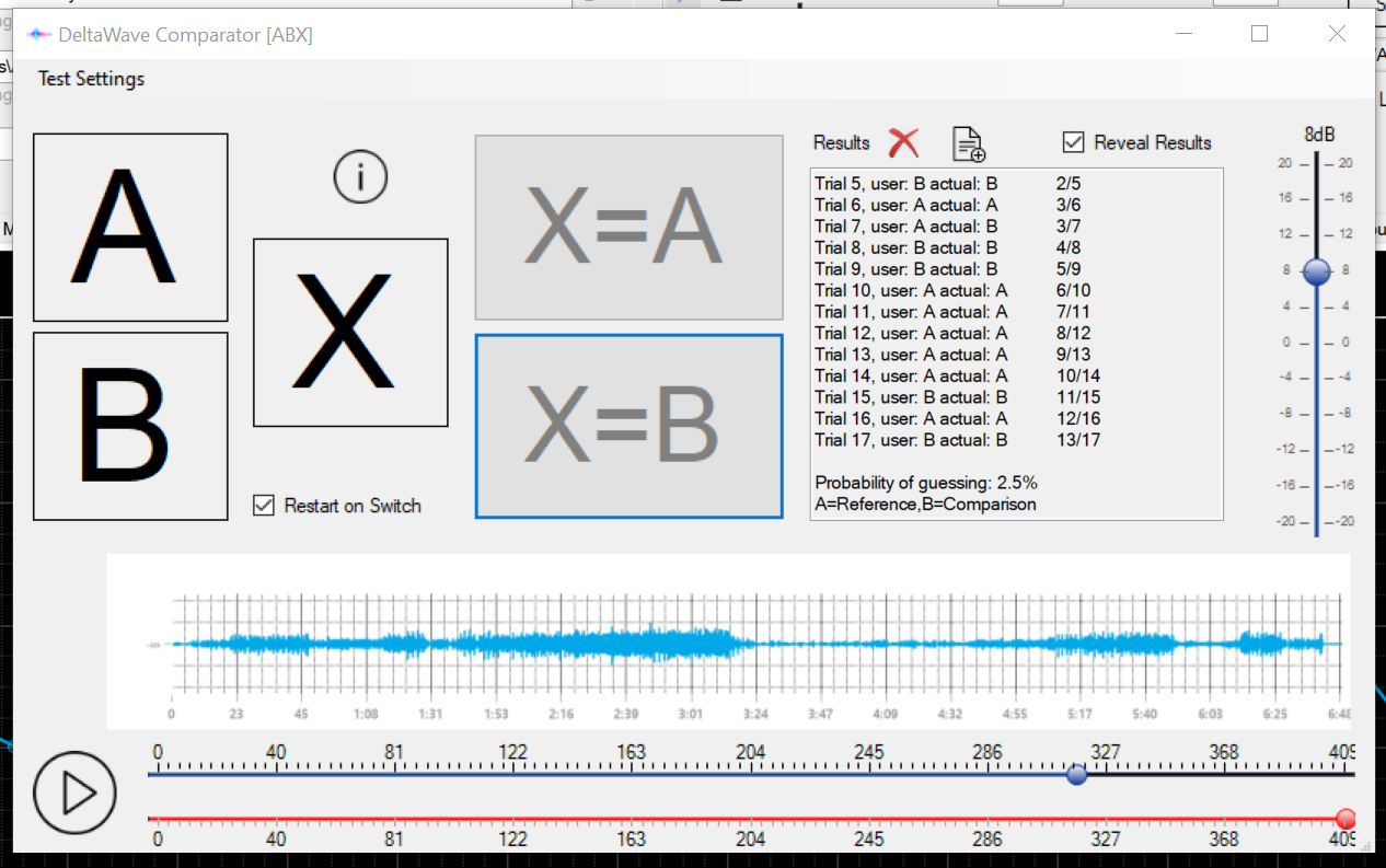

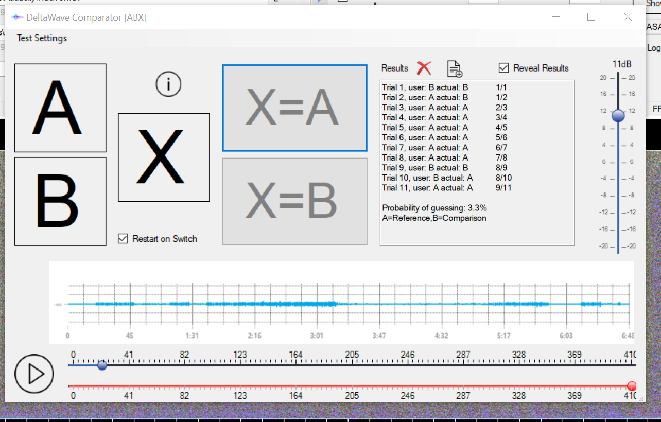

And can I tell the difference in ABX? surprisingly yes. I did this a few times and it does take a fair bit of concentration but just doable. This time the hihat was not working for me so was listening to how muted or ringy the snare was
117720823_3-4comparatorScreenshot2023-02-16185631.thumb.png.a849bf76d2b2ff770109c498b771b4b9.png

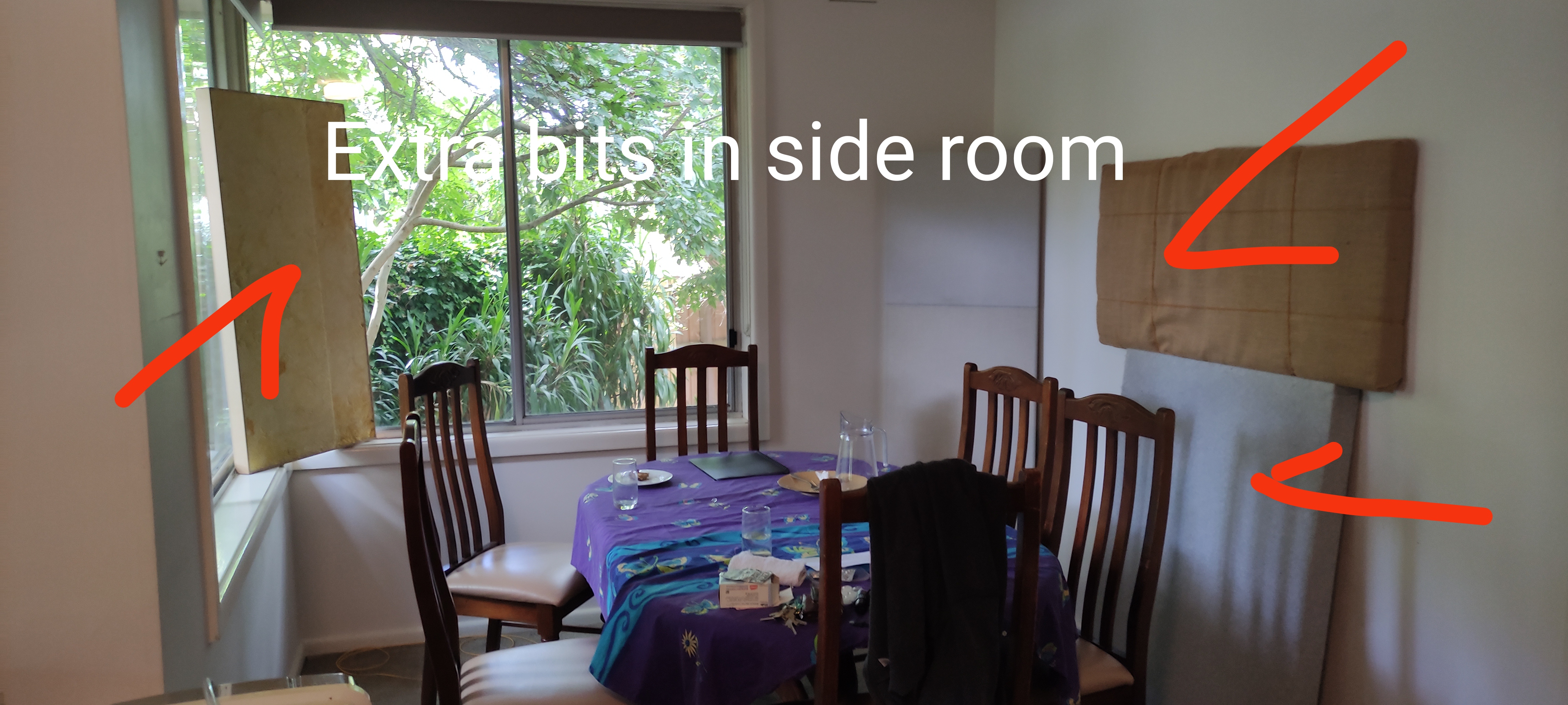

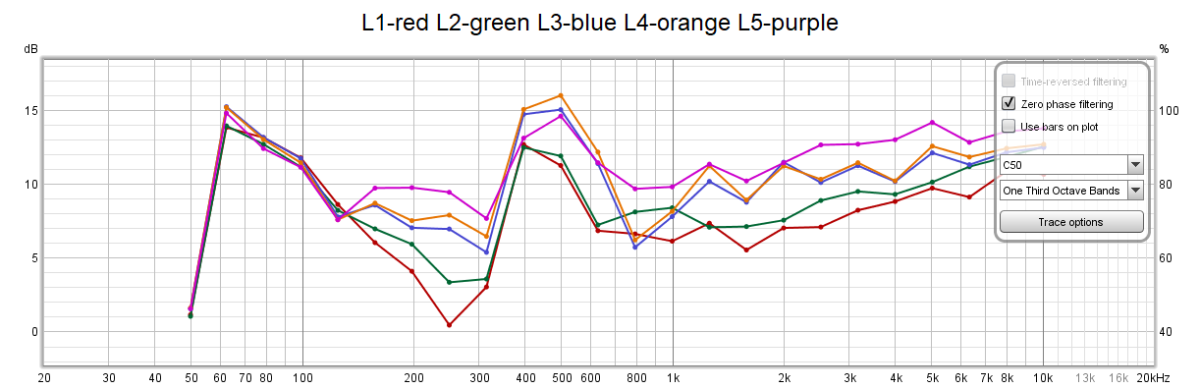

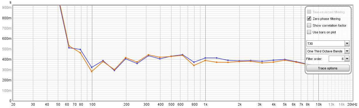

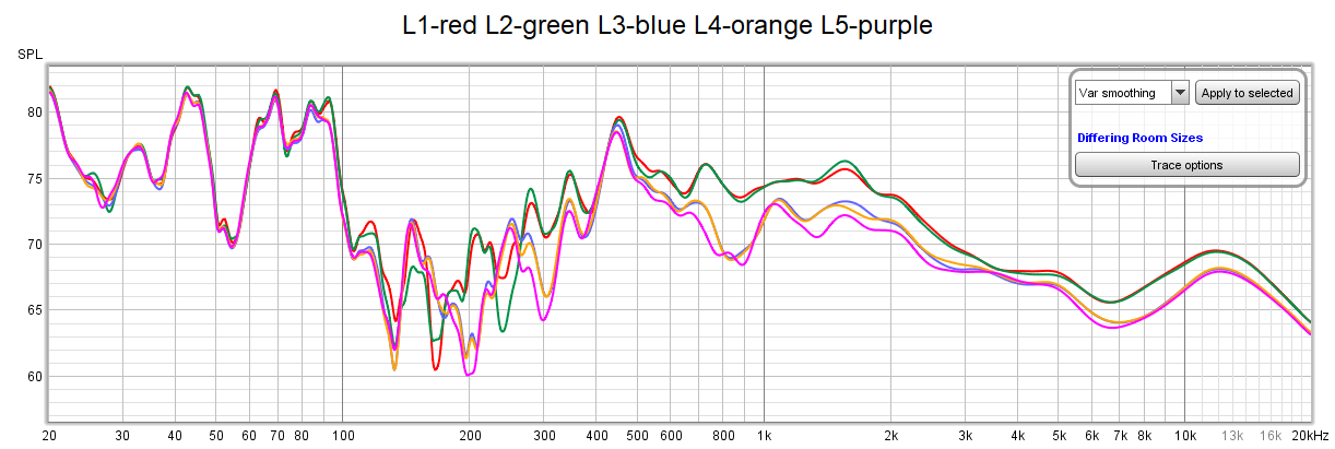

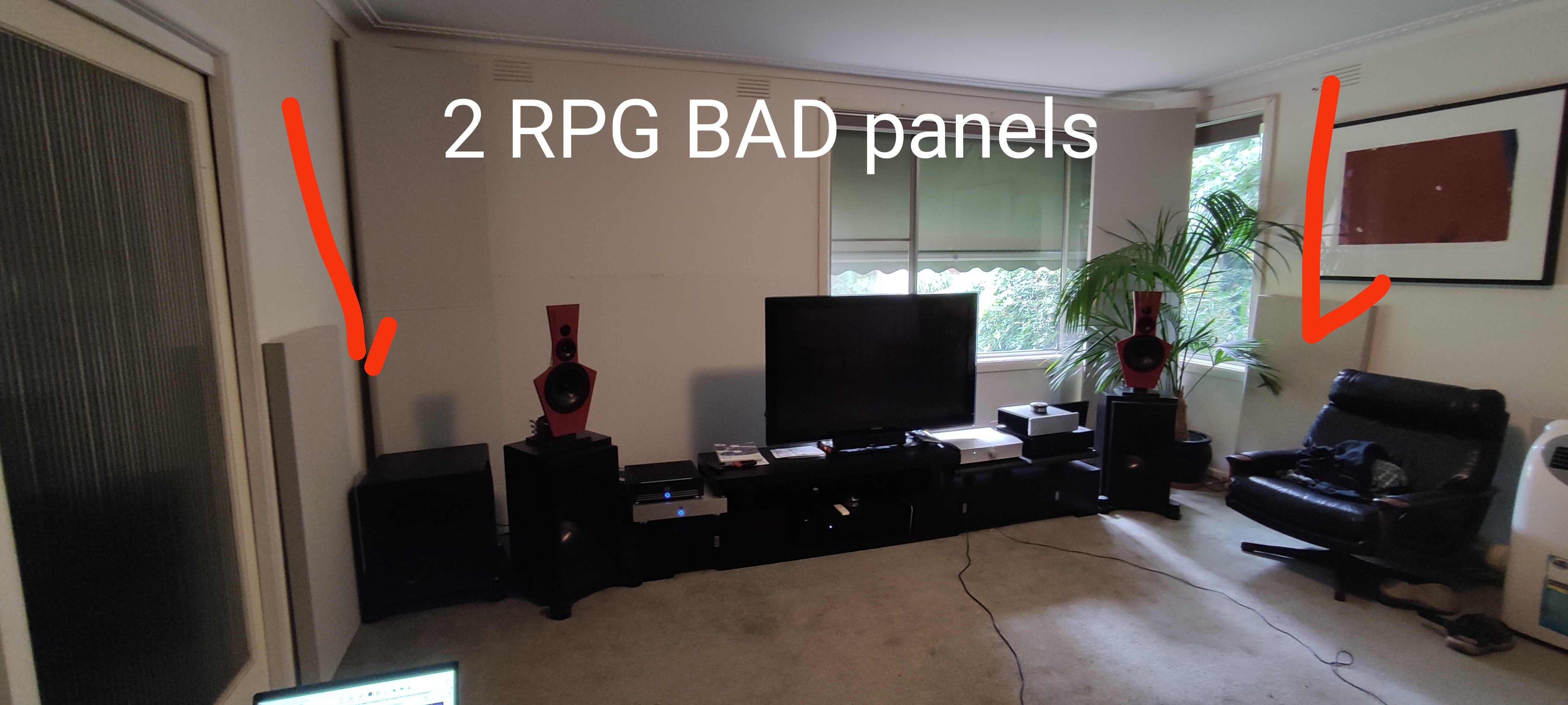

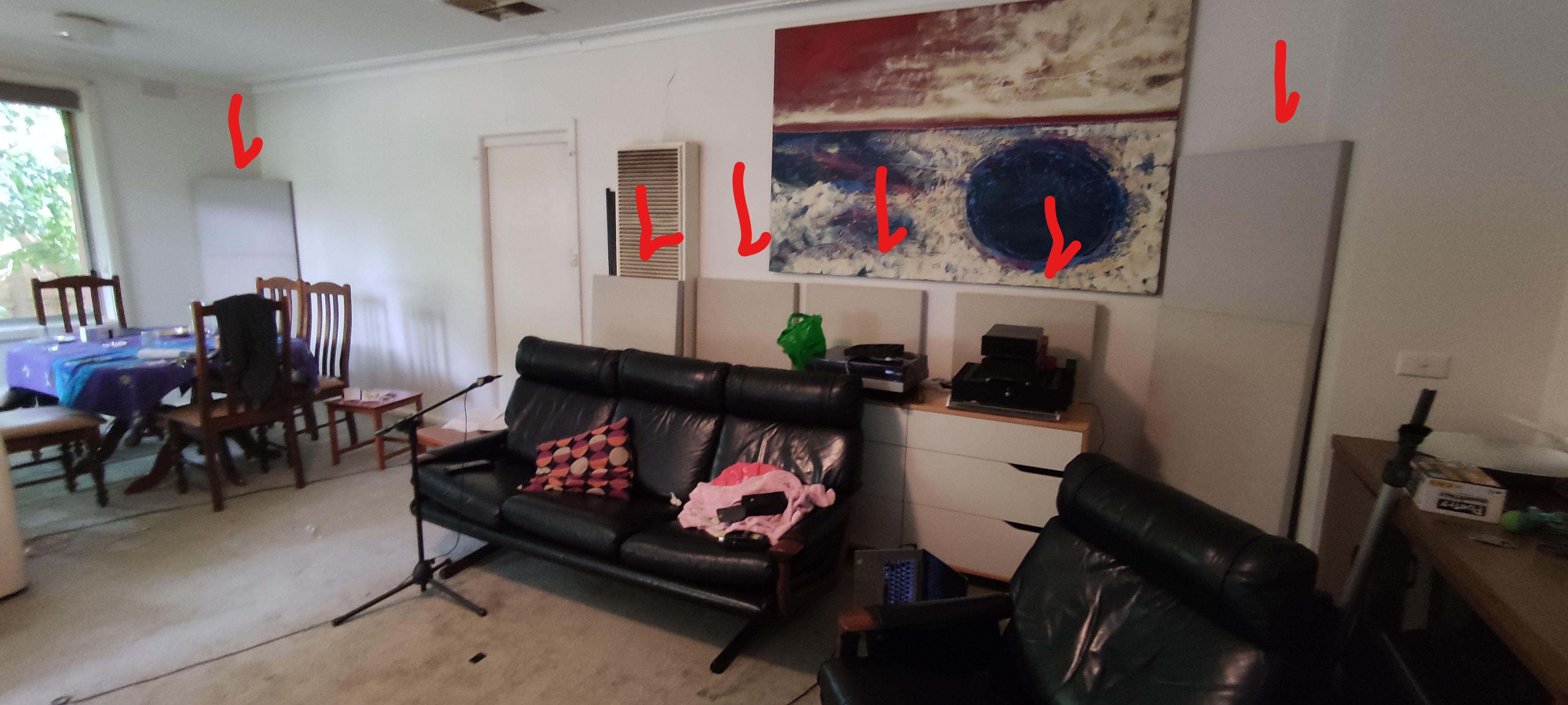

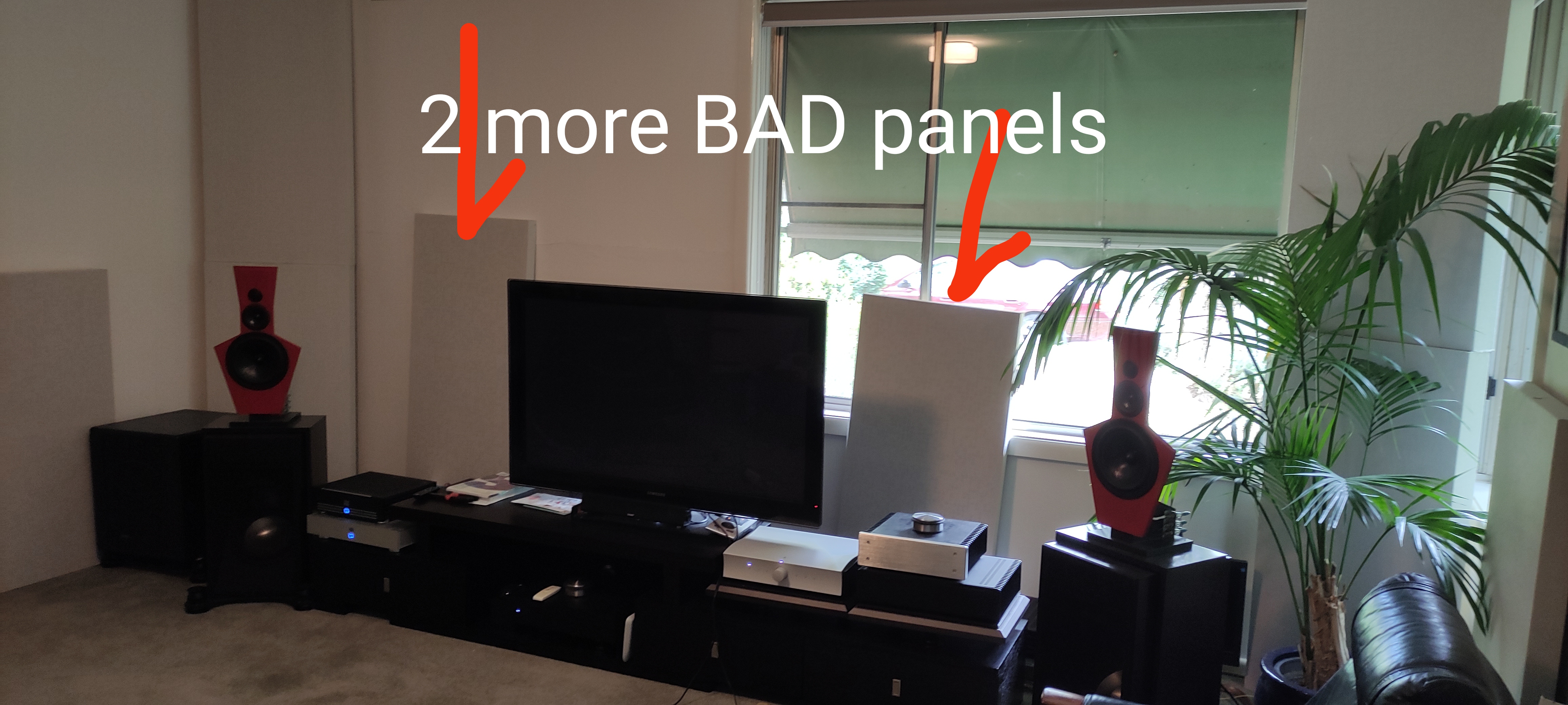

Ok, this is the last addition of treatment. (for now anyway) and I have combined 2 locations of treatment as its dragging on a bit.
Level 4  treatment vs L5  2 x RPG BAD panels behind speakers and 3 ish absorbers in side room
1676683926516.thumb.jpg.f66e388d2dc71300498bec22feaae069.jpg1676683926501.thumb.jpg.4f7e01d3b478844f826ec1c350d95003.jpg

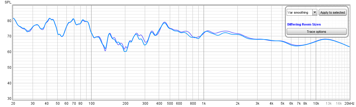

amplitude comparison
small differences but I made this one using variable smoothing to show that there were somw differences below 100. Might be a clue that this is the area that is causing problems.

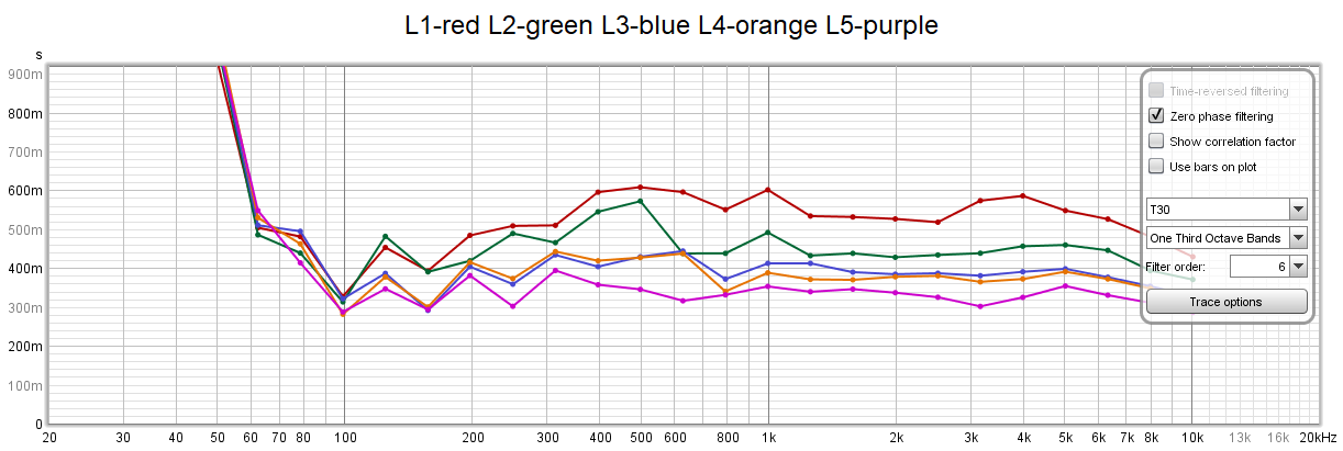

RT60
a reasonable reduction in T30 times pretty broadband,

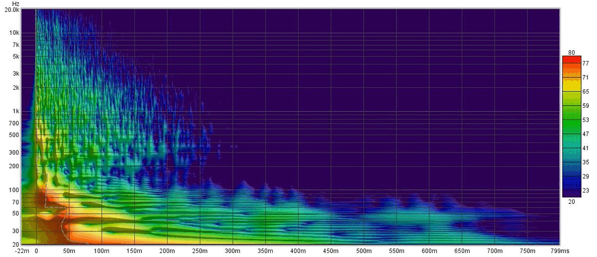

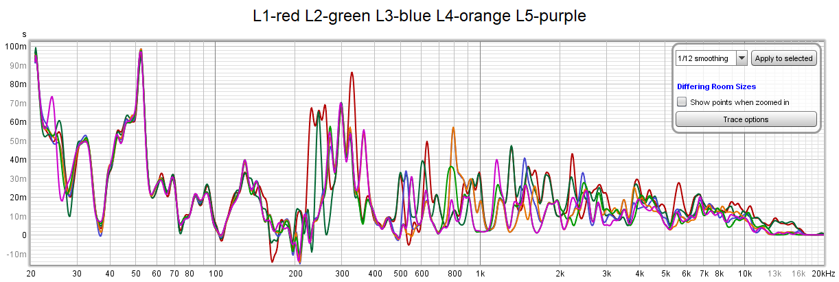

and the spectrogram
things are still improving.
Edited by frednork

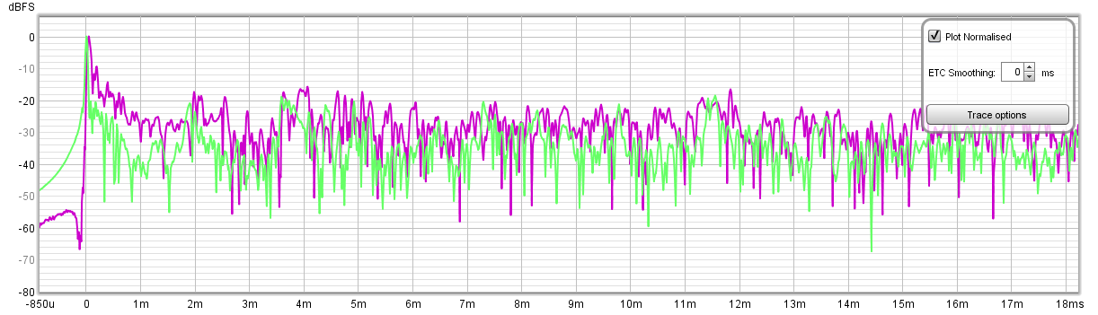

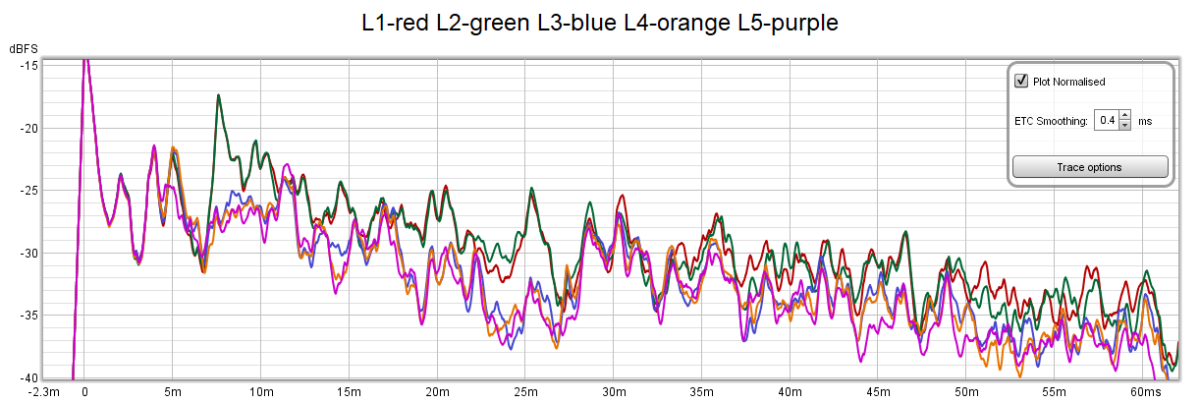

ETC shows some nice differences too

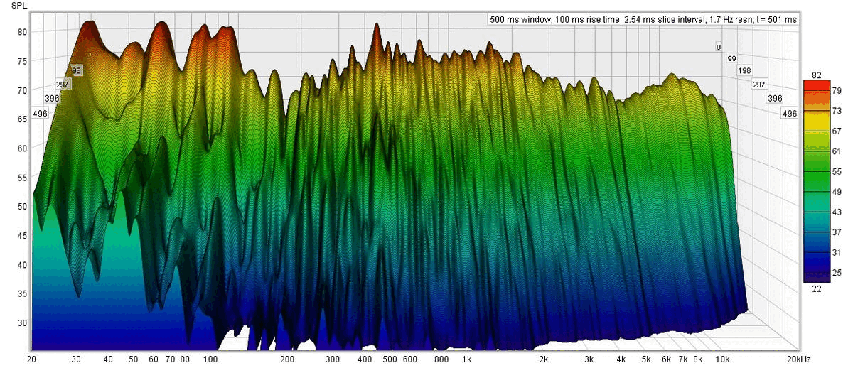

and waterfall
Theres a few odd things going on around the 1-200 mark at the noisefloor. It make be just extraaneous noise around the house at the time or...? Also that big lump that appears at around 25Hz, Maybe passing car or helicopter or something.

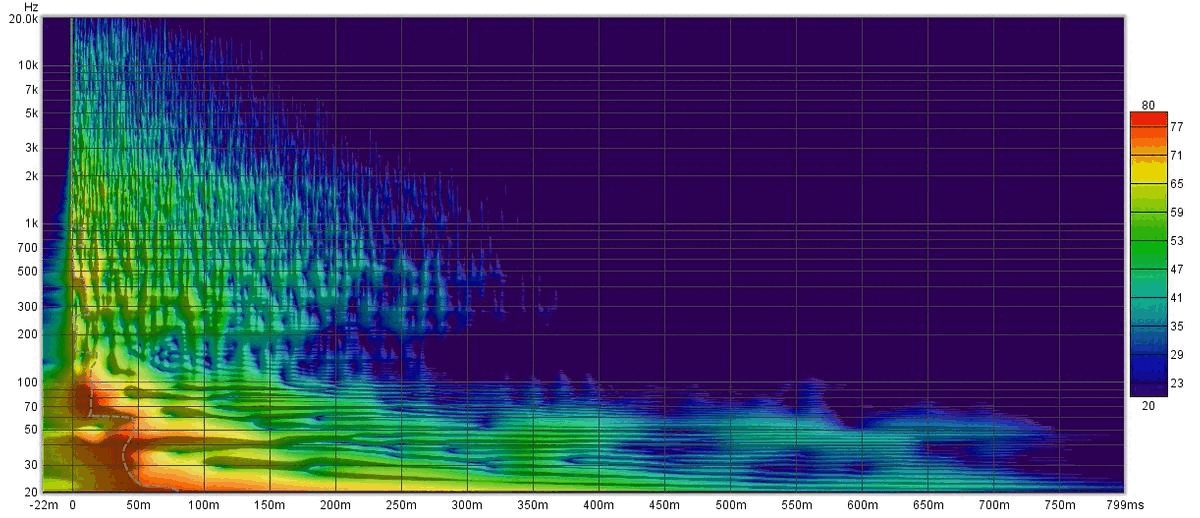

And the spectrogram
You might think great! job done, big improvement. It is greatly improved and from not very enjoyable to very enjoyable. Problem is I know it can be better.

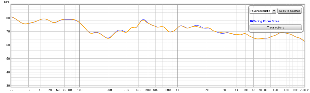

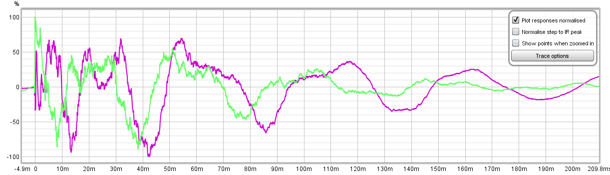

I forgot to add I also dsp as well. This is an early dsp effort. I will post final later but you get the idea
 which improves flatness of curve (and sounds much better).
ETC is much better especially in the 1st 3ms or so
 of course step response is more ideal

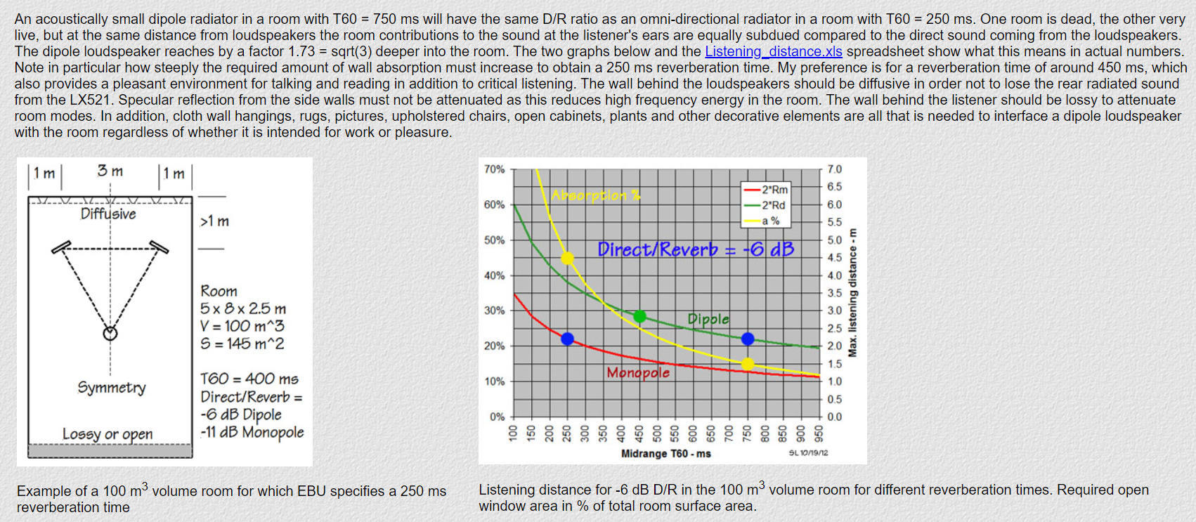

What am i going on about with this direct to reflected stuff? The following is a bit from Linkwitzes website which talks about it from the perspective of monopole vs dipole. But he also says you can achieve the same result with monopoles but the listening distance needs to be much closer and the room less reverberant. whole thing is here https://www.linkwitzlab.com/listening_room.htm
not everyone agrees 😜

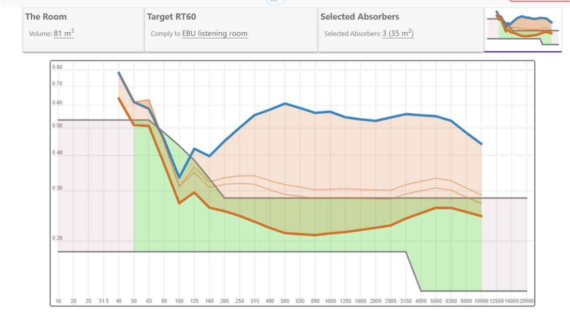

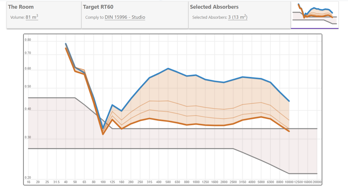

Ok next, how can we predict how to get to our desired rt60?
  • Author

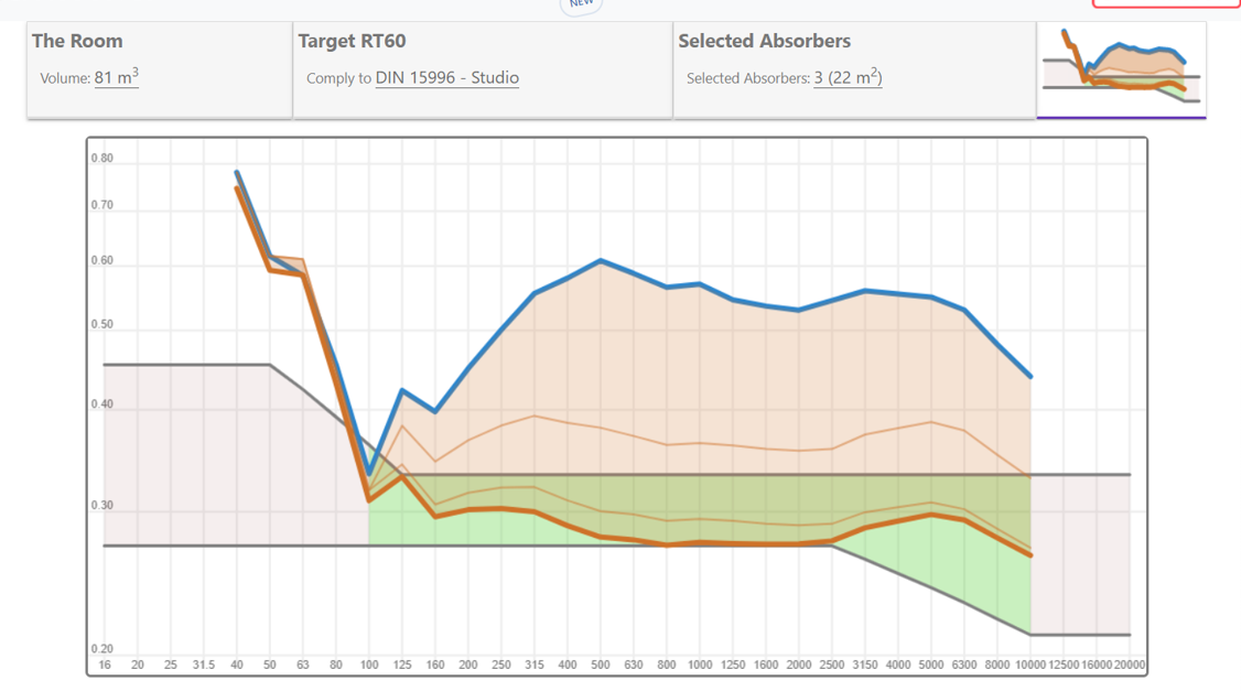

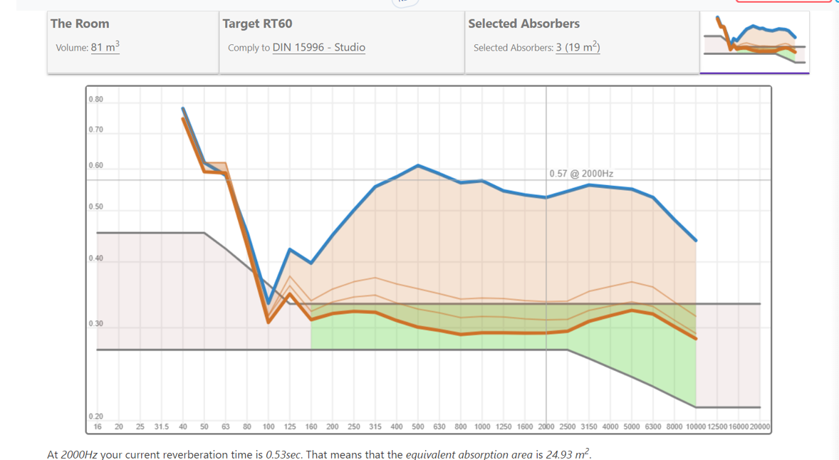

Ok, so how do we predict how much treatment we need to get to our desired rt60? I can say I have no idea how to do that but this relatively new tool purports to do so https://amcoustics.com/tools/amrev/#/room
its a bit half baked atm and you have to do all the work and none of it can be saved. So if you accidently close the page or your computer decides to restart for an update (Frikin windows I am looking at you) then you have to start again. but it may be very useful once it gets better.

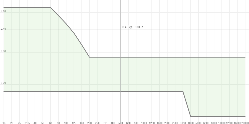

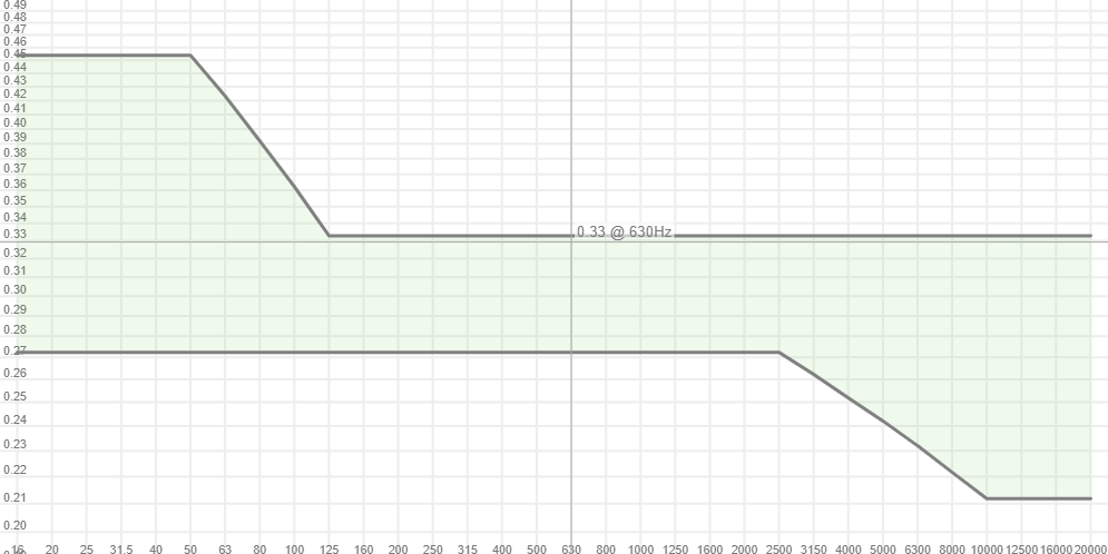

What you do is enter your rooms current RT60 and then the characteristics of the treatment you are wanting to use and then you can add the treatment virtually to give an end result.  I compared its prediction with what I measured and its close enough I reckon. There are some issues with how absorption is specified and the frequency range that is shown in specs but once you take that into account its pretty good.
So what about targets. It has some standard targets included which are customised for your size room
eg https://tech.ebu.ch/docs/tech/tech3276.pdf
or DIN 15996 - Feb 2006, chapter 4.6.5.2
Lets see if i meet these and what it would take to get there
Well the easy answer to do I meet it is a big NUP. not that far off. With this standard (DIN music) I cant meet the below 100 Hz without some serious trapping so will focus on the >100Hz for now.
With the treatment types I have on hand  can I achieve the standard. (above 100hz anyway)?
It says I can meet it down to 160 Hz with an additional 6sq metres of absorbor which equals a bit over 8  120cmx 60 panels. This is where the roof would come in very handy. Sadly its a rental so canno do. If I add more absorbors it doesnt affect things at lower frequencies so no point.
What if I add more Abfussors which have more impact at lower frequencies?
Ok I can meet it (to 100Hz) with 4 more Abbfussors. Considering their size and cost that aint happening. This is a stupid standard anyway😁
What about EBU? of course as it is atm it doesnt meet that either so what extra is required?
So with 13 extra Absorbors I can achieve the above that is really getting into padded cell territory.
Just for fun lets go all out
ok looks good, gets me down to a little below 50Hz
but would take around 13 absorbor panels and 16 BAD panels both of which are 120cm x 60cm each. OMG
The nice thing about this is it becomes obvious pretty quickly that just applying broadband treatment in large quantities may not give the most efficient result and targeting your issue with the right kind of treatment is a good idea!
Hope theres some things to ponder for you...
Edited by frednork
