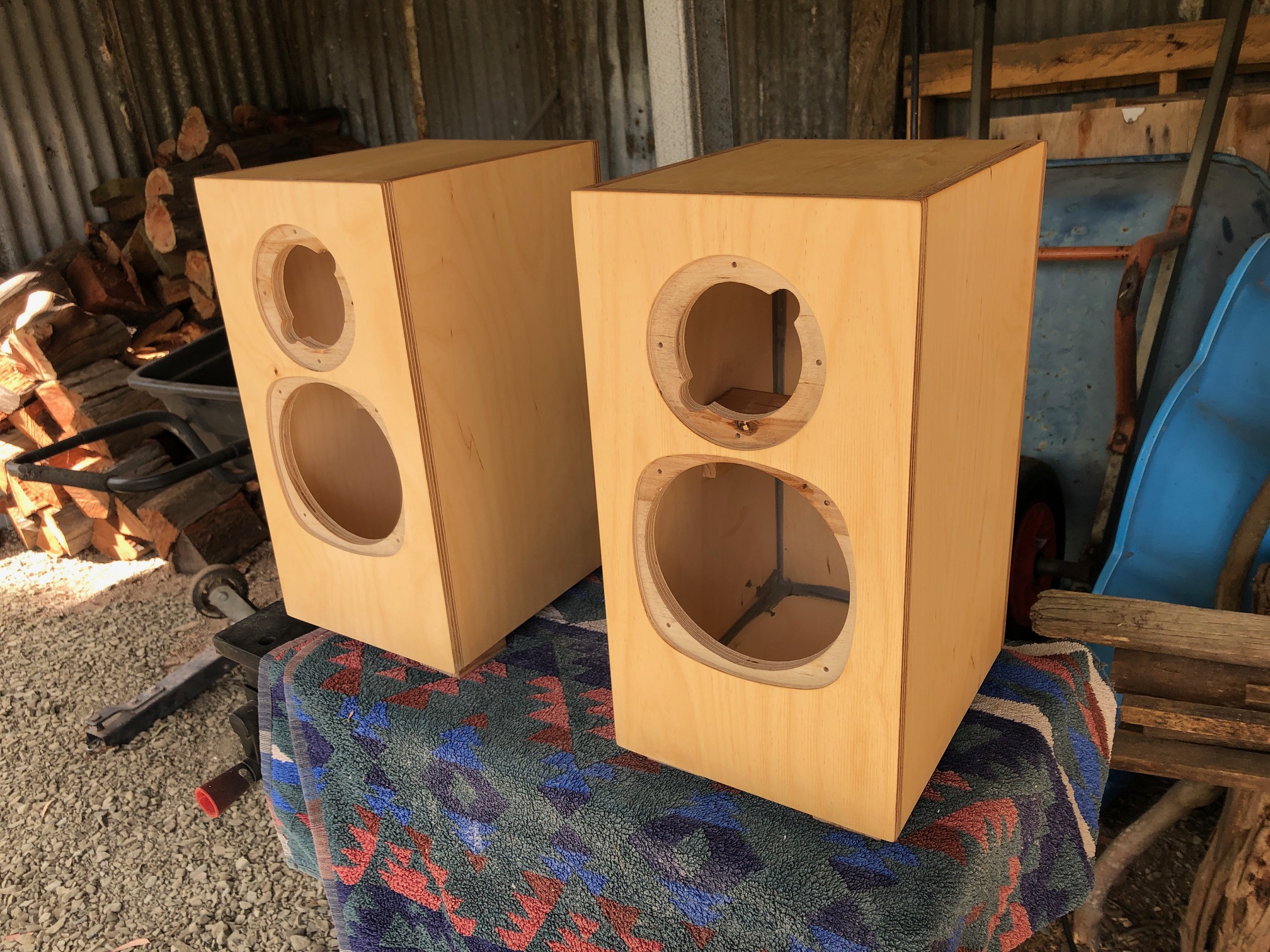

 A week later a heavy box landed at the post office, and unpacking revealed professionally CNC'd panels and everything I needed to build the kits (literally everything!!).
After a couple of trial fits, I glued them up with the supplied PVA, and clamped with the supplied straps.  I added a couple of my own clamps too, but it wasn't needed.  (but more is better, right?)

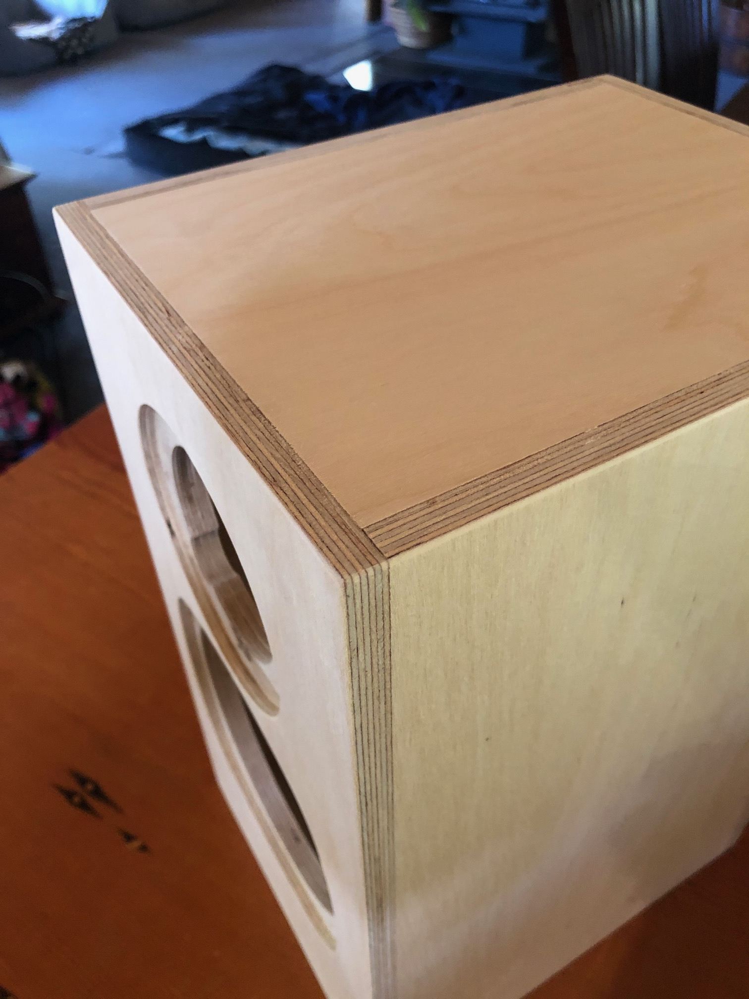

All the panels have a great fit
Next up the boxes are sanded and then finished with a few coats of varnish.  This was the most time consuming part of the process, waiting for the varnish to cure and the then sanding, rinse and repeat a few more times with progressively finer sandpapers.

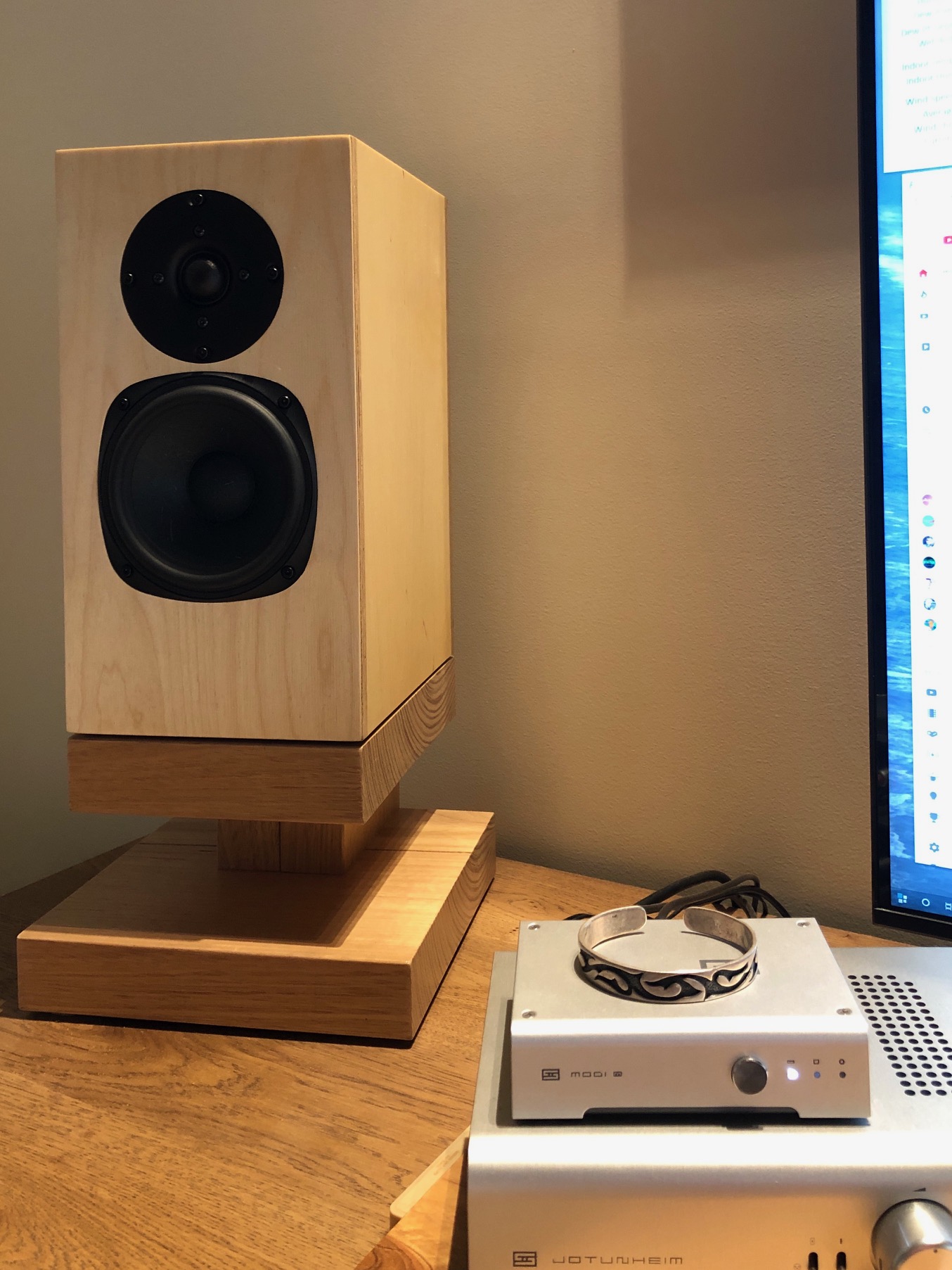

Initial finished product :)

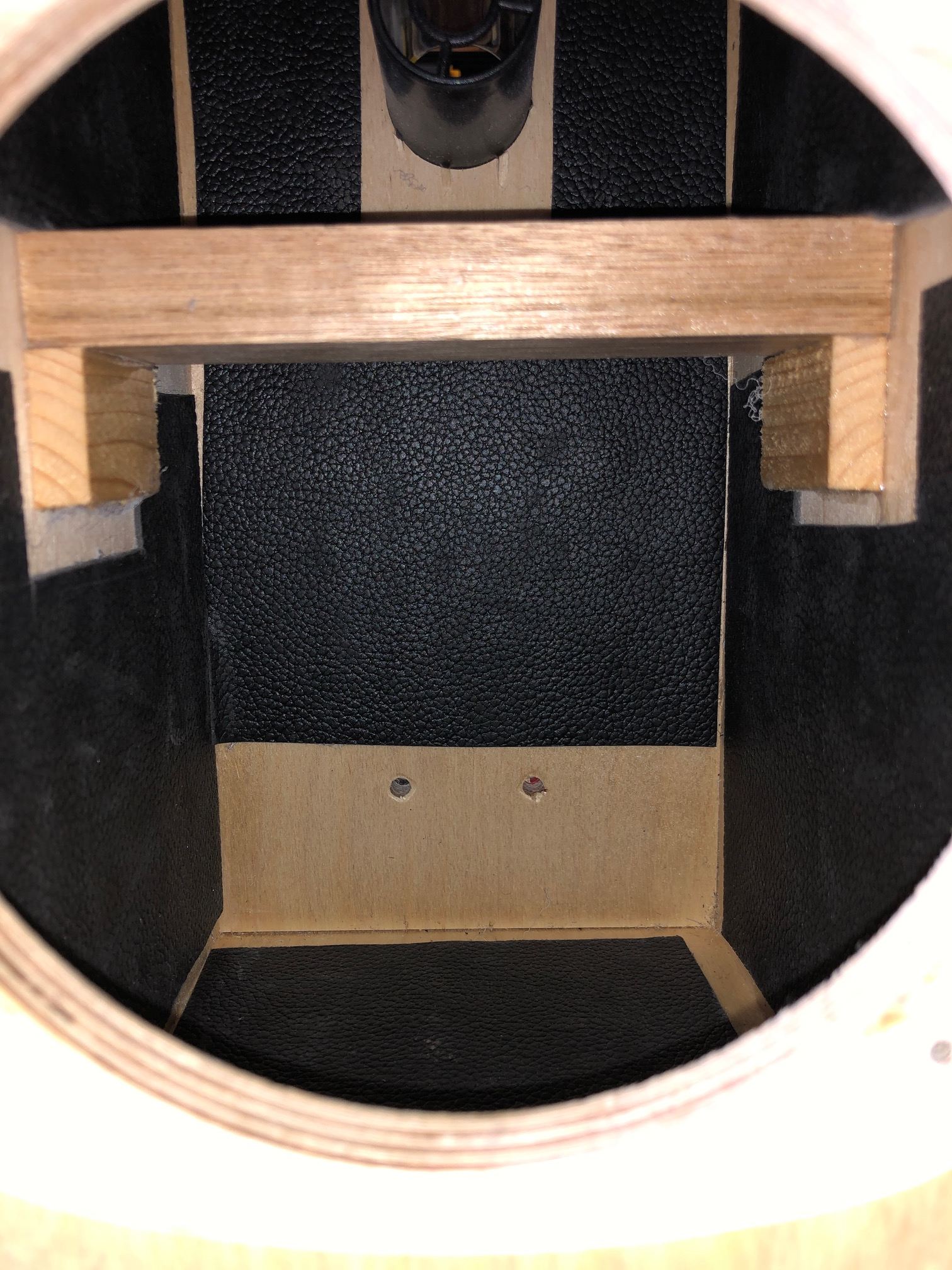

I then took them apart and did a couple of mods.
Installed a cross brace between the sides and lined with barium damping to really deaden the cabinet. (Trohet has internal bracing and damping already included in the kit)
Retro fitting the brace and damping was a bit awkward, but we got there with some blocks and clamping, and spray on contact adhesive for the damping.

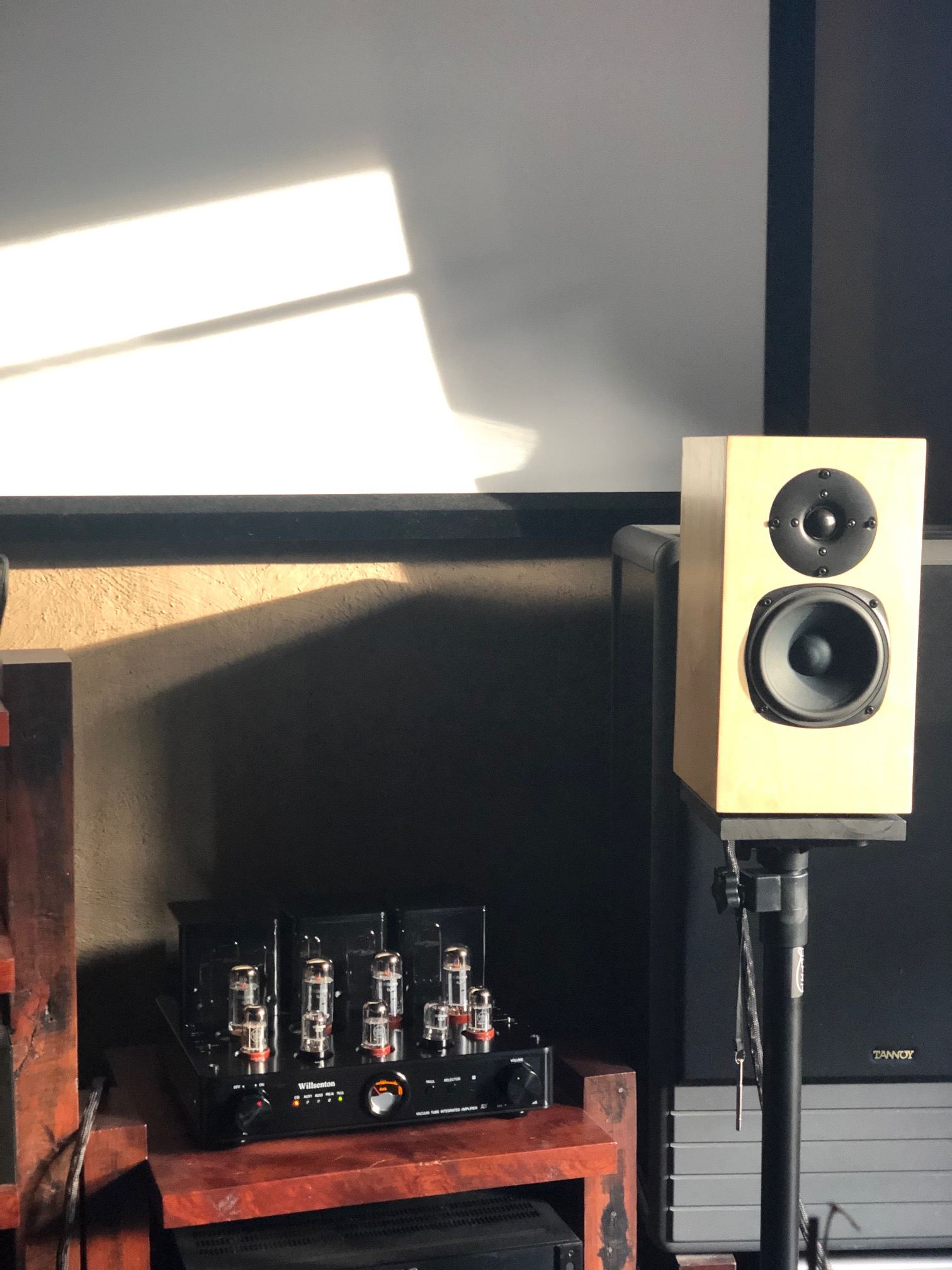

I am very pleased with these.  They defy their size with the bottom end - not subterranean of course - but surprisingly full.  Imaging is spot on and overall tone I would say ever so slightly warm.  They are a very engaging listen, musical and scale well from my desktop setup to filling a large room with more than enough volume for most activities.  Driving them from the Willsenton R8 with EL34s produces a full and wide soundstage.

Question, did you notice much when you added the cross brace and the stuck on damping?
Bet those Tannoy's at the back sound good!

The Tannoys are outstanding, and the room they are in is big enough to allow them space to shine :)
The cross brace and damping was more for my own OCD, the biggest difference to me was the knuckle test - rap the side of the cabinet and it was definitely more dead/damped.  I honestly didn't notice any change in the sound, as the birch ply is pretty solid.  The Trohets come with cross bracing and damping as I understand it.
