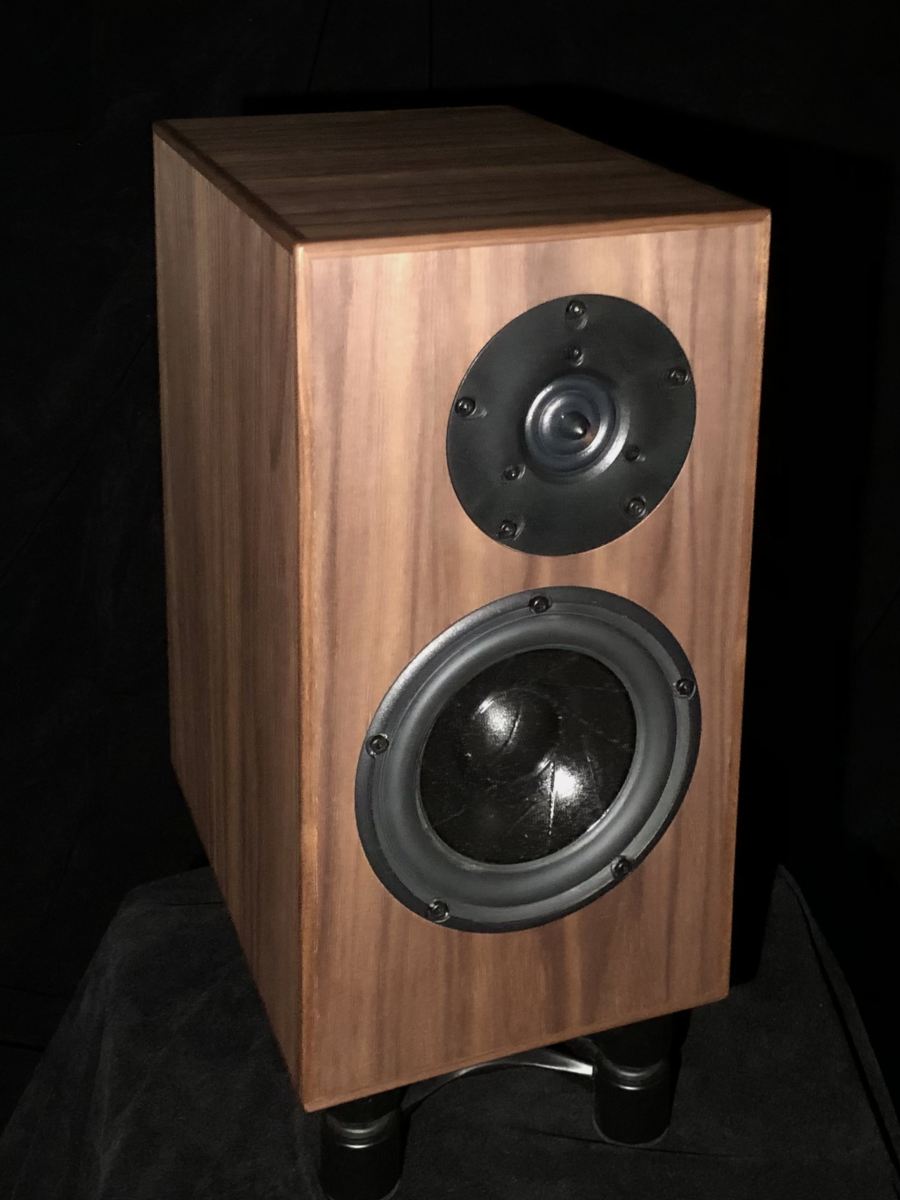

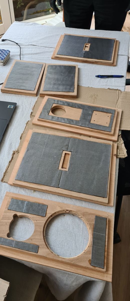

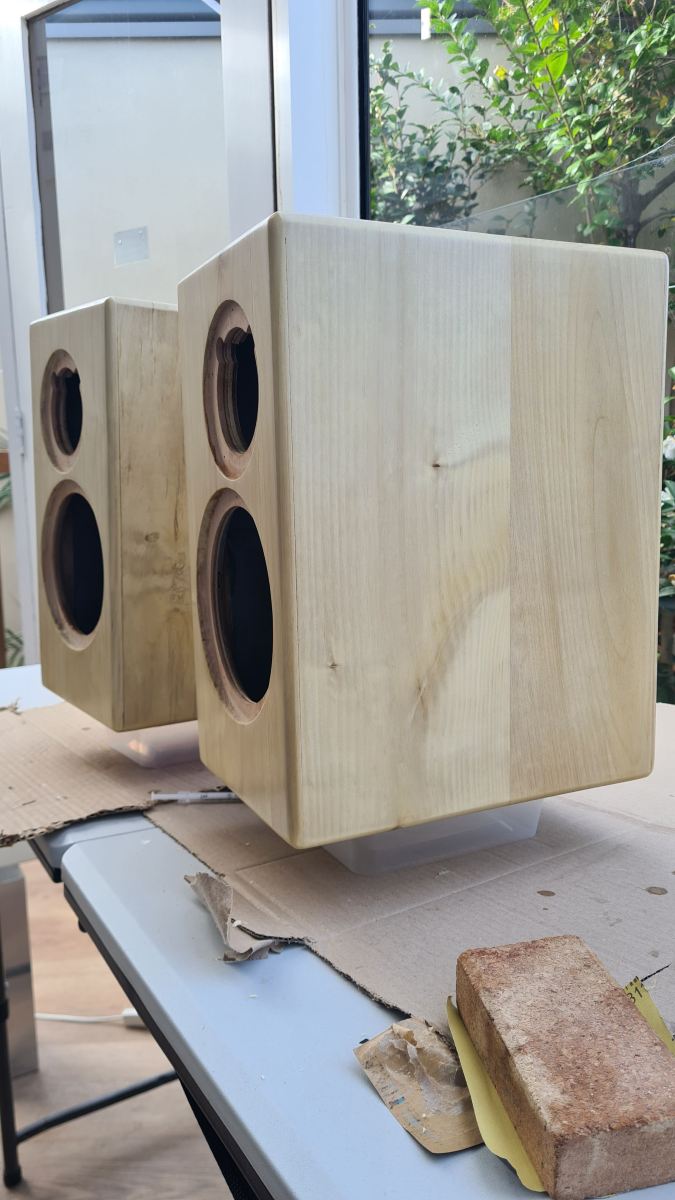

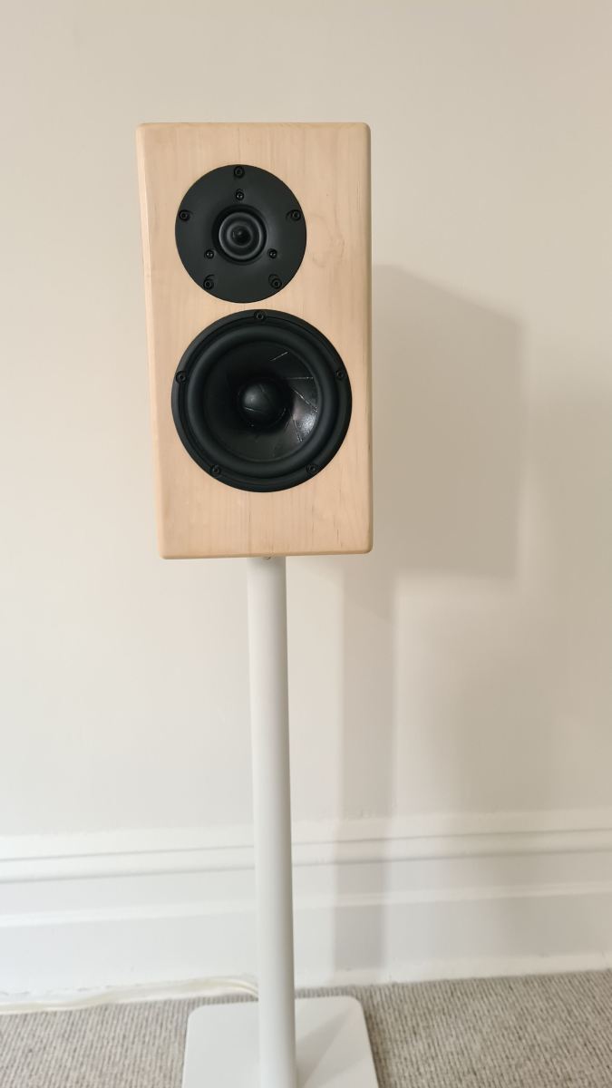

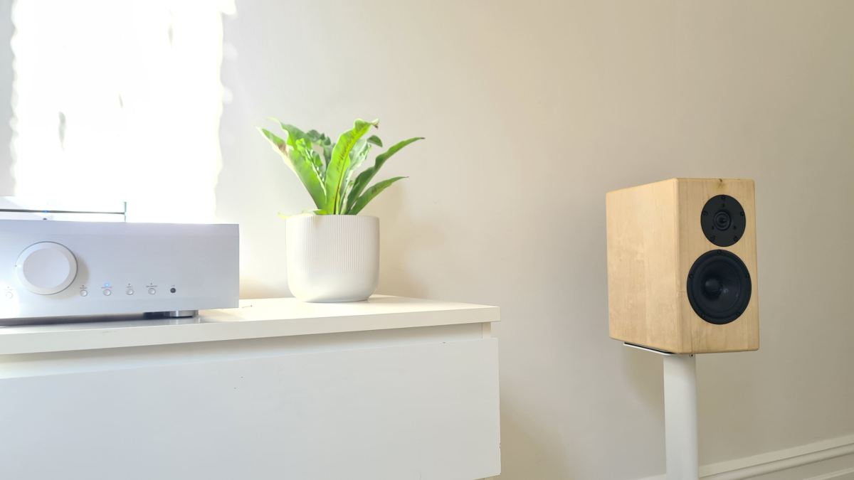

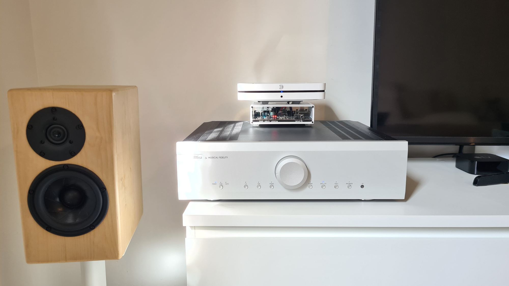

    A few more pictures of the build.
  • Author

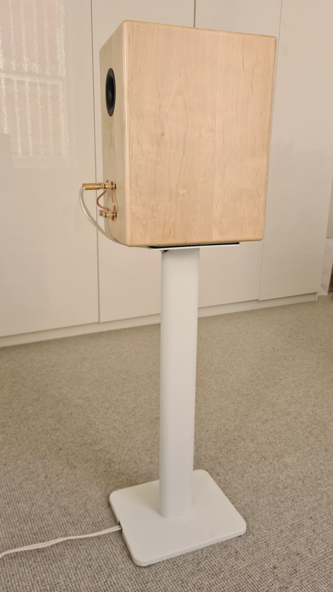

Love the build and love the blonde wood. For me with such a small speaker I would have left the tweeter in the middle. Bigger boxes would allow the tweeter offset and look good but here doesn’t quite look right. Not going to change how good it sounds but. Love to hear them.  Good work.
Edited by mwhouston
They are remarkably similar looking to the Zaph Audio ZD5 DIY speakers.
Yes the finish does look nice.
Having the tweeter offset like this is technically the most optimum design.  For the least cabinet edge diffraction you want the distance from tweeter to all four edges to be different.  But it does look a bit "off".  Whether the gains in performance make up for the aesthetic issues are debatable.  Look at most commercial speakers and you know what the manufacturers and consumers think!

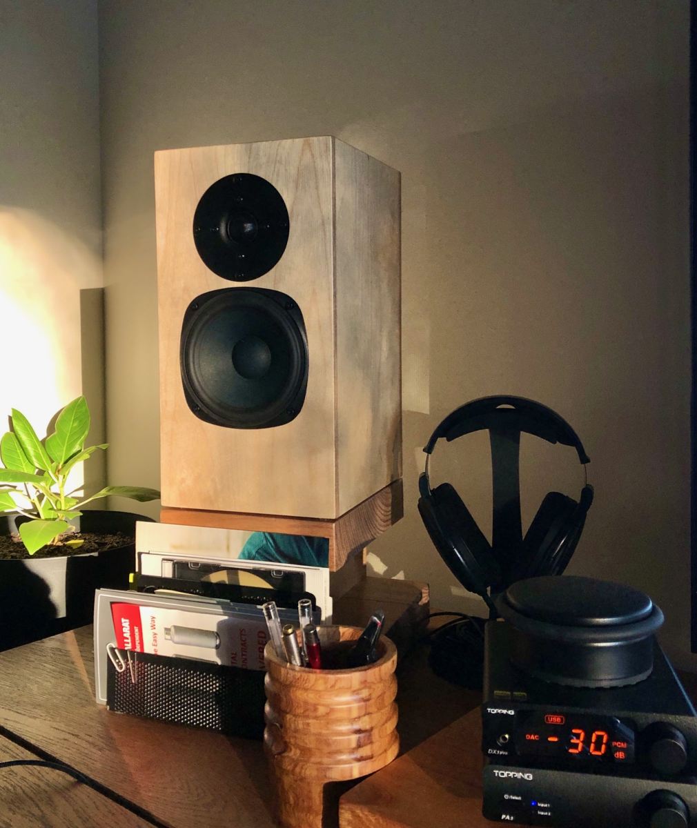

Thanks for sharing Fidelity Hi, they sure do look nice! I'm keen on giving this a go and will probably wait when they get the Mahogany back in stock.
I just had a look at Alder timber on Google and can see it's a lot more brown that your speakers. When you say bleached, Just simply added household bleach?
Thanks! The colour came out really well, Trohet means accuracy in Swedish and I think it is fitting they came out blonde! 🤣
Absolutely understand it is personal preference. But when you see offset tweeters as a pair flanking your system, I really enjoy the look of them. My other system has regular tweeter positioning, so I get the best of both worlds.
  • Author
Thanks @RoHo for providing the science behind, I can confirm they sound great.
It is a two ingredient (readily available) solution that you use after the sanding process. Atlas provided me the information and a video on how to do it. I really like a light colour wood, so was happy with the outcome.

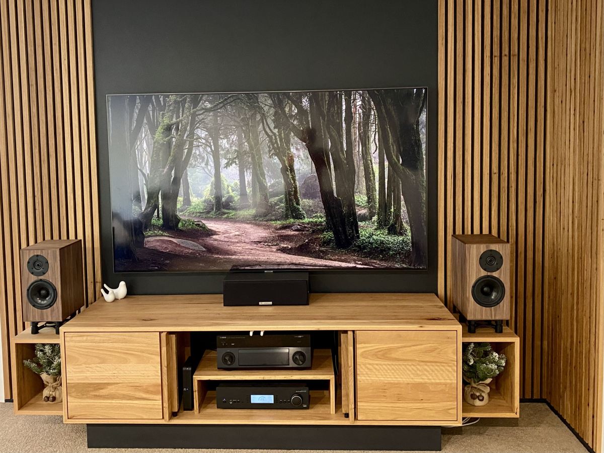

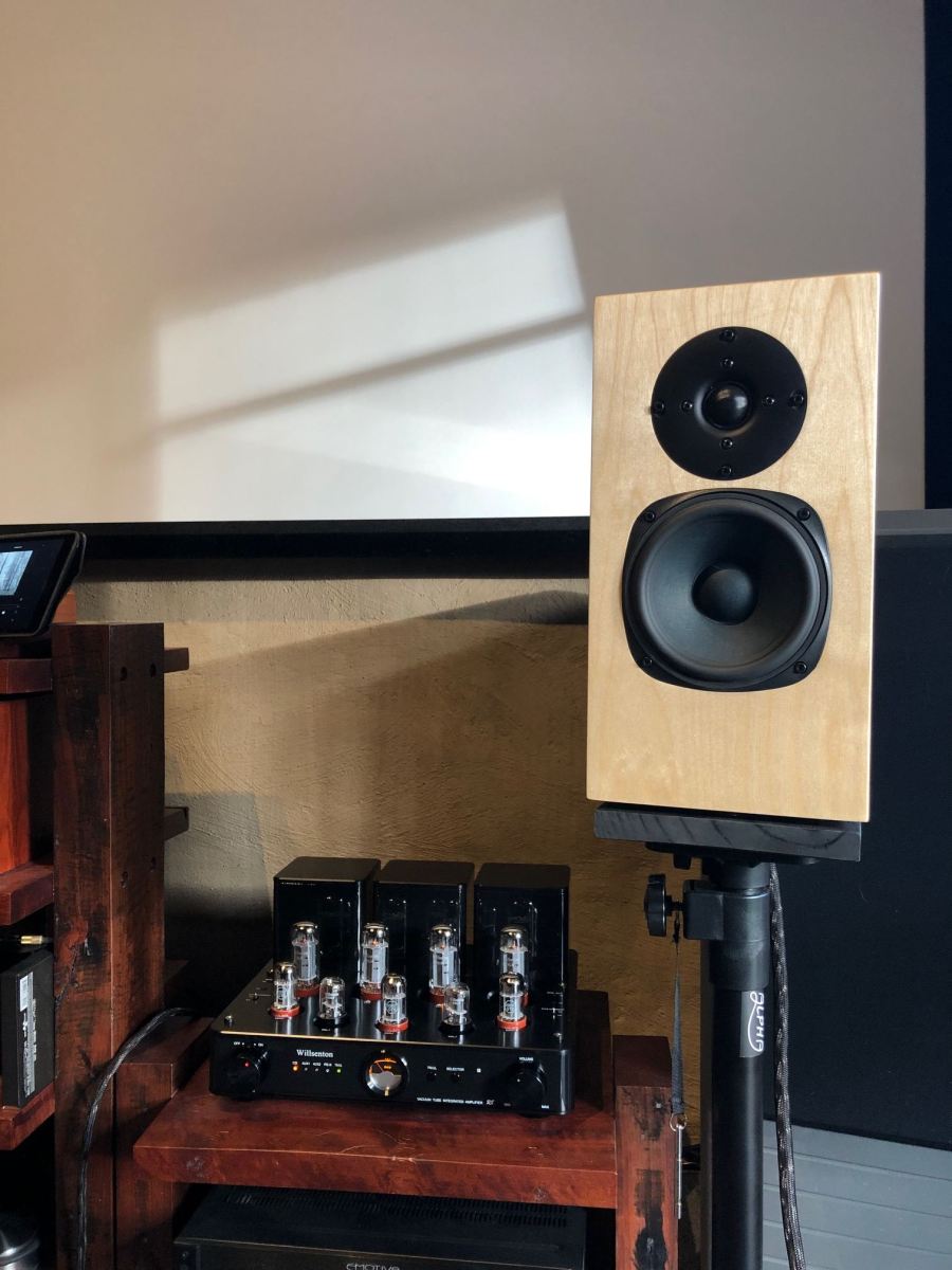

I didn't build the Trohet, but took the cost effective route and purchased the "Copenhagen" kit to build some monitors for my office.  I echo completely the experiences above with the kit and the communication & support from Atlas @ The Speaker Project.  The Copenhagens, too, exceeded my expectations!   I'll start another thread for the Copenhagens and share my build pictures, but here is the finished item on my desk and in use for some more "involved" listening.
The Trohet is on my wish list :)
IMG_8316.thumb.jpg.5876250ec4fd42708b280955277fbfaa.jpgIMG_8370.thumb.JPG.03ce348e22249bd43040130746c10ca4.JPG

@Timster great pictures and partnering gear in the Willsenton. Very cool with the tubes and I'm assuming an impressive soundstage?
Might perhaps be to get the most diffraction across the frequency range, rather than the least. This minimises beaming and lobing.
The sharp edge of a speaker cabinet creates a sudden discontinuity in the wave propagation and a reflection back to the centre of the speaker. Eg much like the expansion chamber in a silencer or the end of a pipe. With a centred tweeter each edge coincides with the same frequency for maximum bad effect.
More diffraction would mean more sound gets wrapped around the speaker and is better dispersed off axis. This is the aim in speaker design, getting an even response into the room through the frequency range. The base driver with lower frequency (more accurate/descriptive than saying large wavelengths in this instance) doesn't have this problem and even know the edge of the cabinet is there and disperses evenly in all directions.
Another way to deal with this issue is to round or chamfer the cabinet edges around the tweeter. This allows more diffraction and more even dispersion by reducing the sudden change of a square box edge. Think of it as a bit like a horn designed to prevent sudden changes in acoustic impedance by the design of the flare.

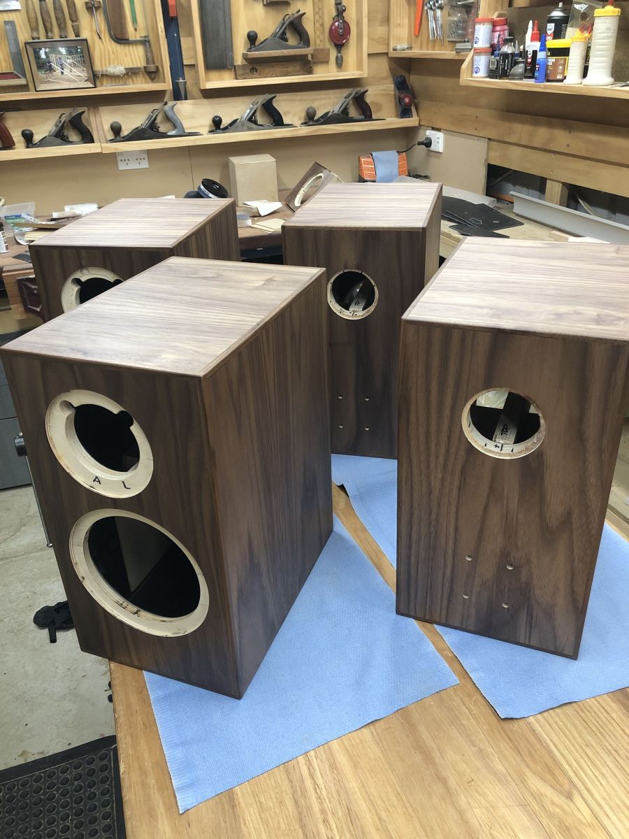

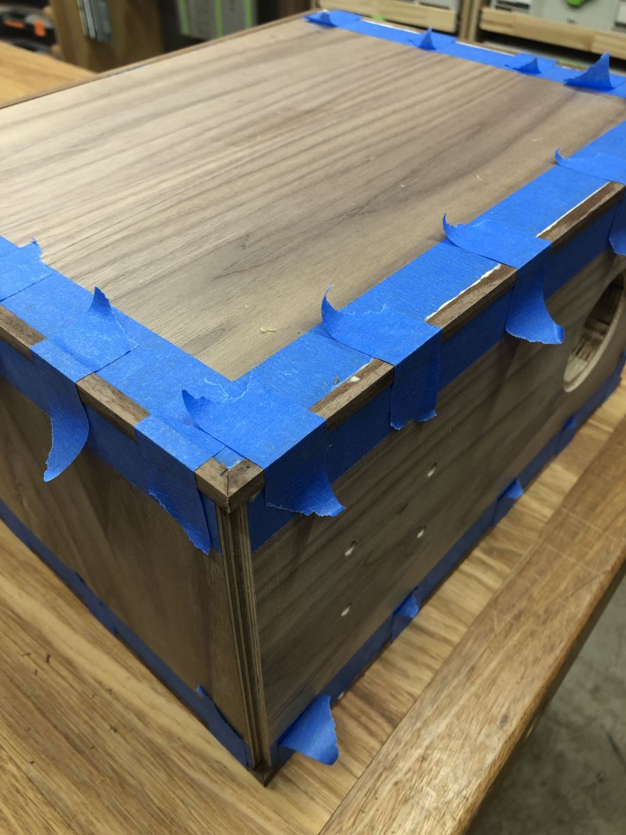

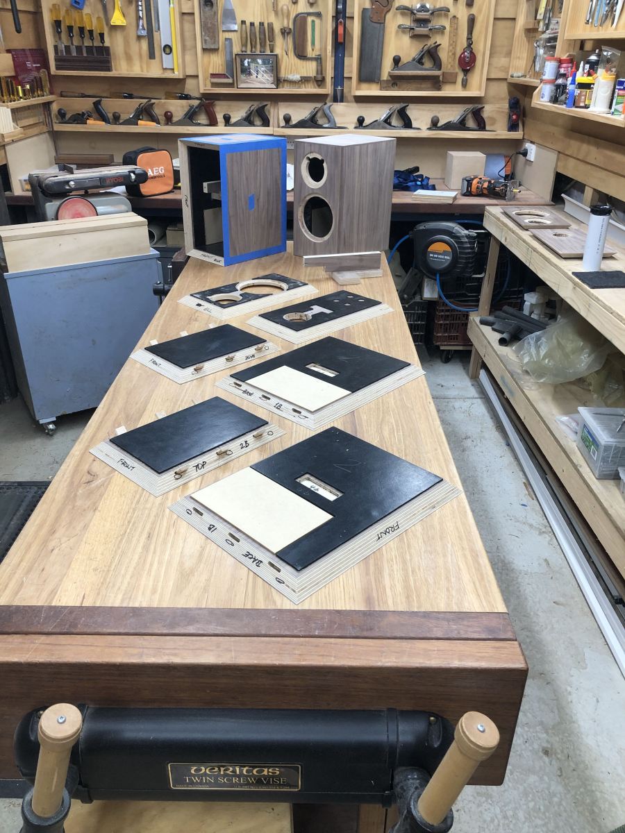

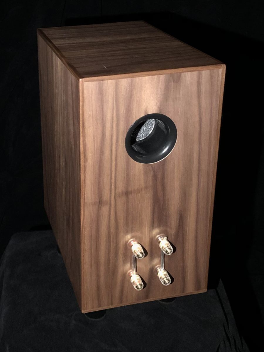

Trohet Speaker build

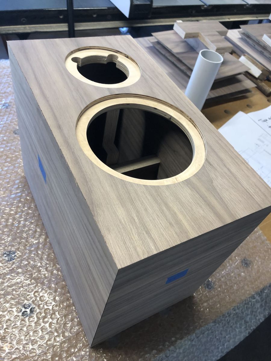

I have recently completed building some speakers designed by Atlas from The Speaker Project.
The speakers called Trohet are their high end speaker kit.
The kit is availability with all speaker components including cabinet panels that are CNC cut ready for glue up & if required all tools needed.
I decided to build my own cabinets so I ordered the speakers & crossover components only.
Fully detailed working drawings were supplied to build the cabinets &
assembly videos were available online & were very easy to follow along at my own pace.

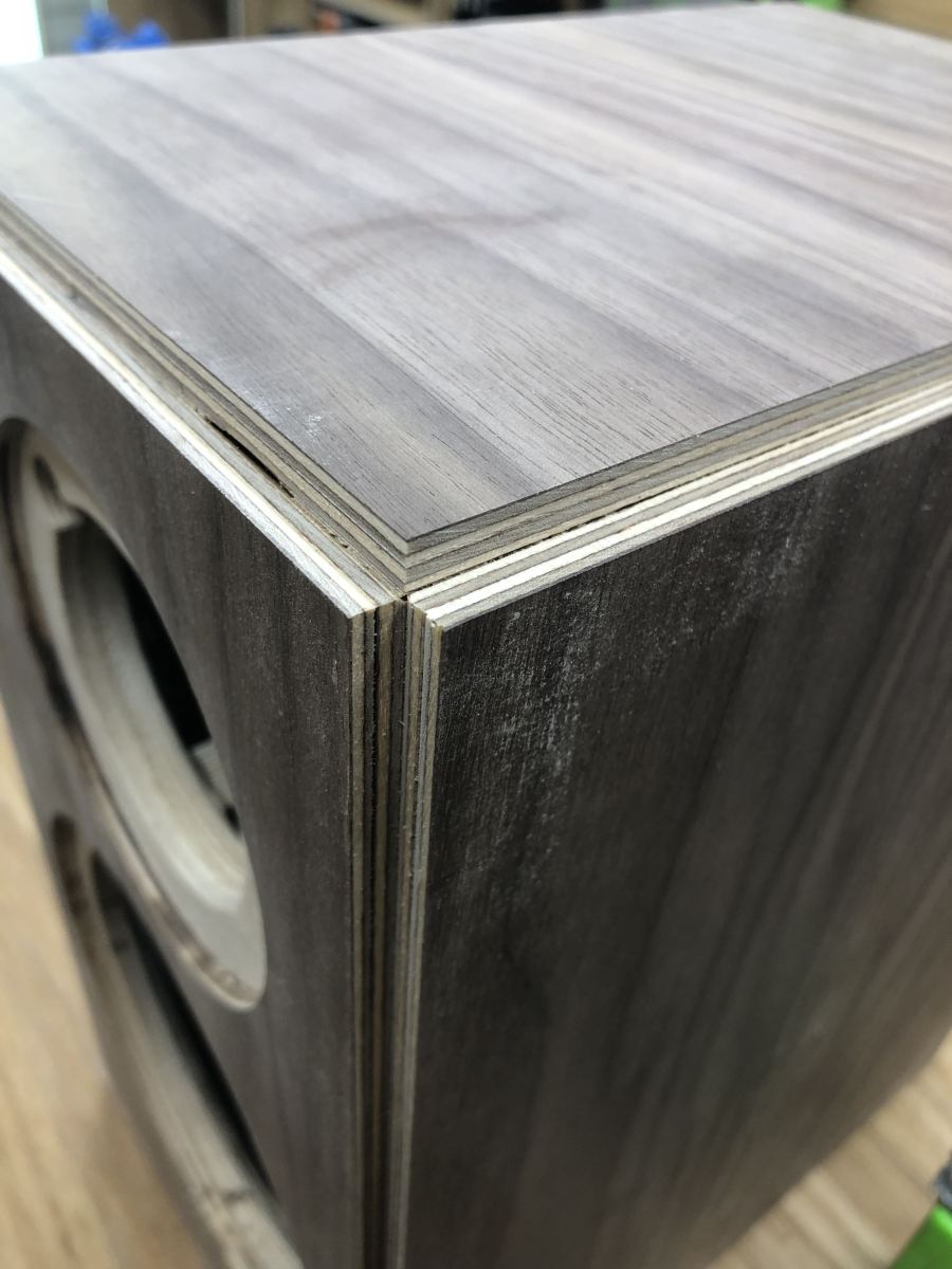

The speakers cabinets were made from 18mm birch plywood with American walnut veneer on both faces.

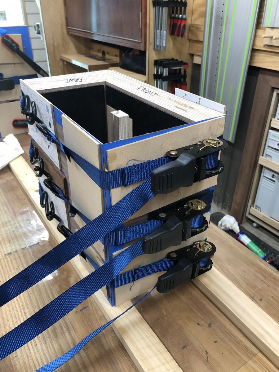

I mitre cut all edges & joined with domino’s to strengthen the join.
Prior to gluing together 3mm rubber sheet was glued to all internal surfaces
to further dampen the speaker cabinet from vibrations.
After glue up I then cut the corners out 6mm x 6mm and glued in solid 6x6 American walnut.
This allowed me to add a small radius to all corners which I sanded by hand.
After sanding all over I then oiled the cabinets using Osmo Polyx to bring up the grain & they look stunning.
I used a table saw to cut all mitred edges, router with circle jig for speaker holes, & Festool domino for cutting the domino holes.
It was a lot of work to build the cabinets but well worth the effort.
Unless you have the tools & experience in woodworking, I would order the kits with pre cut panels rather than build your own.

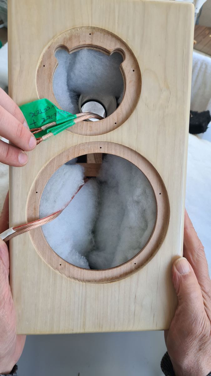

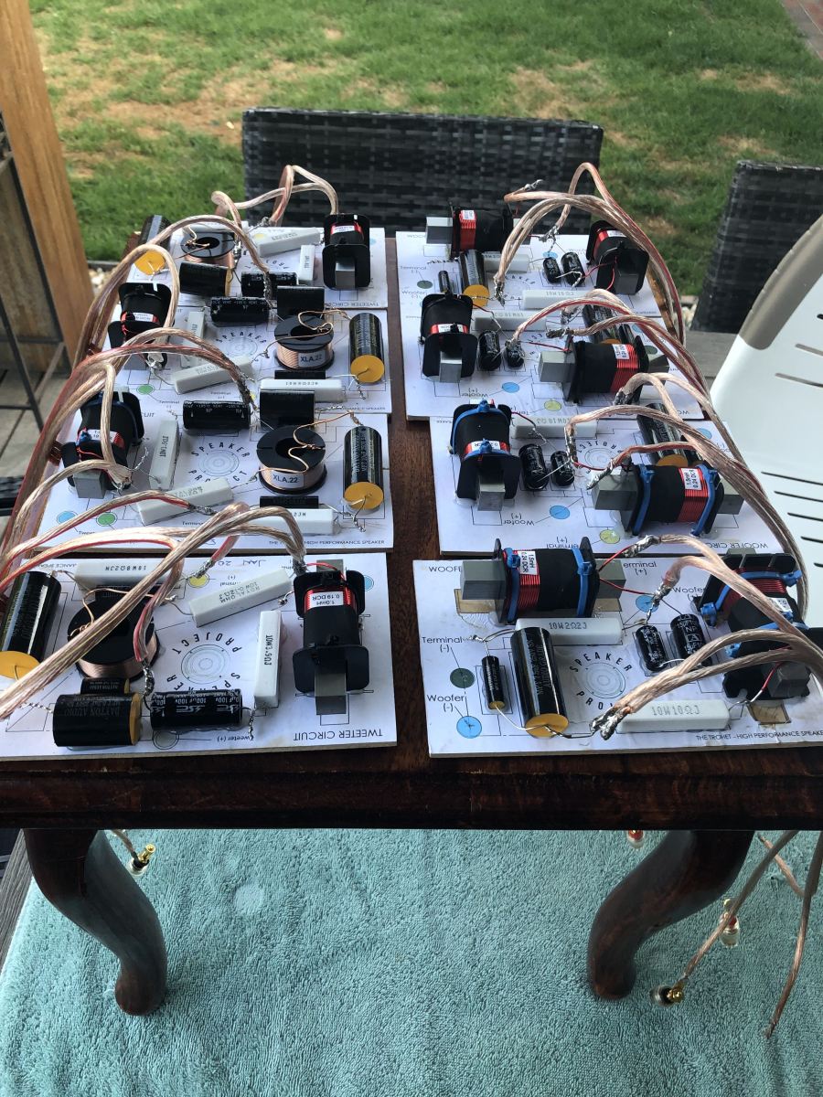

Cross overs had to be assembled and soldered together.
It was then a matter of gluing in the crossovers, filling with acoustic insulation & finally assembling the speakers.
I thoroughly enjoyed building the Trohets and Atlas was very helpful available if I had any questions.

Just an update on the system.
I purchased the Geshelli J2 DAC (AKM version) around 3 months ago, it has changed the tone of system to much more my liking. Everything that was good about the Trohets is now improved. The DAC presents a very coherent sound, that retains the lovely top end, but adds much more to the bottom end. The mids and bass are far more robust. The listening experience is even more enjoyable than it was before – I’m very happy with the Trohet + J2 pairing!
I also upgraded the J2 with Sparkos Labs opamps, it adds greater depth and texture to the sound. Making it sound even more lifelike. I’ve been able to complete back to back testing using the balanced output (TI1612) vs unbalanced (Sparkos) and it slightly improves an already wonderful product.
Geshelli is a small/family run business, their customer service is absolutely fantastic. Sherri and Geno were amazing help and so passionate about hifi. It was much like my experience The Speaker Project. Highly recommend the DAC, I just wish I ordered it earlier!
