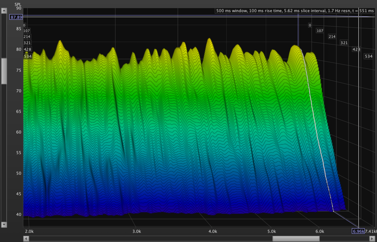

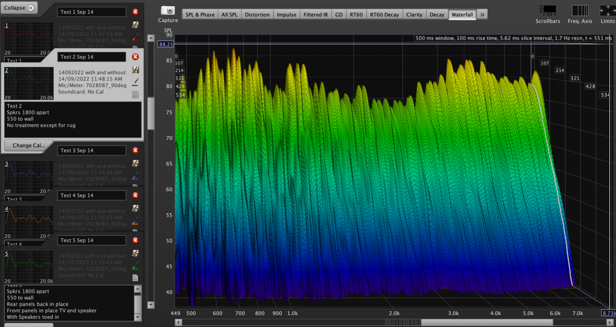

Waterfall:
First graph is without panels in place.

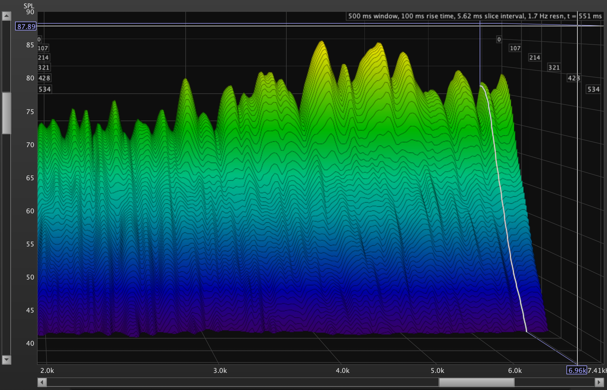

Second graph is with all panels in place. Decay times appear to have reduced a little and seem more uniform.

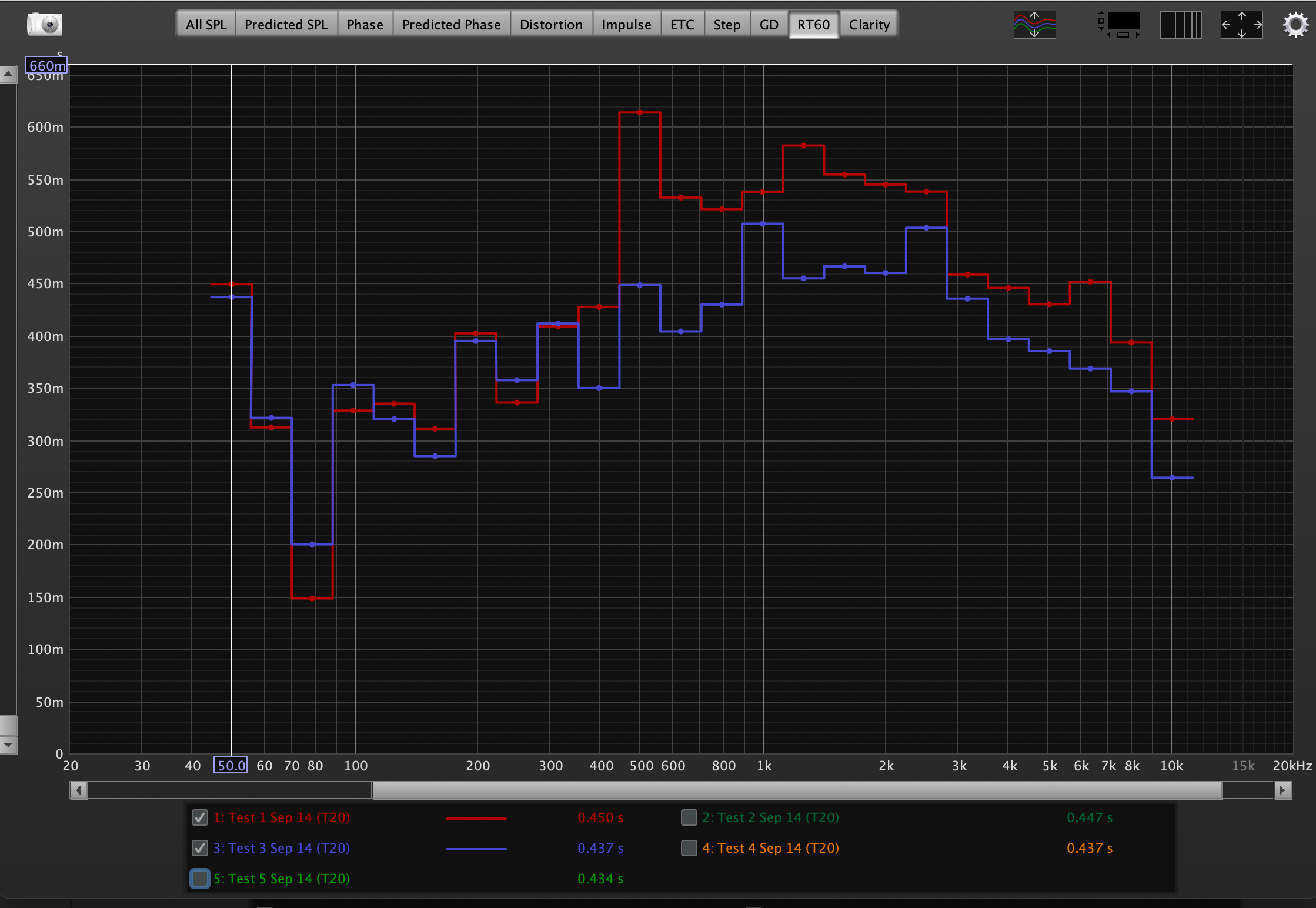

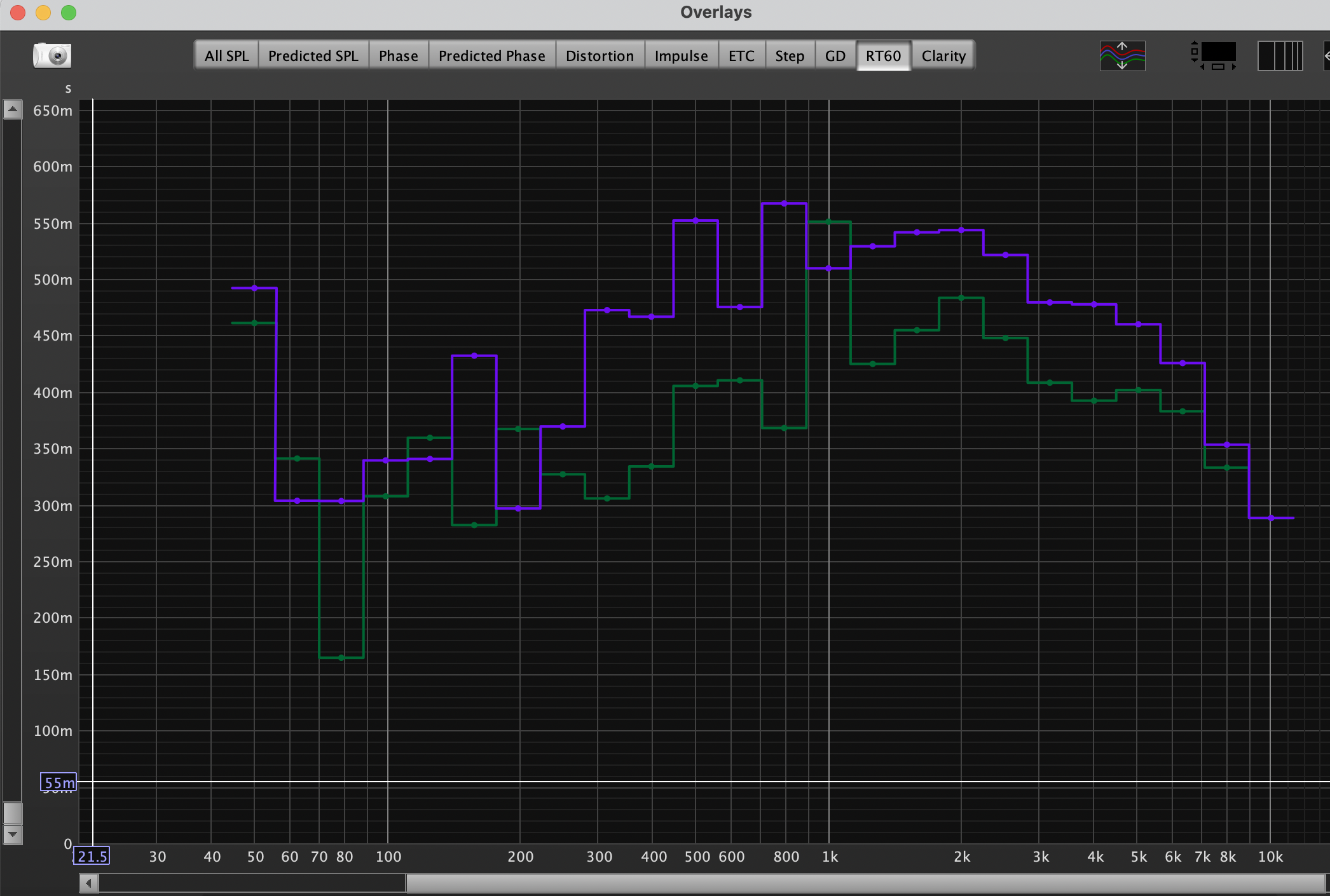

RT60
Overlay of tests with and without panels again.
Red line without panels in place, blue line with panels in place. Reduction in reverb from 450hz and up.
Now this was an interesting one. I have always run my speakers with no toe thinking it would be less bright. Today I ran a measurement with the speakers toed in and to my surprise the top end dropped a bit - how?
It's not a big drop but any drop is welcome. Yellow line is toed in.

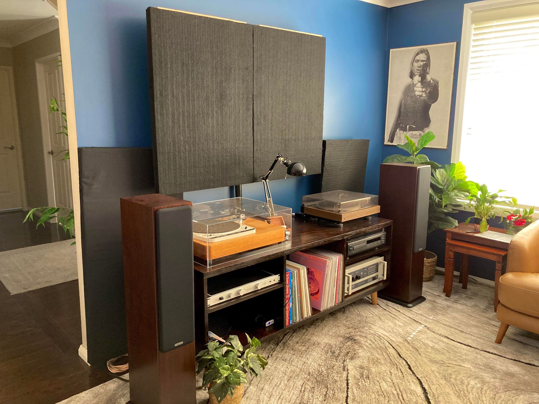

A pic of the front (unfinished) panels FYI. There is already a photo of the rear panels further up in the thread.

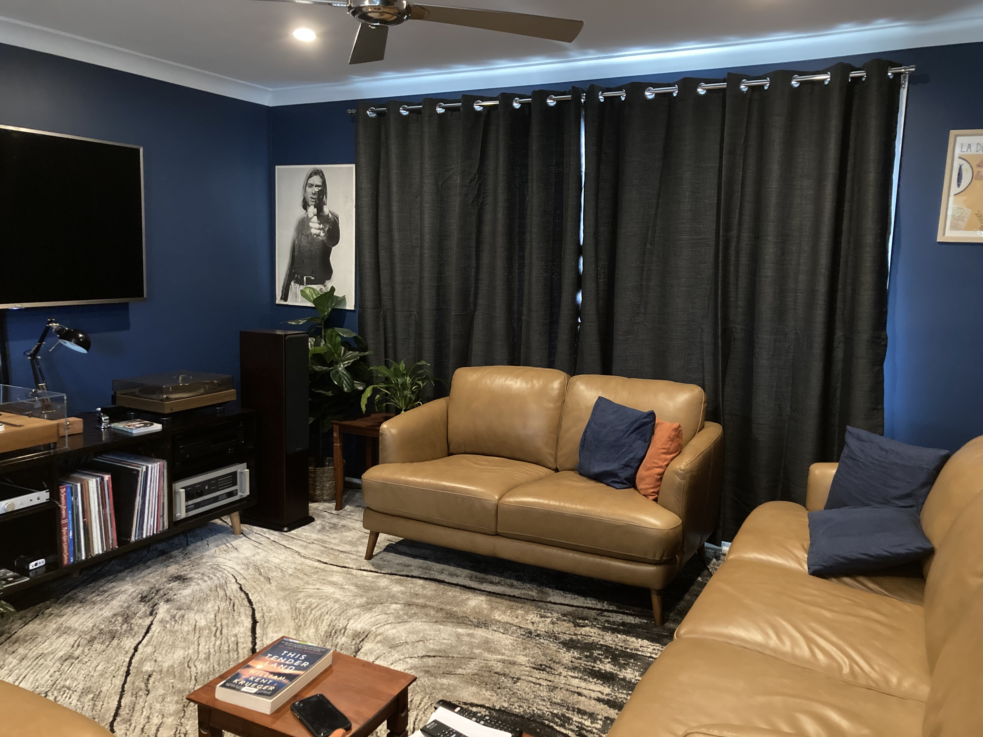

Thick curtain is in which will hopefully help first reflections on one side at least.
No listening or tests done yet.

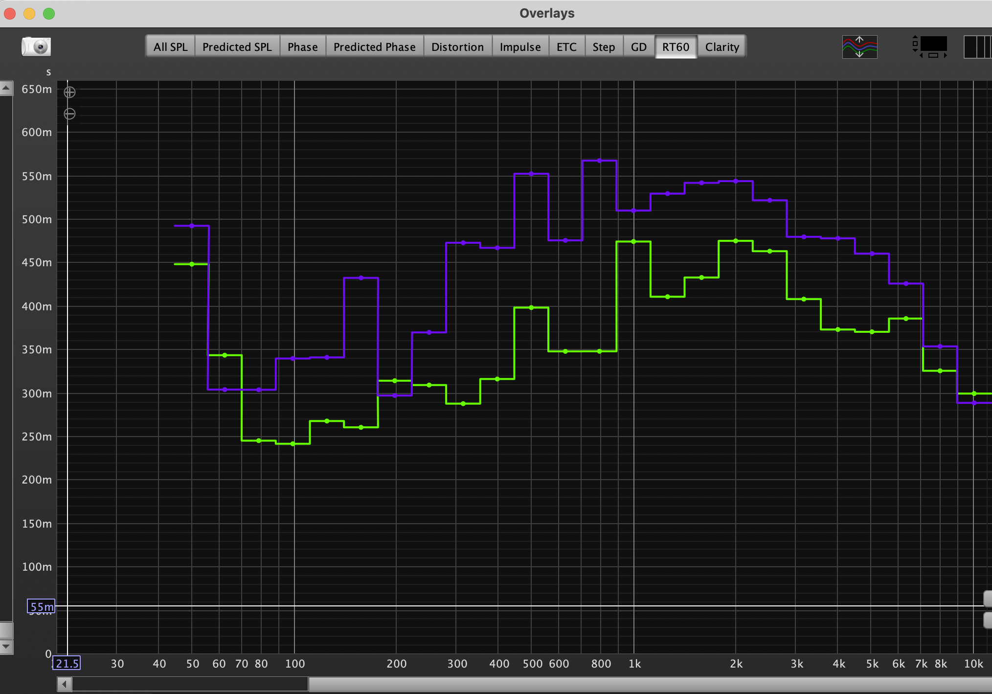

Ok I thought I'd close out this thread with where I got to for now.
I'm pretty happy with the decay and reverberation times in my lounge room considering the limitations that come with a shared room.
Here's an overlay of the RT60 comparing result of my current everyday listening arrangement to one of the early tests I did before the rug, panels etc...
A mostly consistent reduction from 300Hz al the way up about 6.5khz, with a peak in reverb still occurring at 1k.
Now when the fam aren't home and it's serious business, I put the panels in front of the TV, behind the speakers and even throw a rug over my leather lounges.
A little better than the above results right through and the peak at 1k has now dropped from around 550ms to about 475ms.
Waterfall graph looks good too with a reduction in decay across most of the range. Below only shows from 2k to 7k but you can see a definite and consistent reduction.

nice work!
If you have EQ capability I'd try to reduce the long decay times around 40-70Hz.
Reducing reverb further above 1K is easy - only thin absorption is needed.

Hi Andy,

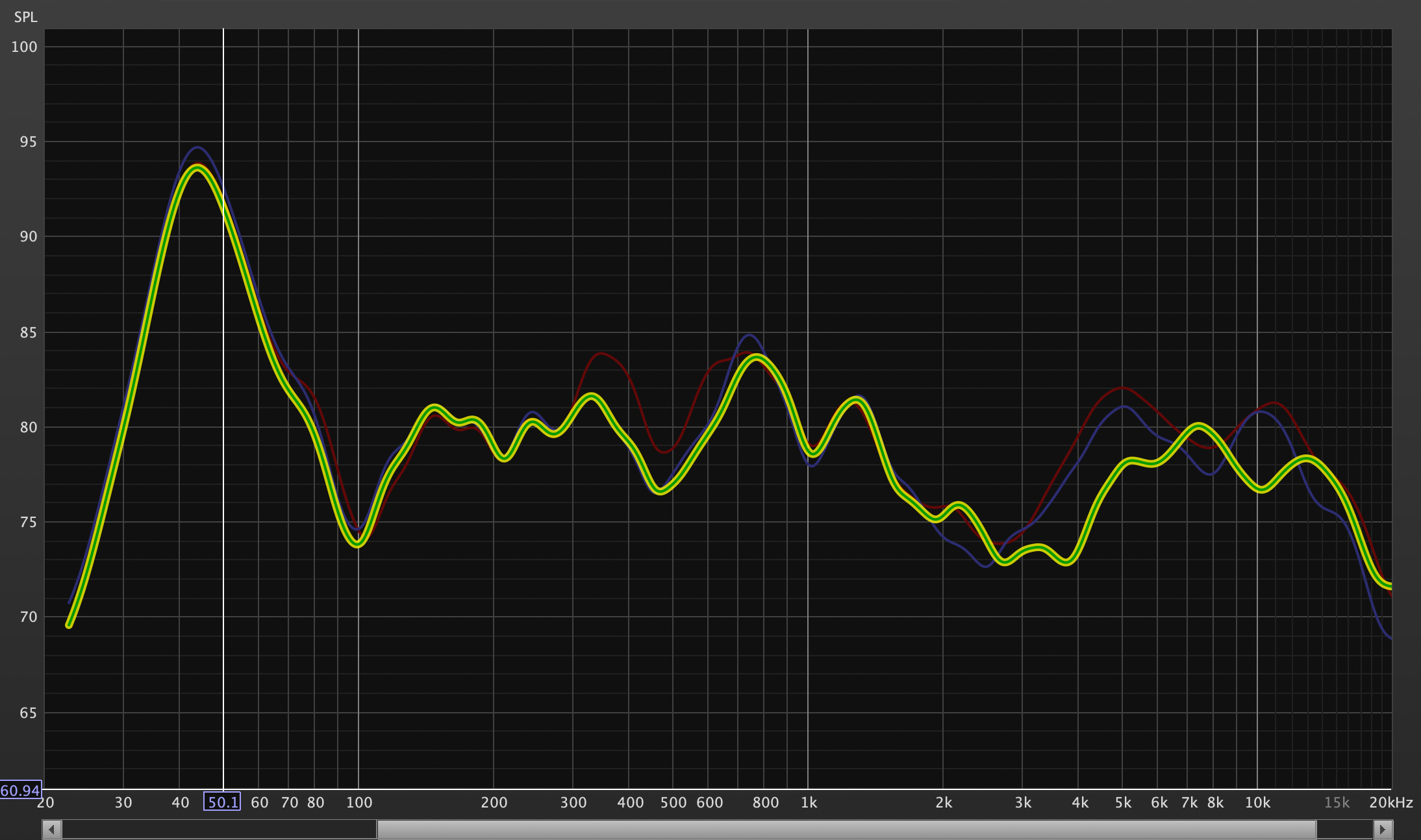

There's a reasonable chance those long decay times down low are caused by resonances that are  "minimum phase".
I always struggle to explain what "minimum phase" actually means - but a key feature of a "minimum phase" resonance is that it can be corrected with EQ in both the time domain and the frequency domain.
ie pull the peak in amplitude down with EQ and you will also shorten the reverb/decay time.
If you look at one of @Rustee's earlier posts, there's a big peak in the amplitude/frequency response just above 40Hz.
On 14/09/2022 at 8:59 PM, Rustee said:
A 40Hz peak like this would require specialist treatment - but there's at least a reasonable chance it will be minimum phase - and REW can measure minimum phase!...
https://www.roomeqwizard.com/help/help_en-GB/html/minimumphase.html
https://www.roomeqwizard.com/help/help_en-GB/html/graph_splphase.html#:~:text=Minimum Phase%2FExcess Phase&text=The minimum phase trace shows,the measured and minimum phase.
...and if that peak is minimum phase, then a band or 2 of EQ cut will bring the peak down and reduce the decay/reverb time.
EQ has a (deservedly) bad reputation - through poor application - EQ can do great evil!
Well applied, IMHO EQ can do great good to the "in room" sound - especially under 100Hz where room peaks are more likely to be "minimum phase".
There's a very good reason for the approach of only using EQ "cut" and not EQ "boost".
Peaks in the amplitude/frequency response are more likely to be "minimum phase" (but not always), and EQ cut will benefit where the response is minimum phase.
Dips in the amplitude/frequency response are rarely "minimum phase", and EQ boost will not benefit if the response is not minimum phase.

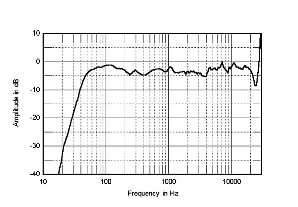

Monitor Audio Silver 8.
From the MA spec, the MF-HF crossover is at 2.7K .
Not sue if they have a rising response, from these Stereophile tests, there does appear to be a few peaks?
Cheers,

And thanks for the post above in response to @andyrand @Nada, whilst it makes my head hurt trying to understand it, it's informative posts like this that become priceless for people (maybe me one day) who are giving EQ a go.
Cheers,
Russ
9 hours ago, almikel said:
Hi Andy,
...a key feature of a "minimum phase" resonance is that it can be corrected with EQ in both the time domain and the frequency domain.
ie. pull the peak in amplitude down with EQ and you will also shorten the reverb/decay time.
Thanks for that, Mike - makes perfect sense!  :thumb:
I will have to examine my own REW graphs.  :classic_smile:
Do you hear a hot >3k still. Kind of a piercing quality?  Turn it up and the ears bleed sort of thing?
In the right system correcting the lift over 3K could make a dramatic difference.
If you are streaming its super easy to EQ.  Have fun :)

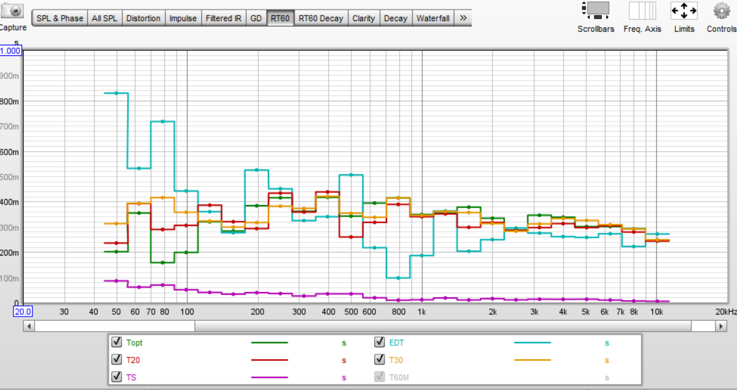

Hi @almikel - I'm wondering which graph-type with RT60 I should've selected for my RT60 graph?
Here is mine - including several graphs:
  • Topt
  • T20
  • T30
  • TS
  • and EDT.
Is my 'EDT' graph the same as what Russ selected, here (the green line)?:
Thanks,
Andy
