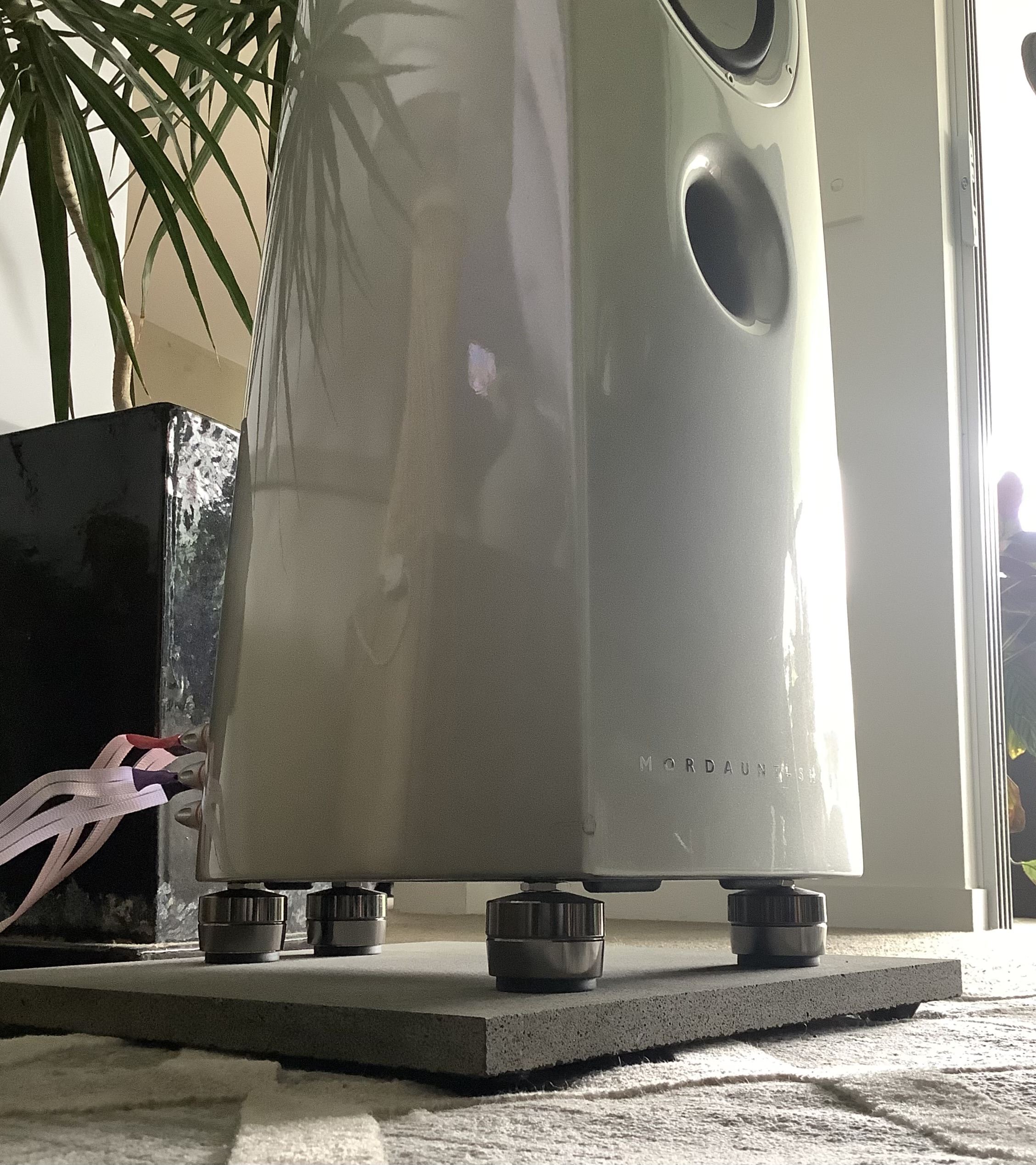

I have my speakers sitting on Bunnings granite pavers which have inexpensive coupling cones silicone to them underneath. This cost a fraction of what IsoAcoustics charge for their spike cups but, I estimate, work just as well.
Whilst Bunnings May describe it as Tuscan bluestone or granite, it is actually vesicular basalt from China and it has some audio component isolation properties that work very well.
The image you provide showing the Gaia feet combined with the basalt would result in a non optimal arrangement from my working with the Gaia’s and basalt.

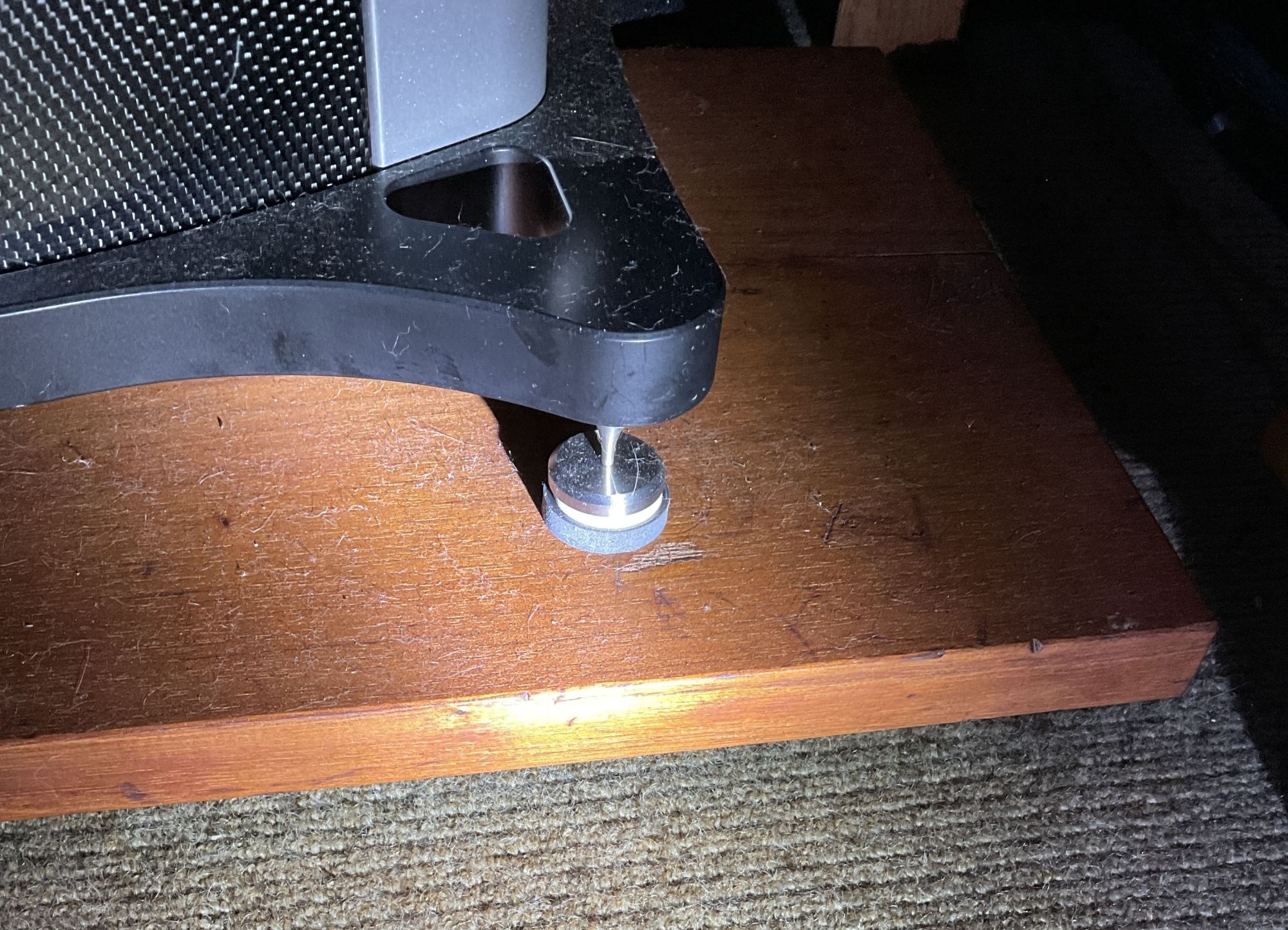

I have mounted my loudspeakers (35kg) on top of timber plinths (55x35x4cm) which have spikes going through the carpet into the flooring beneath.On the underside of each plinth I added some galvanised steel plates (Bunnings) for bracing purposes. My Wilson Benesch loudspeakers have downward pointing bass ports so the loudspeaker spikes sit upon a set of metal spike shoes creating an air gap of roughly 30mm above each plinth.
I recently bought a set of 8 "Big Fat Dots" which are adhered to each of the spike shoes. Results are pleasing........bass output is excellent and speaker vibration (finger on top of speaker testing device) is not excessive. Speakers are easy to "level" or to tilt backwards. The speaker can also be moved further out into the room if desired.Other options in my case are ISOACOUSTICS GAIA and or ENTREQ VIBBEATERS but they are very expensive and not sure if that is worth it.
NOTES: Timber used is camphor laurel stained/sanded......quite heavy timber type. Cost $70. Herbies Big Fat Dots cost about $15 each plus postage from the US (ouch)

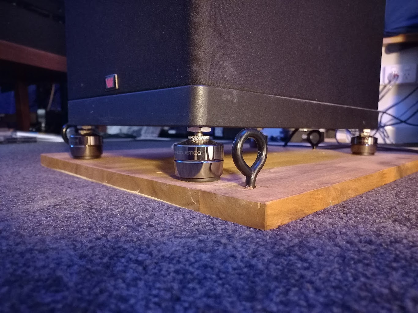

sharing my approach
board is from Bunnings - no idea of it's acoustic characteristics
using 75mm x 7.3mm eye hook screws to lift board off carpet and couple (maybe not as well as speaker spikes) to slab. initially 3x for each side, but now is 4x - there was a little wobble if pushed, wasn't sure it it was the Gaia's so went with 4. simple enough to level or wind out to slide around for placement. I've tried to show that a pencil can readily slip under but there is a minor degree of carpet-board contact
phase 1 - speakers on the ol' crowd favourite White's vibration blocks
phase 2 - speakers on Gaia
speakers are 32kg ea
no measurements or subjective thoughts on sound difference
