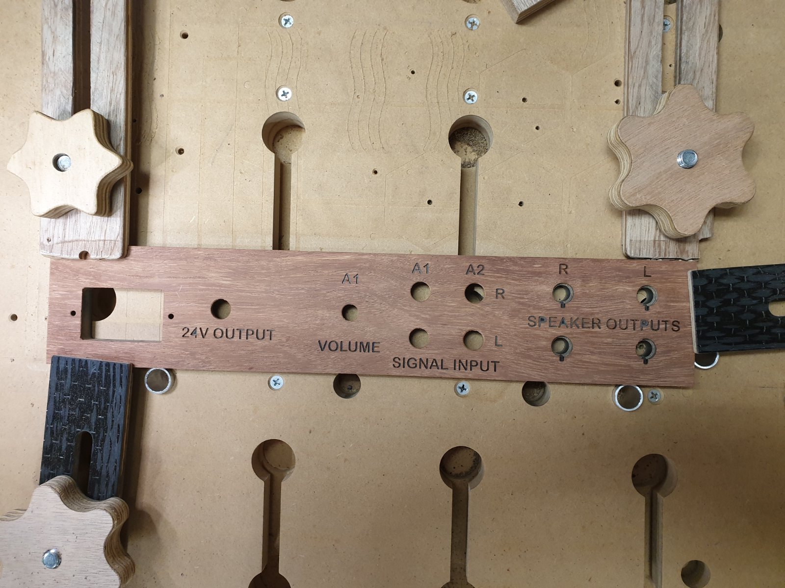

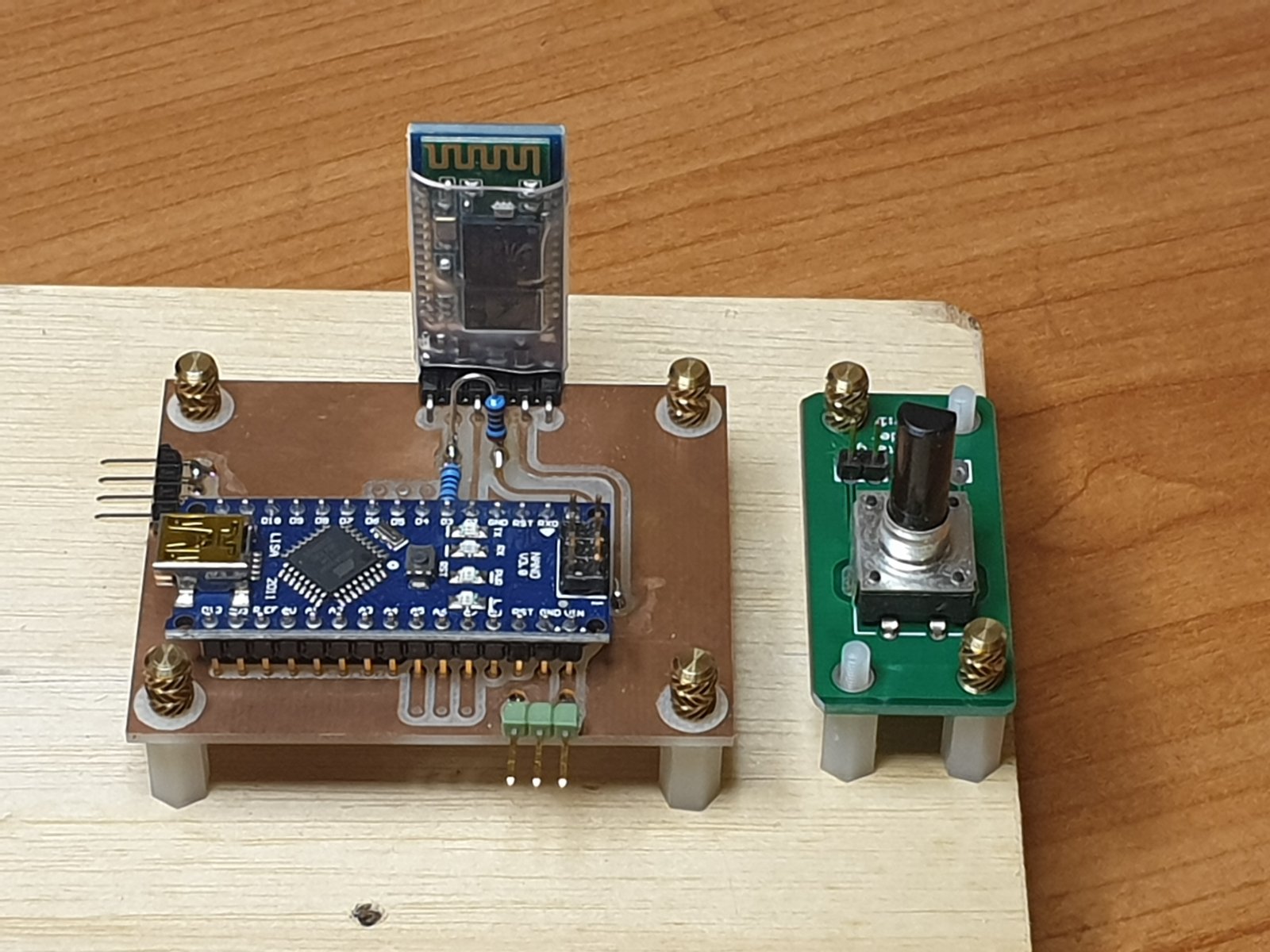

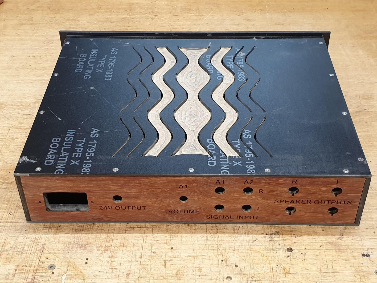

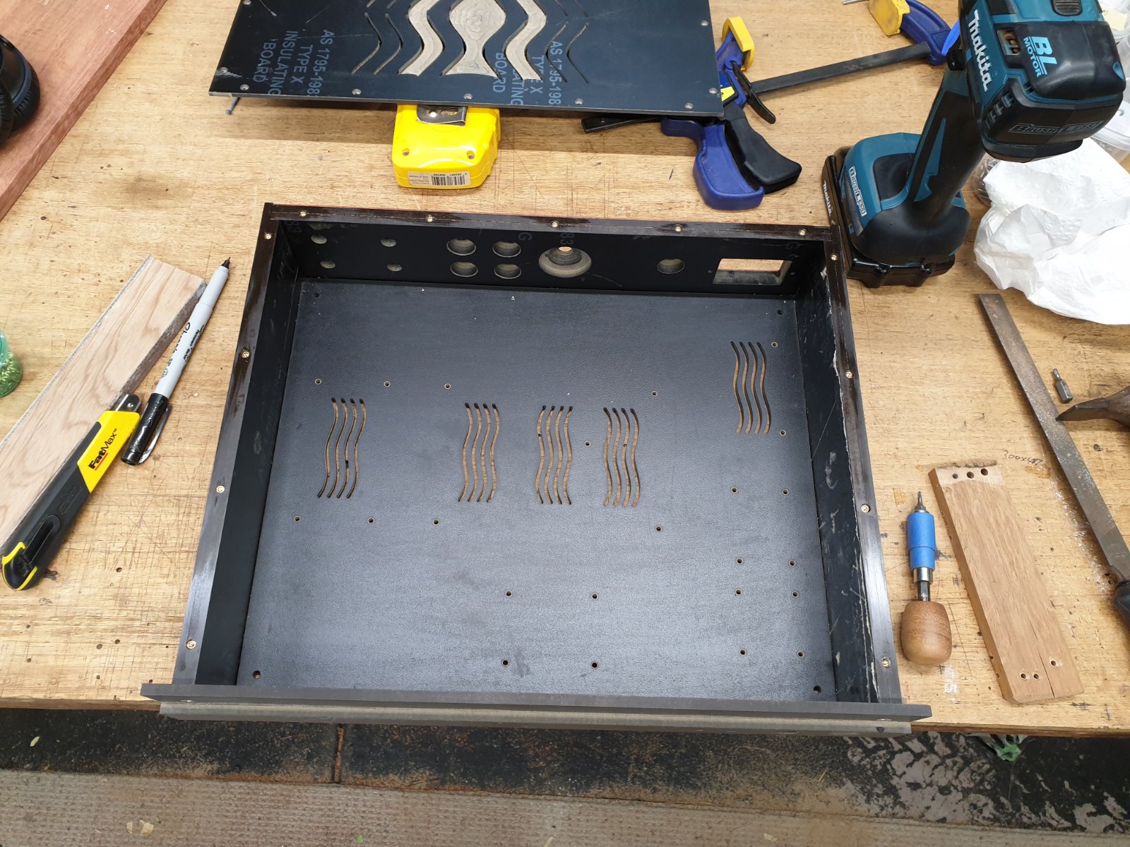

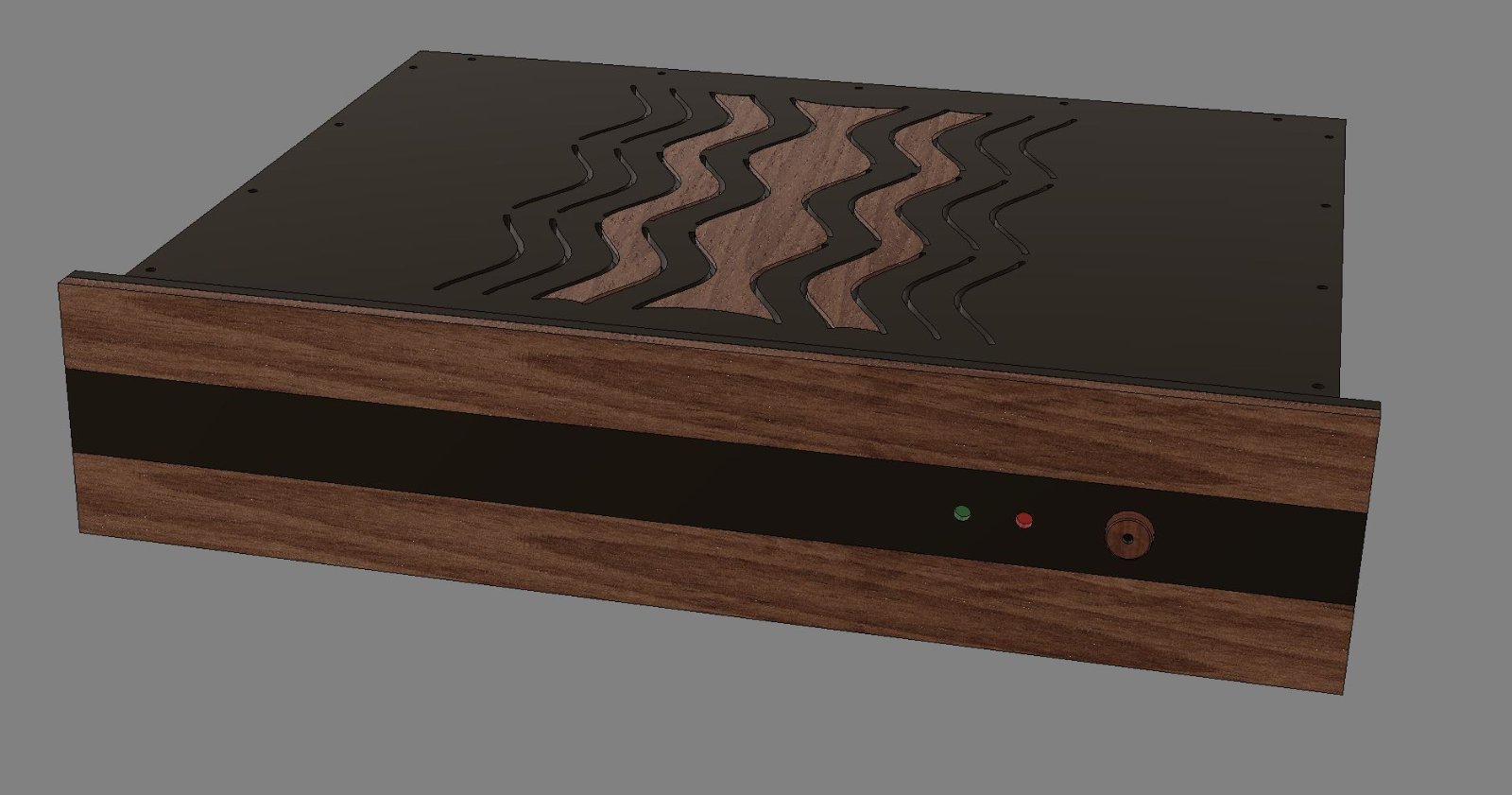

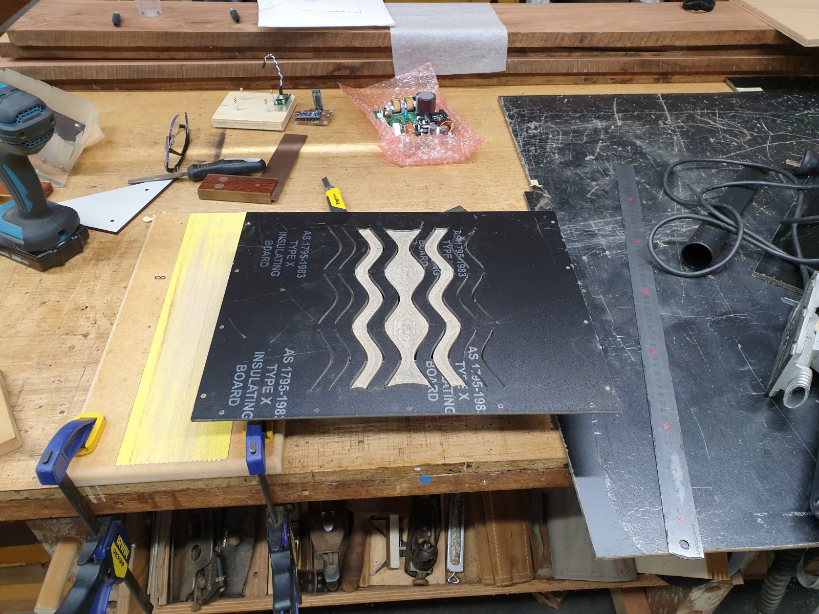

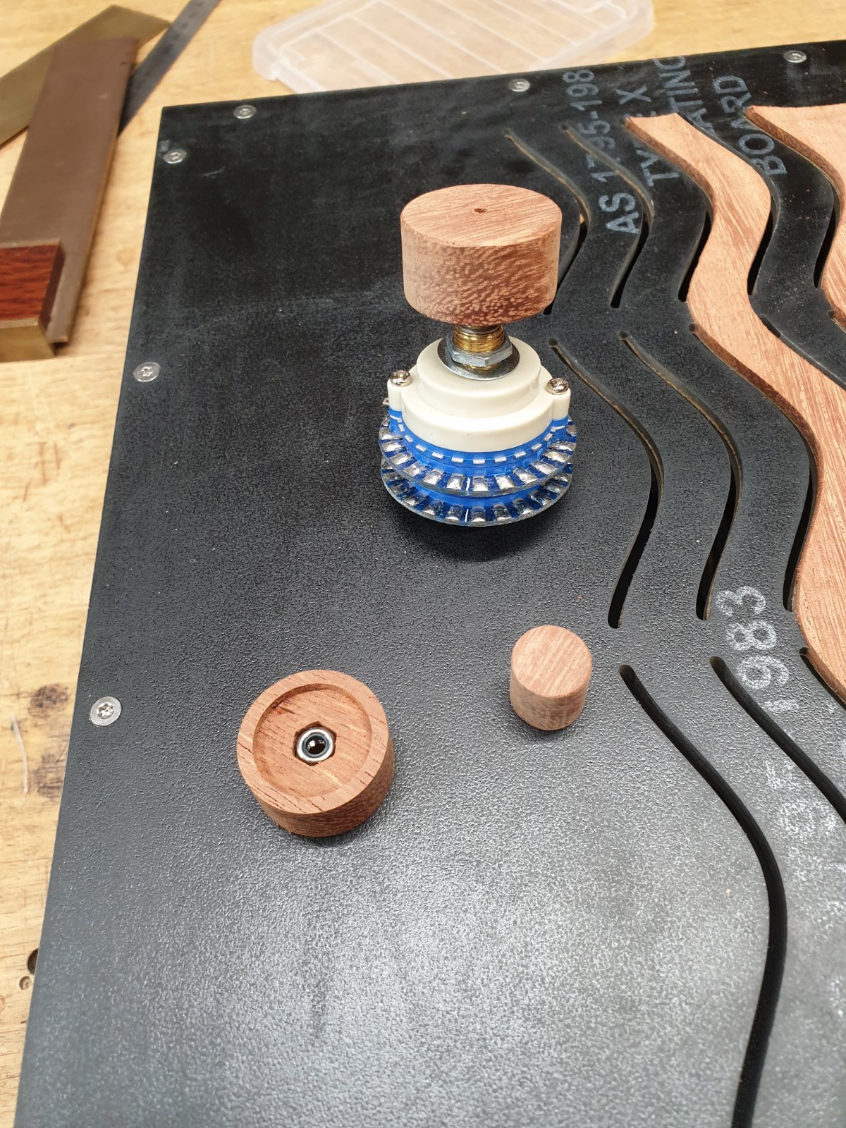

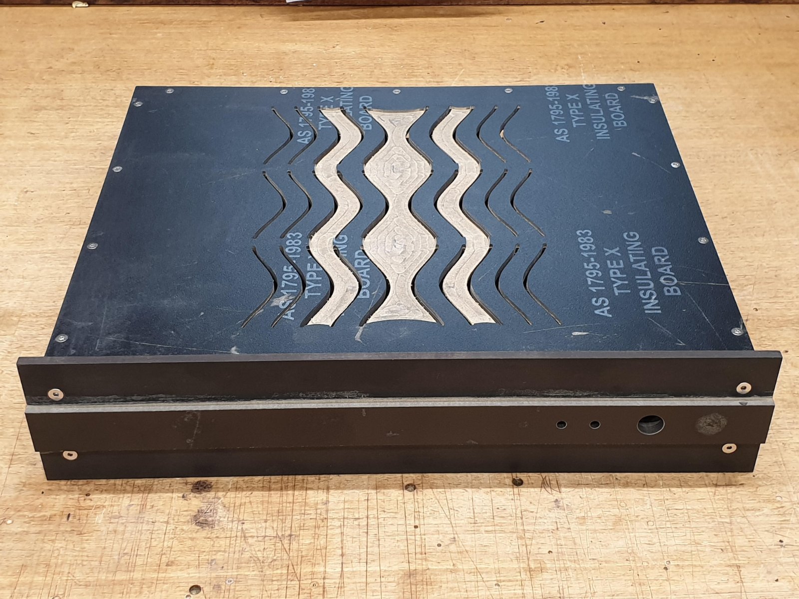

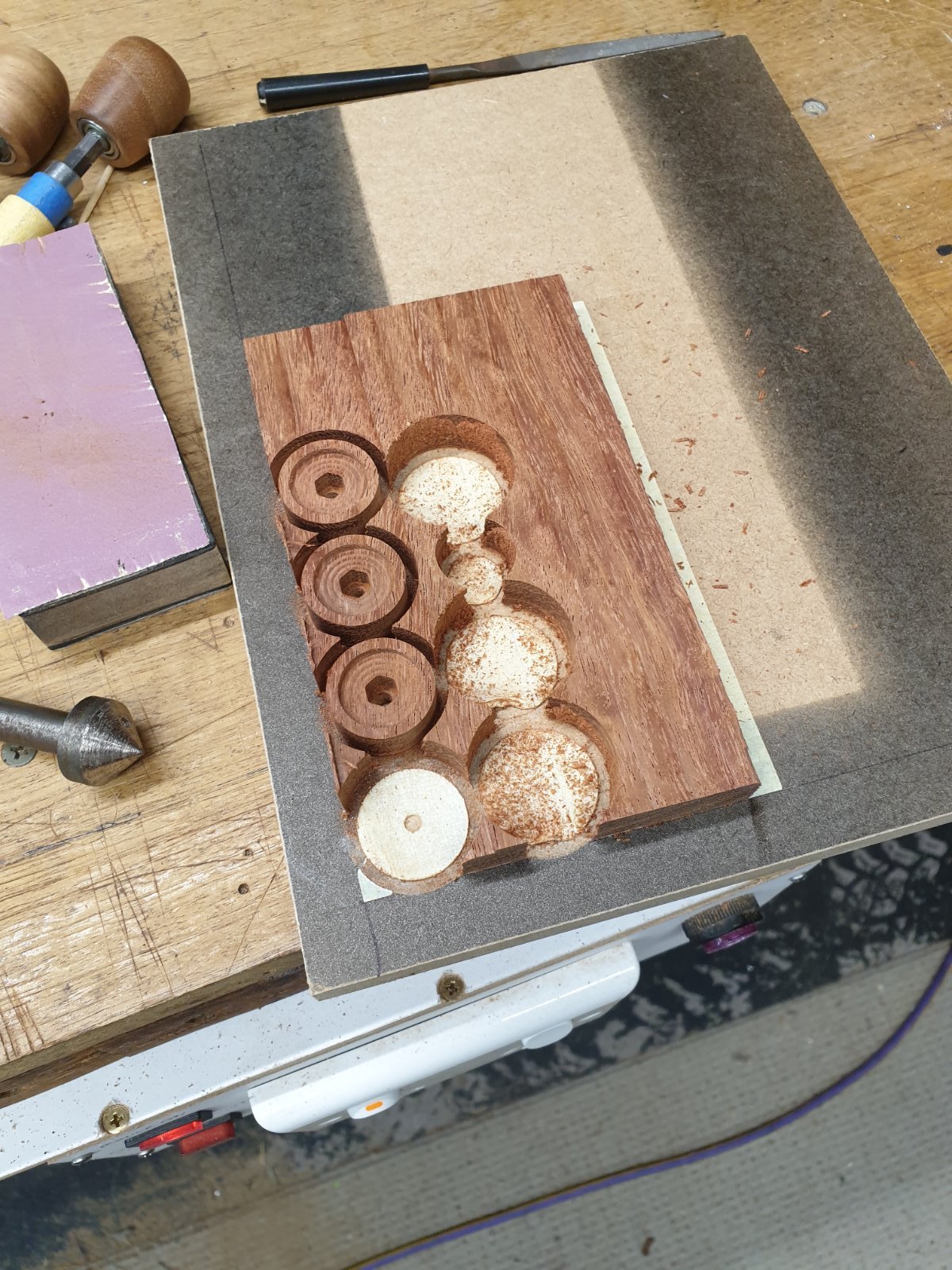

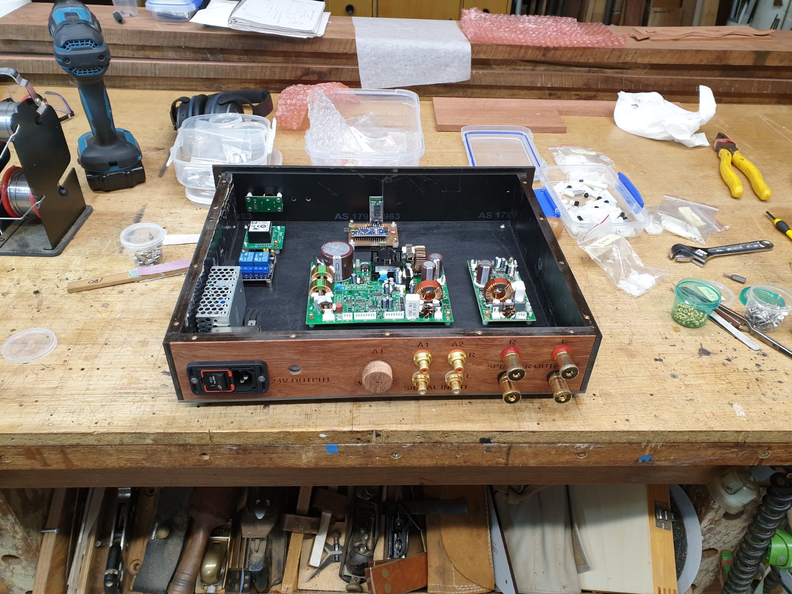

I’ve finally had the time to get my son's amp underway. I have had a lot of success using the IcePower amp modules so I am using the ASC300 - AC300 combo for his amp. I have just reconfigured his Korg Preamp and the 24V PSU for it will be in this amp. I would definitely have built the Korg differently if I knew then what I know now! This amp will control the pre as well. He will be able to turn this amp on via the button or via a Bluetooth app, probably easier to just press the button  The turn on and off will be sequenced using a Arduino Nano to avoid the snap crackle pop. The case will be made from Switchpanel X that will be sprayed with the usual texture coat and Brown-Bronze automotive paint. The trims and veneers will be from Red Sirus which has been my favorite timber for some year now. I like the Switchpanel X material but it is terrible on cutters! I drew the case using Fusion 360 and us it to produce the code for the CNC.

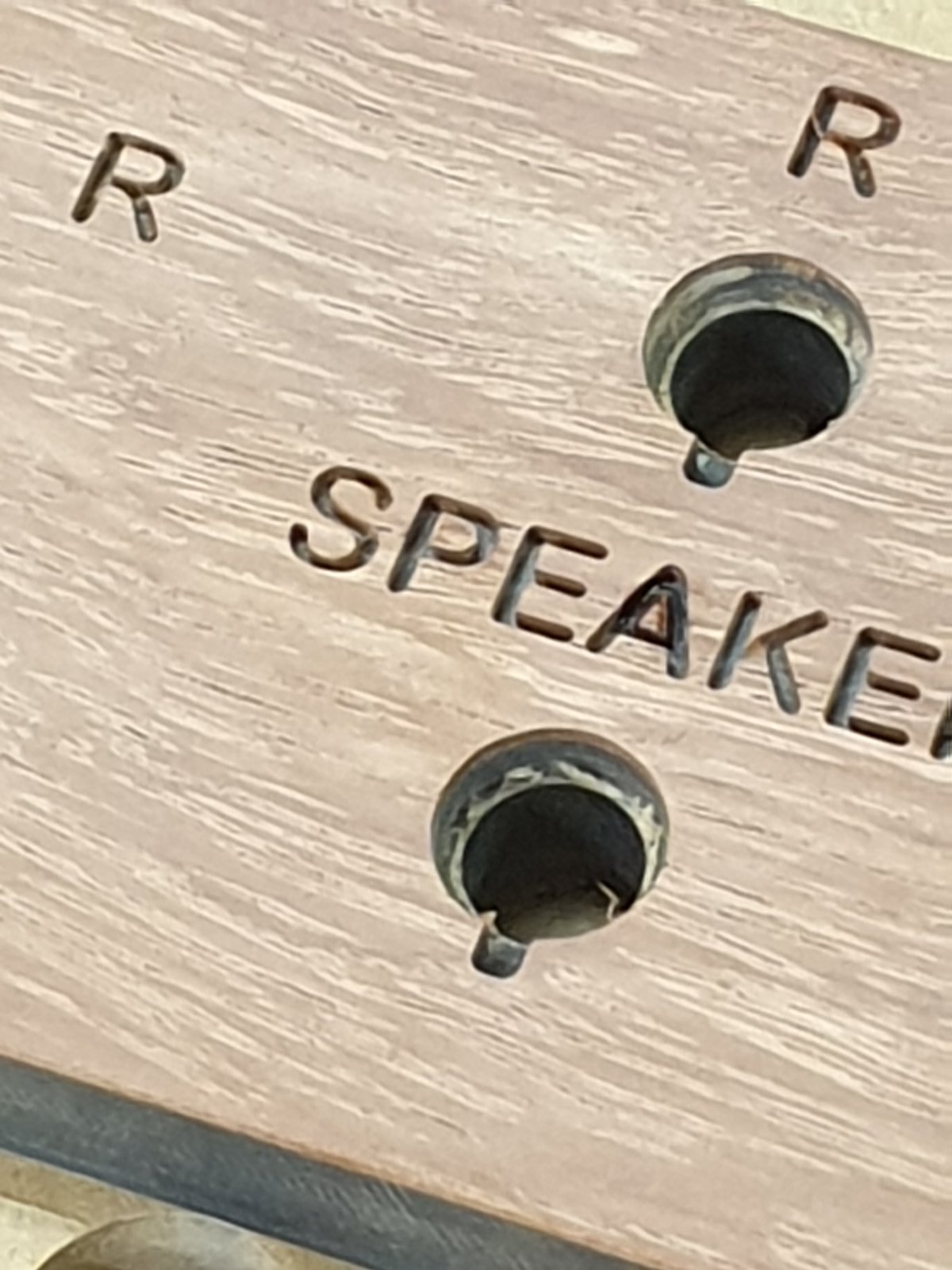

Today was very frustrating, lots of hours and just as many issues. I lost the center pieces from the 4-P-A-P (the text I engraved) and had to spend some considerable time supergluing tiny pieces of veneer in and redoing the engraving, I was amazed it worked!

Wow. that is real skill engraving and the wooden box looks sensational. Love your work..?
May I ask how you engraved on wooden board? Please do not tell me you used engraving pen to write all those letters with hand. ?

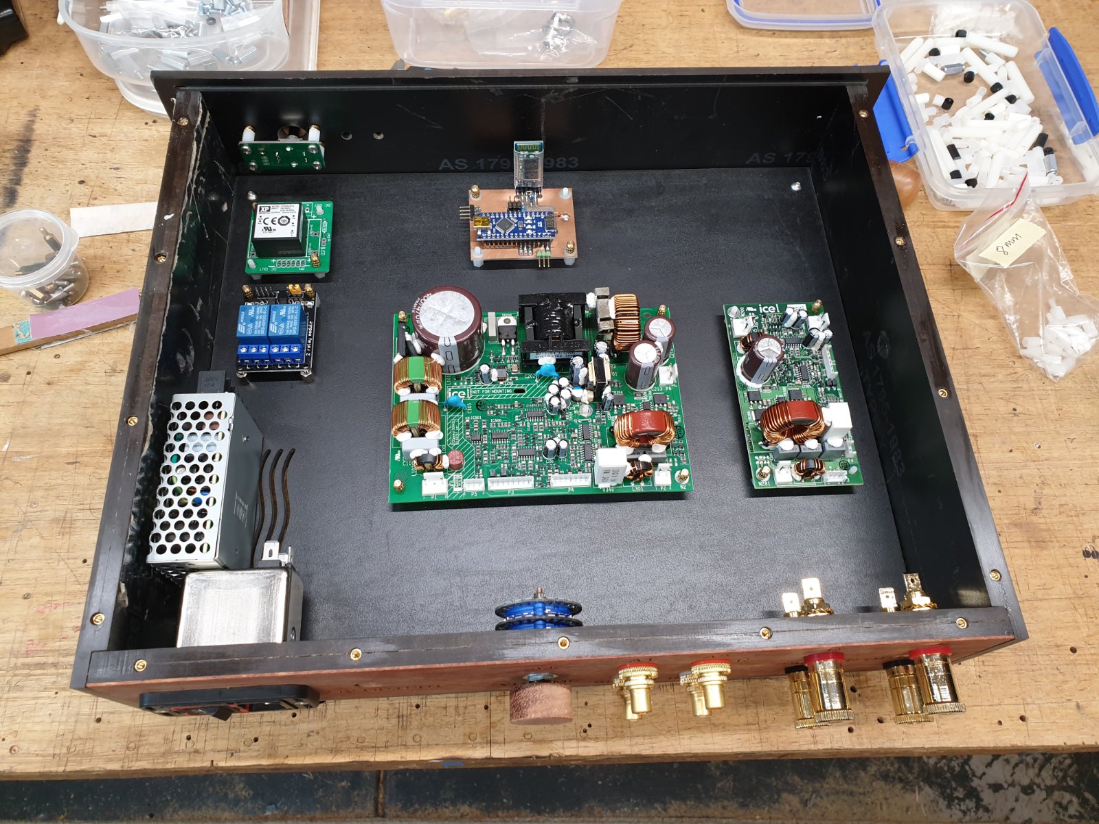

This is really beautiful work and I admire your skill.
There is however another reason apart from cost why amps - and stage amps in particular - are made from metal.
It is to keep amp's interference from coming out it and for the amp itself be more immune from interference trying to come in.
I would perhaps line the inside of the box with some copper sheeting.

Thats what I did with the Preamp but I'm going to see how this goes first!

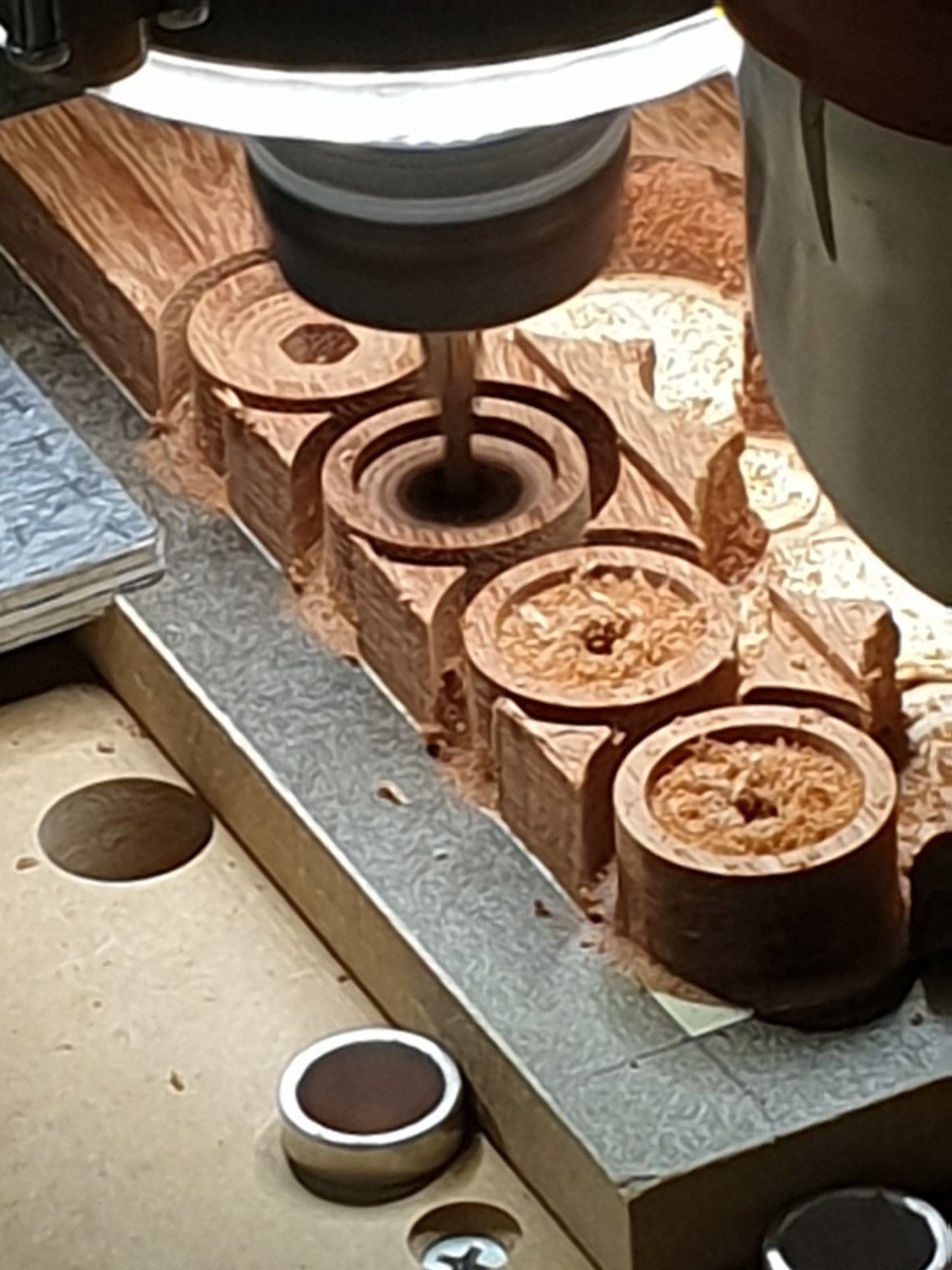

11 hours ago, DQ828 said:
I used the CNC I built, best thing I ever made

Made some progress, the case is almost ready for a test assemble. I usually get the whole thing working before I disassemble and paint the case just to make sure I dont need any extra holes :)
