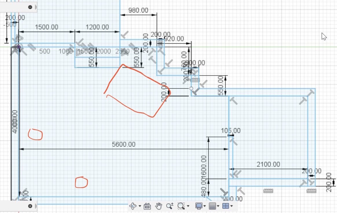

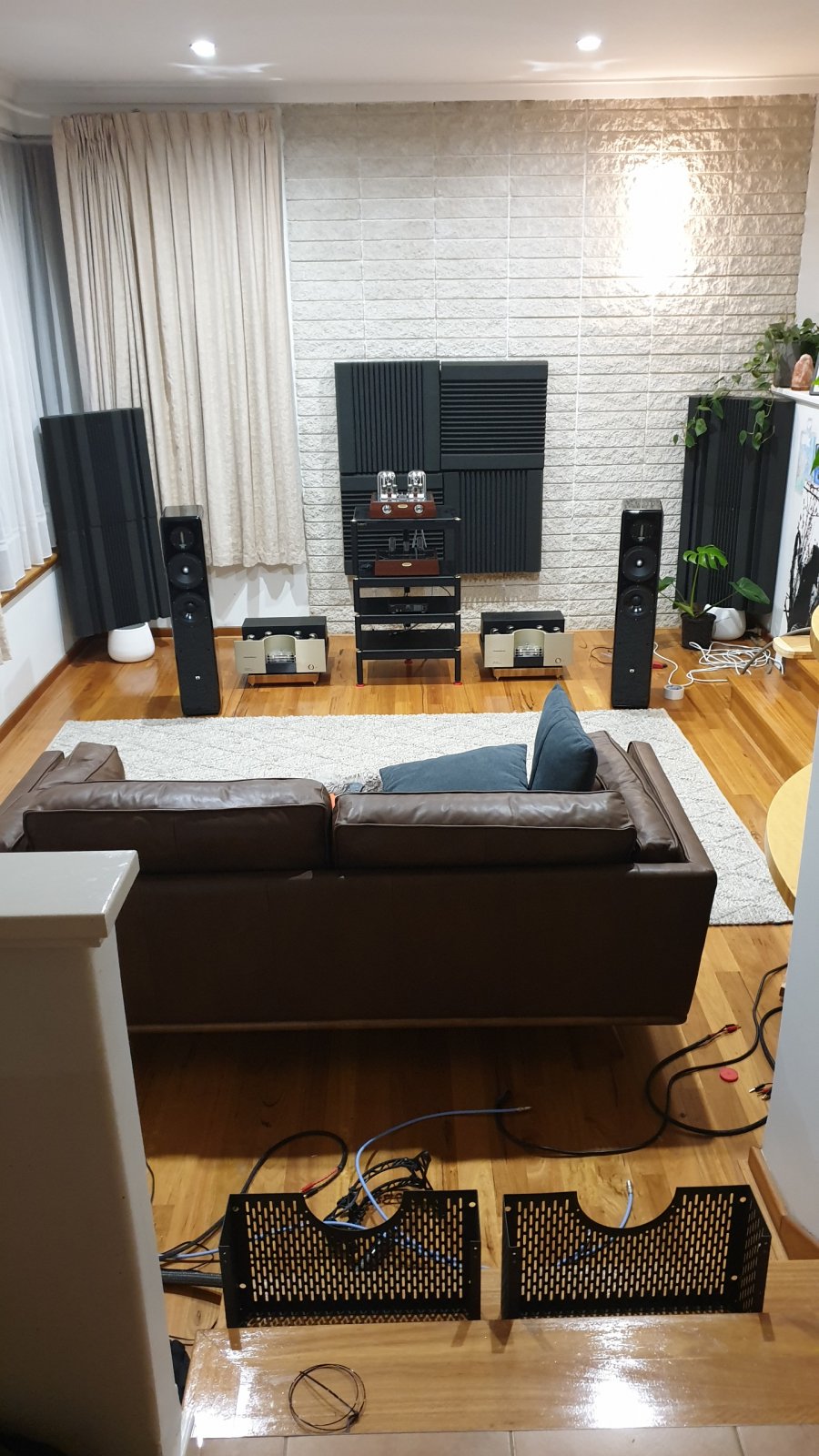

Speaker Position :|
Got some help today. LOL
No idea if this is ideal position, my room is kinda messed up.
Happy to take all recommendations on board. :)

  • Took the advice, missus will have a shock when she comes home tonight ?   Going to hook it up and see how it sounds. Room feels much bigger looking this end of the room.
  • Time to start again. ?
  • Would be better the opposite end of room on the 4m window width end to achieve the recommended equilateral stereo listening triangle, speakers 0.7-1m away from side walls and out, 3m to seat. Treat wi
hi @Pasic007 it looks like it could be a tricky room to deal with; hopefully my reply bumps your thread to the attention of some others on SNA who have dealt with a similar room and got the sound sorted out ok.
The only obvious thing i can suggest is to move the right-hand speaker further away from the wall.  It looks like the room is effectively 3500 to 4000mm wide (4000 at the back but with some rebates at the left front) so following Dynaudio's 'rule of fifths' try having the right (and left) speakers positioned so that the centre of each speaker is around 700-800mm from the side walls.
Try that as a starting point, and tweak from there...trust your ears...or your rabbits' ears ?

Ay yay ay.  To toe-in or not to toe-in.  Position is key, but also such heavy toe-in like that will impact your sound, particularly the sound stage.  Don't forget to tweek that as you move them - you could have the perfect position but too much toe-in.
  • Author
you are 100% correct, i got more sound stage as i dialed the toe-in down.
I miss read the manual as it mentioned having speakers positioned at 45deg in relational to person and it was talking about toe in so yeah i assumed speakers were meant to toe in to 45deg as well haha.
Good pick up, thanks.

Would be better the opposite end of room on the 4m window width end to achieve the recommended equilateral stereo listening triangle, speakers 0.7-1m away from side walls and out, 3m to seat. Treat windows with thick curtains.
Yes agreed, less bass problem.

Neat room plan and video at the start Pasic007!     Impressed an old luddite like me.
2Brix mentioned Dynaudio's "rule of fifths".
To find out a bit more about that, and for a lot of great advice from Dynaudio's guru Roland Hoffman,  google "A masterclass in speaker placement" -  on Youtube.
Roland covers all of the things which others SNA members have mentioned and a whole lot more, including what to do in odd shaped rooms etc.
Based upon what Roland will be showing you, can't help but agree with Al.M and TDX, and wonder if swapping the whole set-up 180 degrees is worth trying. i.e. speakers near the "open" wall (where seating is at the moment, seat nearer the front door entrance area). Will be surprised if you don't like what that set-up creates in terms of sound.  Will also enable you to have more distance between your seat and what will be the new rear wall (near the front entrance). Could also open up ease of movement to/from front door?
With greatest of respect to your g.f., would like to suggest that negative energy flows in the room will not be created by doing this.
Anyway, Roland's 44 minute masterclass will be time well spent.  At the end of it you will have a solid idea about  what  the amount of toe-in does (and how to work out how much/how little toe-in you use), speaker placement (including how to work out the distance from rear and side walls, listening position relative to speakers and rear wall, finding the best position for mid/base balance, fine tuning the set-up etc etc.
Looks like you have some nice gear, and  a nice listening/living room.  Enjoy.
Will be interested to know what you end up with in terms of the room and equipment placement, and the factors that influenced your final set-up choice, if you are happy to share that later on.

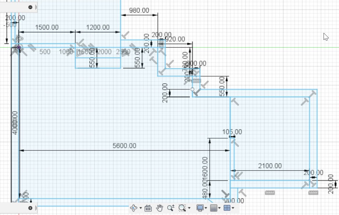

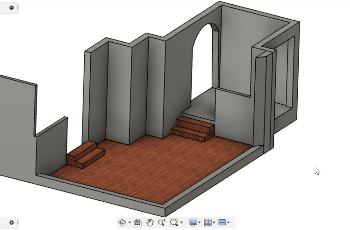

 Thanks mate,  I cant take all the credit my 8yo girl done half the work, It's pretty easy to draw things up in fusion.  She has been very interested since our little project. I might have an architect on my hands.
I had look at youtube video, there was few others i came across as well that were helpful. Before i can move speaker position i need get some longer cables. I am actually thinking of getting something like Power plant P15. and run the mono blocks into it.  Room has single power outlets in each corner.. not handy lol.  Other alternative is to get a sparky in and do 3 dedicated lines.

So late last night once everything was connected and heated up i had listen to few tracks and i was suprised at how much more bass there was not just in the seating postion but in the whole room!!!

Hello Pasic007.
Not surprised that the bass has improved in the room with the new set-up. If it appears to be "too much", go back to Roland's video where he explains how to get the bass happening "right", and how to get the mid/bass balance sorted. (he also looks at adjusting the toe-in to sort the treble - you will have watched that aspect).
One question - You may already have the prime listening spot in the seating position right in the middle of the right hand side of your couch. If however, you have enough room to move the couch maybe 30 cms(?) roughly, to the left as you are facing the speakers,  while keeping the main listening position in the centre of the right hand part of the couch, that may open up a bit more space on the right hand side of the couch for movement from the stairs behind the couch, into and through the room? Will of course put the left hand side of the couch a bit closer to the wall, but that doesn't appear to be an important "movement corridor"?
I hope that the above makes sense?
May not be an improvement - only a thought after looking at photo of latest set-up, which, incidentally, I think looks terrific, and is certainly the way I would have set it up.
One last thought - "davewantsmore" (based upon other comments he has made on SNA) has almost certainly forgotten more than I and most others have ever seen/read about speakers and their placement. I would think that it is always worth listening to/considering anything which he says or writes.
You have done the heavy lifting with the gear - enjoy the music for a few days as you adjust to the new set-up and do some fine tuning.
