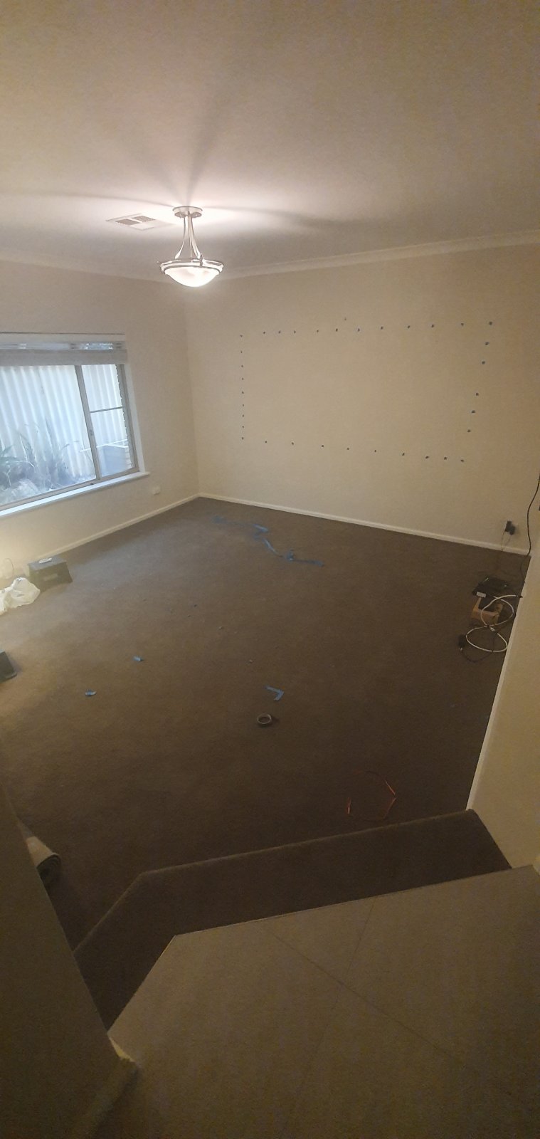

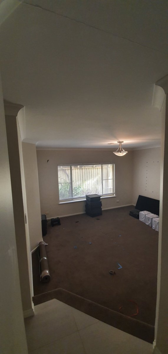

My wife and I are starting our home theatre build. We wanted to start it back in January. But with covid 19 that put a hold on all spending. But now we're back on track and ready to get started

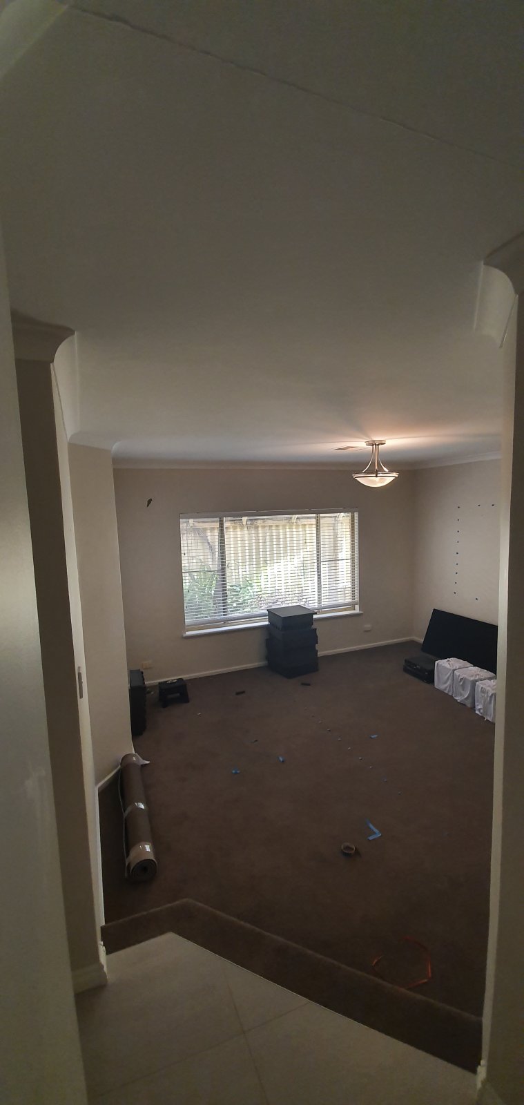

Our room is a sunken lounge room that is 4.3mx4.5m with a 2.7m ceiling. There is a large window that we will brick up, also there is no door to this room. So we will either be installing a door, or a couple layers of heavy curtains. I also need to build a frame/ cabinet to house everyrhing. Plus rip out the carpet for something much darker. Also put in a bunch of sweet lighting and acoustic panels

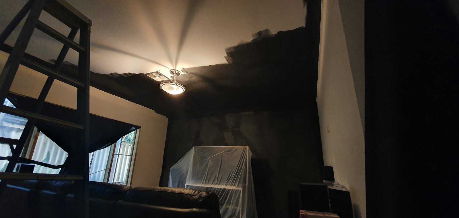

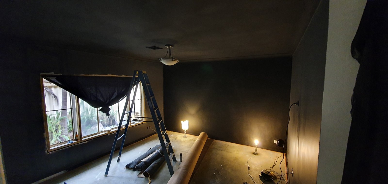

  • Painting has started. We went with the dulux home theatre black for the front wall and ceiling. It looks really good, but I've heard its a nightmare to keep cleans. So I didn't want any of the walls t
  • Big day today. The new sony vpl-vw590es!! Can't wait to see what this looks like with my anamorphic lens
  • Author

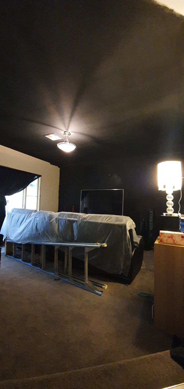

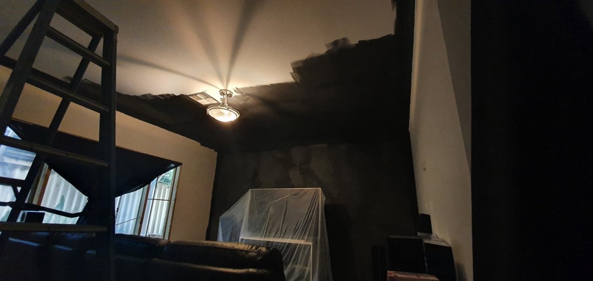

Painting has started. We went with the dulux home theatre black for the front wall and ceiling. It looks really good, but I've heard its a nightmare to keep cleans. So I didn't want any of the walls that people might touch to be that colour. So we weren't without of the darkest charcoul colours that dulux offers. The black was also really hard to get a nice finish, you definitely need to buy good quality rollers to get any kind of decent finish, just FYI

yes some of the "black" paint is a pain to work with and yes the rollers/brushes used make a big difference. points for doing the full ceiling and dark carpet, too many forget the room is a "cinema" style not a family room.

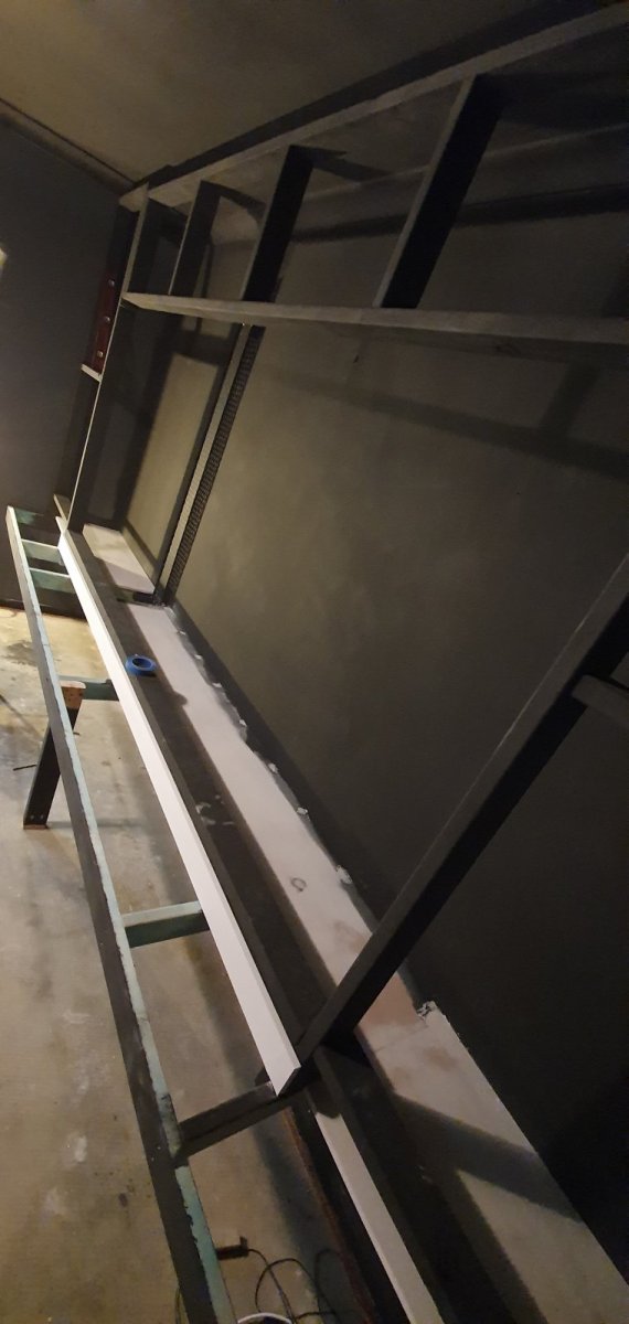

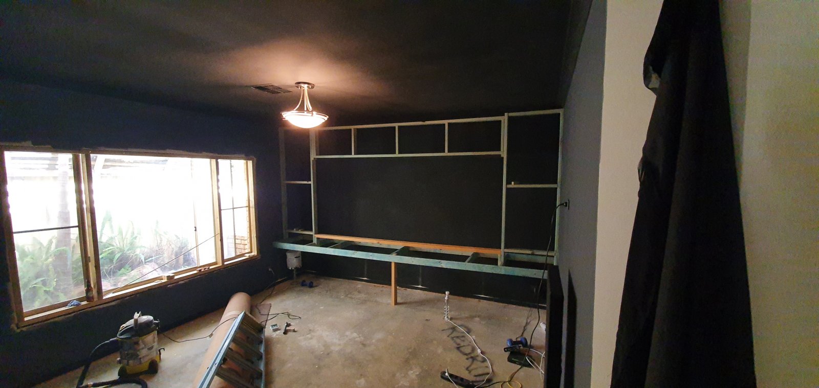

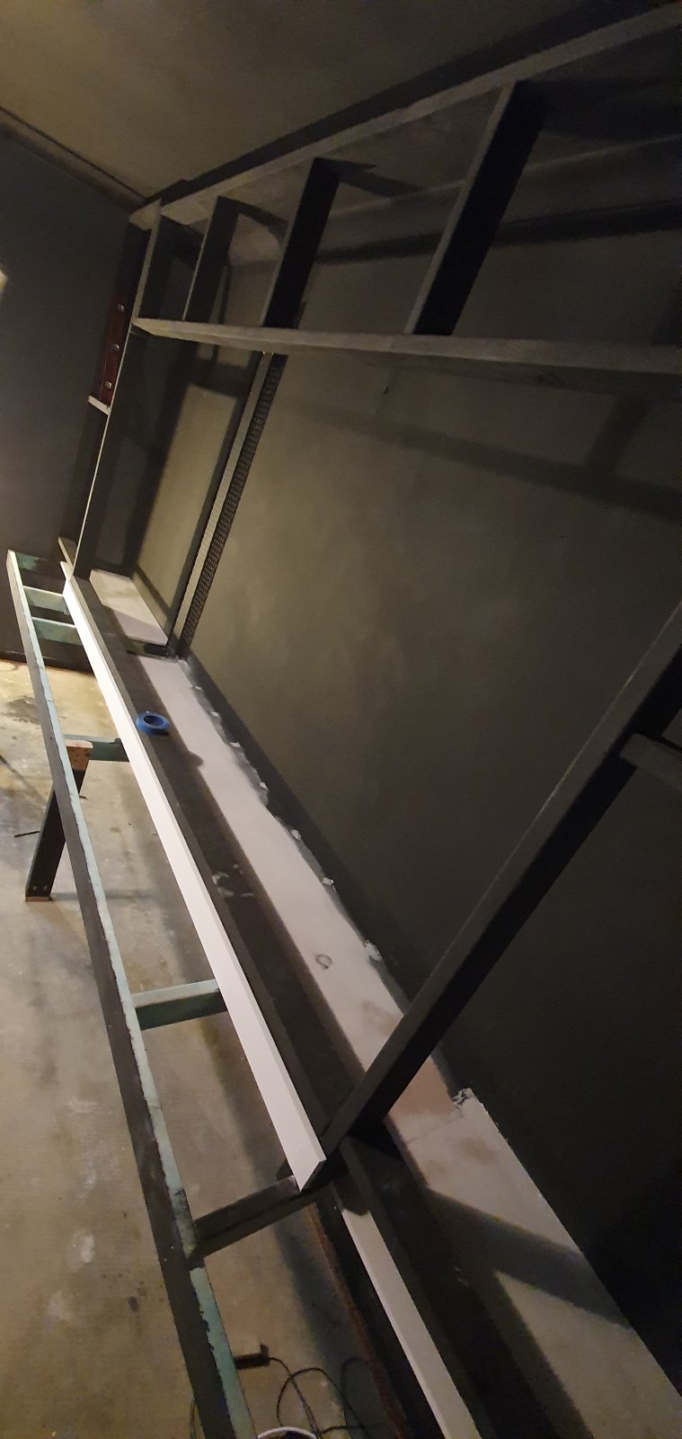

I got started on the front sound stage today. Bolted to the wall with ramset 10x80mm wall anchors. 35x90mm timbre.
All up its taken me about 5 hrs to get this far, tomorrow I'll finish all the vertical frames for the 130" screen

Frame for the front sound stage is complete. Ive allowed 100mm clearance from the woven screen and the front of my speakers.
All up today took about 4 hrs

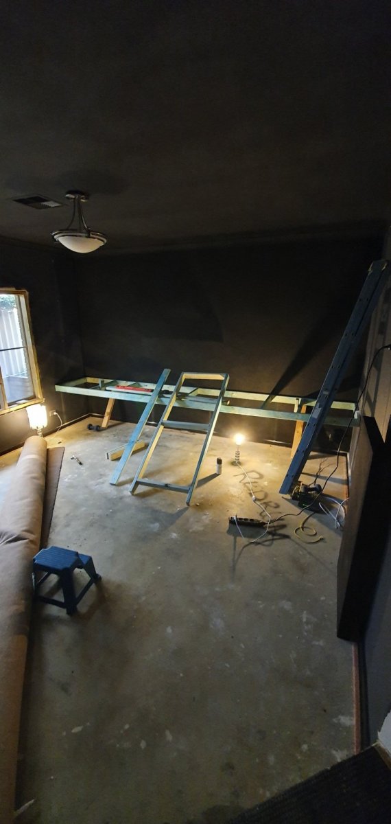

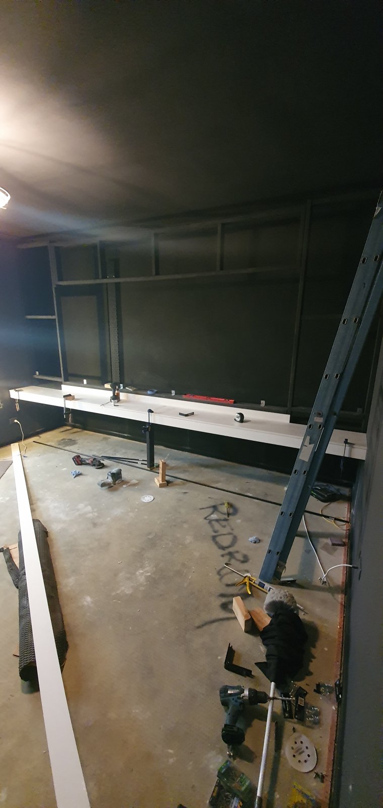

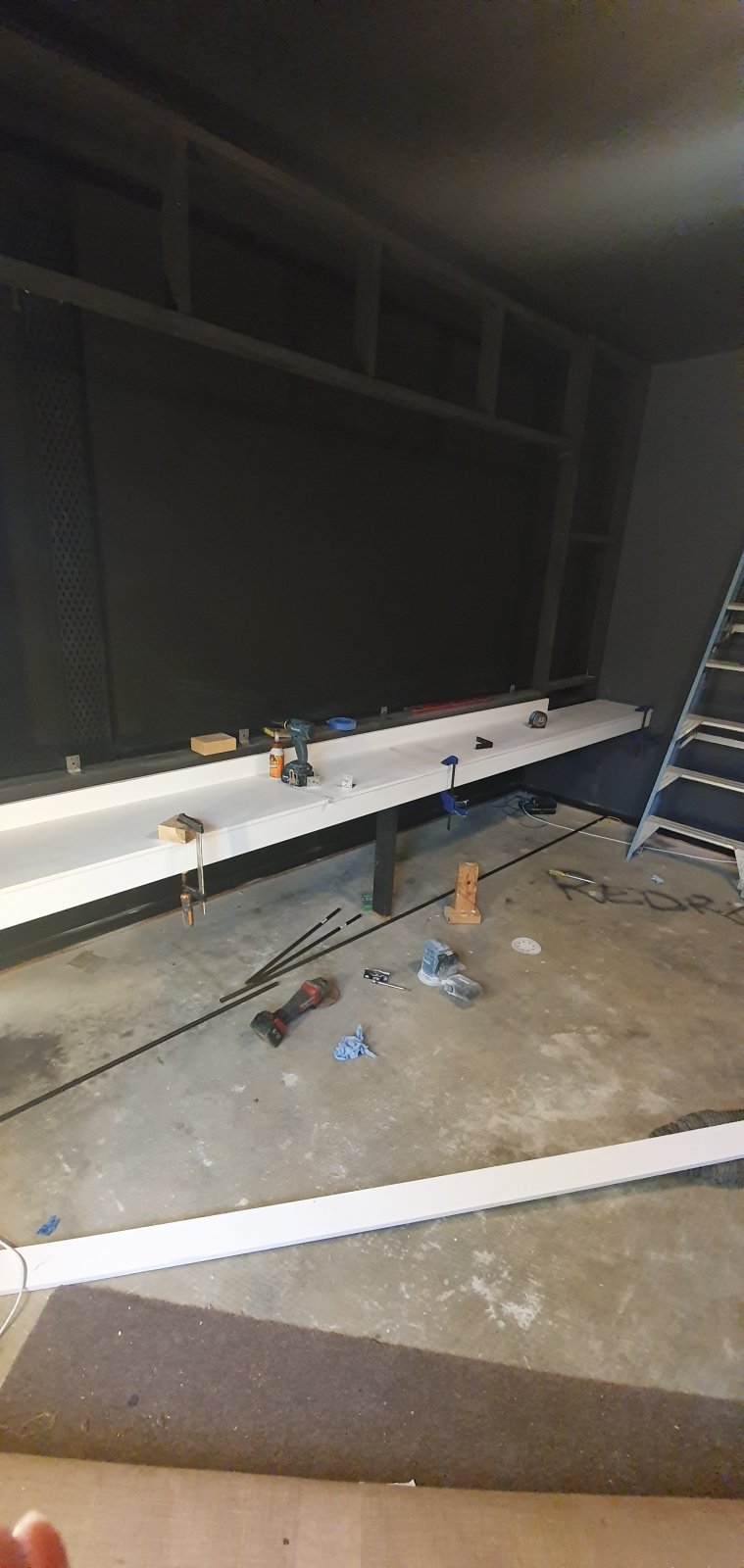

Bench tops at the front and back of the front stage are now done, ready for paint.
Curtain box and rods installed on lower section.

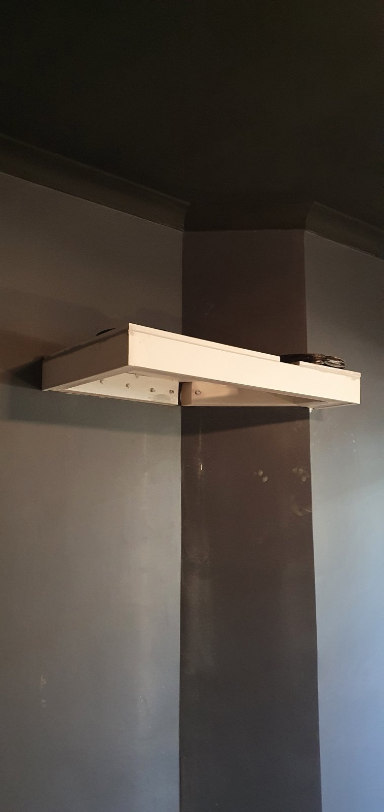

Projector mount installed on back wall.

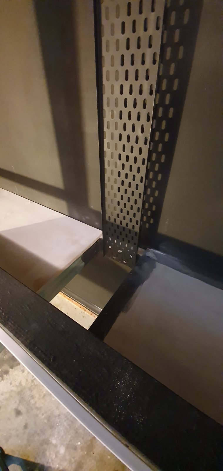

Vertical cable tray painted and installed ready for cables.
