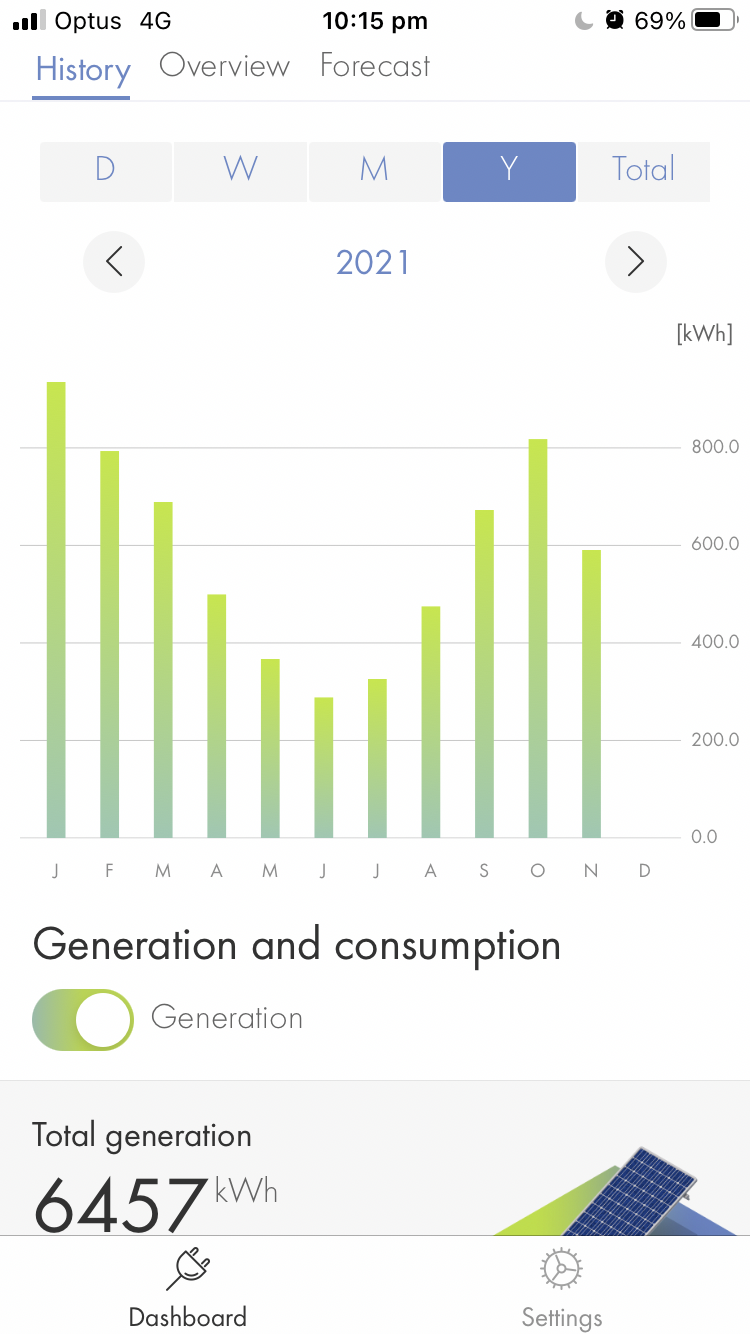

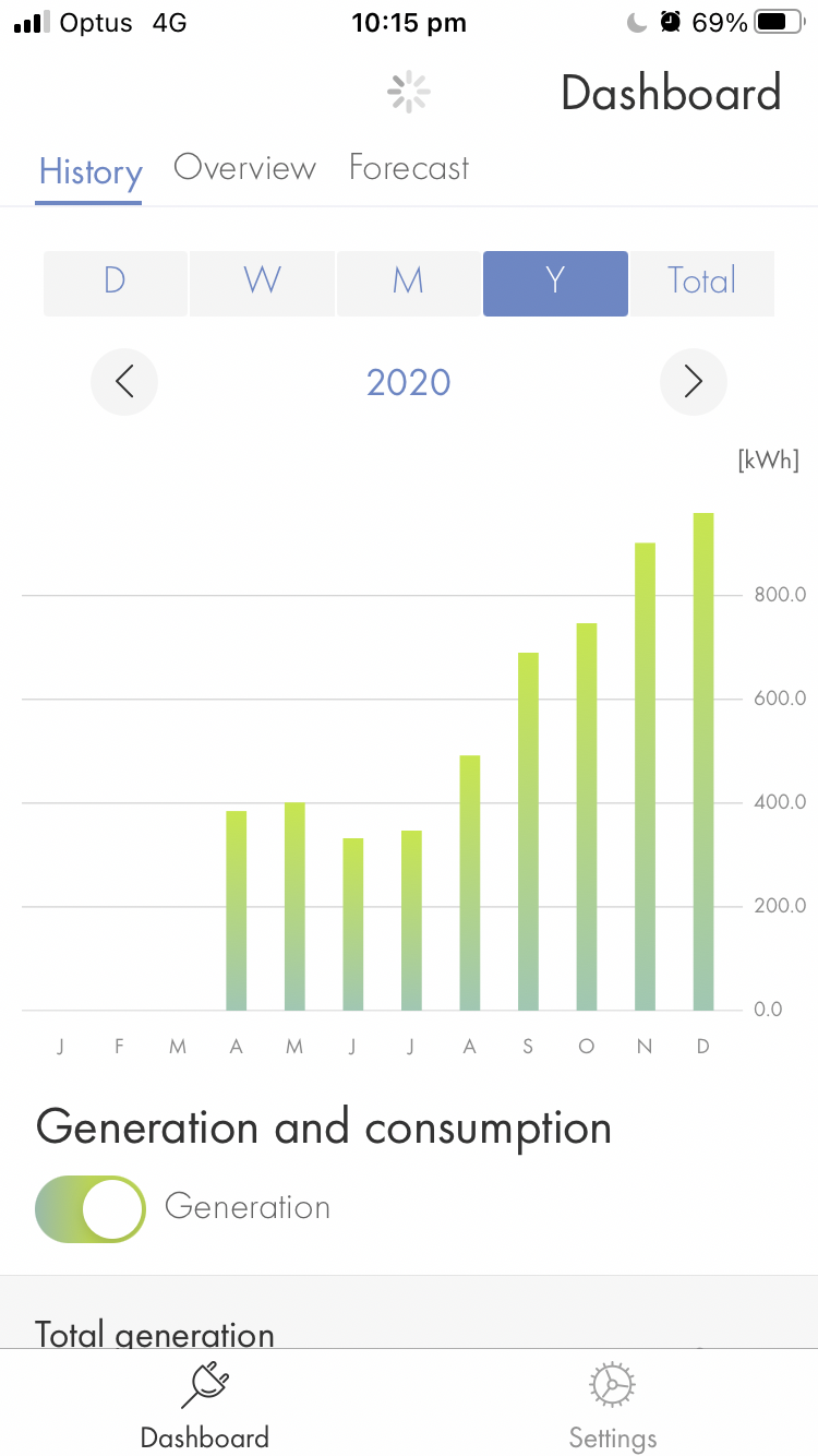

This is what the SMA app reports for the 2020 and 2021 production on my system  for each month.

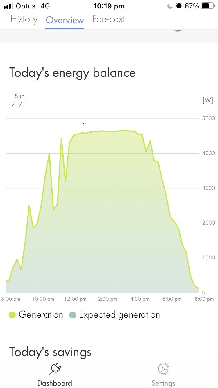

  • Author
Today’s generation
