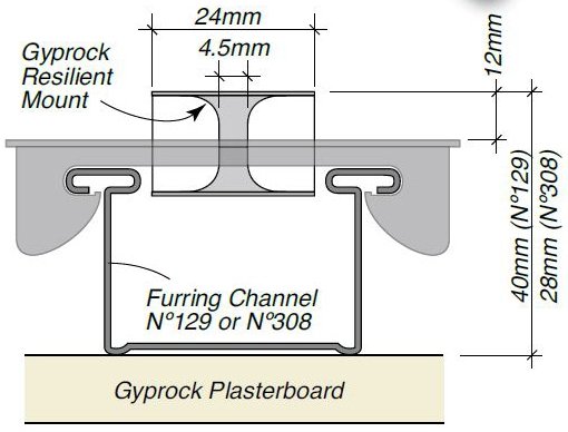

On 17/09/2020 at 5:37 PM, br0d0 said:
Hi Javs,
Just wondering if you've decided on the clips and channel you're going to use. Did you settle on the Rondo 237 clip with 16mm 308 channel or something else?
How's it going otherwise? Any updates?
Thanks
Will be using the bigger rondo channel, not sure 16mm is enough to really work properly so dont want to lose performance based on 10mm. Will probably use 129.
Also might look at price on Rondo STWC clips. Also want to make sure I am getting all the performance I can.

Just scrolling back in this thread and realised I hadn't shared anything for ages in regards to plans etc.
We have full house plans now and the cinema has been thought out a fair bit more...
Here is what it all looks like at the moment.
So the builder didn't want the angle of the entry to be exactly 45degrees due to not encroaching on the entry way to our house, and I am OK with this, was annoyed at first as I lost a little bit of precious internal space to theatre, but after thinking on it, its totally fine. This means the entry to the cinema is a little on the tight side, I wish the door was on the side, but then we didnt want the theatre door to be all the way at the front door of the house, this way it will still look welcoming from afar as you walk up to the entrance from the family room.
The little bar section we have is about 2m wide, its actually going to house 4x 18" subs in there to act as near field subs so they serve a dual purpose. This was done because we went all the way around the world in therms of how can we maybe fit like a platform at the back like a lot of traditional theatres have etc, but we just ended up stripping it back and I am really happy with this.
What we did manage to do though is widen the whole cinema, we realised having a 1.8m wide entry to our house with huge double doors was a bit overkill, so I saw a chance to add 30cm to the width of the theatre, which also widens the children's activity room upstairs, and go to a single 1200 door which is still huge. Win win there.
The projector will live in the study completely outside the room. This will give me throw for a huge 165inch screen and complete noise control in the room. There is a big rack there in the study too, you can see both of those place-holders below.
Plan is to clip and channel the entire room, double drywall and green glue, window plugs and possibly even drywall over the windows completely, and then all cabling, lighting and air conditioning etc will travel through the soffit we will build inside the room shell. This way hopefully we can minimise any issues with compromising sound proofing to the exterior of the house. I am aware that some sound will escape within the house especially through the planned port window for the projector, but that was never really the brief here.
