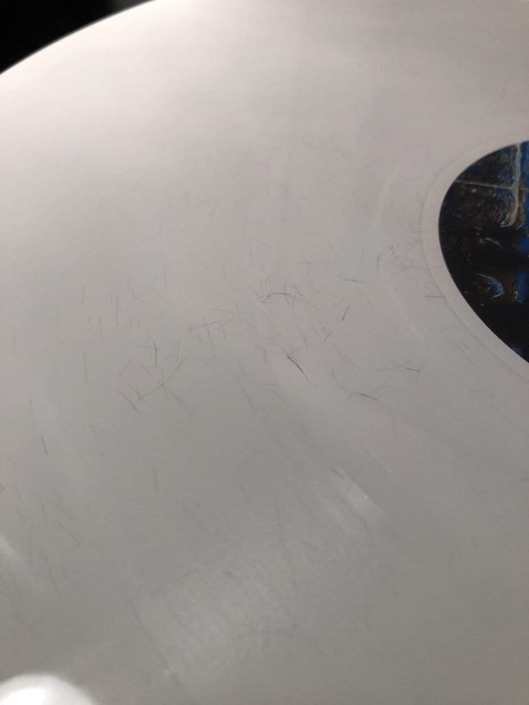

bigev Posted April 27, 2019 Author Posted April 27, 2019 Here is a photo of the record at its worst section. I can't get any of these off as the current brush just continues to shed. Many of these are inline with the grooves ...
Candyflip Posted April 27, 2019 Posted April 27, 2019 On 27/04/2019 at 12:49 PM, bigev said: Here is a photo of the record at its worst section. I can't get any of these off as the current brush just continues to shed. Many of these are inline with the grooves ... Expand OK, so it'll be static that's locking the fibres onto the wax - nothing more. You can get this off with an anti-static cloth, or a wet wash (which will get rid of the static, also). and obviously, get rid of that brush - it must be very old, or very cheap, to be doing this. Of course it should only be used dry - never with any sprays or liquids, or of course, you can expect a brush to perhaps lose a few hairs onto the surface in response. 2
bigev Posted April 27, 2019 Author Posted April 27, 2019 Ok great, thanks @candyflip - new brush tomorrow.

audiofeline Posted April 27, 2019 Posted April 27, 2019 On 27/04/2019 at 12:07 PM, bigev said: ...What is the confidence that a new brush, a spin-clean unit or a combination of the both will get the fibres out of the grooves do we think?... Expand Providing you haven't sprayed the record and the moisture (any other chemicals in the spray) haven't adhered the fibres to the vinyl, they should just be sitting on the surface (as @candyflip indicated, it's probably static that's adhering the fibres). The fibres should be dislodged by a (non-shedding) cleaner (just like dust) or a wash and de-static treatment. If any are remaining will probably knocked out of the groove by the stylus when the record is played. 1
Rocketfrogs Posted April 27, 2019 Posted April 27, 2019 It's really weird because the fibres are all different lengths which would suggest they are not just falling off the brush but snapping as well. I've never experienced that in 20+ Carbon Fibre Brush's over the years. Take your one into the back yard and burn the wretched thing. 1 1
Wimbo Posted April 27, 2019 Posted April 27, 2019 On 27/04/2019 at 12:49 PM, bigev said: Here is a photo of the record at its worst section. I can't get any of these off as the current brush just continues to shed. Many of these are inline with the grooves ... Expand Whilst it looks like there are some fibres on the record, it looks to me, on my 32" screen, that the majority are embedded into the vinyl as Candy said. I've got three brushes. A long hair from "Hensa" and two different Deccas from the 80's . I use a lamp across my LP's which shows dust landing as soon as you dust them. No hairs though. 1

Cigar nuke Posted April 27, 2019 Posted April 27, 2019 My gosh did you clean your vinyl using your black haired dog? i think the last few suggestions have nailed it, and is what I use. 1. Okki nokki spin cleaner with fluid supplied, on all new vinyl. 2. Once dry I hit with zerostat gun - cleaning them puts static on them, you can feel and hear it. 3. Then use air in a can for any dust/fibers. You can’t get these off unless you use an anti static gun 4. All new, cleaned records then go into new mofi anti static sleeve 5. Record jacket then goes into protective sleeve with jacket opening away from protective sleeve opening so no dust can get in Good luck 1
