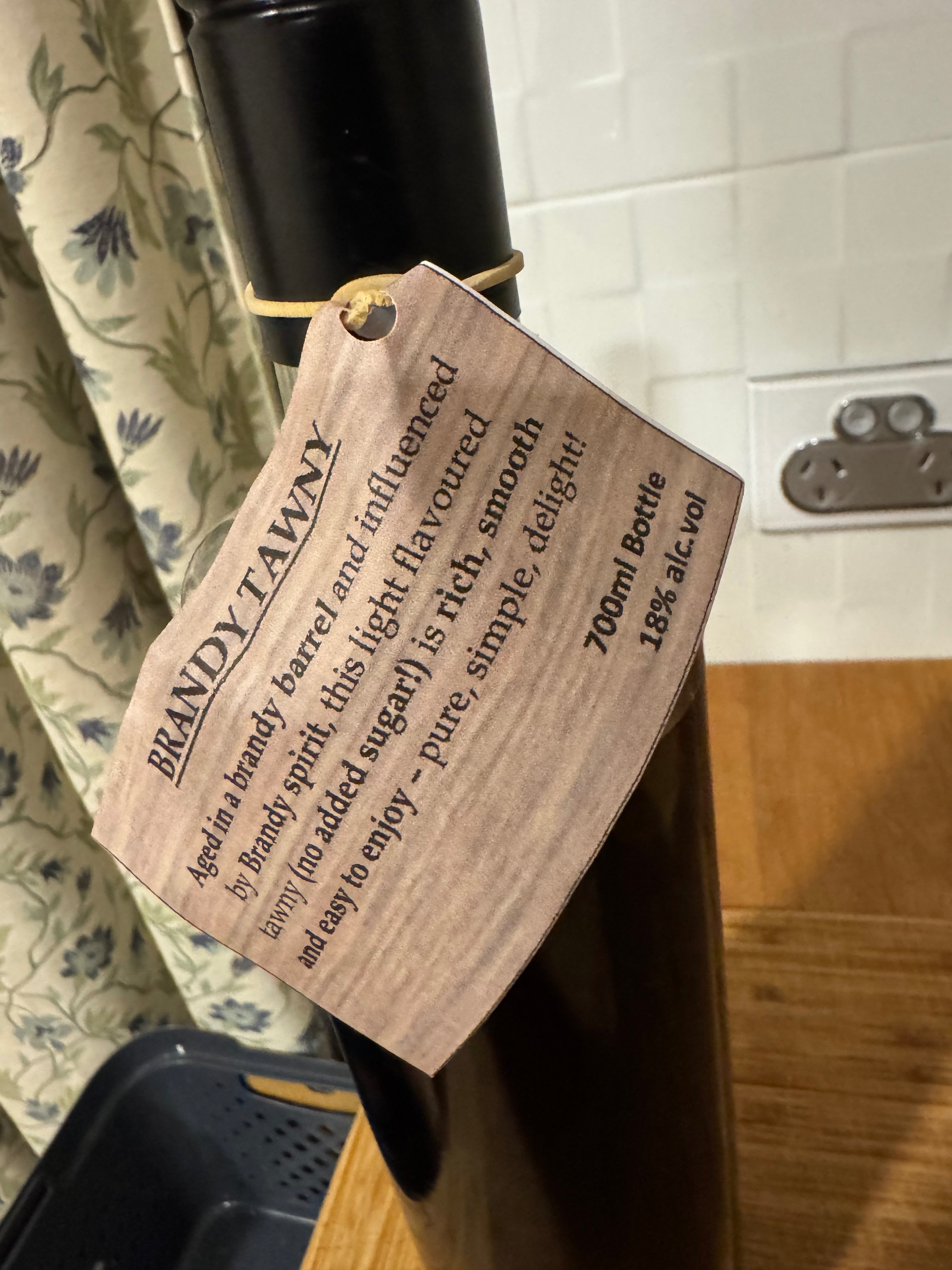

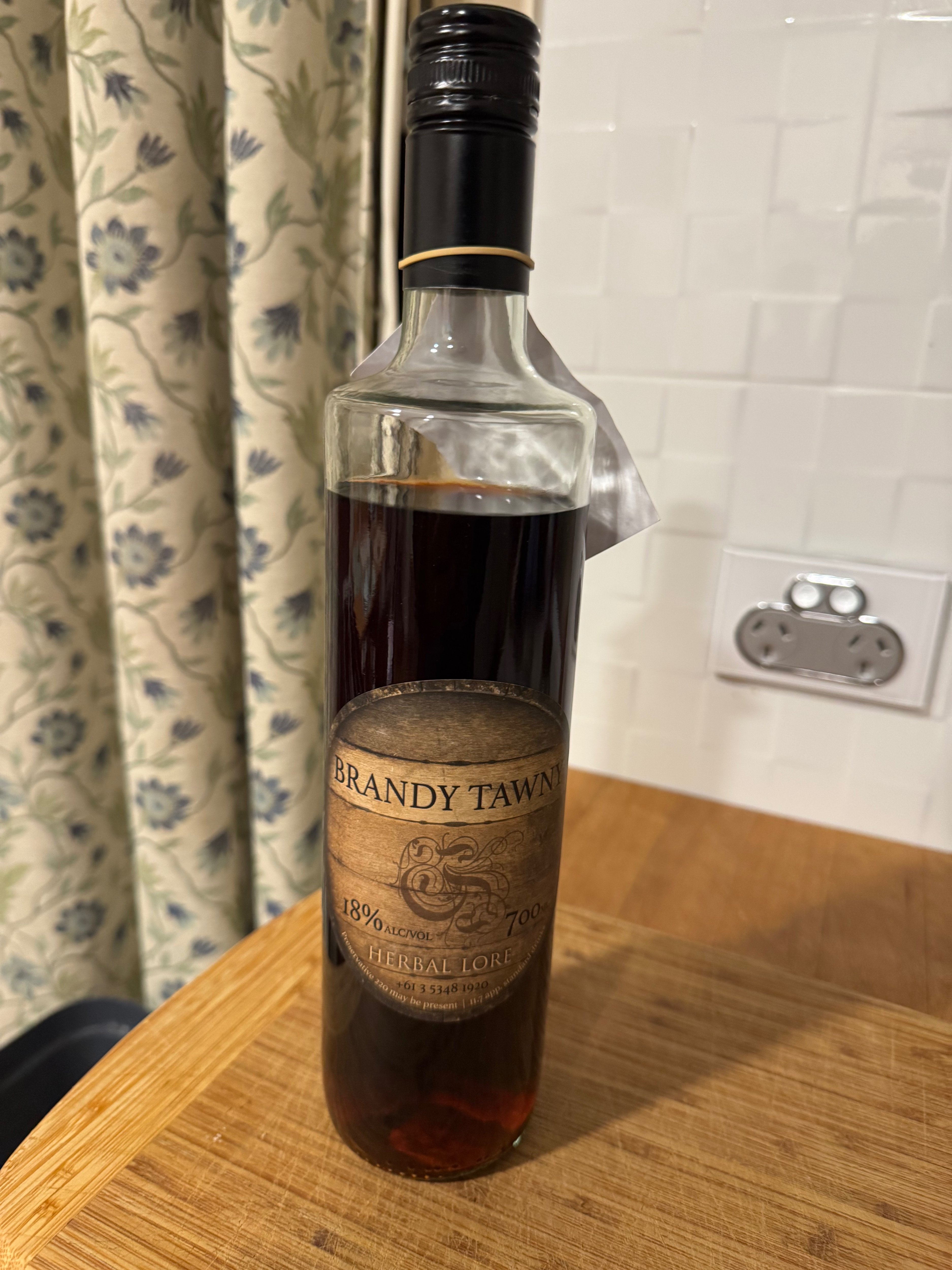

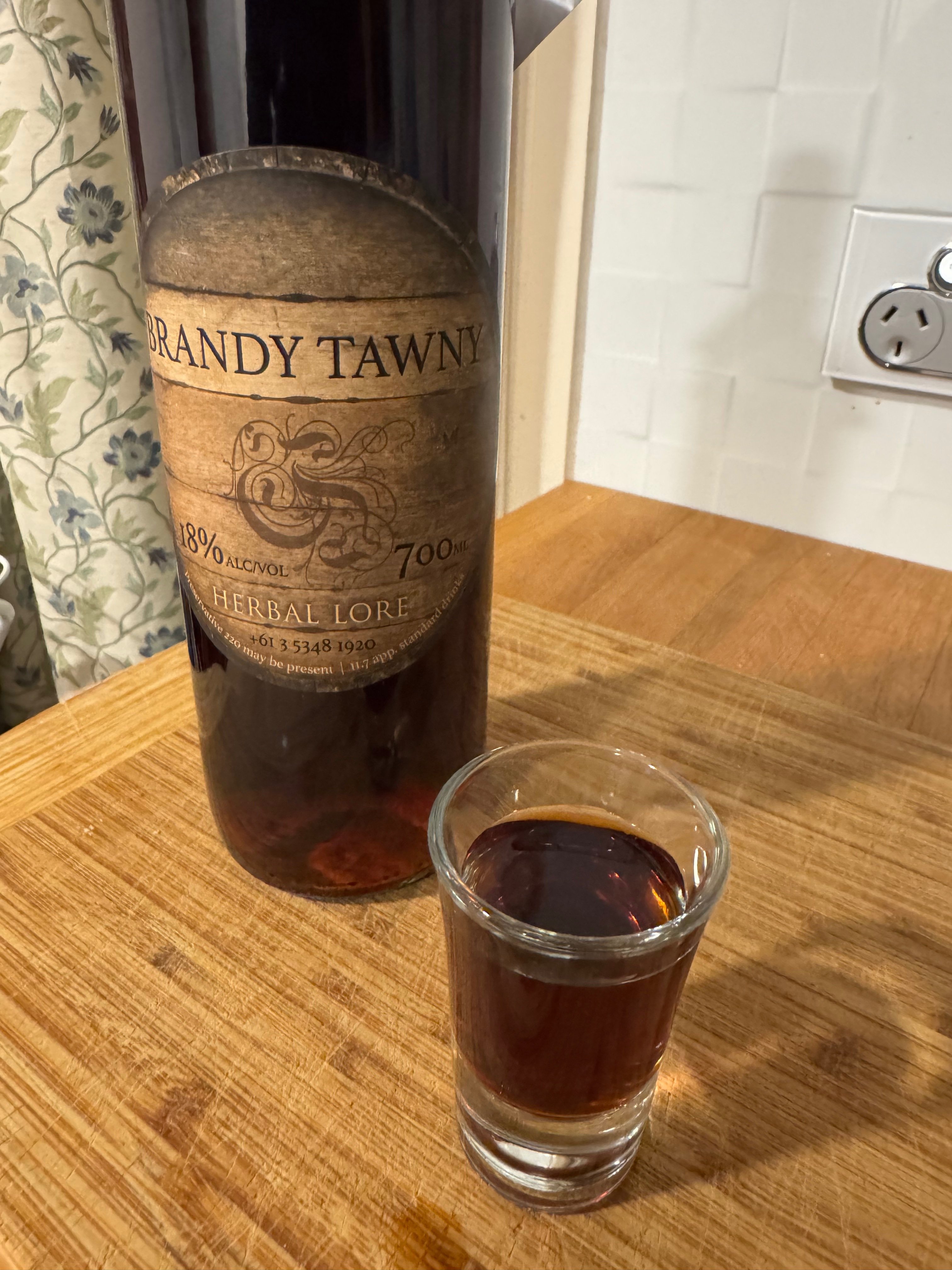

dragged this home in a recent visit to Daylesford. found it at the convent there...  what a lovely drop ! gosh love it 🙂
Had to google it ... found it thank goodness... if i get back there, will be sure to grab another bottle :D
https://www.herballoreliqueurs.com/product-page/tawny-brandy
the blurb... gives some more clues...
Eight-year-old tawny aged in Brandy barrels
This is perhaps our lightest in flavour with a special little zing in the heart of your palate. It is very easy to enjoy any time of the year, and any time of the day!
Aged in a brandy barrel and influenced by Brandy spirit, this light flavoured tawny (no added sugar!) is rich, smooth, and easy to enjoy - pure, simple delight!
The brandy barrels used to age our tawny from Gilbey’s Distillery in Moorabin originally arrived from Gilbey’s Distillery in England. Roger was able to secure these and many other old English oak barrels. Working closely with his cooper, he created the perfect storehouse for our fine, smooth Brandy Tawny.
