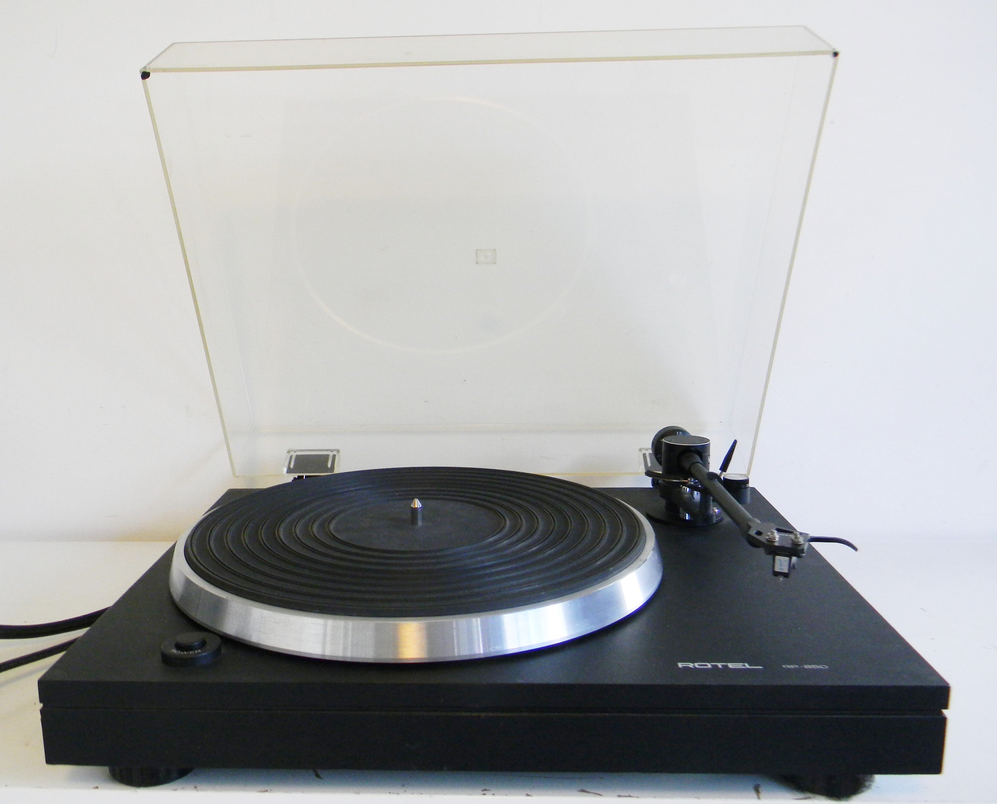

I own a Rotel RP850 Turntable that causes a pop through the speakers when turned off and on.
There is a capacitor on the on / off switch but some of the writing is missing and I am unable to identify it.
Thanks in advance
Pictured below

According to the service manual at Vinyl Engine this is a 0.047uf "noise canceller" or spark quench capacitor.
An X2/Y2 rated equivalent currently available is the Panasonic  ECQU2A473ML available at RS Components etc.

Much appreciated.
Noise was driving me mad
