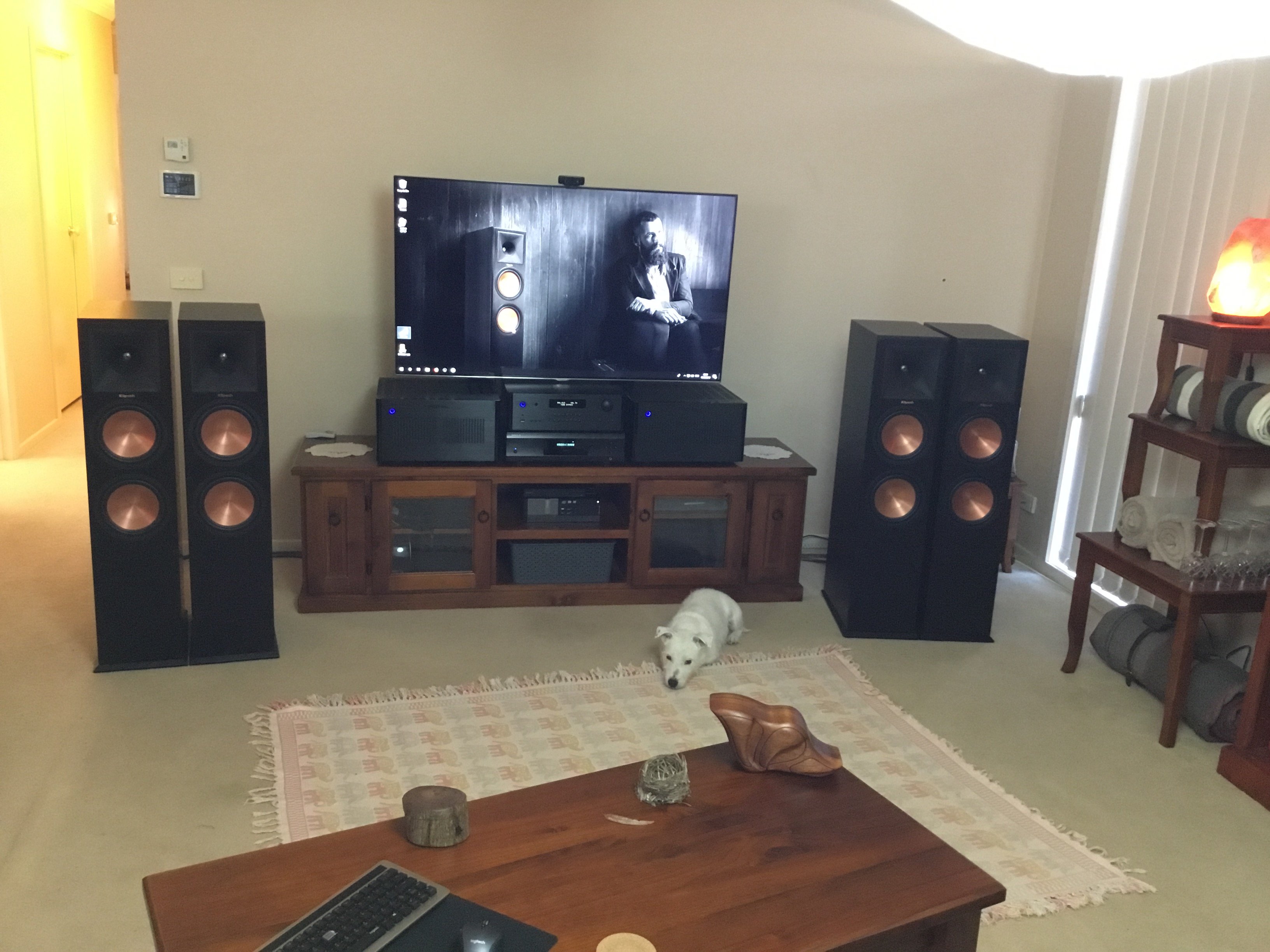

G'day all, I've really enjoyed the sharing and looking through all the posts here, having a gander at everyone's set-up/systems. So rather than be a lurker, I thought it best to slam up a pic as well. This is my favourite seat in the whole house, even better than the dinner table, it's where I like to unwind after work. Regarding the setup, all advice and critique gladly taken on-board. Cheers Trevor

Looks great, Trevor. Can you tell us what the components are?
Hi Trevor. Looks great!
The 4 speakers have me confused though, are they driven at the same time? I am assuming not.
Looks great, love the 4 floorstanders. I bet its loud. I use to run 4 speakers up front from a PA amp and it went very loud.
Agreed! Looks great, more info please!
Can you please straighten the coffee table?
Hi Wolster,
Thanks for the reply, the components are as follows:
Rotel RB-1590 Power Amps x 2. To reduce any crosstalk, I have the two LH XLR outputs from the Pre-Amp going to the LHS  amp. Likewise, the two RH XLR outputs from the Pre-Amp going to the RHS  amp with one power AMP channel driving each speaker via Bi-Wire cables I knocked up in the shed! Does that make sense?
A Rotel RC-1590 Pre-Amp is perched ontop of an Oppo UDP-205 UHD Blu-Ray player. The floorstanding speakers are Klipsch RF-280 x 4, A Samsung UA55H7000 TV sits in the middle of it all. I use a small DELL PC, with J River to deliver file-based music to the Rotel RC-1590 Pre-Amp.
Thats about it I reckon...
Cheers T
Hi DarkNark,
It might be a little weird, but all four are driven  ... gotta get those SPL's up!
Hope this helps ...
The two Amps are not MONOBLOC, they are standard Stereo, R+L channels ...
To reduce any crosstalk, I have the two LH XLR outputs from the Pre-Amp going to the XLR Inputs on the LHS  amp. Likewise, the two RH XLR outputs from the Pre-Amp going to the RHS  amp  ....  with one power AMP channel driving each speaker of the pair.
i.e. LH Amp drives both LH speakers = RHS AMP channel drives the RH one of the pair + LHS AMP channel drives the LH one of the pair, thus cutting out any speaker wires crossing over each other in the setup .. I may have tied myself in knots here with the explaination, but the cabling is not in knots though!!
Hey Tony,
Yep it can go loud! but that's not primarily what I was after, as they say power is control. It fills the room in a relaxed way without the need to drive everthing hard to get SPL.
Cheers T

Gooday Trevor.
Can't get my head around the four speakers. So, you are running two sets of Stereo, is that right? Your more after the DB's then stereo soundstage I presume?
  • Author
Hi Wimbo, not just after dB's / SPL, at the expense of imaging here. Yes, the setup is a little out of the ordinary and might I say it works a treat. My ears tell me there is no imaging loss with 4 speakers compared to 2 only, I've messed around and tried both setups.
Interesting setup.  Very unusual which will make a few of us think outside the box.
nice work.
