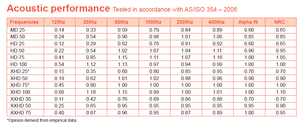

Dogbert Posted May 3, 2017 Posted May 3, 2017 (edited) Some great info here, I have always been trying to get the time to add some panels to my small HT Room. I didn't realize Bunnings sell the Martini insulation. Looking at the specs the best price / performance looks to be from the HD 75. Is there any other reason besides rigidity to go for the XHD? I might buy a pack and try them on the walls first before making any frames. I have read previously that the RIM_Fabrics_Trilogy material was okay, has anyone used this before? Edited May 3, 2017 by Dogbert 1

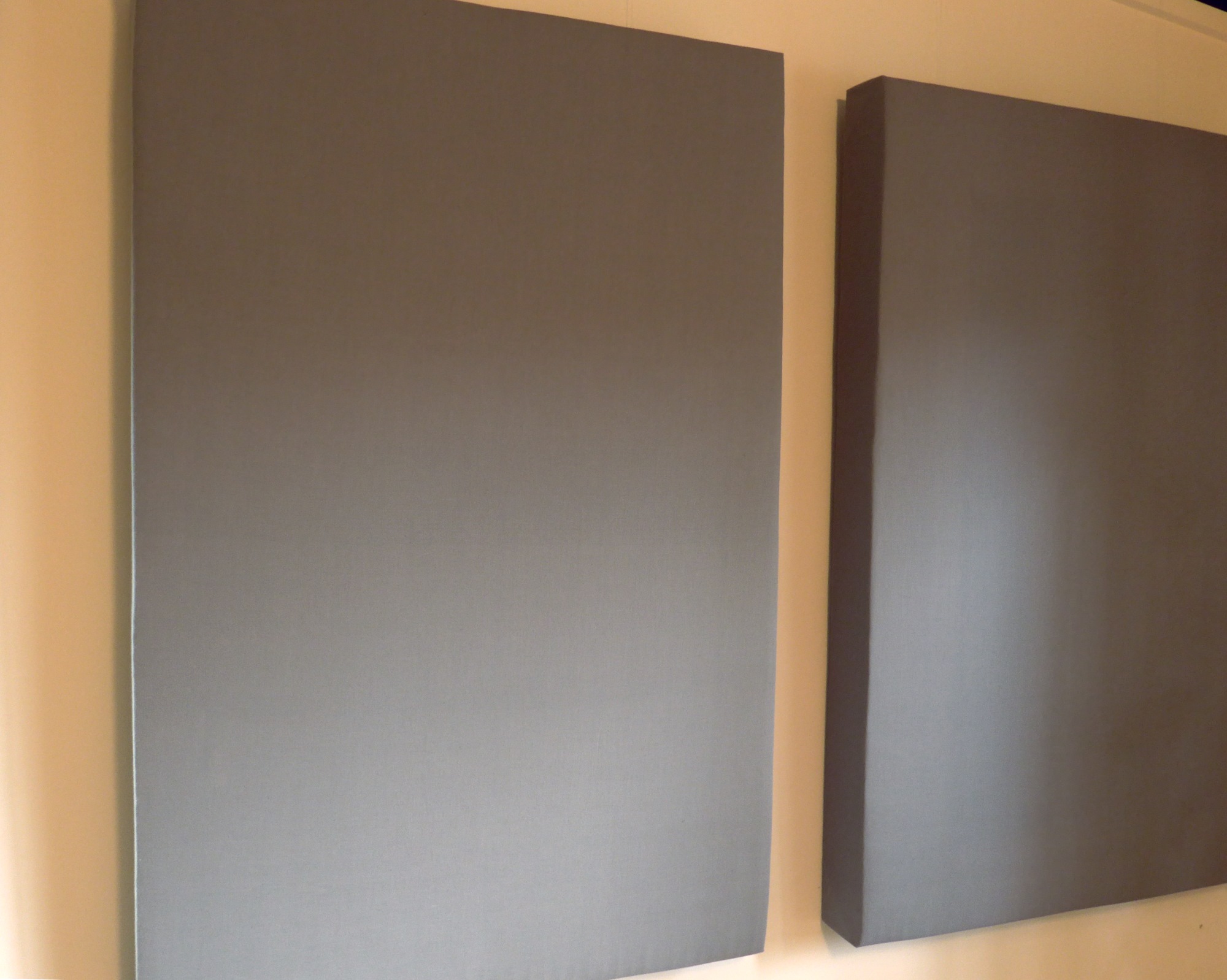

Stevesie Posted May 3, 2017 Posted May 3, 2017 (edited) Here's a not very good photo of what the Martini XHD looks like without frames. The fabric is the cheapest Lincraft cotton I could get. It's just pulled tight and pinned on the other side using dressmaker's pins every 10cm or so. Edited May 3, 2017 by Stevesie 7

Perth.hifi Posted May 4, 2017 Author Posted May 4, 2017 HiWould I be best with the XD or the XHD, also, can this be used for both absorbing and diffuser? If not what needs to Happen to make a diffuser with this material? Sent from my SM-G935F using Tapatalk
Guest Peter the Greek Posted May 5, 2017 Posted May 5, 2017 (edited) On 04/05/2017 at 2:51 PM, Perth.hifi said: Would I be best with the XD or the XHD, also, can this be used for both absorbing and diffuser? If not what needs to Happen to make a diffuser with this material? Expand The XHD looks the go, but depends I guess on what you want. Here is a useful and not so long article that might help you with your decisions https://homeacoustics.org/2017/04/acoustical-treatment-primer-absorption/ You can give the insulation diffusive properties by covering it with strips of tape, plastic film, paper etc in 150mm vertical strips i.e. 150mm covered, 150mm uncovered and so-forth. Other DIY methods are significantly more work, but easily achievable. As I said, read the article. If you have more questions get the book he references Edited May 5, 2017 by Peter the Greek
