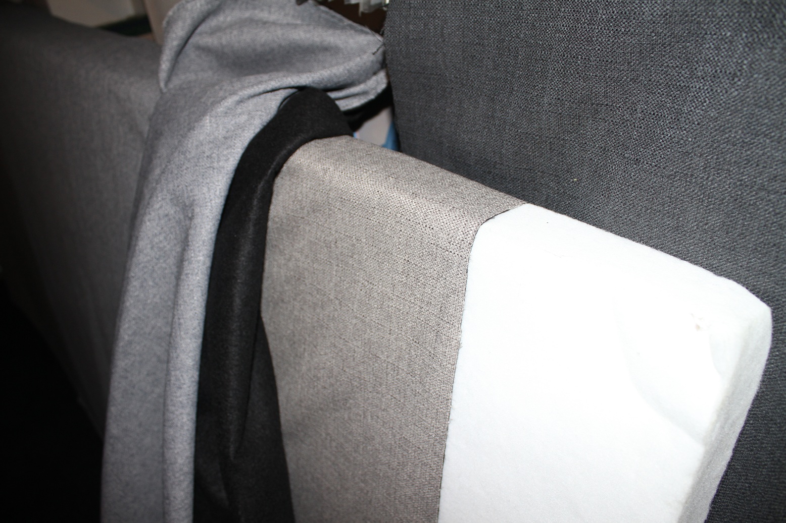

Sweet... I've just got all my gear today to build the exact sane panels, with martini 75hd, being ordered tomorrow...
What fabric are you using, i still need to purchase fabric.?
Sent from my SM-G935F using Tapatalk
Using an upholstery weave with a felt backing, can breath through it but is is heavy.
Aim is to reflect HF and absorb mid range. Have had good success with this method of upholstery covering bats of a few types improving focus of the sound generally wherever placed to effect in a small room
Massive WAF as well ;)
If I use that that name, will the fabric store know?
If using speaker cloth, will the panel absirb too much HF, that's my current concern?

Yes felt backed upholstery, wool or cotton or anything
I get it at Spotlight https://www.spotlightstores.com/search?q=upholstery+material%3Arelevance
If using speaker cloth which is very light weight and transparent to sound (mostly) would work for higher frequencies and expose the bat to full range (edit without an outer mass loaded layer)
Just experimenting at the moment with these materials which seem measurably effective

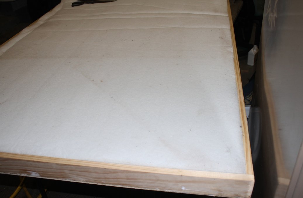

I just built two frames and fitted Some 25mm 48kg/m3 autex batts i had lying around....put two frames on both side walls, would I be crazy if I said I already notice a difference....

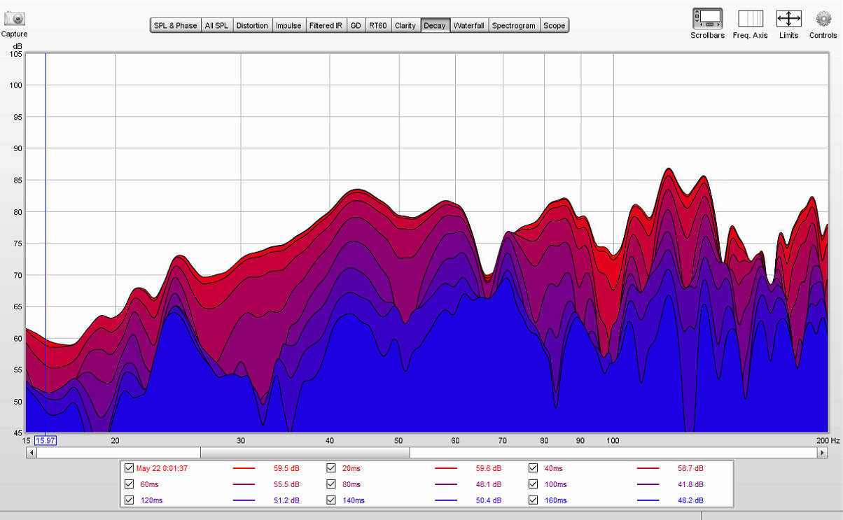

On 5/22/2017 at 0:49 PM, rocky500 said:
I might be able to lend him a lappy with REW and microphone. Not sure my Mic is behaving at the very top end though.
Here is my MDat I did last night.
Any suggestions on the areas I might target myself?
http://www48.zippyshare.com/v/9Ryu3raw/file.html

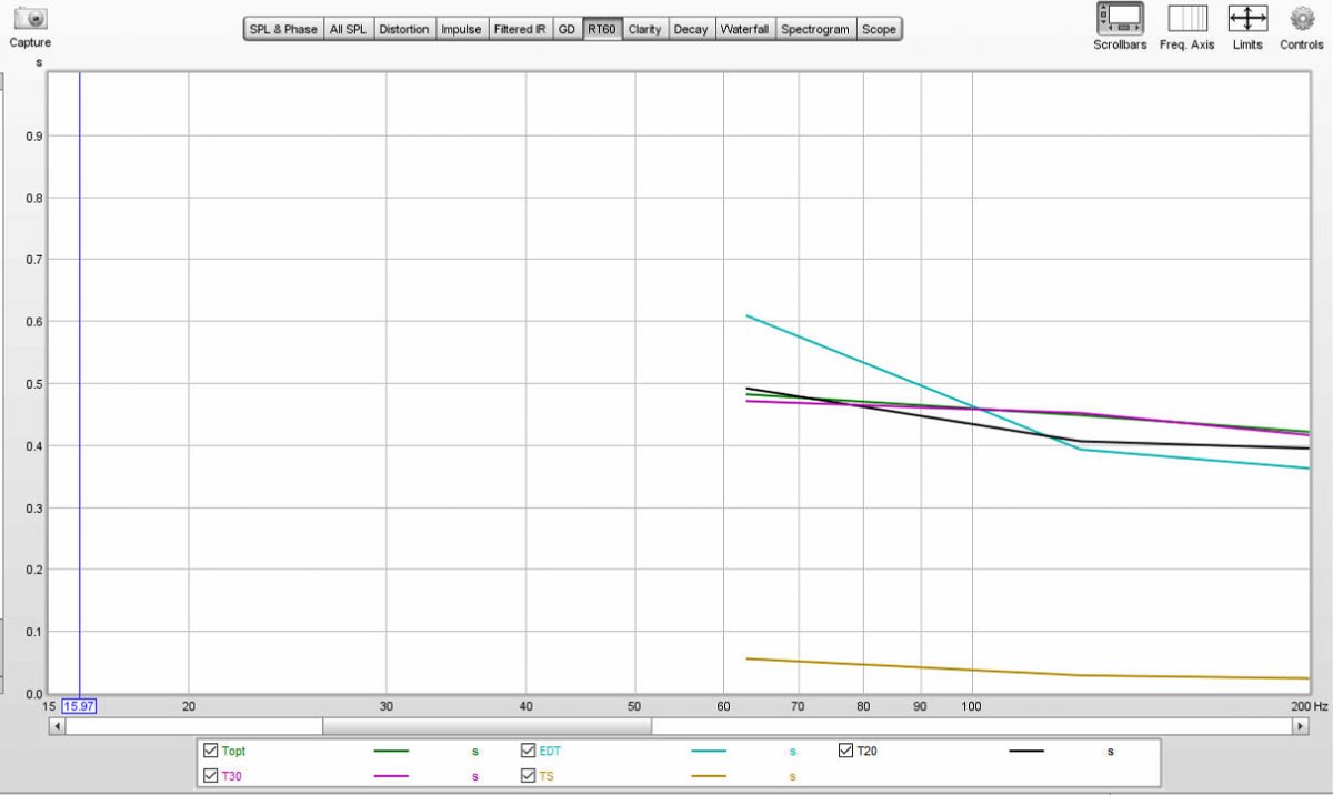

post some jpg's of your reverb times and Decay below 200Hz (RT60 tab and Decay tab in REW)

9 minutes ago, almikel said:
link failed
Just tried your quoted link and it worked with Chrome.
Here but not sure myself with these. Left speaker.
that looks quite good - freq response is lumpy, but decay/reverb for the room is good - reverb times are very smooth.
You have what appears to be modal peaks just above 70Hz, just below 50Hz, approx 45Hz, and approx 25Hz - you could try some EQ on these - don't try to fix the dip at 65Hz with EQ
I'd take a guess and say you don't have block/brick walls, but possibly a slab floor?
Some broadband absorption targeted at bass frequencies would help smooth 100 - 200Hz - try that before EQ.
cheers
Mike
