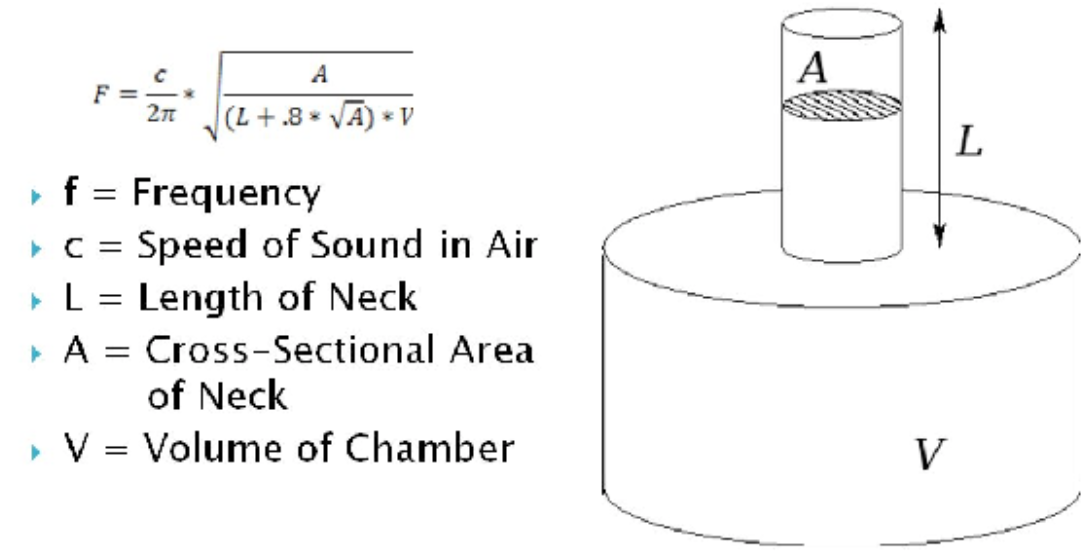

did you attach the wrong picture? - that's a Helmholtz pressure trap, not a Schroeder diffuser?
correct

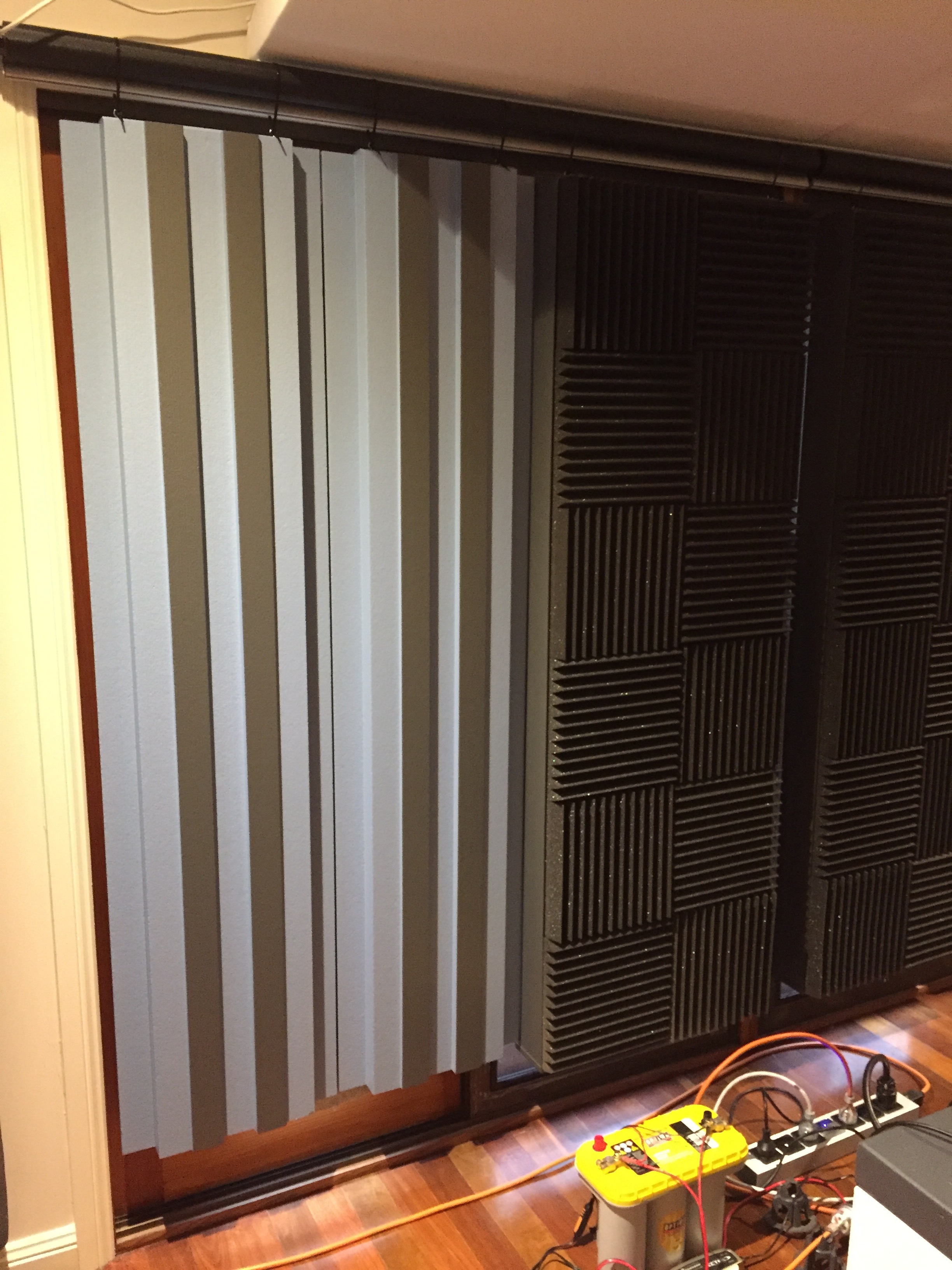

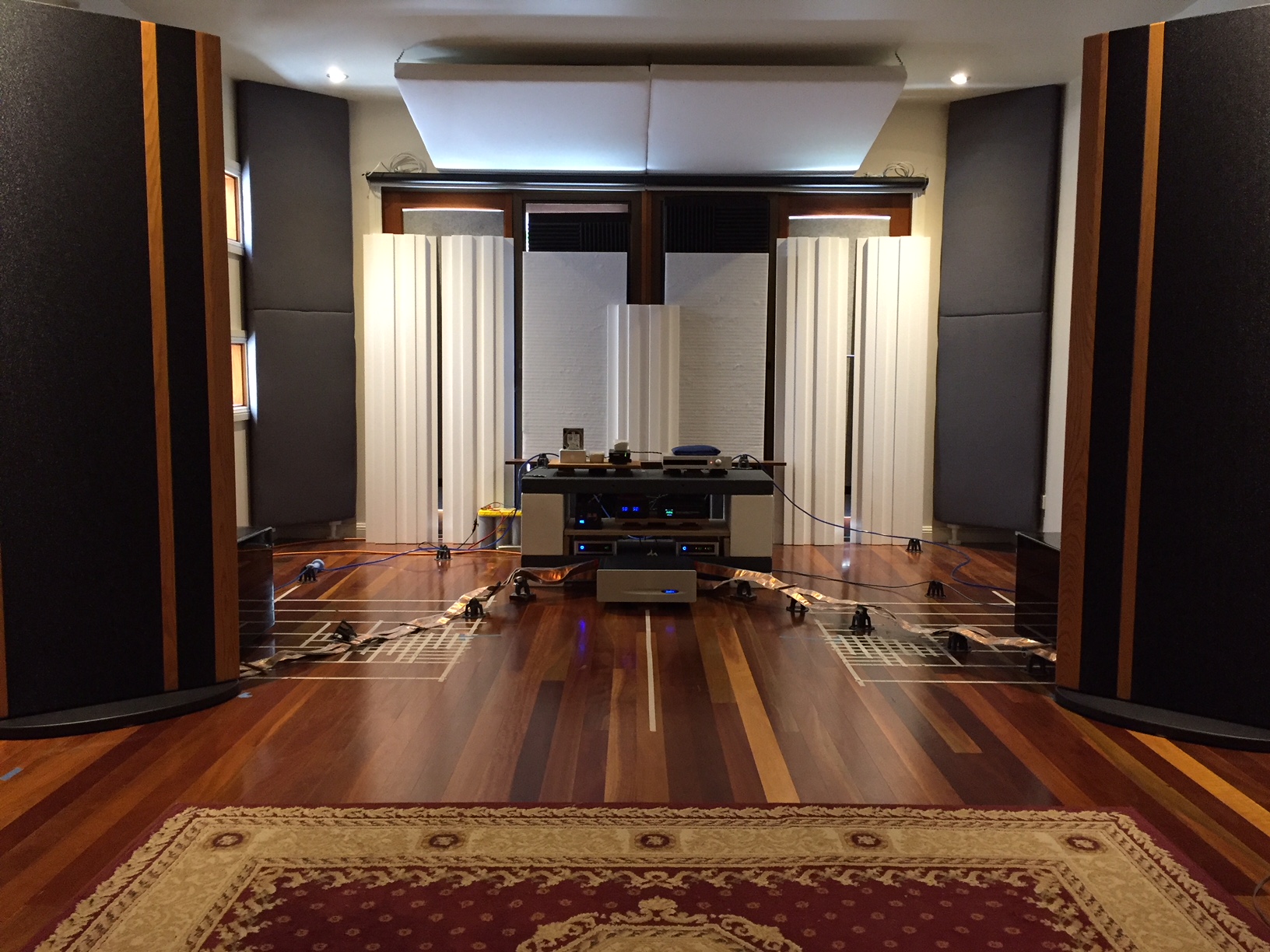

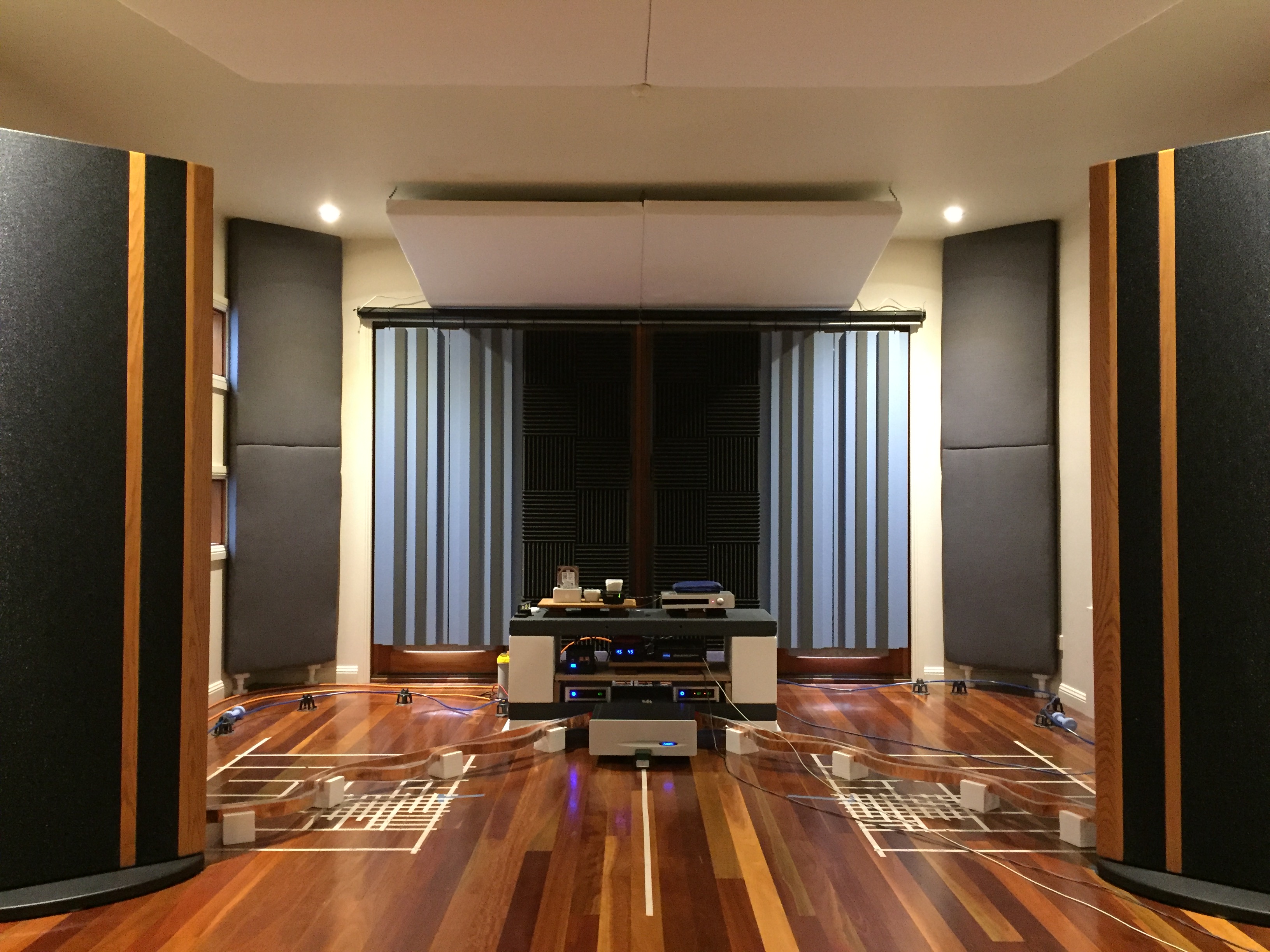

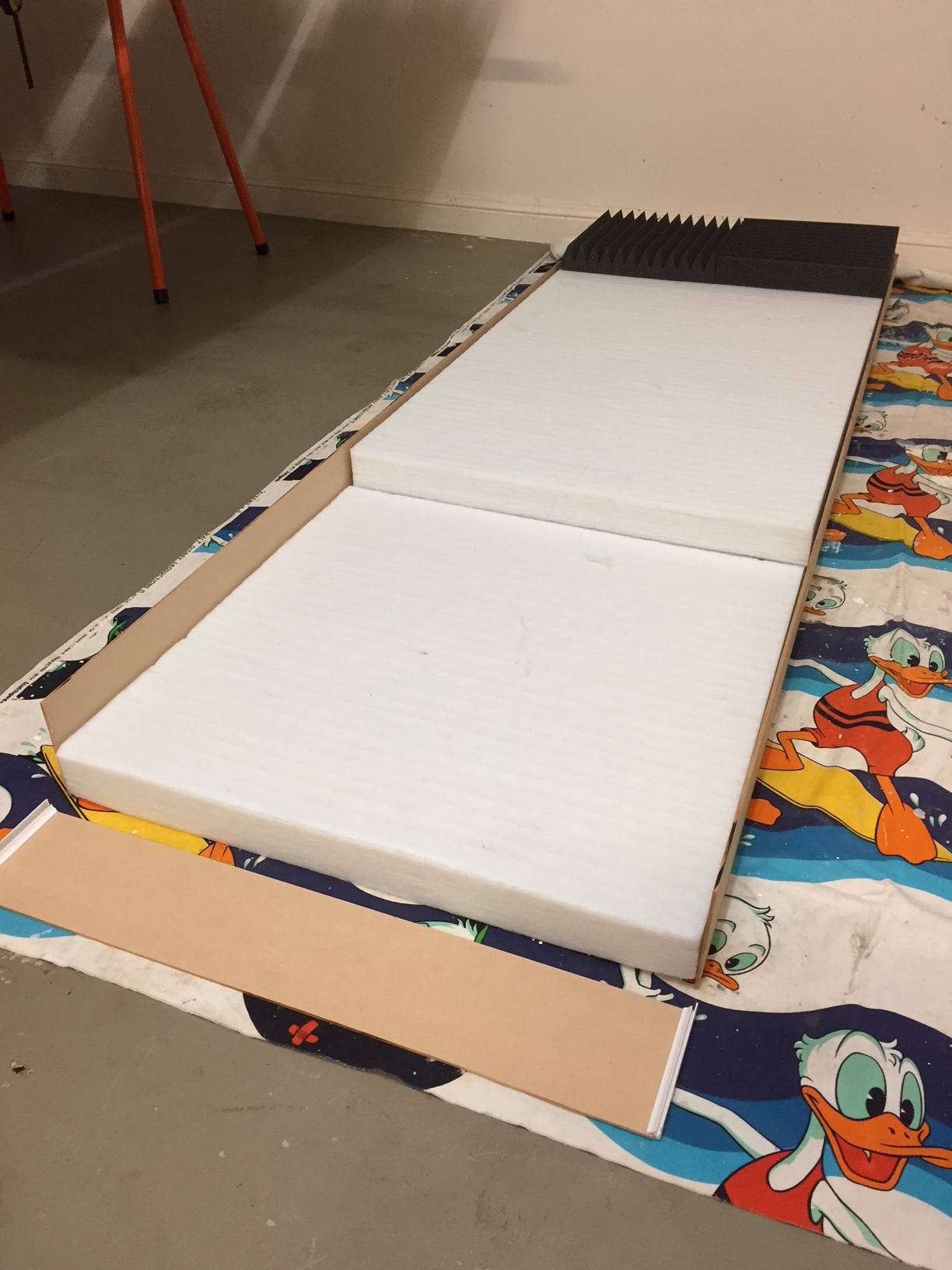

Just finished mounting the absorber panels and Arqen diffusers on the front wall.  The panels hang about 100mm in front of the sliding doors giving an air gap behind and because they are hung from the roller blinds they are easy to remove if required.  The before and after photos are below.  The corner trap construction is described on page 7 of this thread.
IMG_0649.thumb.JPG.de957d416c7ba6521d413339c55335ad.JPG IMG_0664.thumb.JPG.c0651cff02d7363c7899845a65b974cd.JPG
The Arqen panels are styrofoam coated with 3 coats of PVA glue then painted to harden up the surface and reduce absorbtion.  I colour matched the material from the corner traps and my wife chose the blue colour.  I have no taste apparently so I let her choose the blue - it was political mastery - she is now impressed with my room and thinks it's wonderful!  :thumb:

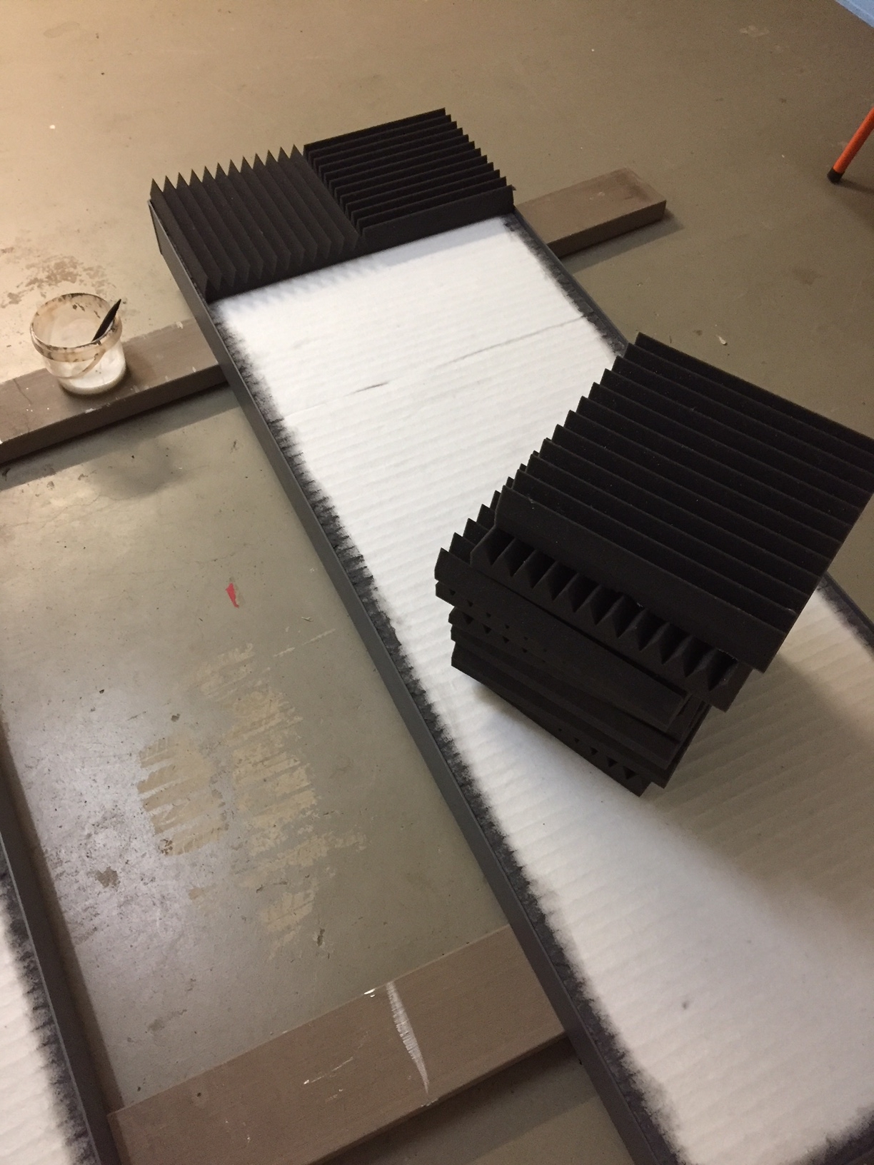

The absorber panels are 2 x 50mm thick and faced with 50mm acoustic foam tiles giving a total depth of 150mm.  Because the panels are self supporting, I only needed a light weight frame to be able to hang them from the roller blind using cable ties.  I used 3mm MDF and plastic corner moulding to glue it all together with Liquid Nails.  No actual nails or screws were harmed during the construction of the panels.  Overall I'm pretty happy with the result and will have to get to work on the side wall panels next week.

any acoustic treatment is better than nothing, are you hearing subtle differences?
@Wavetrain
There is a slight improvement in the mid bass and better imaging.
Though the panels were previously leaning against the wall once I mounted them properly with the air gap behind it has improved things.

Yes, soon as you have the absorber slightly off the wall, it lowers the frequency target, also velocity is zero at the wall surface, nothing really happens there, the party starts just out from the wall surface.
Nice work

 That is an incredible looking room, the grandkids will have a ball in there! Great stuff

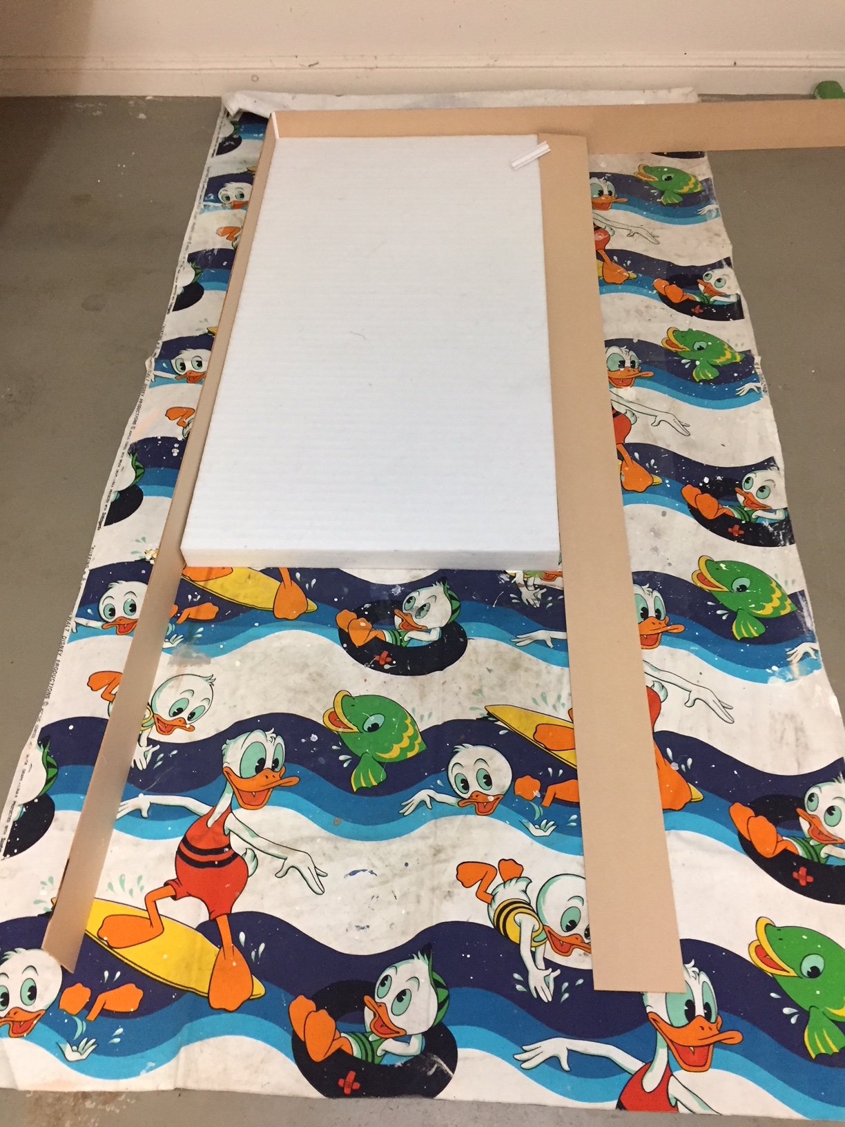

Yeah we'll done. Ive built my panels, just waiting on acoustic art fabric to arrive...yaycb858cf6bf1c164aca05ad0b4fe560c7.jpg
Yeah we'll done. Ive built my panels, first 3 have been wrapped. 4982537140e9388563d7e62fd969bd07.jpga911d678c2b83687cc569d5fb94a25ed.jpg52130ff685209b8458b2f32807eb5c9a.jpg
Those panels are very cool - makes mine look quite daggy!!
  • Author
The prints are awesome, they would make any frame look cool. :-) I've learnt allot in this process. If anyone needs acoustic panels made, I'm happy to offer my services. I might be starting to make these to sell.
