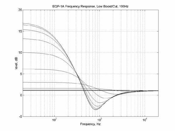

It boosts bass up to a certain frequency, followed by an undershoot. The boost and attenuate functions as well as the corner frequency can be adjusted. In professional settings, it might be used for drums, etc. where the signal still exists in individual channels before mixing. At home, all I have access to is the finished product where all instruments that produce bass have already been mixed together, so it selective for frequency only, and not for individual instruments - a major weakness. As you can see, Pultec is not a "simple" EQ that simply raises the target band, it is a "dirty" EQ in that there is a Q and there are sideband side effects. It is basically a sound effect.
There are other Pultec EQ's that can be used to dial up / down the mid and top end. I have only played with these briefly, they have the effect of fattening up vocals and making them sound richer, or thinning them down until they have no body.
Nonetheless, it is free to download and try, so I downloaded it. It comes as a VST, and needs to be hosted on a VST capable player or convolver. I used JRiver. A few companies make Pultec EQ VST's. Apparently the best and most faithful reproduction is UAD so that's the one I used.
Outcome: HOLY CRAP this thing is amazing! I can wind it up to maximum settings and the power and snap of the bass is overwhelming. In fact it is far from realistic and it is almost comical. I have dialled it all the way down and it gives me a nice low end. It blends in nicely with the rest of the frequency response. Previously, only the mids and top end sounded "physical"; while the bass was there, it didn't have the same impact as the rest of the FR. Now it does. I have paid for my license and I will keep it.

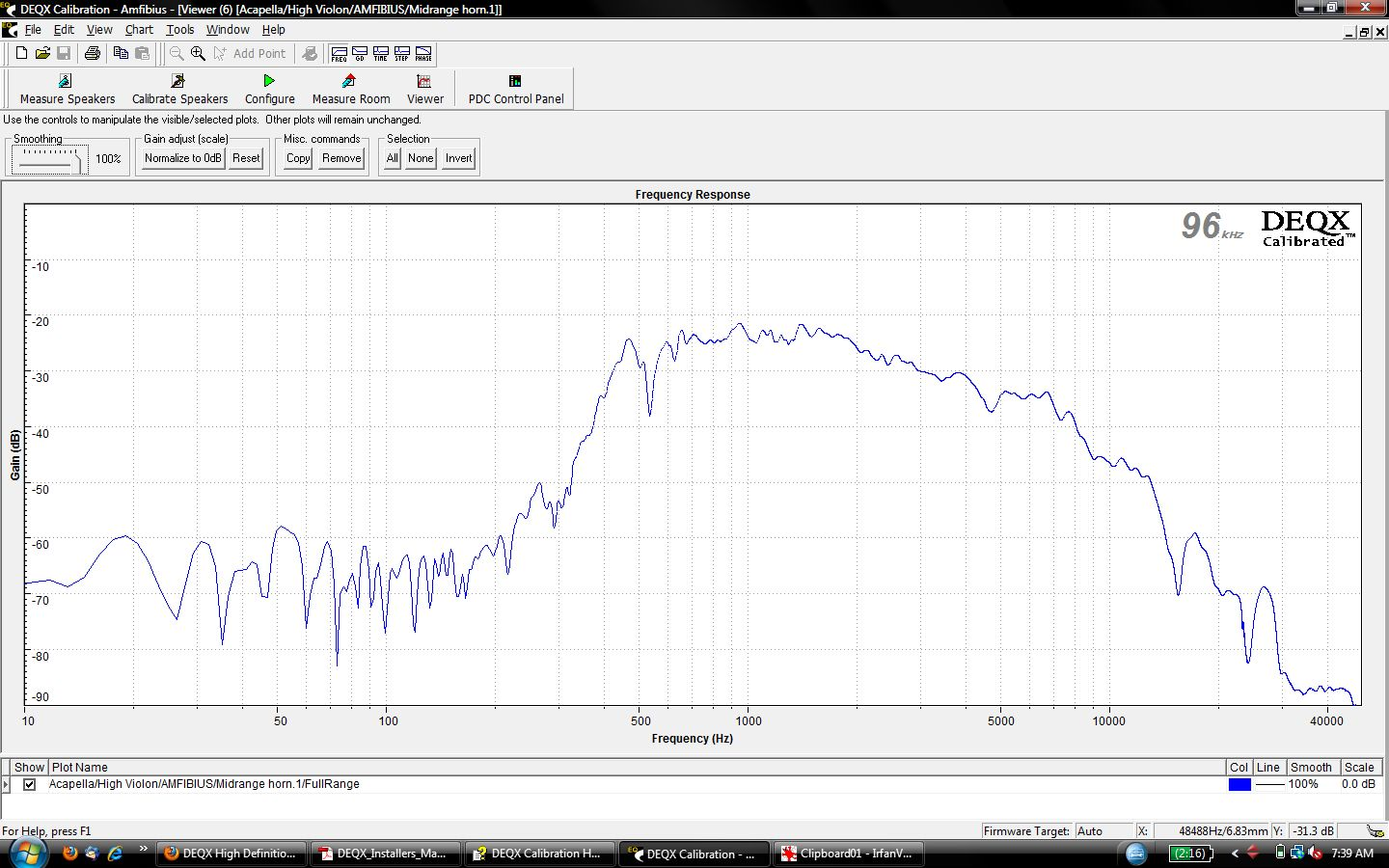

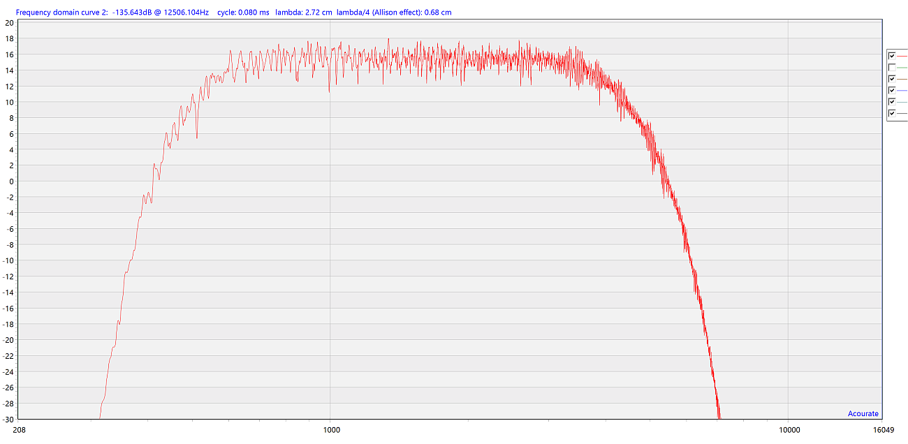

This is the frequency response of the horn, with the factory crossover in place.
And this is a nearfield measurement of the horn, with the passive crossover bypassed, but with no driver correction or digital crossover. You can see that it naturally starts to roll off at 500Hz, and by 400Hz it is -6dB and about to transition to the steep part of the slope:
The curve below is with full driver correction and bandpass applied. After I took the above measurement, I realized that I have a LOT of headroom for the horns since they are so efficient. They are 98dB/W/m, compared to the woofers below it which are about 85dB/W/m. If I wanted to, I could cut the volume of the horn and use 400Hz as the corner frequency. But I decided to keep it at 500Hz:
I am crossing over the horns much steeper than factory but at the same crossover point.
Hmmmmm. Now I really want to go and measure the effect and think about redoing the XO. Thanks for pointing that out!

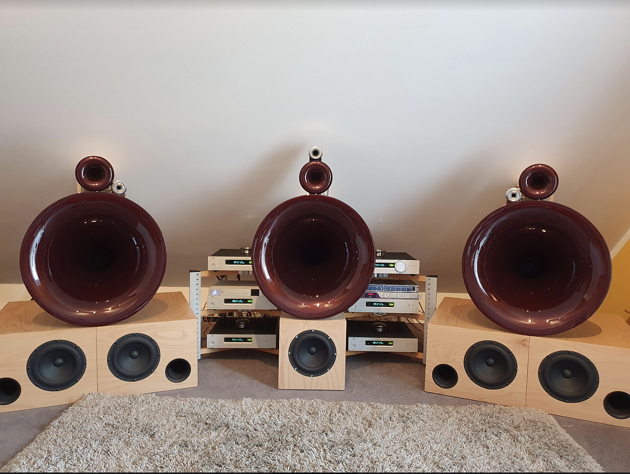

I know that Uli (author of Acourate) also uses horns. He sent me a pic of his system:
(And BTW, for those who are concerned that I might be violating his privacy by posting a picture from a private email - he has posted this image on some other public forums)
Are you using this data to determine your correction(s)?  If so, then that is mistake, generally.
When you measure a speaker at different distances, it changes how the diffraction sums with the direct sound.
I'd make the decision by look at the frequency response of the woofer, and of the horn, vs angle.     (and also based on not using a driver where the non-linear distortion was too high, but I doubt that is a problem here).
Basically trying to get it to if you look at the crossover between the horn and woofer, from many different angles, that the sum is as optimised as possible through the listening window (and much wider, if possible).

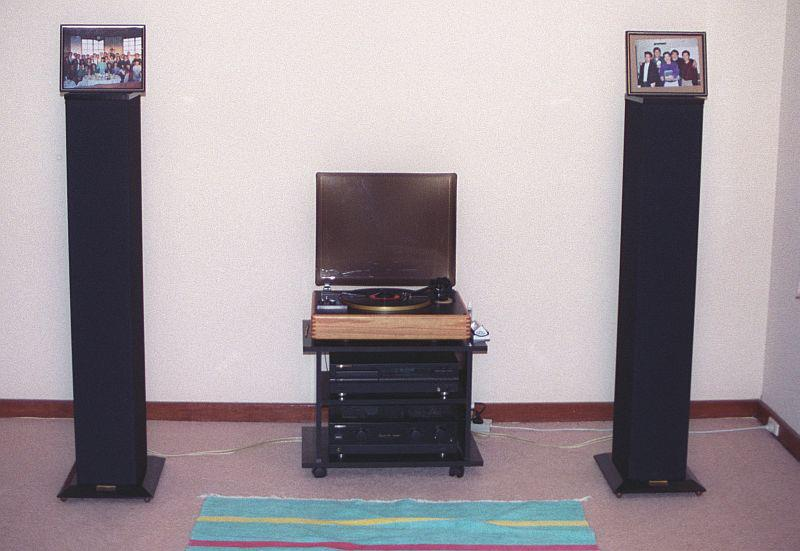

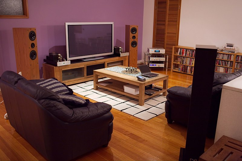

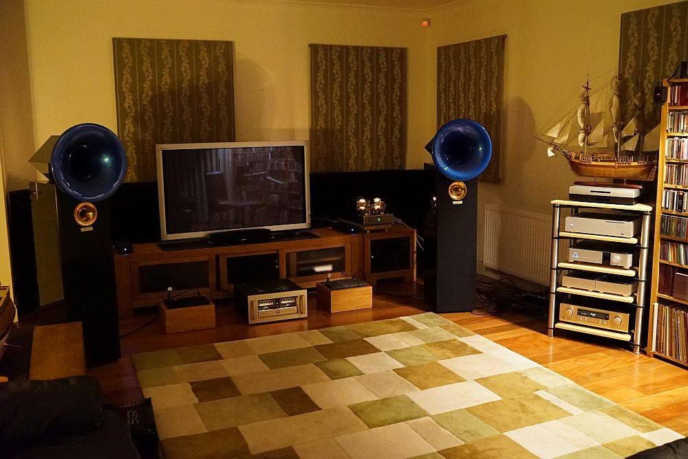

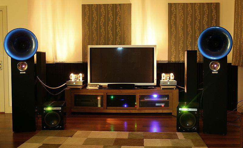

I found a whole bunch of old photographs of systems I have owned over the years! Unlike many people here, I am slow to change equipment. I tend to buy things and enjoy them for many years before upgrading. So here we go ...
1991: my first system. Mission 760i speakers, NAD 3020i amp, Sony Discman CD and Sony Walkman (cassette) as source. About a year later I added a Marantz CD52 CD player.
1995: The Missions went out and I bought a pair of Audio Definition Signature speakers. The amp was changed to Pioneer A400. The turntable was a Sota Sapphire with Sumiko FT-4 arm. I used a Sumiko Blue Point Special which my dad destroyed while he was cleaning the turntable (snagged the cloth on the needle and ripped it out). It was replaced with a Denon DL304 cartridge.
2004: I bought an entire new system. ProAc D38 speakers, Cary CAD-805AE SET monoblocks, Cary CD-306 SACD player, Cary SLP-05 preamp. The Audio Definitions were relegated to surround speakers.

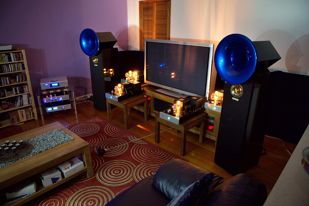

2008: enter my current speakers. When I heard them, I fell in love with the top end, but I knew that the bass had problems. It sounded like two speakers in one, one speaker for the top, and another for the bottom. I thought that it would be an easy fix, after all I was driving them with a pair of SET's. Maybe they needed more power? So I bought a pair of Cary CAD-211AE monoblocks and vertically bi-amped them. It helped a little, but not enough.
2012: Over the next few years I kept adding to the system to try to fix the bass. By 2012 I had a pair of JL Audio F110 subs, I sold the Cary SET amps, and bought an SGR amp. By this time, every driver in the system had its own amp channel but I was still not satisfied with the bass.
2016: In 2016 I decided to take the plunge and convert the speakers to active. The passive crossovers were bypassed, and I bought an 8 channel Merging NADAC MC-8 DAC. The woofer drivers were also swapped to Lorantz, and now the SGR amp didn't have enough power. So out it went, now replaced with Accuphase power amp which was on kind loan from a friend. The JL Audio subwoofers were replaced with a pair of custom subs which I designed with the help of @Red Spade Audio, each sub has two Rythmik drivers for a total of four sub drivers in total. The system was now controlled by the PC which made the crossovers.
I knew close to nothing about DSP and DRC back then, I was only aware of its potential. It has taken me years of learning to get to this point. And for a couple of years after switching to this system, the sound was close to unlistenable. It really was a downgrade. I eventually made some filters which were "good enough" and kept the system as it was until late last year, when I decided to redo all the filters. This resulted in a massive improvement in quality without having to spend any money.
And that takes us to now 🙂 Nothing more needs to be done.
