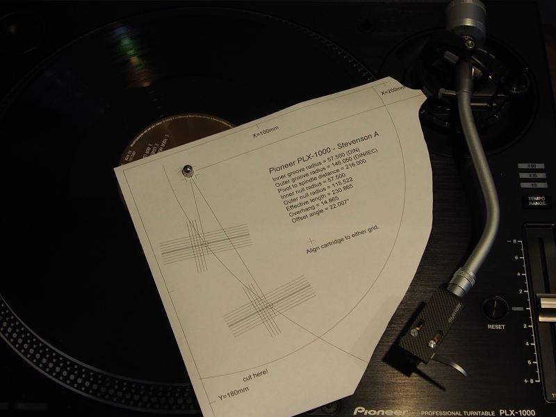

rocky500 Posted June 15, 2015 Posted June 15, 2015 On 14/06/2015 at 11:50 PM, Besty22 said: @rocky500 I have printed and laminated the template. Thanks again. Great but I forgot to mention I had to cut my sheet up to fit on the table to use it. You can see my printout here
Besty22 Posted June 15, 2015 Posted June 15, 2015 Yeah . I cut mine out as per the cut marks. keen to get home and check it all 1
Besty22 Posted June 15, 2015 Posted June 15, 2015 Well I checked the current alignment at both positions on your template @@rocky500 near perfect. Thanks
