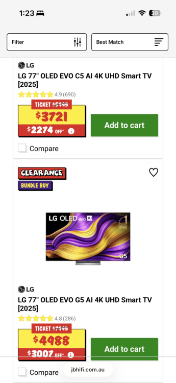

A great breakdown of options etc in your post, with one exception - where I live, LG 77" C5 and G5 OLEDTVs are currently available at great prices/significant savings off RRPs
It seems JB have sold out of the larger size LG's as none are listed, that's why I didn't list them.

Just go to JB and buy the 77” LG Oled on sale at the moment. Anything else is a compromise.
