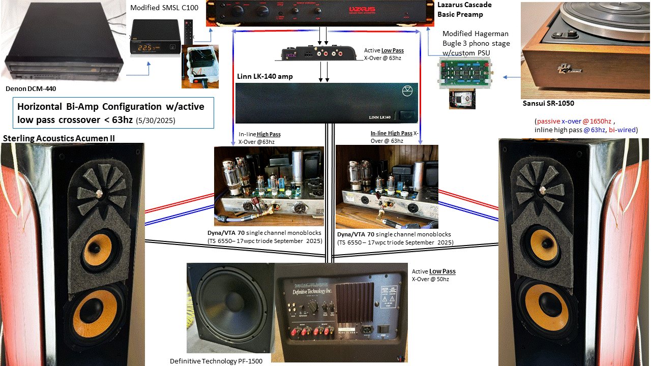

- Sterling Acoustics Acumen II transmission line speakers

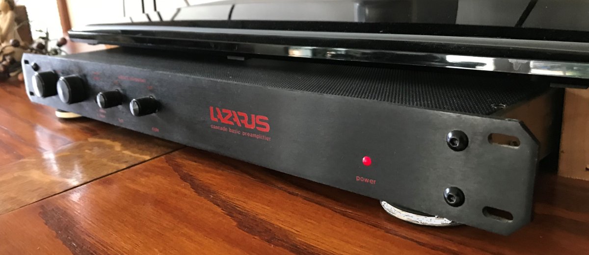

- Lazarus Cascade Basic tube preamp with CAT caps

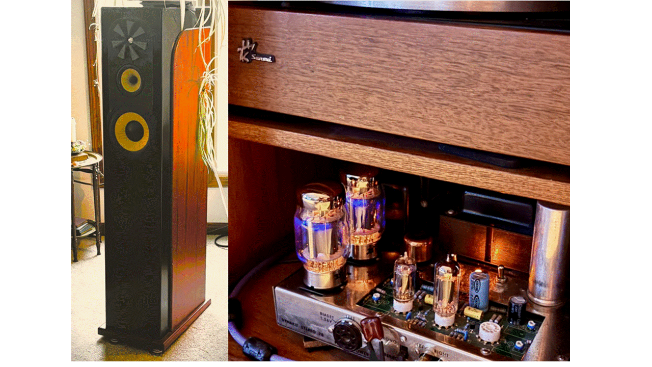

- modified Dynaco/VTA tube monoblocks on midbass/tweeters w/CAT caps, SS rectifier, and Tung Sol 6550 in triode (inline high pass crossover)
- Linn LK-140 solid state amp on the woofers (w/active low pass crossover)
- Sansui SR1050C with a blended Nagaoka MP150 body and JN-P500 stylus
- modified SMSL C100 DAC w/MUSES02 and linear regulated PSU

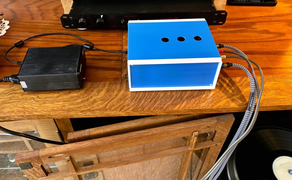

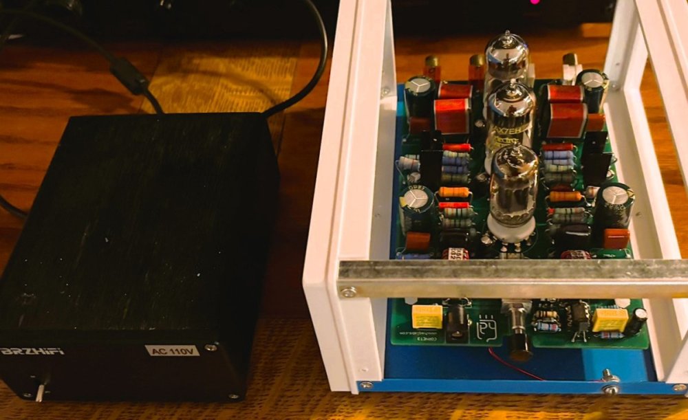

- New! Hageman Cornet 3 with linear regulated PSU and some upgraded caps and resistors

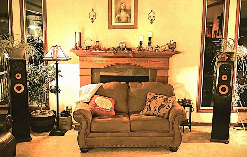

Here's a rare glimpse of the speakers pulled out from the corners of the room:

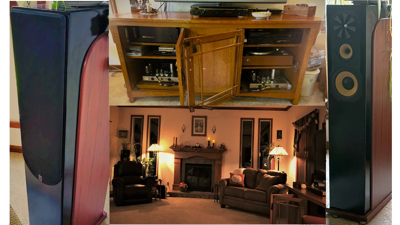

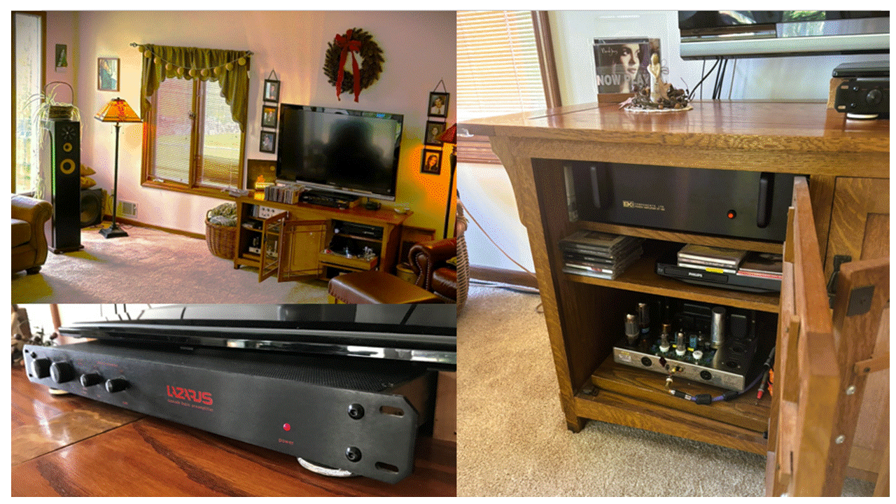

Right side speaker and tube amp:

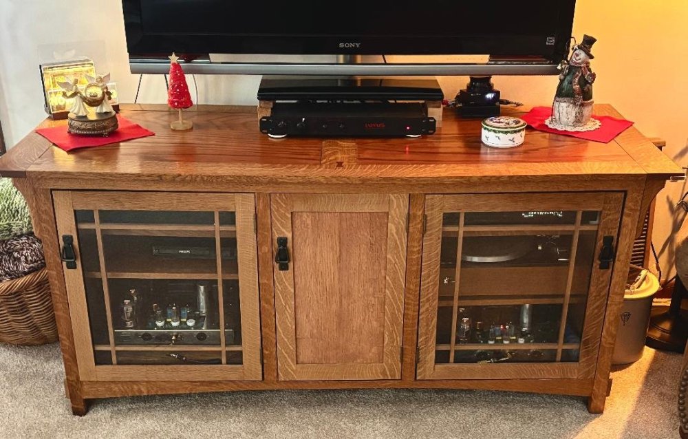

A glimpse of the wife approved version of the room:

Hagerman Cornet 3:
The layout as of early December 2025:

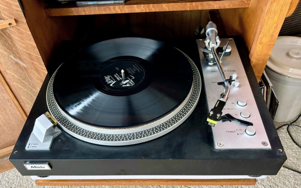

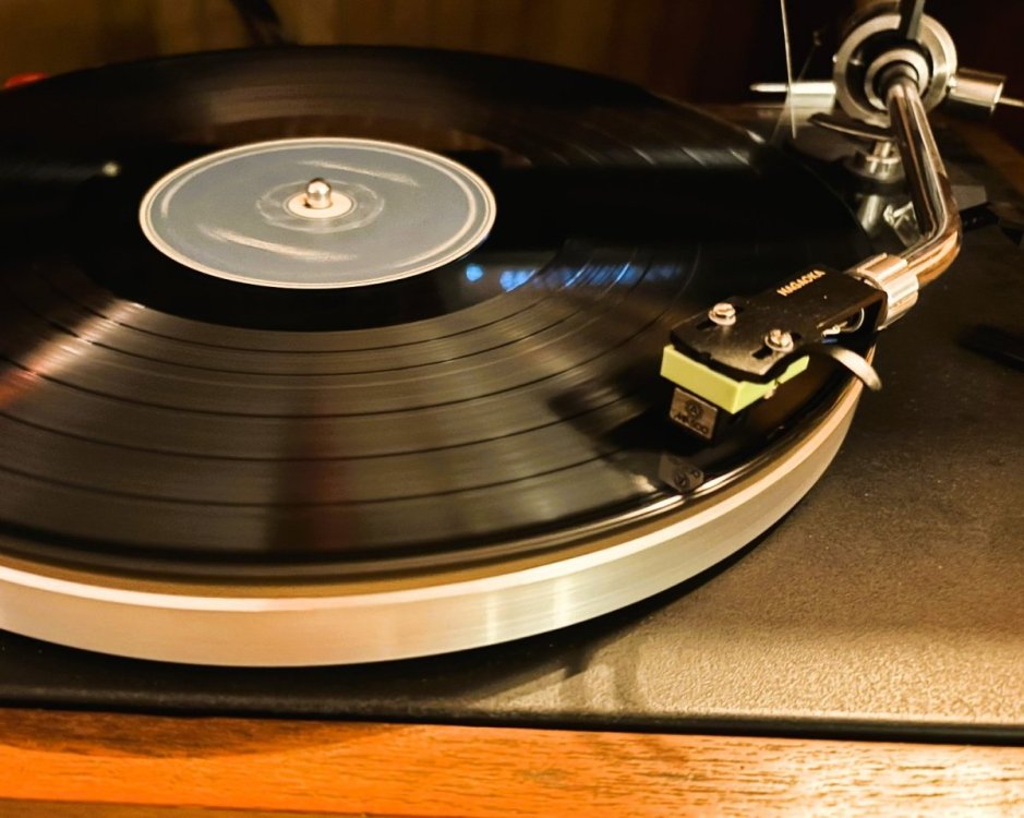

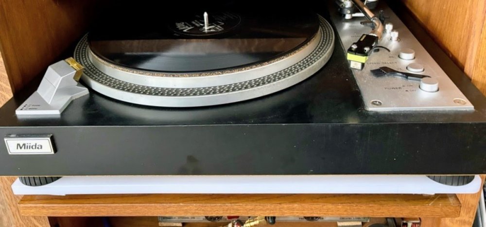

I recently added a Miida T3115 direct drive TT to complement my newly completed DIY Hagerman Cornet 3 build. The Miida is the same as the Denon GT700 or SL-7D.
