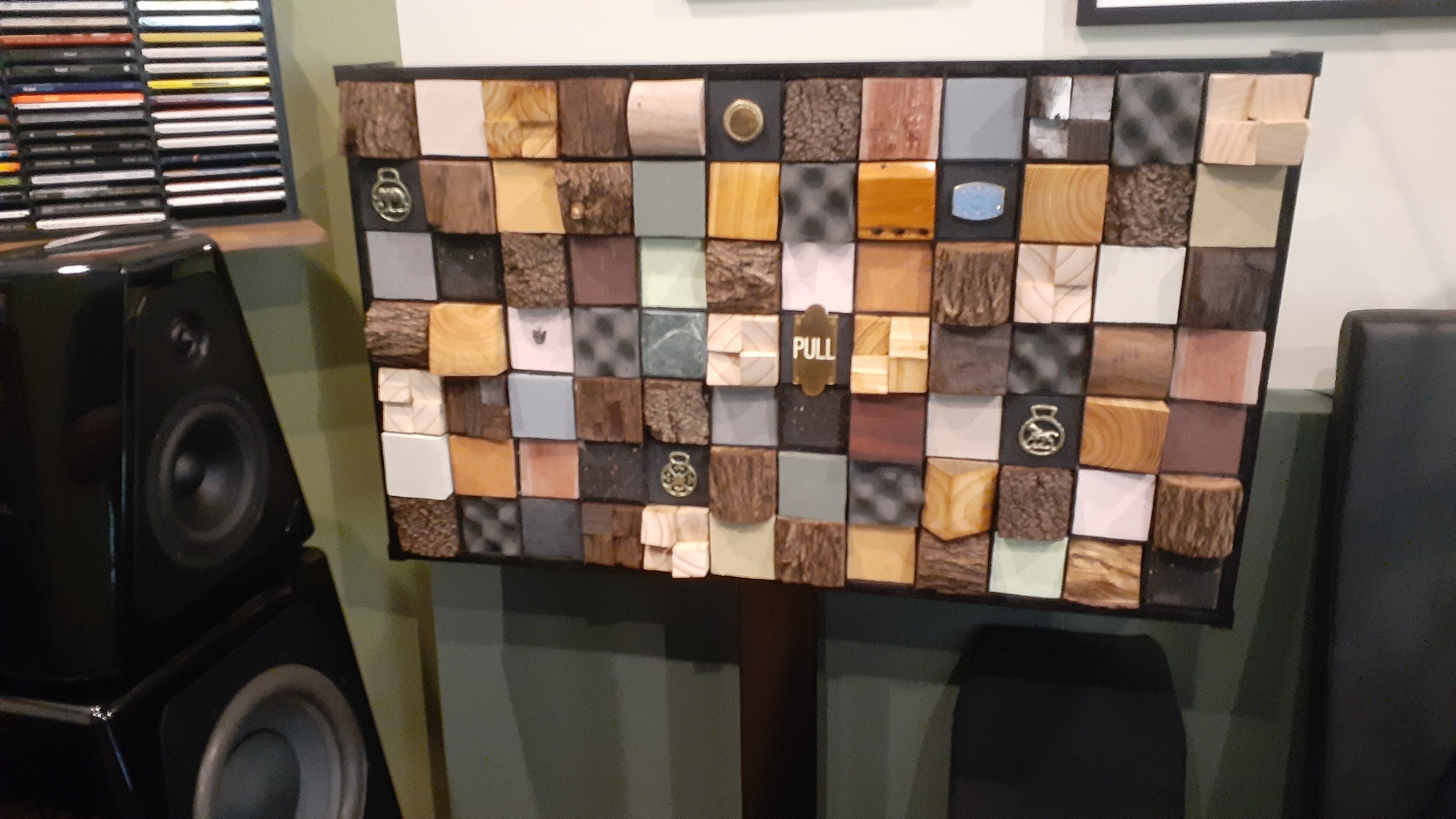

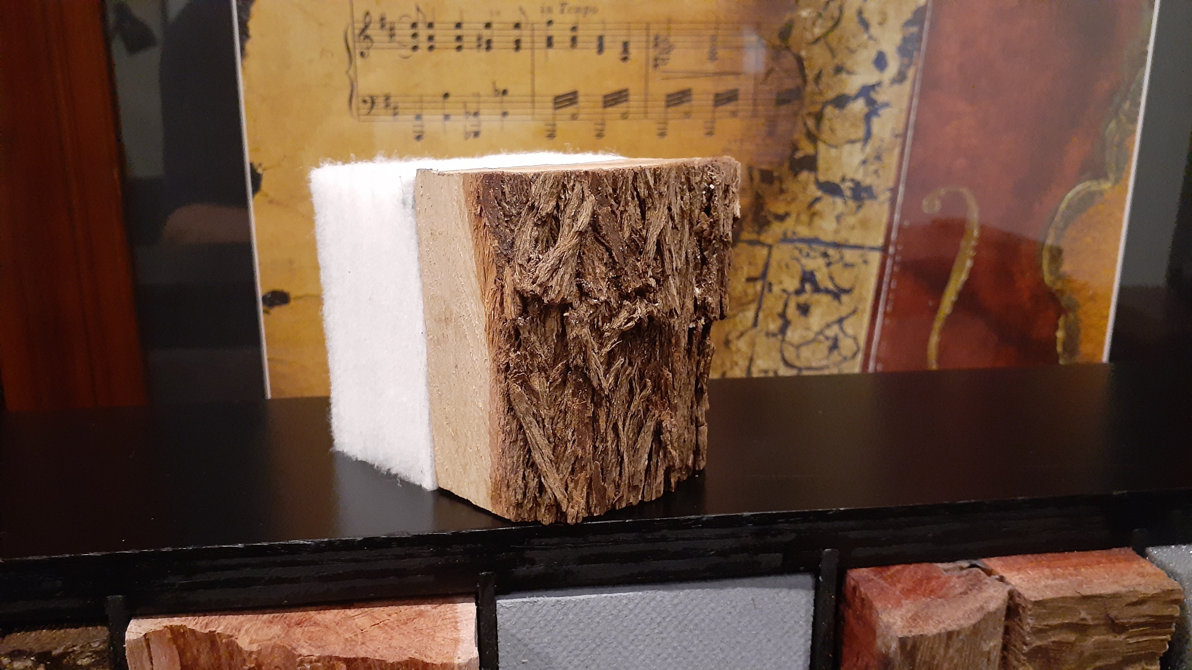

Here's my first reflection point diffuser / absorbers. Free standing frames on old speaker stands, weigh 22.2Kg. 70 to 90mm of Autex Acoustics Quietspace® Panel then 84 blocks of rough wood shapes, bark faced wood, polished wood, quartered angle shapes, soft blocks, vibration squares, stone slab, Absorb-foam, oh! and horse brasses. Wooden't (gedditt) be without them now, definitely (maybe) tighten up the sound stage imaging without deadening.

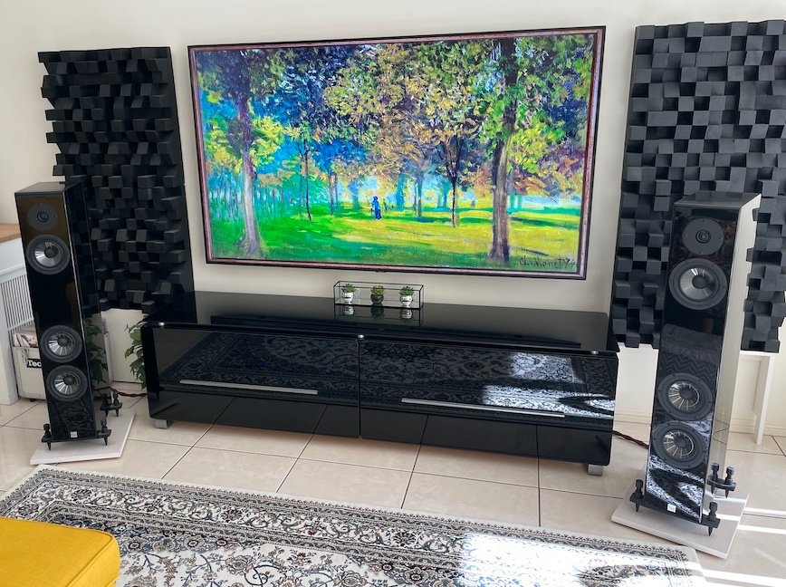

I am not sure if this will help - but I did not want to put a heap of holes in my walls either - so I had to come up with a plan.
So I shall share two ways I have done this:
On the wall behind my listening chairs I have four of  600mm x 600mm panels.
On the back of these they have a magnet to attach them to the wall, but that meant having to permanently put up other fixings to the wall to do so, also I have seen that the magnet system can fail and they can fall off so my OCD wanted a more secure plan.

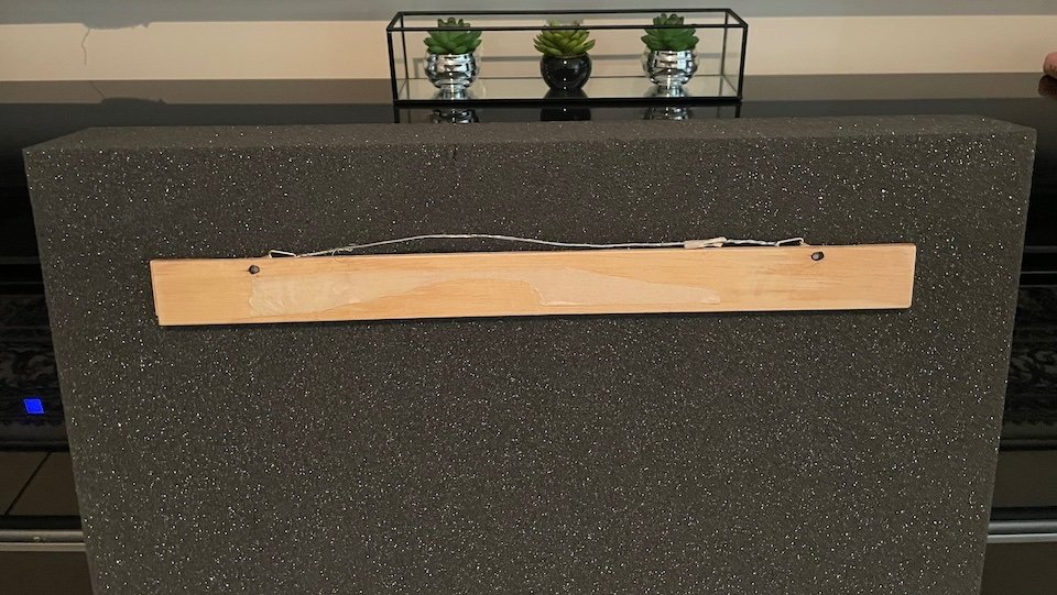

So  I had a strip of craftwood cut for each panel to reach magnet to magnet and I glued the strip on to each magnet - then it was a simple thing to get a picture framing set and attach the fixings with wire on the back of the glued strip which that allowed me to hang each panel like you would a picture, on a single nail for each panel.
I had to get the bottom two perfectly level, then the two that sat on the top was easy - so all four are simply on one small nail each which leaves a tiny hole and easy to patch up should I wish to move them.
Edited by April Snow
The panels I have on the wall behind my speakers - I worked out the height I wanted them - which in my case was to match the TV height & I had a small frame made up which I painted to match my wall colour - this allowed me to sit one panel on top of the frame and the acoustic panel  that sits on the very  top of that is also on a picture framing system like above. This panel was a little easier as it had a wooden back so easy to attach the picture hooks.
So on this wall I only have one tiny nail hole each side of the TV.
Hope all that makes sense?

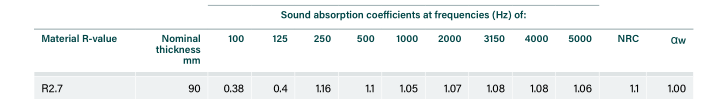

The panels ended up being roughly 500*1200mm 6 kg each with the following specs as per the manufacturer of the insulation.
