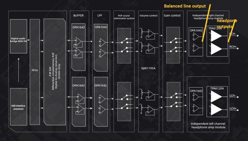

Just tried it for you, yes it does, but the "high/ medium/low analogue gain switching"  only works on the headphone amp output/s (TPA6120) and not the XLR balanced line output, it just has the analogue domain volume control.
I did try the front (TPA6120 output) "balanced headphone output, so I could try those 3 x gain options with analogue domain volume control  straight into my Hypex NC500 monoblocks used as a line out, and the (TPA6120) as a line out sounds a "little smeared" in comparison to the (OPA1642) balanced rear line output/s.
So to me you get this more to drive power amp/s not for it's headphone stage which while good, is not as transparent as the rear line output/s.

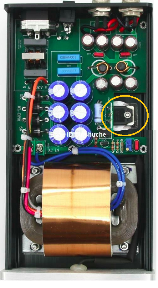

As for the LPS I was going to make my own then saw this deal and thought why bother it's got the goods in it, 50w Black Friday deal for $100 shipped

  • Author
41 minutes ago, MrBurns84 said:
Cheap but effective, runs hot though.
Odd, mines just lukewarm powering the FiiO K13 feeling under the chassis where the regulator ( attached in yellow ) is mounted to the chassis bottom, and the transformer is stone cold so are the bridge rectifiers.
Cheers George

The volume control in the K13 is about as transparent as you can get as it is a chip based series/shunt balanced resistor ladder network NJW1195A. https://www.mouser.com/datasheet/2/294/NJW1195A_E-259014.pdf?srsltid=AfmBOor36QJ8_VlWVVd1YRMhRUG2rvuSx1yYyCsZcEdP_bm_M-sum2g1

Yes the K13 is series/shunt balanced resistor based volume control NJW1195A is in the analogue domain perfectly matched from the OPA1642's output coming into it and a leaving into another OPA1642's input. (no problems with it)
