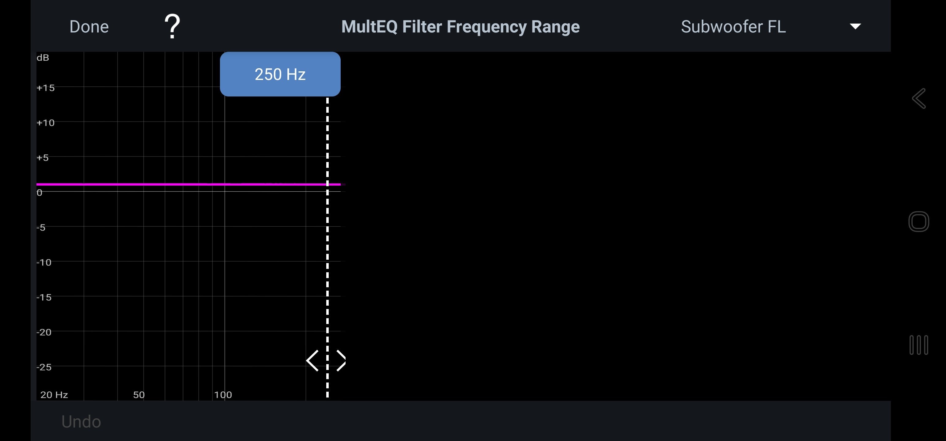

Hi everyone. Just a quick question.  If i have a dip at 120htz , will it benefit if I go into the lpf for lfe setting in the avr and change it from default 120htz to 100 htz.? Also if I go into the audussey app and change the multi frequency range for the subs from 250htz to 100?

Hi.  After running audussey through the app.  Audussey has tried adding correction to the subs from  250htz and under.  I might be able to share a pick.
OK, well I think if you change the correction range from 250Hz to 100Hz then that would be going backwards about addressing the 120Hz dip, because then it would not be in the range of correction. I think is 250Hz is a good correction range and I use similar myself with Dirac Live.
