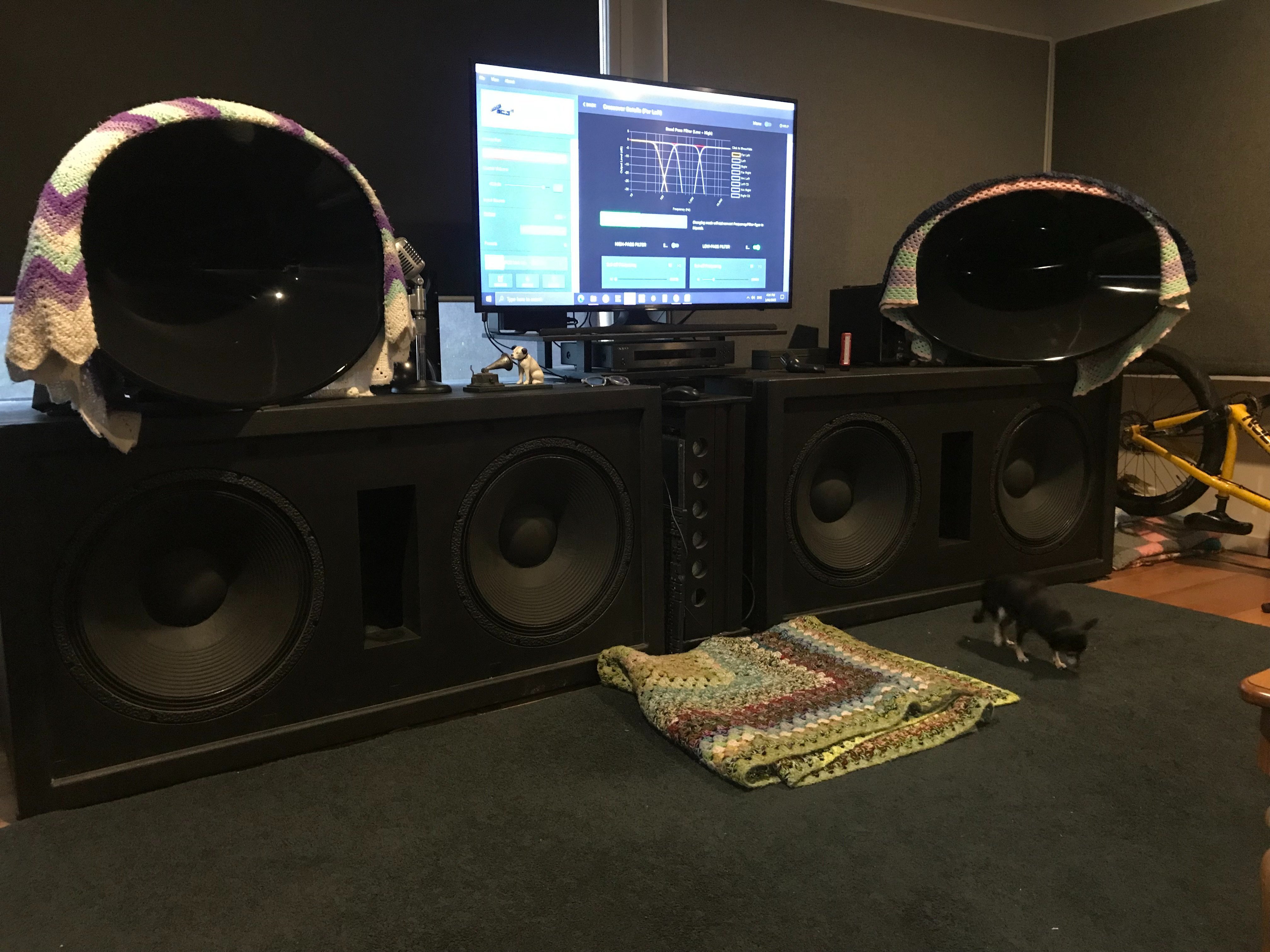

Agree completely, limp mass membranes work very well "whole or most of the side and rear walls", with experience in 2 separate rooms. 12.5m2 across 3 walls in one listening area. A complete wall in the rear of another room, with 1m to 1.5m tapered gap to the cement wall behind, the area behind was completely filled with XDR acrylic sound absorber, this fake wall, was no more than a normal pine frame with the limp mass membrane suspended behind the pine frame, a layer of restrained XDR bats then a fabric layer facing into the room. IMG_9849.JPG.13b0613240ed79d1a3a2804513b04f82.thumb.jpg.d51b19662e62ec474c7233786988f126.jpg
The photo depicts 2 of the wall mounted limp membranes, on the RHS of the system in front there is another on the LHS of the system 1.3m x 3m, wall mounted as well. Note, fabric overlay, framed in 200mm/19mm painted pine board. There is an inner frame which was bugle screwed into the wall structure, which the membrane frame was suspended and actually then sealed for air chamber to the wall.
Needless to say both stereo systems/room interaction changed profoundly to the ear, to measurements below 150Hz if not for the simple large scale of the treatments. All DIY, self learned, measured and documented in a thread I did a few years ago.
@acg mentions that you cannot have too much bass treatment in a room and agree, I also agree with "more is better" above depiction 4 x 21" drivers as pairs in 650 liter enclosures with band pass of 20 to 250Hz, drums sound like drums, bass sounds like bass, rocket take off, sounds like a rocket take off  ! 🙂 No substitute for size, none,,,,,
