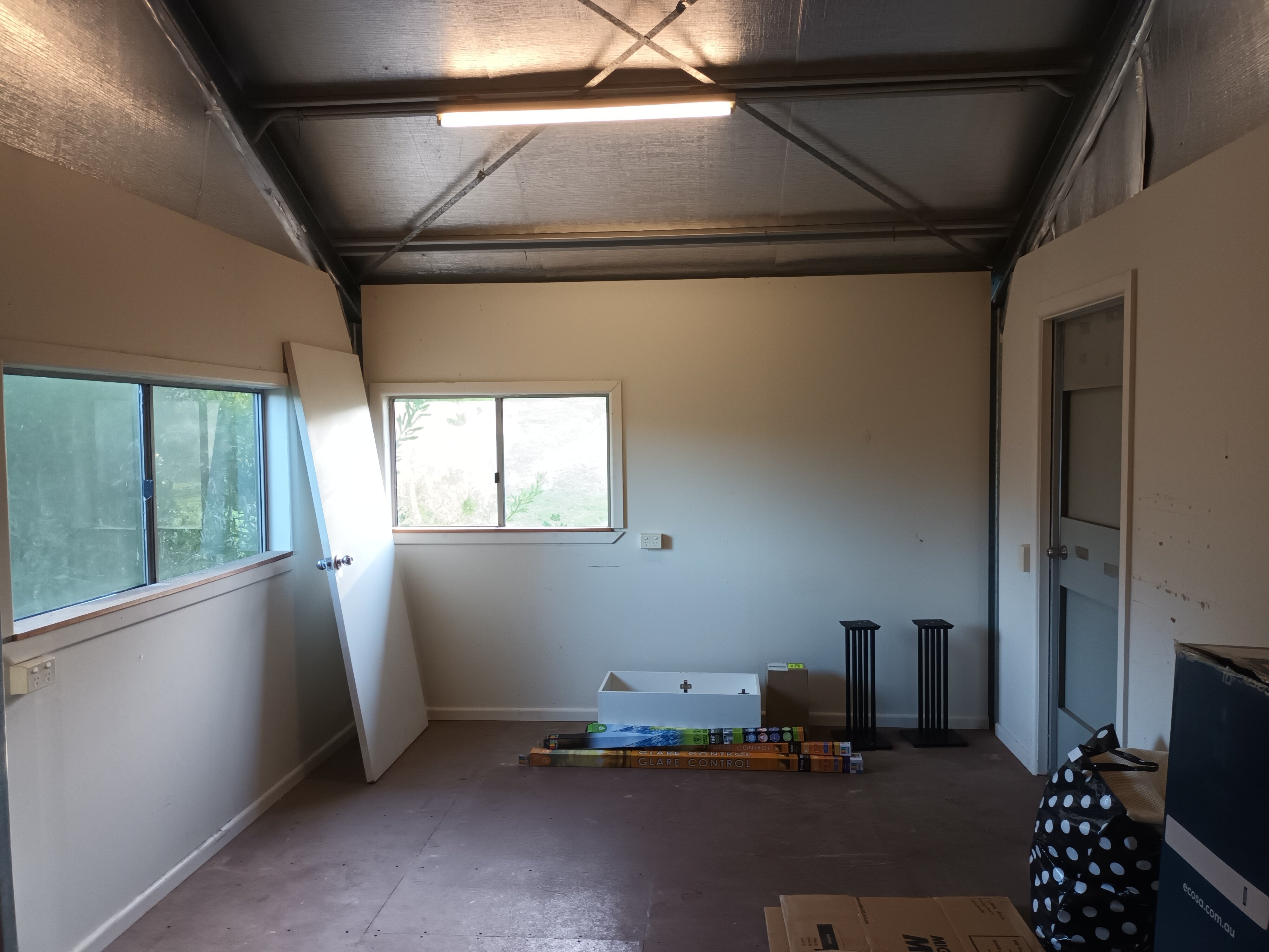

We recently purchased a property and it came with a half-finished studio (approx 3.3meters x 5.6meters internal).
I have always dreamed of having my own space as a dedicated listening room, so the plan is to convert this studio and hopefully do it properly. I am reasonable with DIY but I don't have much building experience.
I'm wondering if anyone here has experience with this type of thing? I have found information about converting sheds into recording studios but I'm not sure if that applies to a space that is purely for listening.
My thoughts so far:
  • The existing plaster work etc will come out
  • I'm thinking the wall cladding will need some sort of vapour barrier/insulation layer? The roof already appears to already have this.

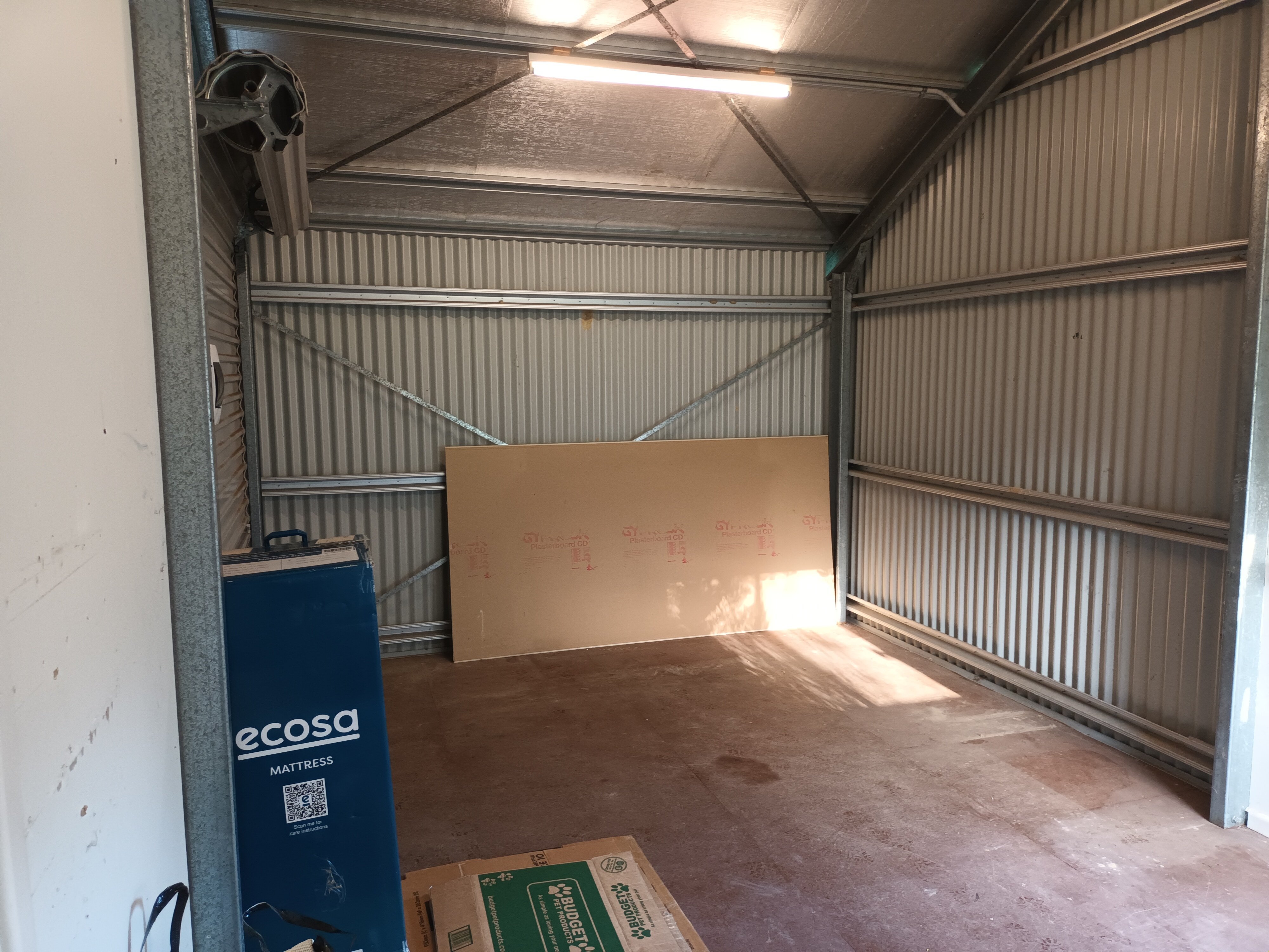

  • The roller door will come out and the wall will be reinstated.
  • A timber frame would be made to isolate the internals from the steel structure (to what specifications I'm not yet sure).
  • Some sort of plasterboard would be affixed to the timber frame, with another layer of insulation/soundproofing behind.
  • The subfloor sits directly on steel joists, I'm not sure what to do with this.
  • I'd like to keep the gable roof inside, I'm not sure what this will do acoustically.
  • I will be going down the path of room treatment as well
I'm still in the very early stages, any advice/resources/product suggestions would be welcome.
Thank you,
Phil.
