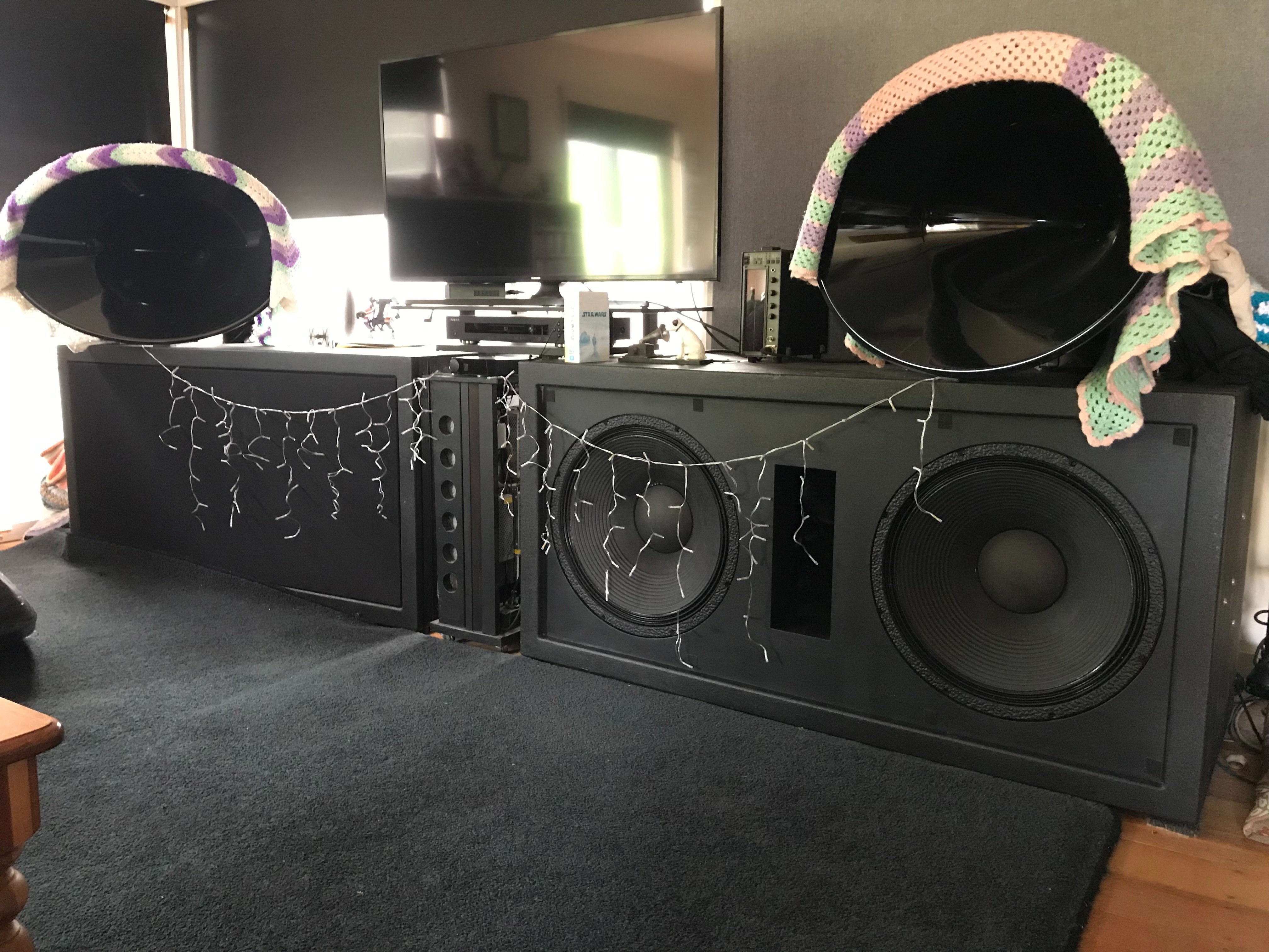

Gday
Had similar issues with an all timber, suspended hardwood  floor, house.
It was a big job to fix, as in double plaster walls, double glazing, huge wall panels of weighted membrane bass traps, ceiling trapping and moving the speakers  many times. Speaker isolation with large sorbothane pads.
As like the Members suggest above, it's a combination of a few things going on.
De coupling (acoustically and physically) the ported sub from the corner loading might help, If your main speakers are also  loaded into corners, it would help to bring them into the room away from the walls, and even up off the floor That and physical decoupling speakers/subs vibration damping as suggested.
If just doing that helps, all good, beyond that though some bass trapping will help quite a lot.

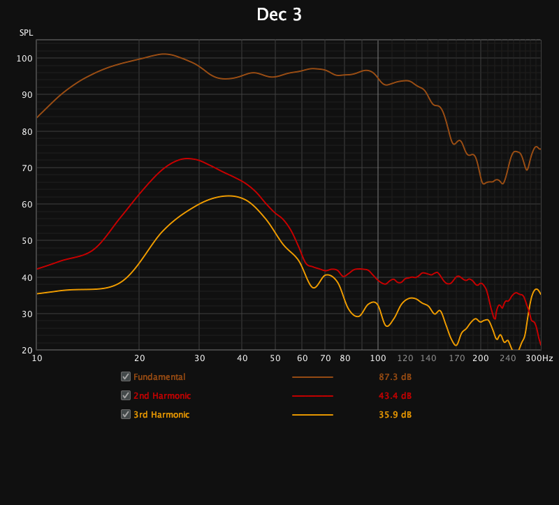

Measurement below of system "resonance" beyond the fundamental, before sorbothane bumpers added to the enclosures and after. Tactility resolved,,,,,
distortion.gif.77ca59e85fbbff81a07a21c7f7a50571(3).gif.b88076821ebb0e82e65fc6d0503cb805.gif
