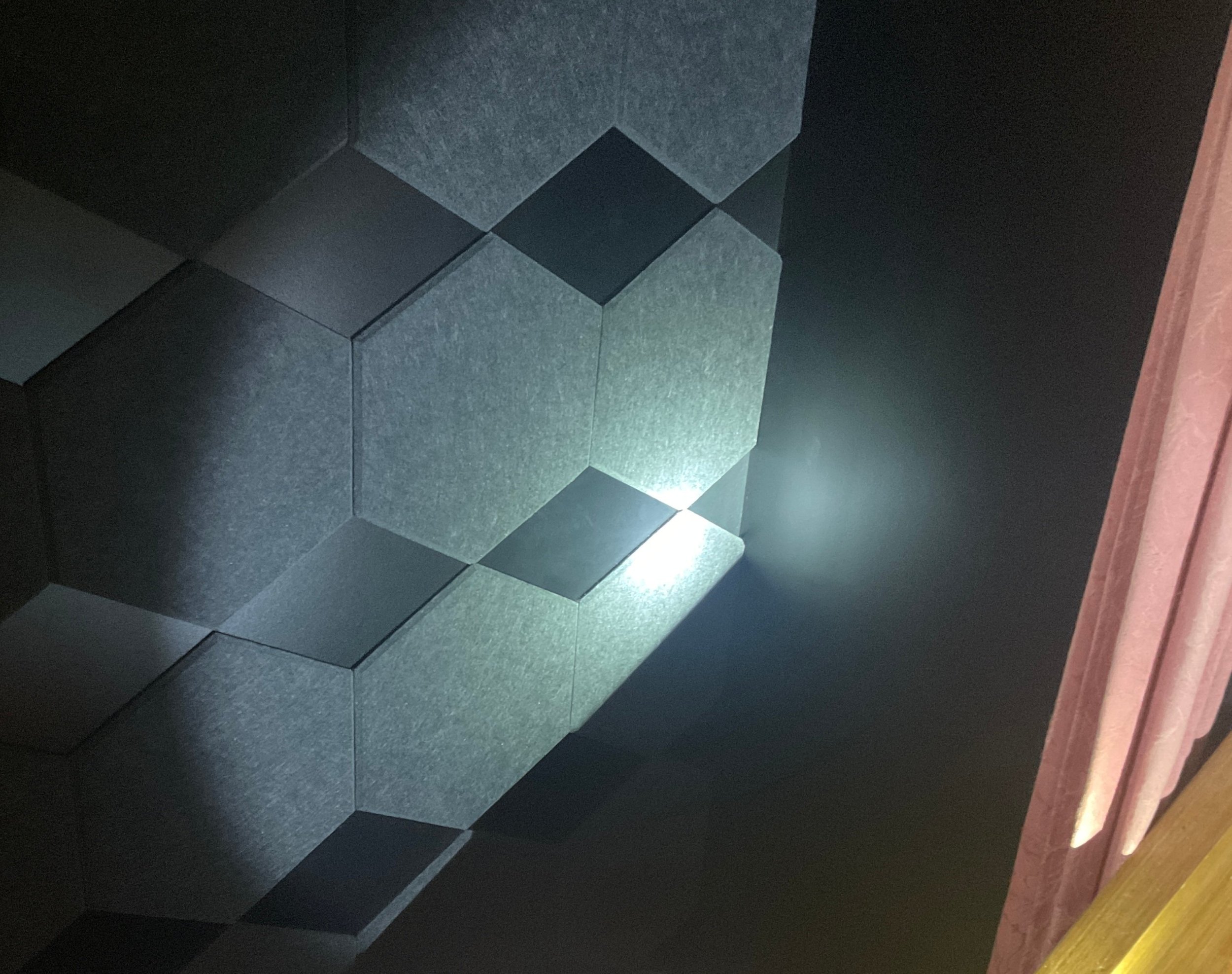

  • Author
Think along these lines 😉

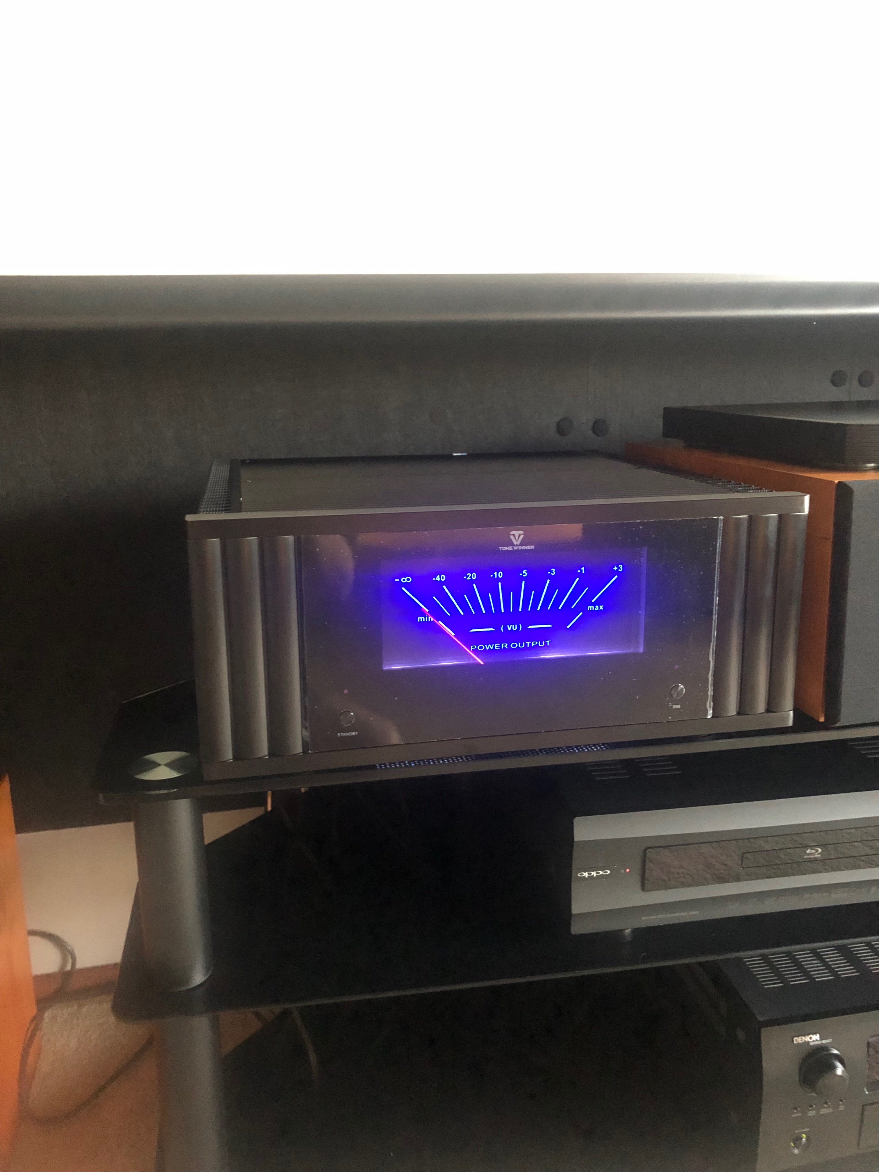

Have a space next to my audio components measuring 1.4m x 1.0m x 0.6m (9mm thickness) and always thought it needed some acoustic treatment. Cruising through Bunnings and found SPECRITE PANELS on special at $19 for 12 Hexagonal self adhesive tiles. Anyway I used "charcoal" rather than white or blue or orange and took care of that area.....just did the back wall but could get out of hand. Cuts easily with a box cutter blade too.

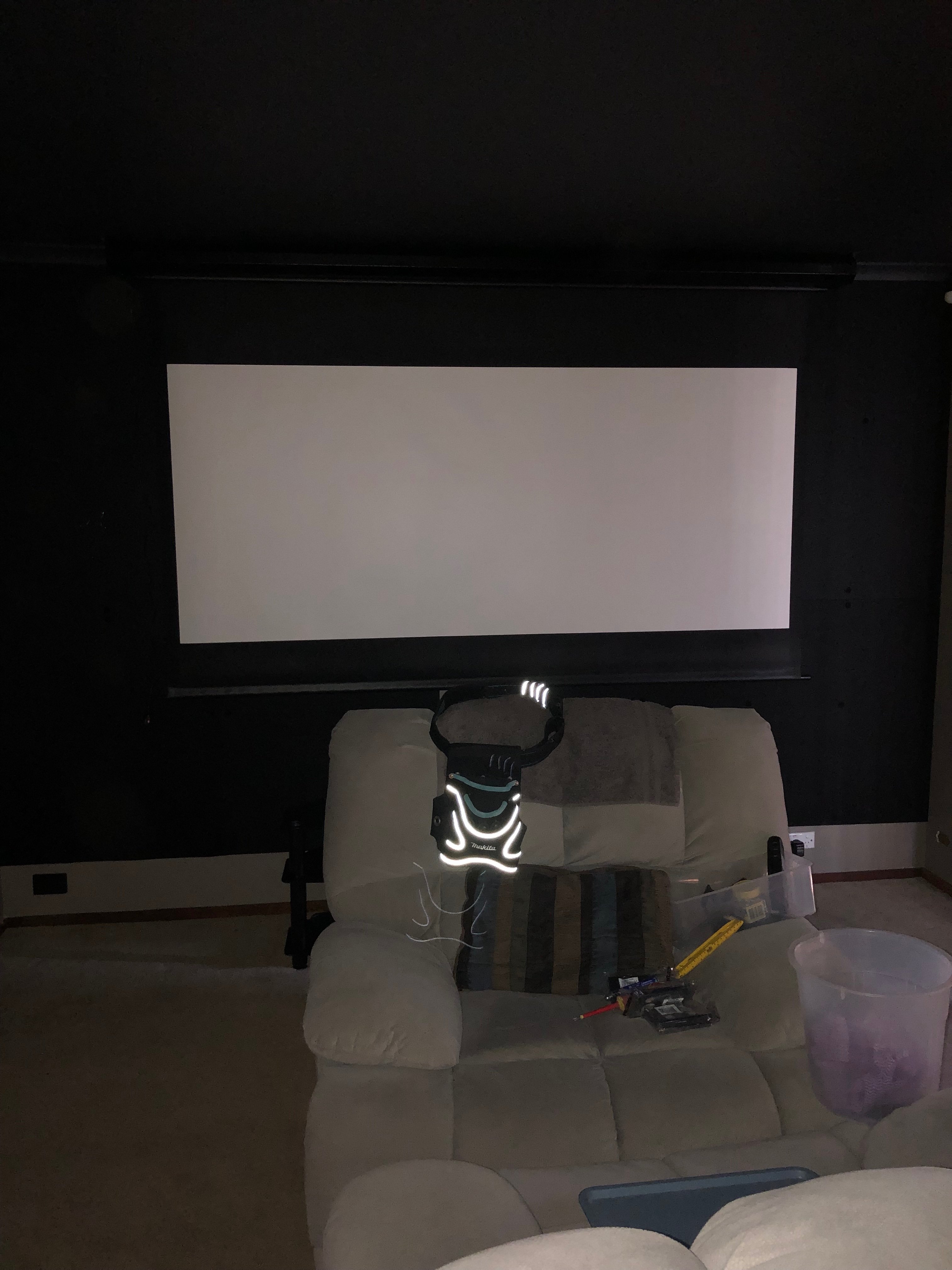

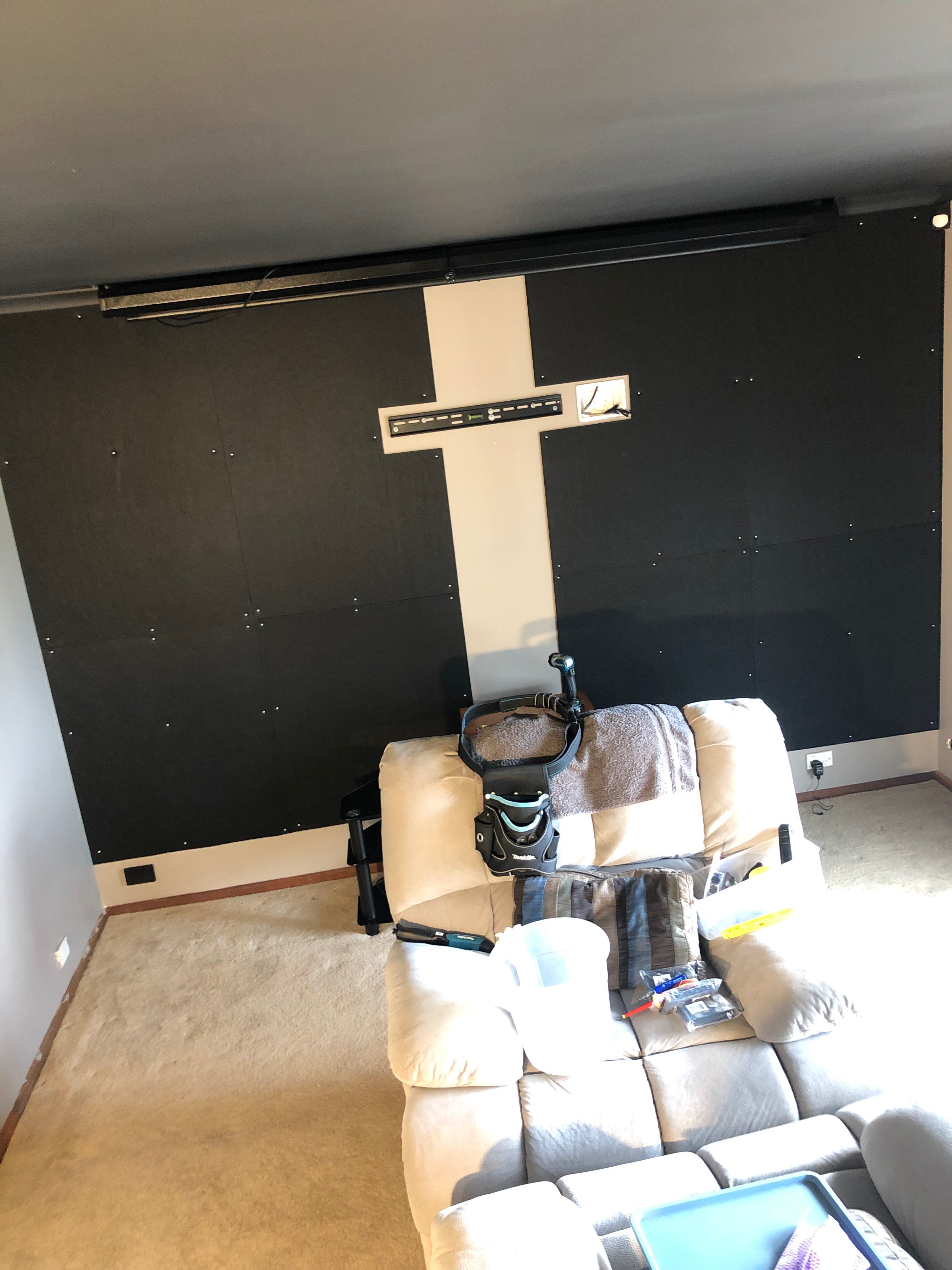

i have lined my projector wall with the black felt panels from bunnings.
they have a NRC of .9 at the higher freq's
they do help reduce slap echo and complement my other treatments
they improved the whole veiwing experience hugely
zero light spill on the front wall, also seemed to be an improvement in percieved contrast
i went with smaller 1200x800? size as they are easir to handle
i fixed with wall grabs ,straight into gyprock,suprisingly solid, dont overtighten!
then covered each screw head with sticky velcro dot( soft part)
not the most eye pleasing but the wall just disapears when the lights go off.

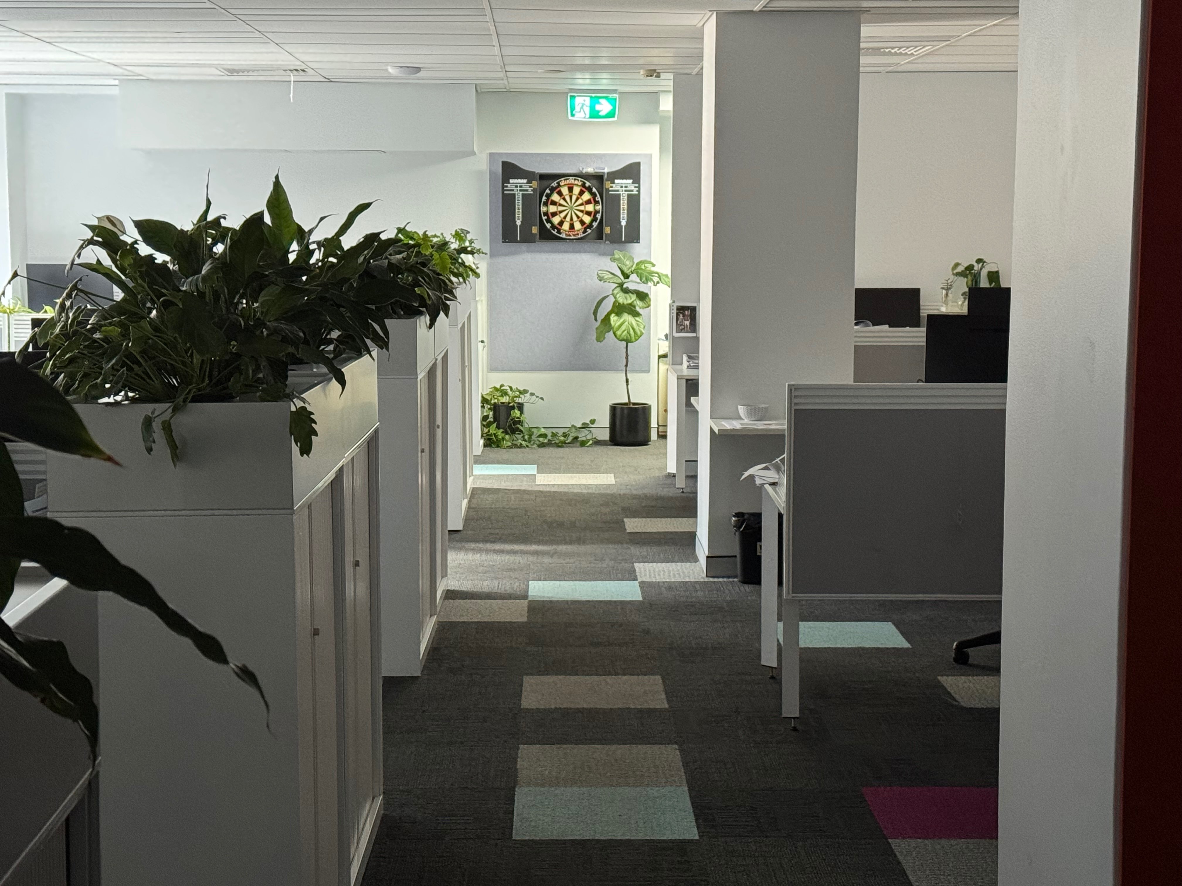

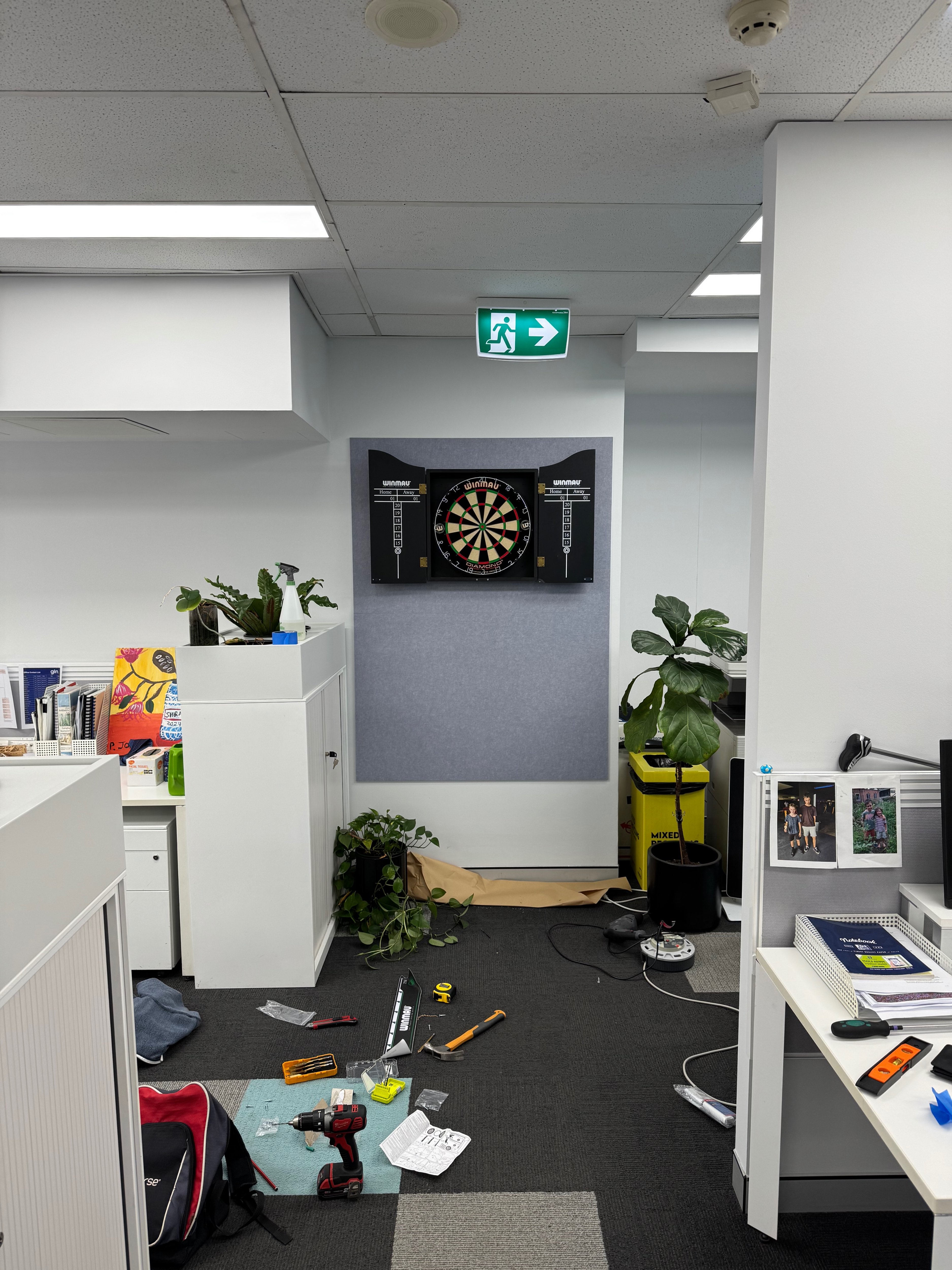

I installed a couple of those exact panels yesterday morning (although light grey in colour) in the office as part of a dart board installation.
I ended up using some Gorrila Grip branded double sided tape and it worked an absolute treat on a painted masonry wall. Super strong hold. I used around one roll of tape (7m) per panel @ $15 per roll. Definitely a viable option if you want to avoid using screws, although I suspect it will be harder to clean up if you want to remove the panels later.
