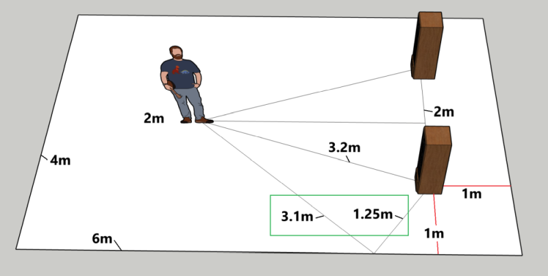

Hmm, if we are designing a room from scratch, it is worth remembering that long wavelengths and short wavelengths have different requirements.
Long wavelengths will form room modes. They will always form modes, regardless of shape, ratio, and size (within reason). They will form fewer modes if the room has a large opening to another space, e.g. adjoining dining room. Regardless, we should accept that modes will form and we need another strategy to deal with them. The only time modes won't form is if a half wavelength is longer than the room - this is so-called pressure mode. For most listening rooms, this will occur very low, about 25-30Hz and higher for cars. But you still get room modes above this frequency.
Short wavelengths have a completely different consideration. You want the reflections to arrive delayed, diffused, and attenuated. The only way to achieve the delay is to have a larger room. The minimum delay considered "ideal" is 5ms. Sound travels 0.34m in 1ms, so for a 5ms delay, the reflection has to travel an additional 1.72m compared to the direct sound.
Most "decent sized" listening rooms I have been to are about 4m x 6m, which I have quickly drawn in Sketchup. You can see that if the speakers and listeners are placed in the locations indicated, the reflection path travels 4.35m in total. Since the direct sound travels 3.2m, this would give a delay of 1.15m, or about 3.35ms. It is still short of our 5ms threshold. You might be able to improve things by sitting a bit further away.
Anyway, as can be seen, the priorities for speaker placement are completely different for high frequencies and low frequencies. For high frequencies, we want to position the speakers for best possible imaging - reflections need to be delayed for as long as possible, placement needs to be symmetrical, and so on. But for low frequencies, we want the speakers placed where there are as few dips in the FR as possible. It is rare that the two positions coincide. This is why we use subwoofers, it removes low frequency placement constraints on the main speakers.

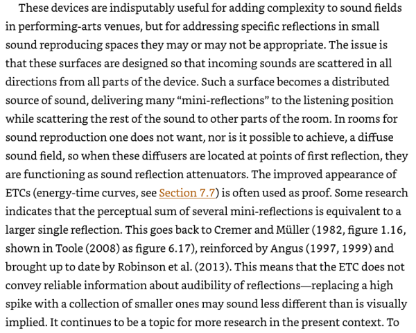

Respectfully disagree.
Re: absorption. Attenuates but does not delay.
Re: diffusion. See Toole Ch. 7.3.2:
Not mentioned in Toole is that diffusers do not add additional delay, unless they are very large. For example, a large convex surface mounted on your wall will change the direction of the reflections and lengthen its flight path, which will increase the delay. But I don't think most people would want to do that.
Re: controlled directivity speakers. This changes the ratio of direct sound power to total radiated sound power, i.e. the DRR (Direct to Reverberant Ratio). It determines if the critical distance is longer or shorter. Nothing to do with delay.

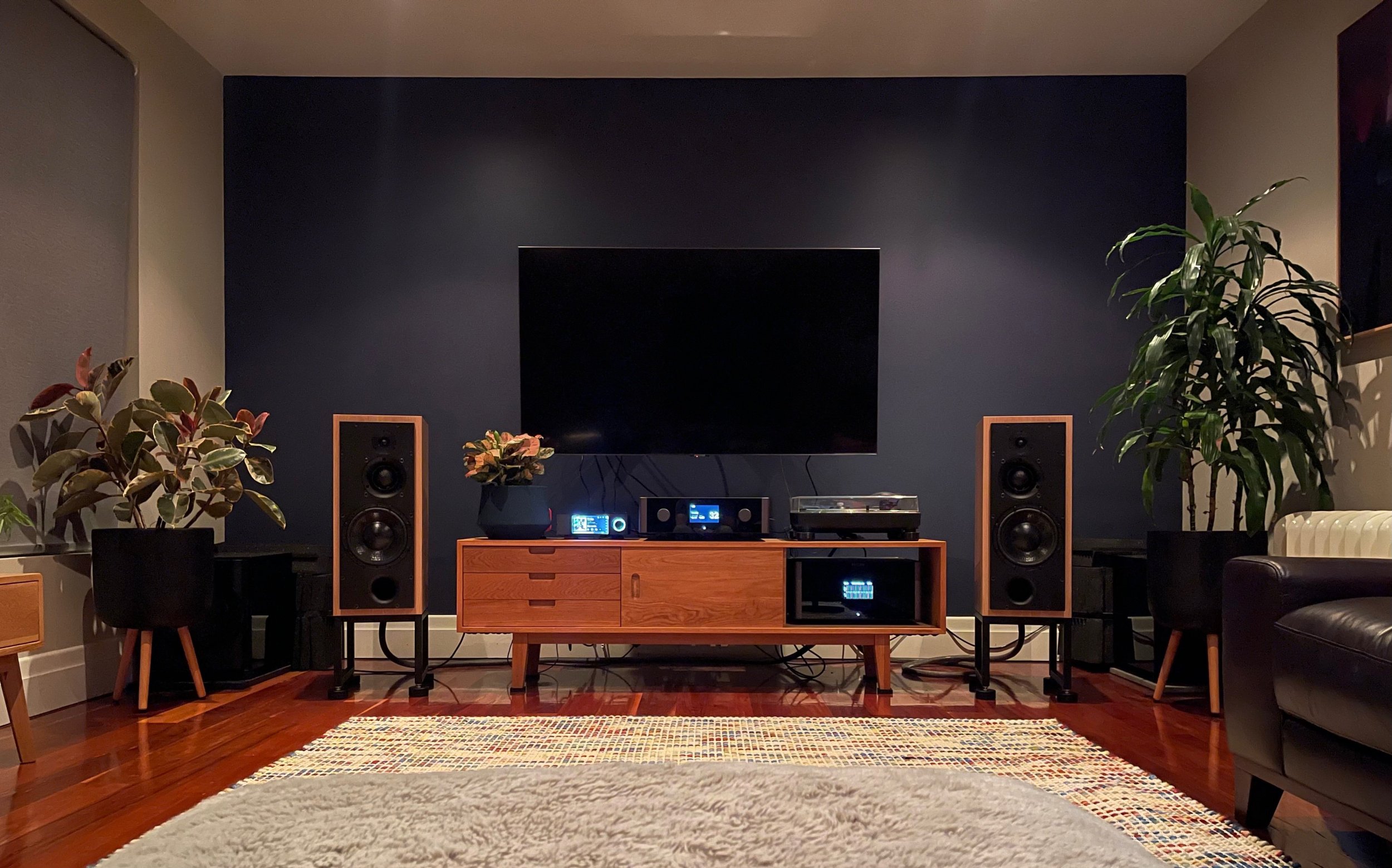

All great reading on here.
I’d like to add some weight to the importance of reflection when it comes to sound stage. IMG_0666.thumb.jpeg.5cef933794b09d7871e2123d65c13f05.jpegThis is my living room, see the blind on the left, when it’s shut like that and you’re listening with your eyes closed a centrally recorded singer is often situated just right of the TV. Open the blind and the singer moves across into the tv area by about half an metre (and the voice appears to clear up a bit).
Throw a shaggy blanket over the TV and the voice appears to clear up even more, but that may be a pseudo placebo because I was told it would.
