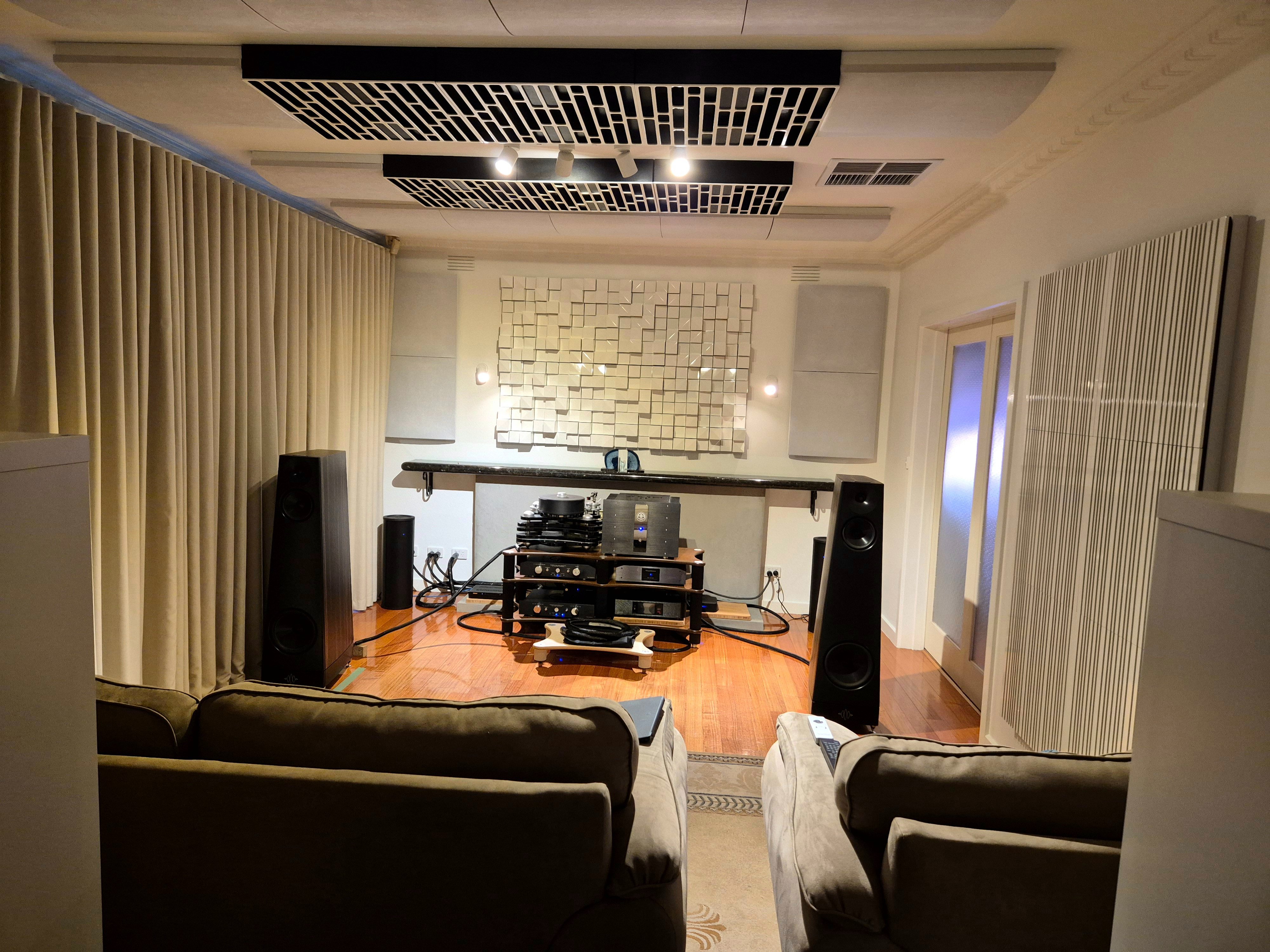

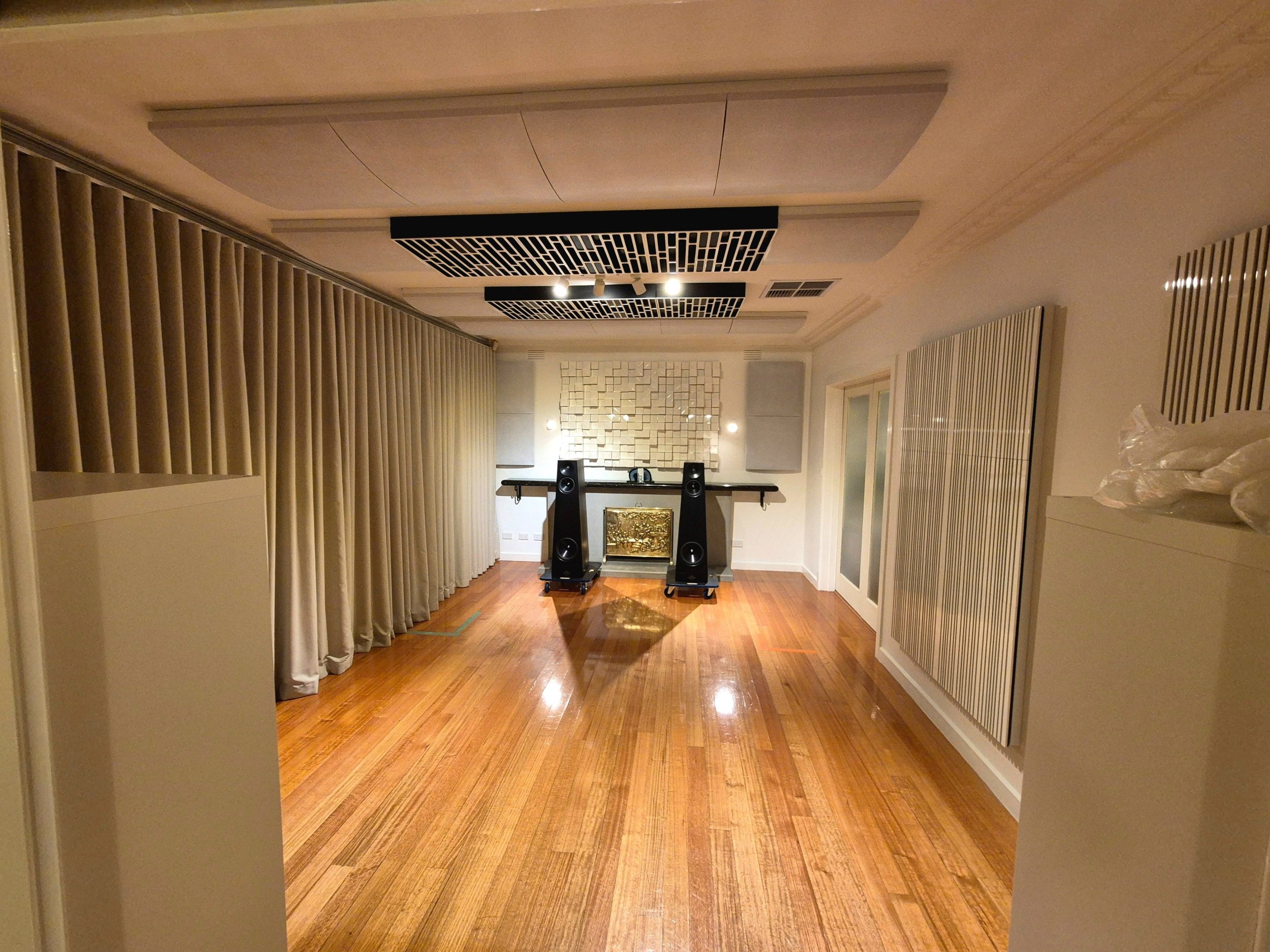

@Bass13 would you mind sharing how the setup "looks"?
  • Author
Ok, Here's a couple pictures
Just waiting on my stands for my other six Siena panels on the left, to mimic the right hand side Siena wall panels.
Edited by Bass13
You're very kind - that looks GRAND.. 🤩
