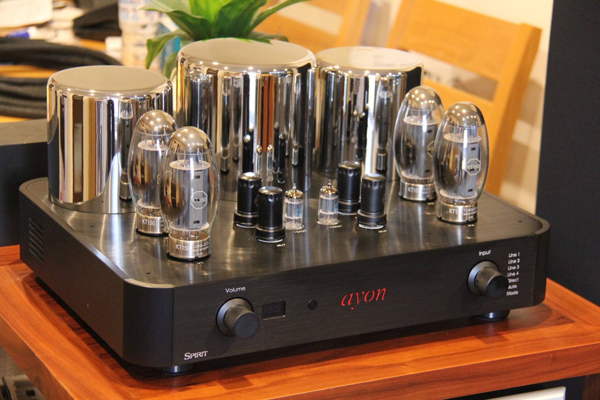

Vacuum Tubes
The choice of signal and power tubes have a significant influence on the sound and hence on the inspiration and joy of listening. This is not only the decision between good and bad tubes but finally the interaction of the different types of tubes and their combination that are used in the various Ayon amplifiers.

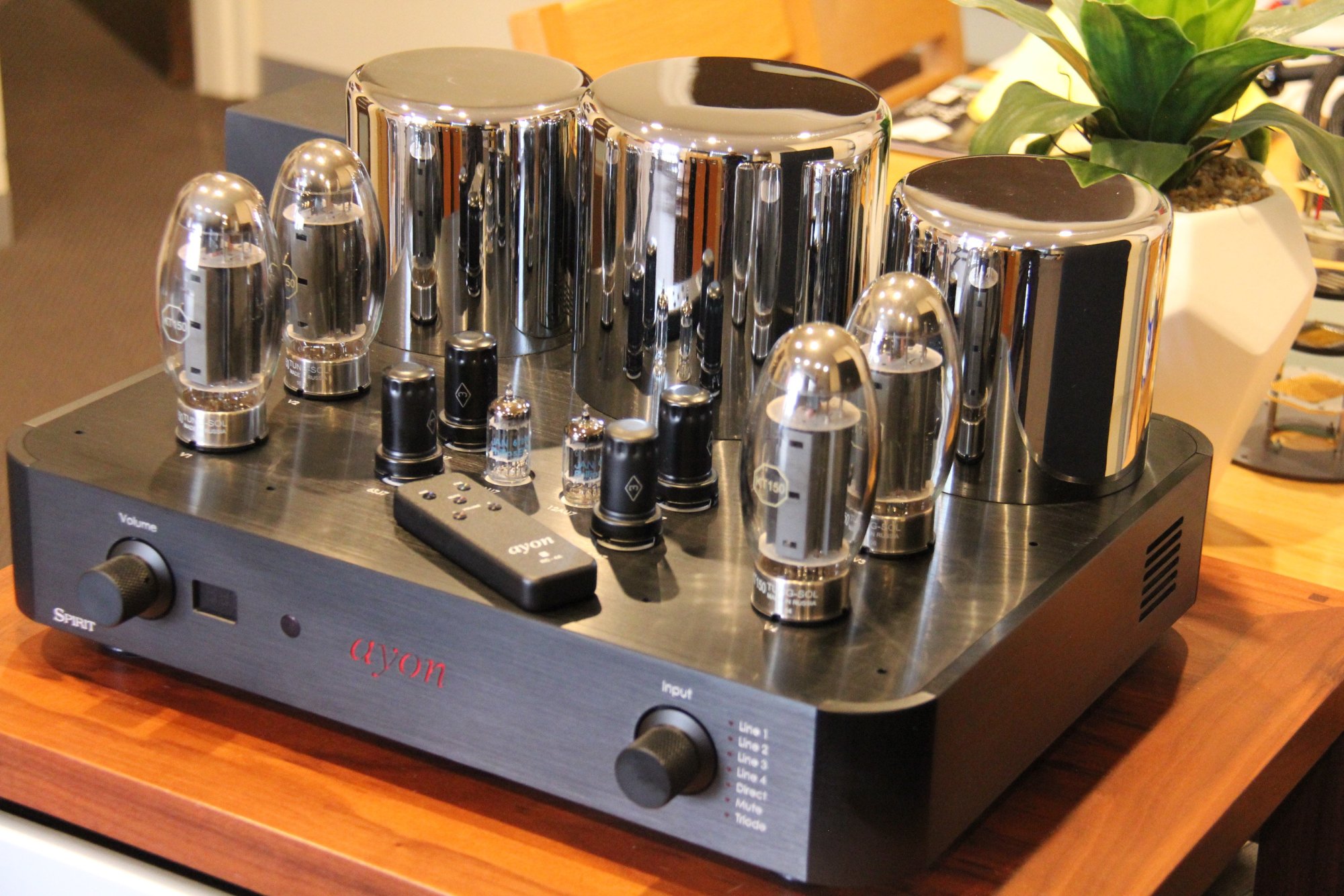

The high grade aluminum chassis impart a richer, more lustrous tonality with a cleaner background and less hash and grain. All brushed anodized anti-vibration-resonance and non-magnetic chassis’s are fully hand assembled to insure the highest level of craftsmanship.
● Improved heat ventilation chassis
● Custom-made machined control knobs
● The aluminium feet are resonance absorbing types
● Backlit “ayon” logo
● All front & rear panel descriptions are engraved

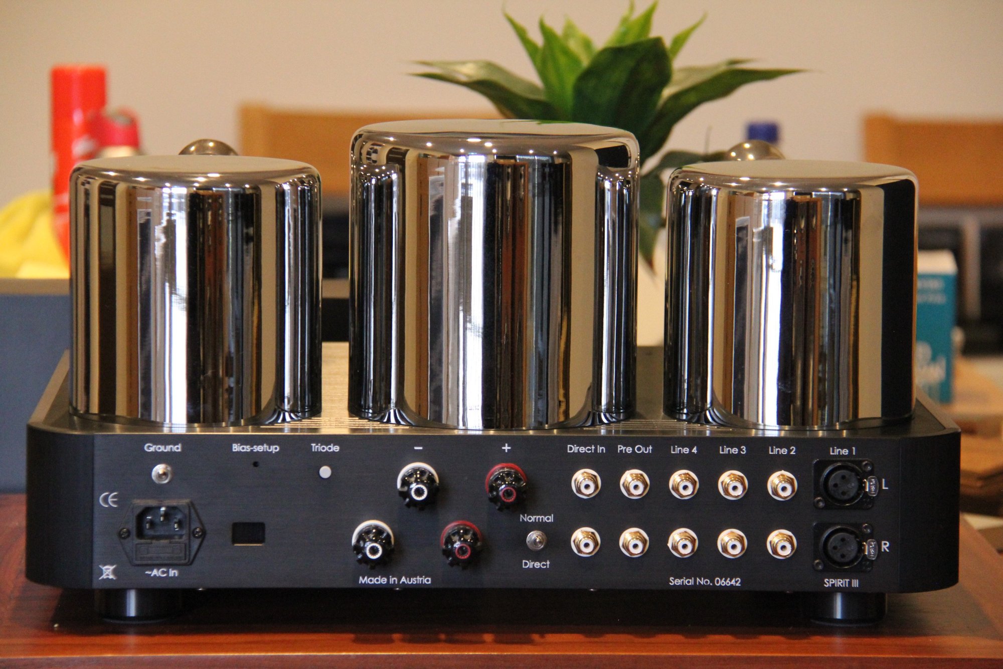

● 4 line inputs & 1 direct input – for pure power amp operation
● Ground switch
