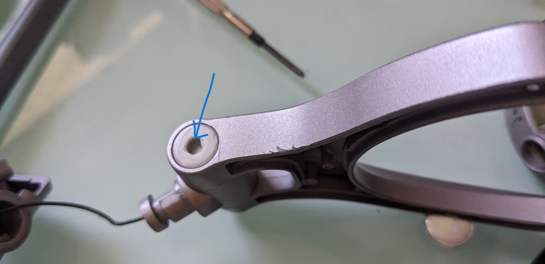

Spider27 Posted October 11, 2023 Share Posted October 11, 2023 (edited) Hello, My Shure SRH940 headphone is broken on hinge so try to replace it with another headphone that I have and could not figure out how to remove the hinge somehow. Has anyone tried to repair headphone and remove hinge before? I found that there are many case of broken hinge on 840 and 940 models so it seems that it's quite common. Here is the photo with highlight. Any help would be hugely appreciated. Thank you. Edited October 11, 2023 by Spider27 Link to comment Share on other sites More sharing options...

audiofeline Posted October 11, 2023 Share Posted October 11, 2023 It appears that the hinge takes a specialised screwdriver, a circular shape with a side filed off, like a "D". I would expect that there is another one on the other side. Put a screwdriver in both ends, and I would anticipate the hinge will screw apart into two pieces. 1 Link to comment Share on other sites More sharing options...
