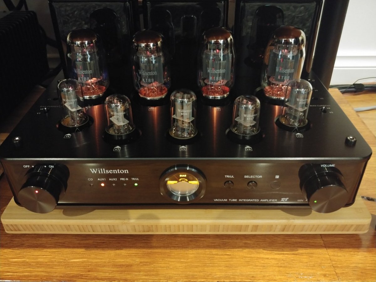

    Happy New Year to all Willsenton owners. Just checking in to say that my totally unmodified R8 is now 5 years old, still working perfectly with my vintage tube set and still making great music. Still

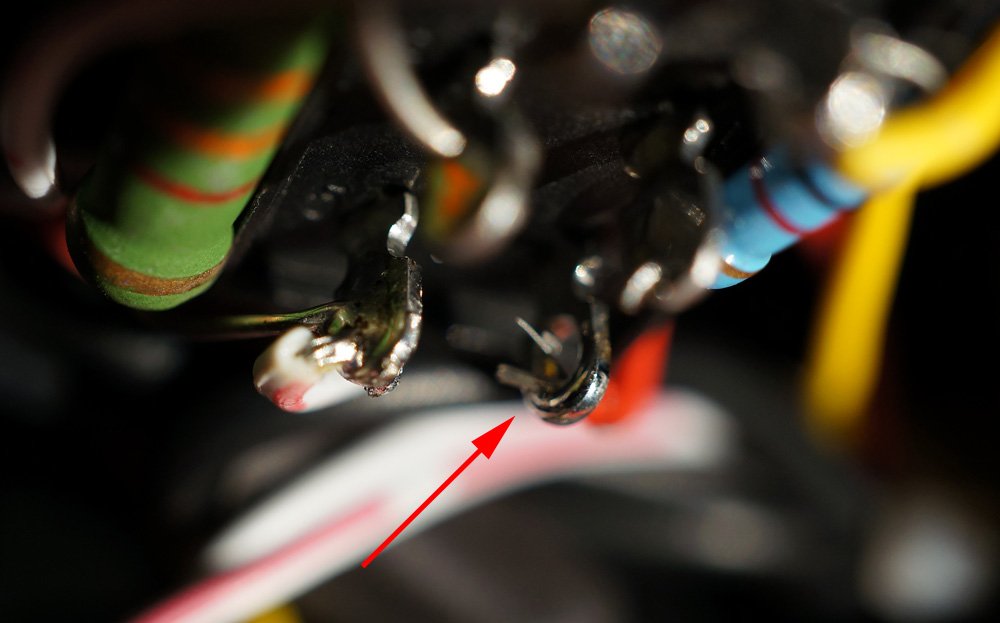

I wonder, since this problem previously went away and resurfaced, if there could be a cold/loose solder joint somewhere in the filter caps/diodes section. Perhaps the joint finally broken clean? I don't know what I talking about though ?
That is something you can try yourself if you are handy with soldering. Absolutely no harm in doing that. Just re-solder all the points around that valve base and bios pcb as I pictured above.
I decided to look myself and see if there is anything obvious. Check this out - There is NO SOLDER on one of the connections on the rear power tube selector switch. I don't suppose this could have anything to do with my problem could it?
The photo is not clear to me but if you see no solder there, that might be the issue. However, DON'T GO ON WITH MULITIMETER AND CHECKING STUFF UNDERNEATH IF YOU DON'T KNOW TUBE AMP. There are lethal voltages involved. Please be careful mate.

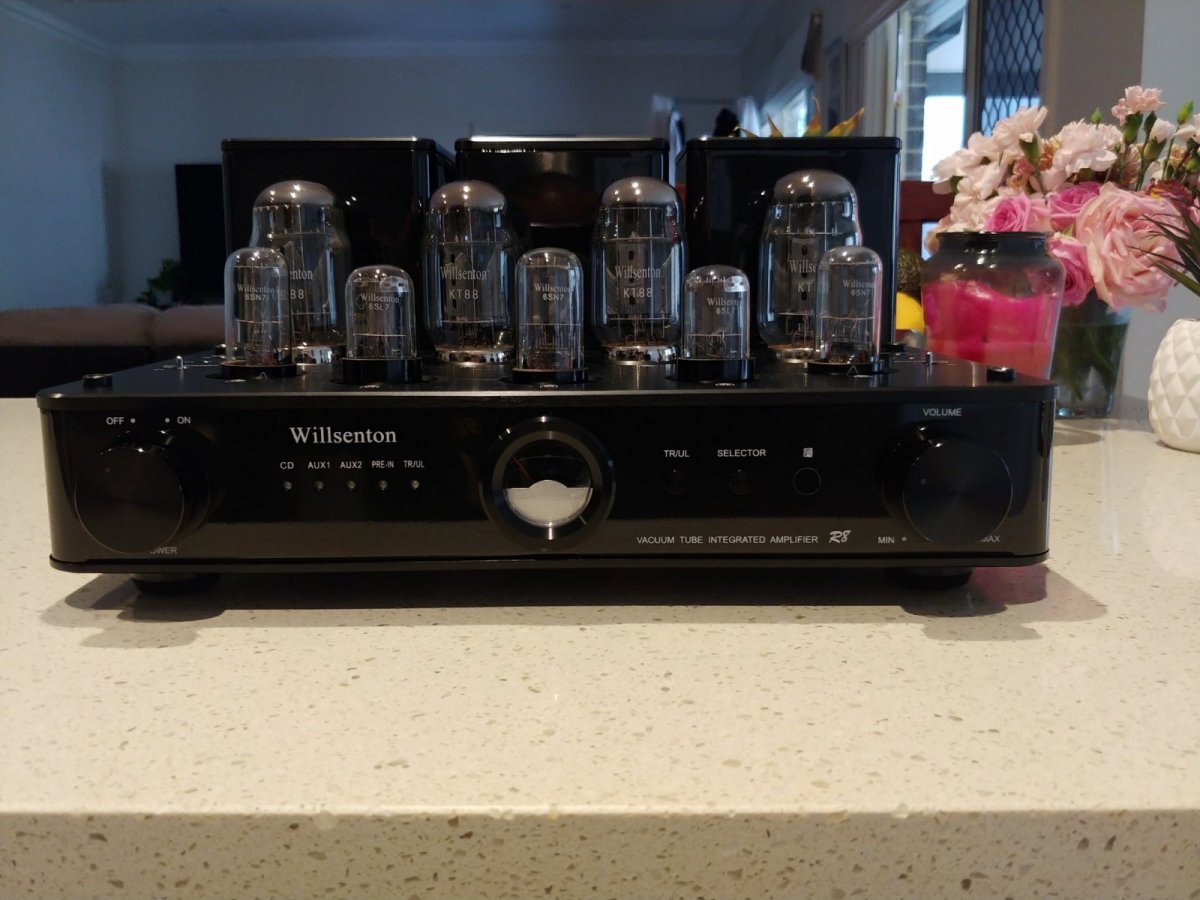

Bummer to read of your issue @echorec. Hoping you get it sorted quickly.  I guess this will test the warranty follow up etc too.  I am sure Yong will be helpful but yes, the geographical distance will push options available.  The website does clearly state warranty is no issue outside of China so if thats through their preferred fixxer or your preferred fixxer with the cost being covered I am sure will explored.
On a happier note, mine finally arrived.  Packaged like a champion and the smell of fresh paint once I unboxed it was insanely strong.
All plugged in and working perfectly.  Checked the bias, was a bit high and just pegged it back a bit and now all good.
About 5hrs of listening thus far, very nice.  I am sure it will get better after maybe 20-30hrs as a minimum.  But right out of the box I am happy with the bass and also the higher frequencies, nothing brittle and bass is quite stong.  Wouldnt say soundstage is mind blowing just yet but I can hear the depth in it, just need it to open a little and then the width will be there too.
All tubes are standard, the KT88 I was unsure whether to go for based on some reviews saying the EL34 is a slightly smoother sound but I went with KT88 and will over time roll through the varying options.
As this was a unexpected gift I just plan to enjoy it for a while and leave it as it is till its all burnt in and operating at capacity. Unless the tubes foul up I dont expect to change anything until maybe early next year, but with all the rolling in this thread already it will be a great reference bank on what tubes power and pre to consider when I do decide to go shopping!
Here are some pics...

Thanks, everyone! I double checked that solder connection pictured above and there must be a very tiny amount of solder holding the wire to the post as the wire does not move. It definitely needs to be resoldered though. I just closed it up and am planning on taking it in for repair locally on Tuesday. I'll let the local expert take it from here.

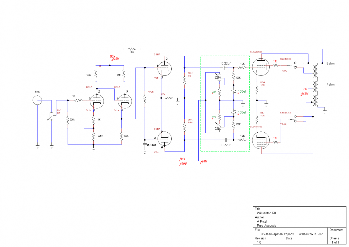

@echorec
Hey mate,
Here are schematic. I have attached Original as well as one I drew after opening. The values are different nothing else and some details of Tube switching is not included in both but that does not matter much as it only changes the grid voltage.

Thank you so much!
@Atmaj thanks for sharing the schematics!
just curious have you done some measuring if the B+ voltage? is it around 445V? so when biasing KT88 should be around 55ma(70% dissipation)  ?
I did measured all the B+ voltages (with 244V grid supply) which are there in the schematic however, I haven't noted down the Bias current measurements. Should have done that but it took long time to note values of all components and draw schematic. I roughly recall it to be 47ma but not 100% sure about it.
