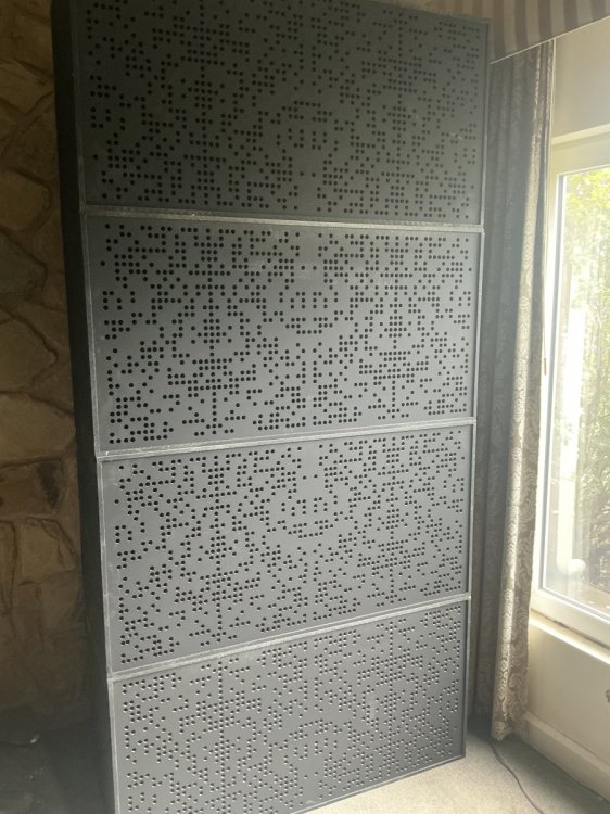

Last weekend I finally completed my diffused acoustic panels which have been a fill in project for a long time. The panels are a standard 1200 x 600 and about 430mm deep. I used the fluffy pink batts for minimal flow resistance so they act as lower frequency bass traps. I have a stack of these in each back corner. Previously I had commercial 200mm panels there and now those have been moved to the front corners to double up to and also provide 400mm of panel depth. The panels also have a 400mm air gap. The ceiling has a series of 12 panels supported on chains with an air gap. Next step is to redo the room correction and I might try some room measurements to see how well it performs. I added the diffusion to the rear panels to prevent some of the over damping I was experiencing with the panels and I have about half the ceiling panels with diffusion added. I also have some skyline diffusers at the side reflection points.

    The panels went in with the other bags of insulation and did some measurements. No EQ changes, tried to keep the same  sweep gain from the last set of readings.  Put the bags in places there seem
  • Starting to wrap up this part of the panel job. Outer case framing made and painted, on the last part, the plaster wall attachment frame/seal,  lovely and sunny today, beautiful. Another coffee b

Im not sure yet. I run Bacch4mac in my system and there is an update I need to install. This update requires a complete redo of the profiles so i decided to wait for the acoustic treatment since that would necessitate new measurements anyway. i've done the install of the new version but havent done the measurement process. What I have noticed is the room is slightly more live with the diffusion panels.
I'll post again when Ive set up my system and had a listen. Sure hope it makes a difference, it was a lot of work.
