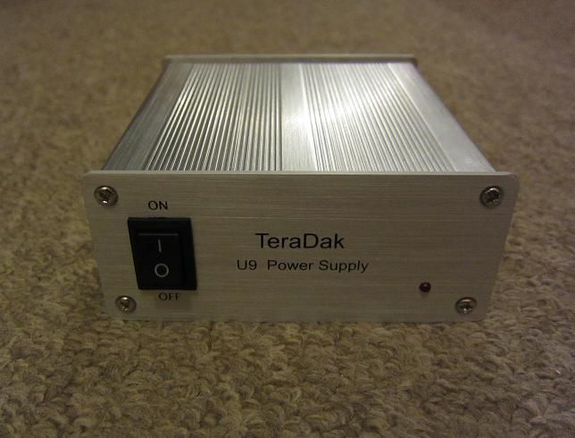

pete_mac Posted November 8, 2013 Posted November 8, 2013 I snaffled one of these Teradak U9VA linear power supplies recently from A&B Systems in Hong Kong, as I was after a cheap clean USB power supply for my DAC. http://www.ab-system.hk/index.php?route=product/product&path=73&product_id=64 Dirt cheap at around $65 landed. The power supply came with a 5.5mm equipped cable for the 9V output (which, incidentially, is adjustable via the trimpot on the PCB from 0.25V to 9V). To my very great surprise, the power supply also comes with a power-only USB cable which works perfectly for my needs. Importantly, it is the kind of USB cable which passes through the data, but severs the power supply from the original source and injects the clean 5V from the Teradak PSU instead. I am most impressed with this inclusion, as I was considering making up my own power-only USB cable anyway. I note that the transformer inside these units is now a 120/240V configurable unit, rather than 115/230V as was previously the case. It appears to be fairly well designed and constructed, and weighs just under 1kg. I note that the advertising mentions the use of Panasonic FC caps. Nope, that's definitely not the case - these caps are some other kind of 105 degree low ESR cap. Now for some listening comparisons to see if there is any perceivable difference using this power supply vs the 5V USB output from the SBT. Some people reckon that the SBT sounds better with the least possible load on the power supply, but whether I can actually hear a difference remains to be seen. If there's no difference, then at an absolute minimum I've bought a nice and heavy $65 power switch for my DAC Considering the actual price of the unit is USD$44 + around $USD15 for registered shipping (so about $65 AUD as mentioned earlier) I reckon it's pretty darn good value for money. 12

A J Posted November 9, 2013 Posted November 9, 2013 The only thing to point out is that they use a 9VA transformer - that means at 1 amp these things are being pushed hard. Other than that - looks like a ref hit bargain. It would interesting to scope the output because at the end of the day - what you generally want is a stable, low impedance and low noise floor supply. 1
skippy124 Posted November 9, 2013 Posted November 9, 2013 I will get Pete to bring it over and I can put a scope on the output. Cheers John 1
pete_mac Posted November 9, 2013 Author Posted November 9, 2013 I will get Pete to bring it over and I can put a scope on the output. Cheers John That's a sterling idea! Probe-fest tomorrow afternoon. 1
evil c Posted November 9, 2013 Posted November 9, 2013 That's a sterling idea! Probe-fest tomorrow afternoon. I also am very interested in any improvements this might offer to my SBT if compatible
A J Posted November 9, 2013 Posted November 9, 2013 I will get Pete to bring it over and I can put a scope on the output. Cheers John That's a sterling idea! Probe-fest tomorrow afternoon. Hmmmm ðŸ˜
pete_mac Posted November 10, 2013 Author Posted November 10, 2013 (edited) OK, we threw the Teradak PSU on the scope today at skippy124's place. This wasn't intended to be exhaustive testing, but a quick comparison with the tools we had at our disposal. Whilst I didn't drag my SBTalong for testing the output of its USB port when fed via the SBT switching PSU, we did have an apple 5V USB power supply and a generic 5V USB power supply. The generic power supply revealed around 250-300mV of noise under no load, and an increase over this figure when under load. The Apple power supply revealed around 80mV of noise under no load, and an increase over this figure when under load. The Teradak linear PSU showed 2mV of noise... but unfortunately this was the limit of our testing, as there was 2mV of noise with nothing connected to the scope. So, all that I can say is there is definitely less than 2mV of noise. There was no change in the measured noise under load, but again with the caveat of not being able to measure below 2mV in this instance. There's a chance that the linear PSU did get noiser under load, but if both measurements are beneath the noise floor of the measuring equipment, then we'll never know. In short, there is definitely much lower noise offered by this PSU compared to other generic switchmode USB 5V PSUs. One day I might get Dad to take the power supplies to work so that he can arrange for them to be tested on more sophisticated, higher resolution equipment. In future we'll also measure the SBT USB output and the output of a laptop USB port. Edited November 10, 2013 by pete_mac 2
